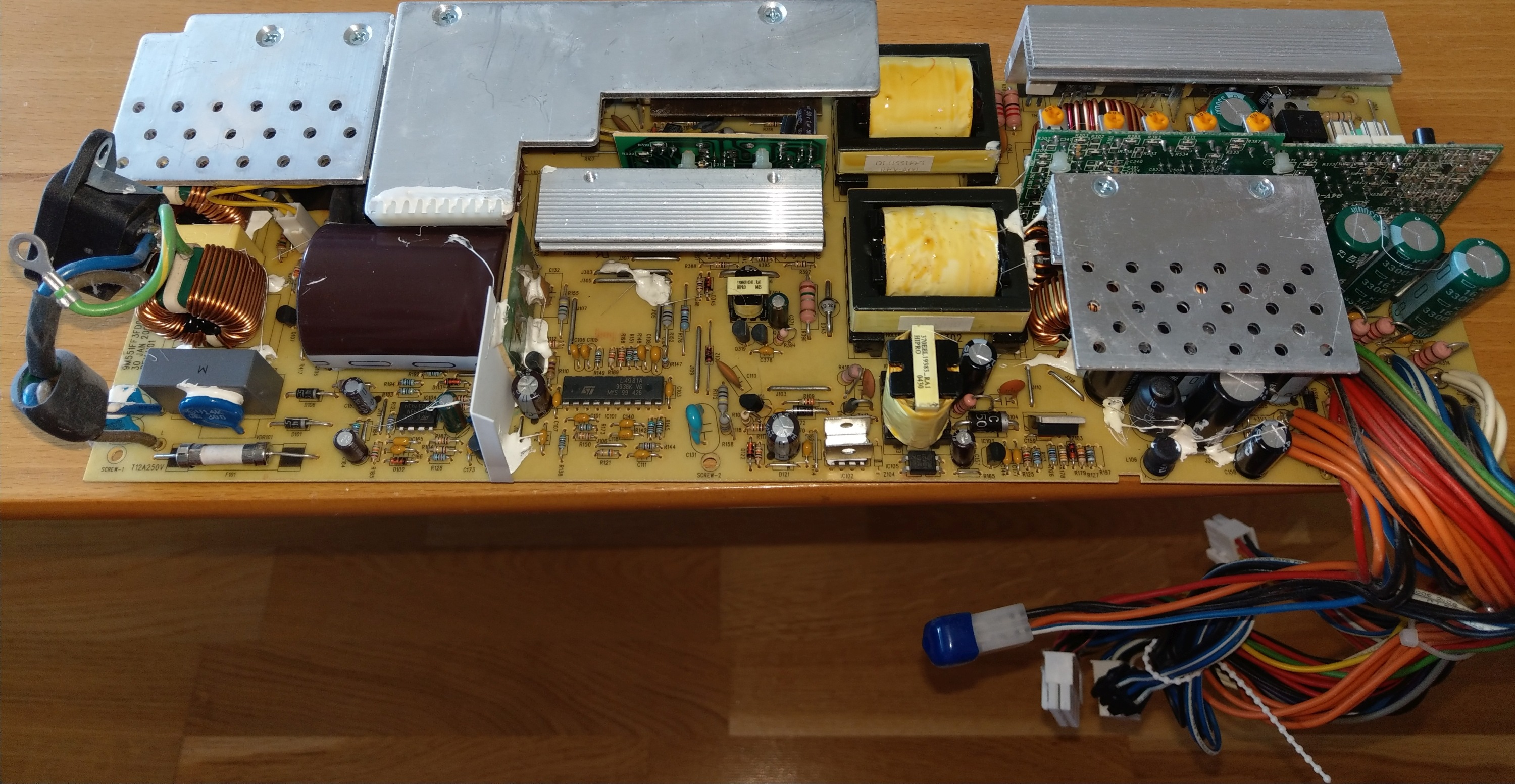

                Decided to open up the PSU I bought for this machine on eBay years ago.
                The original that it came with from the dumpster was built like a tank as seen here: 1 2 3 4 5 but alas it was dead so I replaced it with one using the same Dell partno back then.

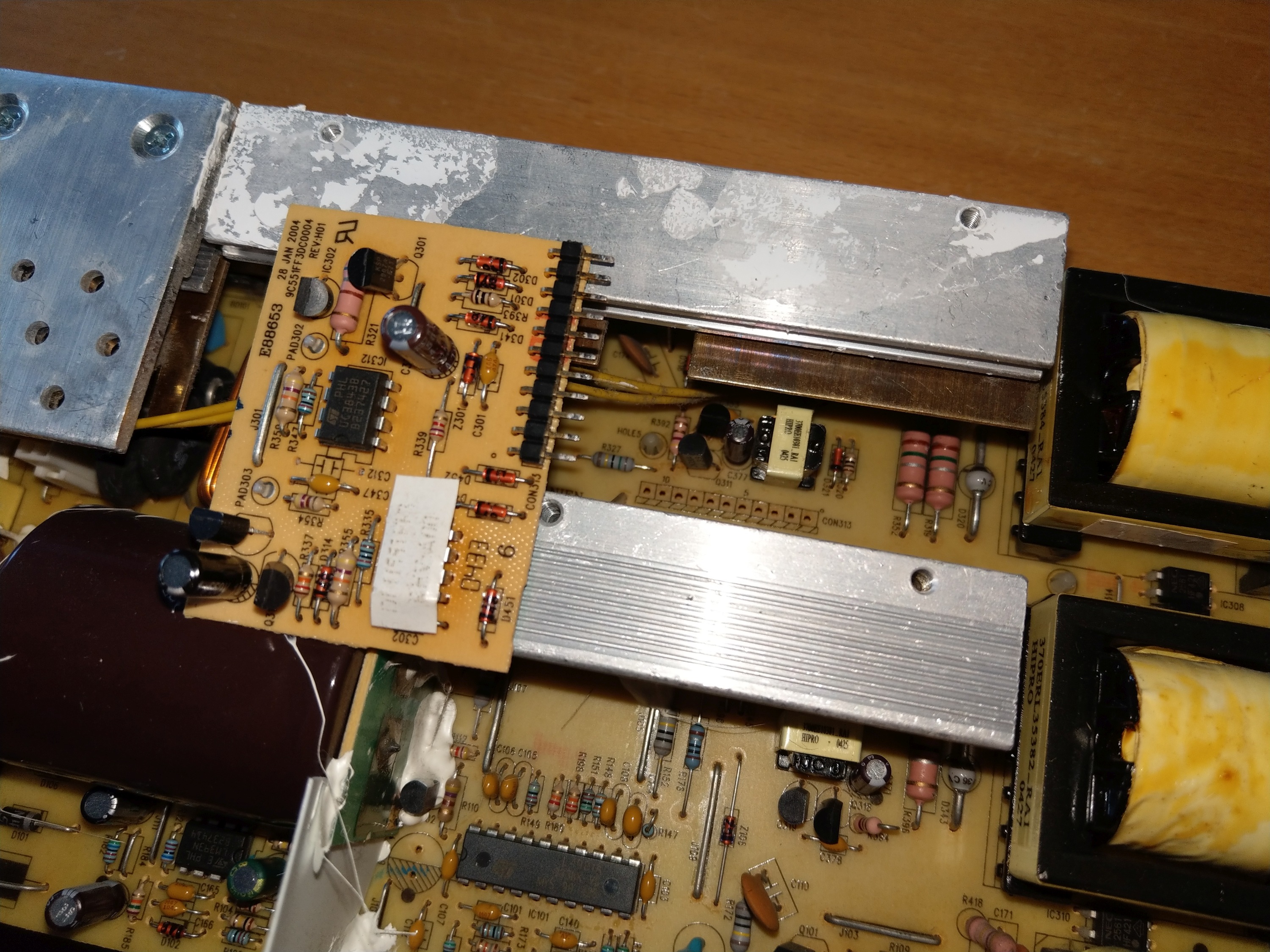

                As I opened the PSU I was instantly greeted by a bulging Teapo SEK 220uF 35v cap dab smack center of the board smiling back at me, near the boards edge, it read around 90uF and 7 ESR on my meter.

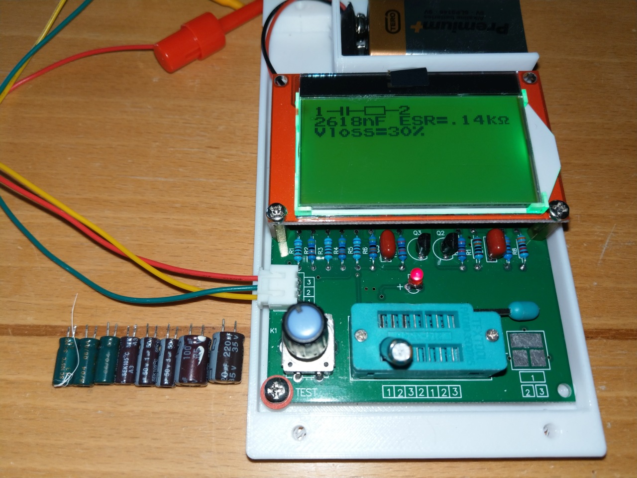

                I replaced it with a UCC KMG, to the left of it was a 100uF 35v SEK that I also replaced, it measured ok though unlike it's bloating neighbour!
                The fun came when I started replacing the small caps, some read 140ESR, which is the highest my meter can show.
                Impressive that the PSU did not blow itself up!
                Of course all the Rubycon and UCC caps on the board were fine after all these years!

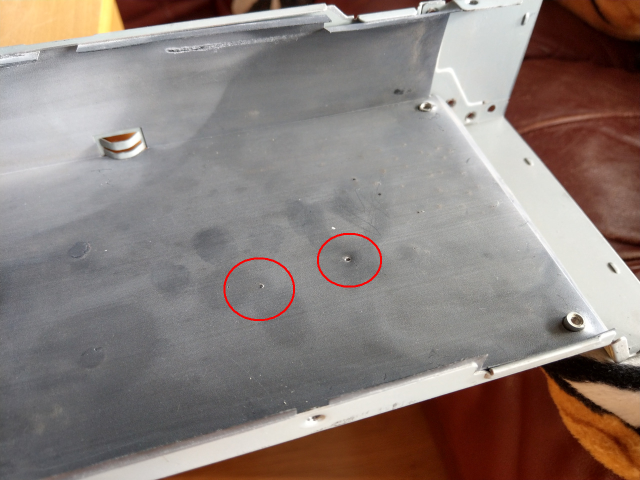

                Now it's put back together and working again, there was one scare at the back of the PCB, an inductors leg had almost pierced the black insulation cover!
