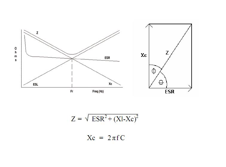

    Re: Dell Precision 470 Workstation
    Originally posted by PCBONEZ
    - The rule about reducing uF when you lower ESR does not apply to other parts of a motherboard.
    [That rule wasn't 'invented' out of the blue, it comes from a tech doc about VRM's.]...
    Could you post that or provide a link? Enjoy a good read.
      Originally posted by bigcape
      So where is the lytics to poly conversion chart?
      There isn't one because too much is involved.
      But you are welcomed to do the math [for each cap] if you want to.
      Here's a start.
      I'm of course just teasing.
      The point is that it isn't that simple.
      There is a thumb-rule used for VRM caps derived from that math and an engineering document for a VRM MOSFET Controller chip that says if you switch to ploy then you can reduce uF by half. That doc clearly pointed out that in VRM's the ESR is more important than the uF.
      The thumb-rule isn't that safe to use anymore because it was based on the characteristic of the polys that existed at the time. Since it was created more kinds of polymer have come on the market and some actually have worse ESR than the better lytics.
          KC8 posted it like 3? 4? years ago.
          Always takes me forever to find it but I'll look for a few before I crash for the night.
              Here's the thread:
              https://www.badcaps.net/forum/showth...&highlight=mod
              Here's the document:
              See page 15.
