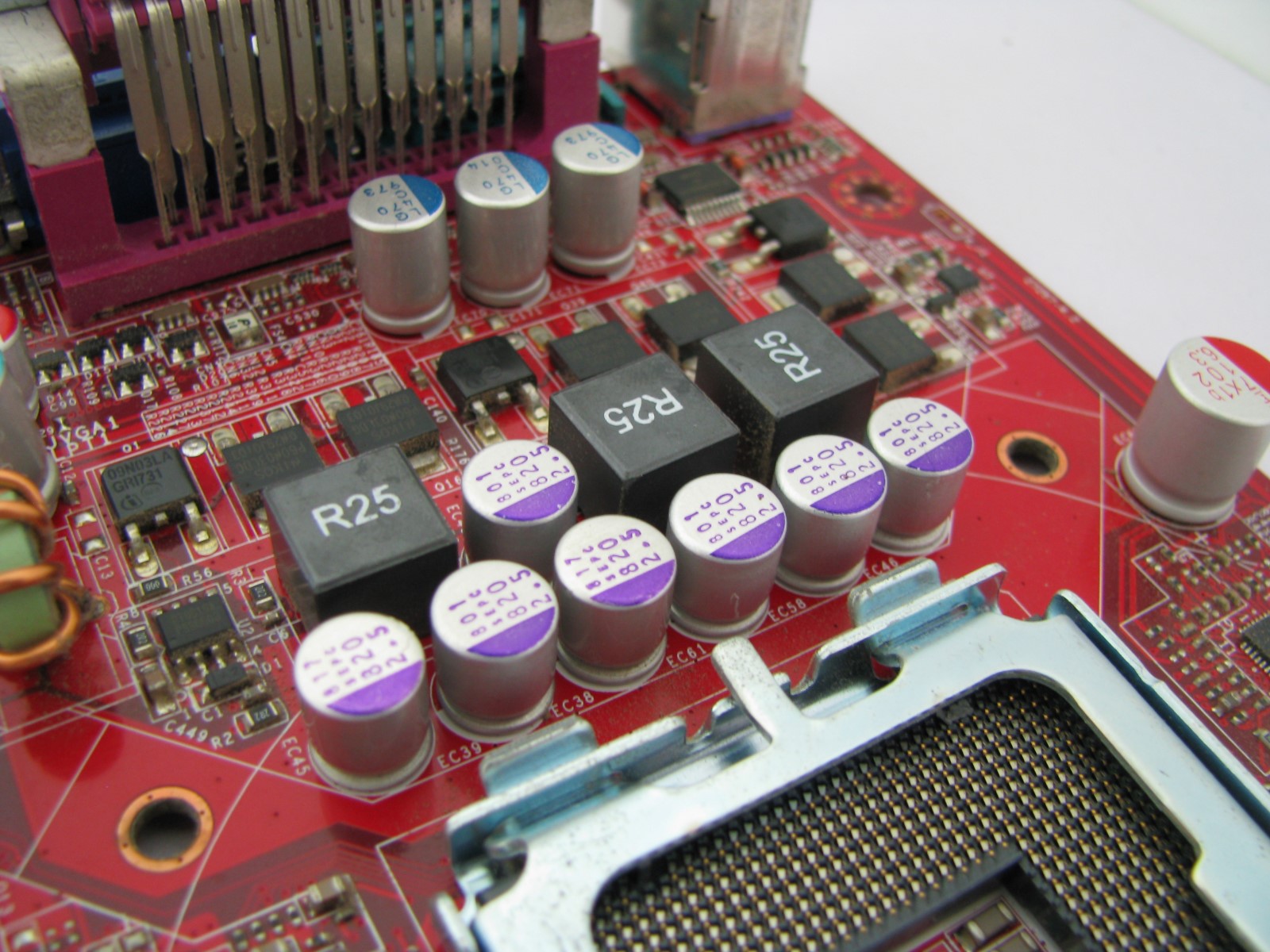

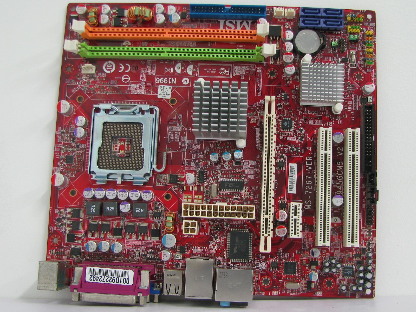

    MSI 945GCM5 V2 Full Poly-mod

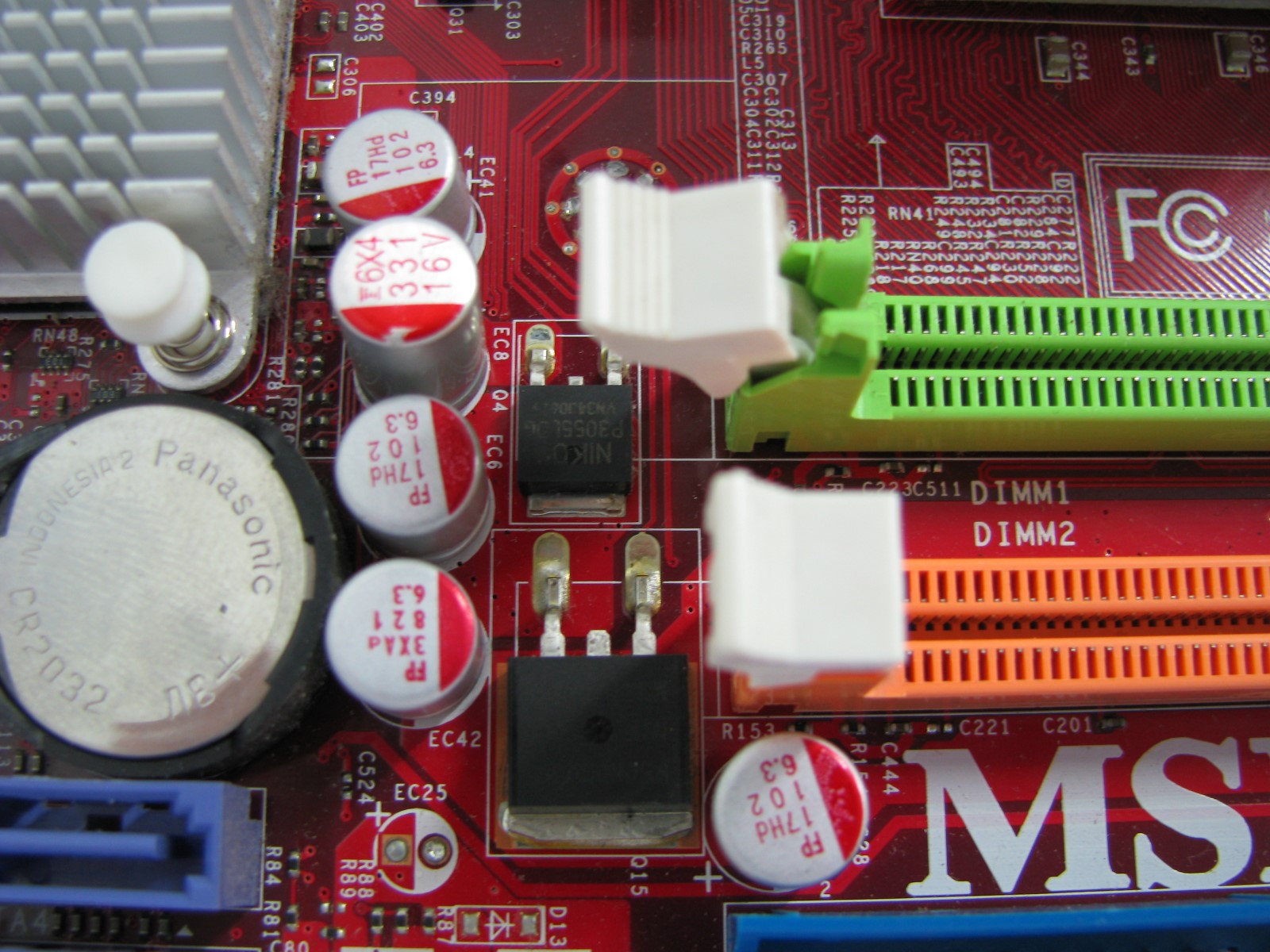

    I've said before here that I've found MSI boards to be fairly tolerant of being poly-modded, and today, I did another one. A 945CGM5-F V2 to be exact.
    The CPU VRM high got 470uF Nich LG 16V polies, while the low side got 820uF 2.5 OS-CONs.
    The others which originally had 470uF either got that or 330uF as replacements

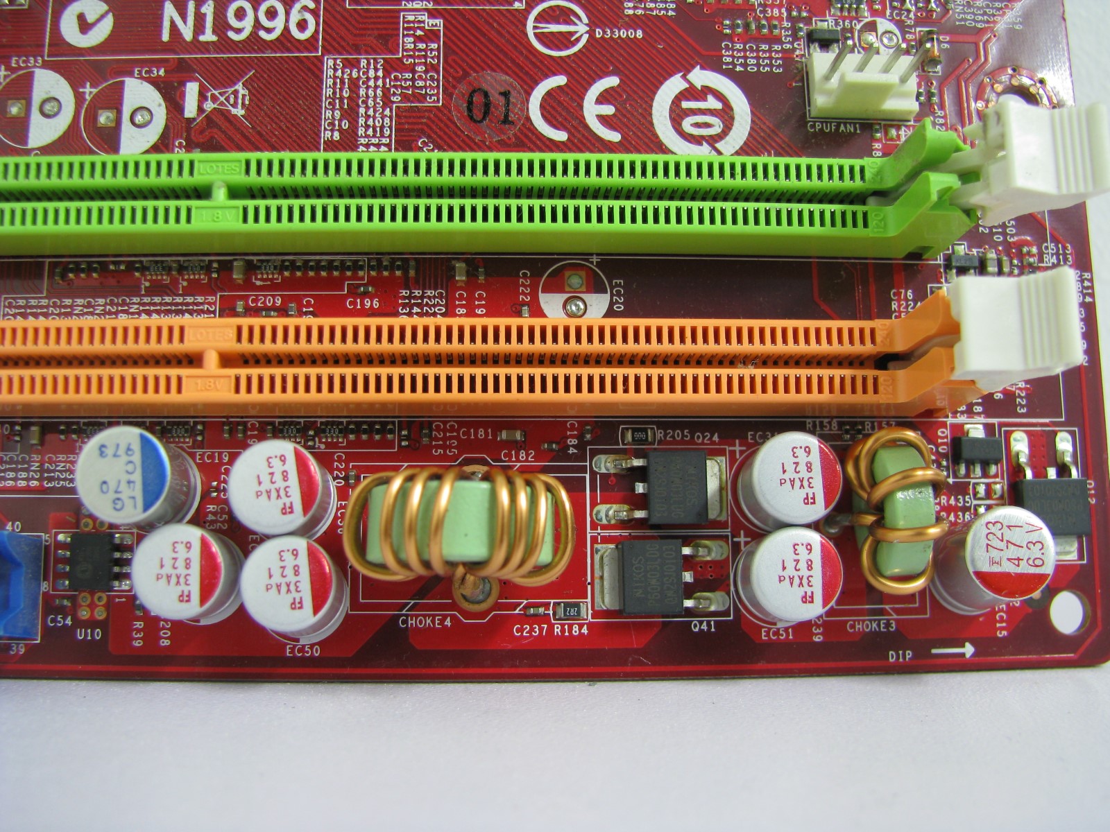

    There were two 1500uF caps on the RAM VRM which were replaced with 820uF 6.3V Nichicon L8, and there were 3 220uF 10V caps near the chipset which were replaced with 220uF 6.3V NCC PSC.
    Everywhere else (which originally had 1000uF 6.3V lytics) got either 1000uF or 820uF 6.3V Nichicon L8.
    I was quite interested in doing this board as there is what appears to be a linear regulator in the 3rd picture here (in between the CMOS battery and DIMM slot), which gets very hot, and the lone cap immediately above it is usually the first to go on these boards. Hopefully, the poly will handle the heat a bit better.

          Don't know how I missed this thread. Nice one, c_hegge. Looks really good. What were the brands of the original caps?
              OST and Teapo, and possibly a few KZGs
              Originally posted by stj
              why the mix of brands and types?
              Because that was what I had on hand.

                Were any of the original caps bulging? I'm a big fan of 945 boards, especially well built ones. They're extremely reliable in my experience.
                • c_hegge
                  • Sep 2009
                  • 5219
                  Re: MSI 945GCM5 V2 Full Poly-mod
                  I think they might have still been OK on this particular board, but it was only an old lady who used it, and probably only once every couple of weeks. The cheap sleeve bearing case and PSU fans hadn't even seized
