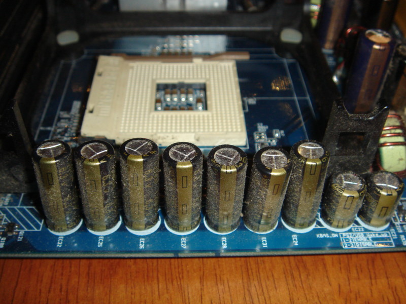

    You have probably guessed by now that it has a bunch of bad caps.... and yes there are bad caps on that board.
    There are 3 GSC 3300uf 6.3V 10mm caps near the CPU.
    The 3 GSC caps are all leaking electrolyte and will need replacing. I've just gone through my draw and I found one Sanyo WG 3300uf 6.3V 10mm cap.
    The rest of my spare caps are Hitano 3300uf 10V 12.5mm, and they won't fit.
    I've got some 2200uf 6.3V 10mm Panasonic FJ caps coming this week.... would they be OK for replacing the bulging GSC caps?? My brother's friend said that this motherboard was very stable when he took it out of service.... he only took it out of service because he feared that the bad caps could cause some damage to some other parts in his PC some time soon.
    On the board, I can also see that there are itty bitty GSC caps with 330uf 25V ratings. They are domed, but are domed inwards.... does that mean that they are bad??
    I can see that the CPU output caps are 1000/1500uf 6.3v 8mm Panasonic FJ series caps so they are fine and won't need replacing.
    I am wondering if I should also replce the GSC (or Choyo??) 1500uf 16V caps for CPU power input?? They look fine (no bulging etc.) but being GSC or Choyo caps, could they be dry inside the cap itself??

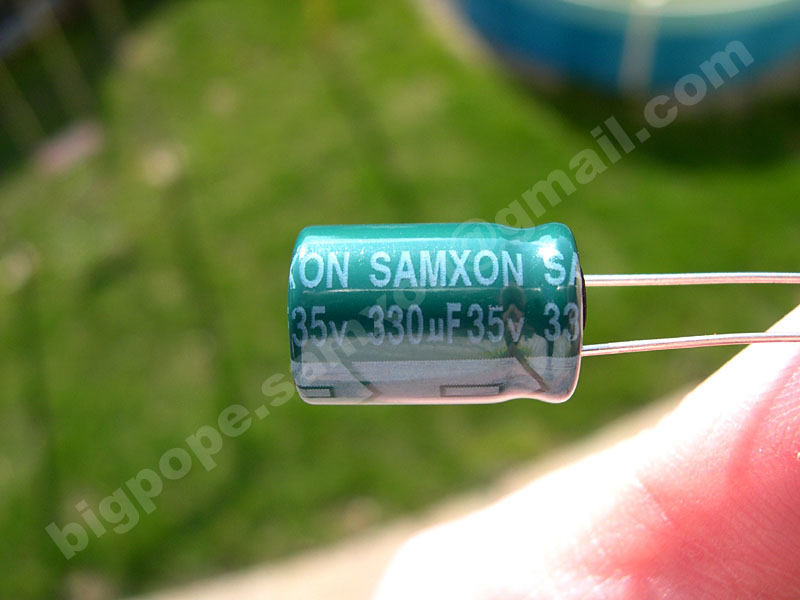

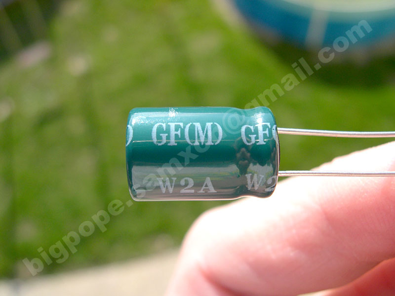

    Would you want to try this? I have replaced many GSC and CHOYO with 330uF 35V D10x16mm on Gigabyte boards being of this year, all are wroking great.

        you can wash the MB in simple green (from bunnings) there is a thread on it here somewhere, just make sure you give it lots of time to thoroughly dry out.
        for max life Id rip any crap caps out of the VRM atlest
        If in doubt replace them
        Going to 470 uf shouldn't be a problem just be careful when it comes to reduced voltage.
        since its a MB highest voltage is going to be 12V so 16V should be ok
        You shouldn't need to use low ESR for other positions just use good quality caps
        you will probably find they are general purpose caps anyway
        using low esr I dont think is going to hurt but more a waste of a good cap if anything
        I dont know what the quality of the latest Hitano are, they were considered crap in the past I believe (but I have heard of there use in the vrm and staying the distance for a fair while) so Id if you got them to hand use them in the GP postions
        (personally I wouldn't use them in vrm, but thats me knowing what I know now thanks to these froums)
        I dont know the MB layout but dont mix values in the vrm circuit, use the same value
        you can use more lower values to get back to the original or a little more total capacitance.
        for example see my post here
        ok just re read your post
        VRM caps look ok you say...Panasonic FJ series
        get rid of GSC and Choyo while you got the chance.

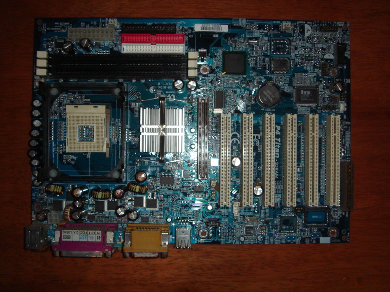

          post a pic of the MB if you can, save me having to hunt for one but only if you feel like it.
          Sorry about that, I forgot the pictures. I took some pictures today. In the last pic, there's a whole row of Panasonic FJ caps around the CPU. I don't know why Gigabyte mixed Panasonic caps with lower quality GSC and Choyo caps though.

            Stevo1210. I am curious why you are not using Samxon from Big Pope in Hong Kong. They are great quality, great price and he will post to you. Pay via Paypal. Hitano EXR have been around for quite a time, their ESR values are not as great as Samxon GC or GD series.
            See Big Pope catalogue in this thread.

                I can't use Samxon caps because I do not have a paypal account or a credit card.
                I wish I could use Samxon caps though because I know that they are very high quality caps and have lower ESR than Hitano caps.
                I use Hitano caps because I can get them locally here in Sydney.

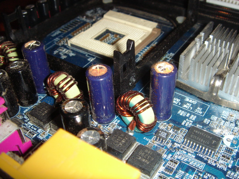

                    It looks like those FJs at the VRM output have been sitting there for a while - which would seem to affirmatively settle the issue of whether they're durable enough. That's good news, because FJs are widely available locally in the 'universal' 1800uF/16v/10x20mm package.
                    Check the voltage on the 330uF/25v caps - on every Gigabyte board I've seen, they haven't exceeded +5v and those caps can be safely replaced with 6.3 or 10 volt caps. I use Panasonic FC or Nichicon PW 1000/10, which are about the same size, but the 1800uf/16v FJ is probably a good replacement too.

                      not that a GSC is a great measuring stick LOL...but yeah they look fine thats for sure
                      I am a little curious as to why they mixed values if they are all part of the VRM output?
                      I count 7 X FJ and 3 X GSC so that makes 11 caps
                      there is 2 smaller ones there but I very much doubt they are part of it...
                      (something in my mind says they are part of Fan circuit?)
                      VRM controller chip appears to be HIP6301CB I suppose a look at that and the mosfet driver chips and it might make sense.

                        I recapped this motherboard yesterday afternoon. I only recapped the bad GSC caps. The replacement caps are Sanyo 3300uf, 6.3v, WG series.
                        I haven't booted it up yet but I will try to remove the CPU from my media center PC and put it into this motherboard to see if my recap job was successful.
