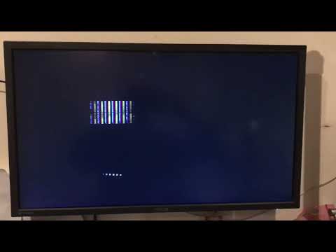

2080Ti startup issue ?
  • moss99
    • Oct 2013
    • 50
    • United Kingdom
    2080Ti startup issue ?
    Hi I recently bought a 2nd hand Ge-force 2080Ti, it all works ok runs fine and no issues stress testing with furmark . However I get this screen when powering on (see video link) , is this cause for concern ? .
  • FZG
    • Sep 2022
    • 117
    I guess this is some scrambled version of the mainboard vendor logo and the loading circle. Can you access BIOS and if so, does it display correctly?
    • moss99
      • Oct 2013
      • 50
      • United Kingdom
      Just gone into the bios and all looks like it should, interestingly it seem it only does it from power up not on a restart 🤔
      • FZG
        • Sep 2022
        • 117
        In the video it looks like it also happens when starting the PC from sleep mode.
        What exact model of GPU are we talking about?
        You shoud try to update the GPU VBIOS, if there is an update available. Use GPU-Z to check your current firmware version.
        • piernov
          • Jan 2016
          • 4439
          • France
          Should check with another motherboard and display before messing with the graphics card.
          • FZG
            • Sep 2022
            • 117
            Can´t see how the display would be at fault here though
            • moss99
              • Oct 2013
              • 50
              • United Kingdom
              Originally posted by FZG
              In the video it looks like it also happens when starting the PC from sleep mode.
              What exact model of GPU are we talking about?
              You shoud try to update the GPU VBIOS, if there is an update available. Use GPU-Z to check your current firmware version.
              The video is from startup, it does not do it from sleep, Gpu msi gaming trio geforce rtx 2080 Ti
              • moss99
                • Oct 2013
                • 50
                • United Kingdom
                Originally posted by piernov
                Should check with another motherboard and display before messing with the graphics card.
                The motherboard is a fairly new asus PRIME Z690-A (LGA1700) and both were working fine before I put this card in.
                • moss99
                  • Oct 2013
                  • 50
                  • United Kingdom
                  I just checked and it seems to be on 30 Hz with no option to change it, I plugged it into the other display port and that does not show the scrambled image on startup and its on 60Hz but if i touch the cable it goes to black screen like the connector is bad .
                  • FZG
                    • Sep 2022
                    • 117
                    How does it work with the other connectors? Should have 3xDP, 1xHDMI, 1xUSB-C.
                    Did you check VBIOS version with GPU-Z? Latest version is 90.02.42.00.14. If everything else fails, might be worth to give it a try.
                    • moss99
                      • Oct 2013
                      • 50
                      • United Kingdom
                      Originally posted by FZG
                      How does it work with the other connectors? Should have 3xDP, 1xHDMI, 1xUSB-C.
                      Did you check VBIOS version with GPU-Z? Latest version is 90.02.42.00.14. If everything else fails, might be worth to give it a try.
                      Version : 90.02.30.00.65 is what I have
                      Not done a VBIOS update before , will take a look / .
                      • FZG
                        • Sep 2022
                        • 117
                        Make a backup of your current BIOS before doing anything (can be done with GPU-Z).
                        Flashing a new BIOS can be done with Nvidia NVFlash or with a USB programmer.
                        Latest rom for your card is here: https://www.techpowerup.com/vgabios/...i-11264-200203
                        Besides all the VBIOS stuff, check your display cable as well (just in case it´s that simple...)
                        • moss99
                          • Oct 2013
                          • 50
                          • United Kingdom
                          It was just a dirty connector, it looked a bit dull compared to the other 2 ports so I gave the cable plug a squirt of contact cleaner worked it a bit now its working fine..
                          • shahnld
                            Lenovo legion 5 pro startup issue
                            by shahnld
                            Good day Experts
                            I have a lenovo Legion pro 5 16ACH6H with AMD RYZEN 7 5800H and RTX3070,.
                            A weird issue has troubled me. If i power on off the laptop 20 times then only power LED will lit but no fan spin no display. At this stage gpu, vram. DDR voltage. 5v 3.3v 1.8v and the rest are present and cpu core is stuck at 0.84v.
                            And sometimes lets say the 21st time it will boot perfectly and there is image and everything is working perfectly and at this stage i see cpu core...
                            08-24-2025, 12:31 PM
                          • db80
                            Lenovo Ideapad 5 15ARE05 startup issue
                            by db80
                            Hello friends,
                            I've been racking my brain over the past few months on the following issue:
                            I have a Lenovo Ideapad 5 15ARE05 laptop that basically works fine as long it starts up at all.
                            If you shut it down, often you hear the HDD still spinning and the Power LED remains on, it only shuts down if you force it (pressing the power button for like 15 seconds).
                            Then, if you want to Switch it on, nothing happens, only the Power LED lights on, nothing else. If you leave it, then after like 30-60mins it turns on itself.
                            I tried all the common alleged „fixes“...
                            07-06-2024, 05:58 PM
                          • rounin
                            MacBook Air A2337 (820-02016) USB-C Port Issue – Only Works in One Orientation (CC Line Problem?)
                            by rounin
                            Hi everyone,
                            I'm working on a MacBook Air 2020 (A2337, board 820-02016) and running into a strange USB-C issue. I've gone through quite a bit of testing and part replacement, but I'm stuck — hoping someone here can shed some light.
                            🛠 Original Issue
                            The machine initially wouldn't negotiate 20V over USB-C — stuck at 5V.
                            Diagnosis showed PP1V5_UPC0_LDO_CORE shorted to ground.
                            I replaced U3100 (UF400) using a donor board (A2179), and the machine powers on fine now.
                            ⚠️ New Problem: One USB-C Port Only Works in One Orientation...
                            04-19-2025, 01:18 AM
                          • ugamazing
                            Three 820-01700 32GB Logic Boards Same Issue: Won't Wake From Hibernate
                            by ugamazing
                            I have three identical-spec 820-01700 boards (2.6/32/512), and ALL THREE boards came to us with the same fault, from different sources: The boards don't wake from hibernation with the keyboard or lid, they ONLY wake when you press the power button. I understand this is a very minor issue, but the boards must be fixed!
                            We will of course begin with the obvious (checking lid signals), but I couldn't help but notice these three boards were all 32GB variants. Has anyone noticed an issue relating to these 32GB boards in particular? I of course don't think it's a RAM issue, but it's bizarre...
                            12-17-2024, 07:05 PM
