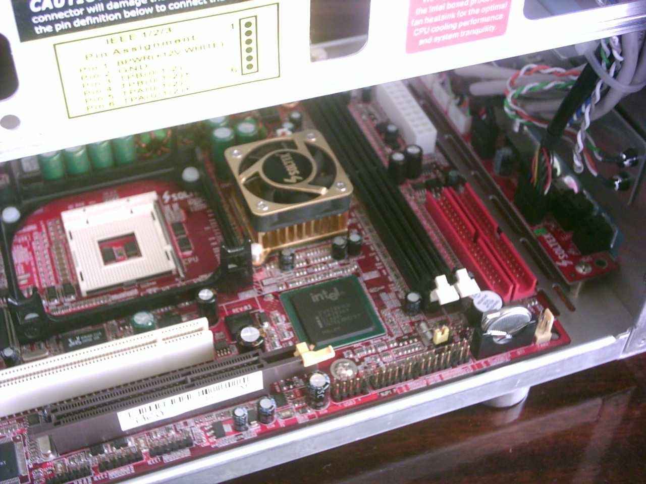

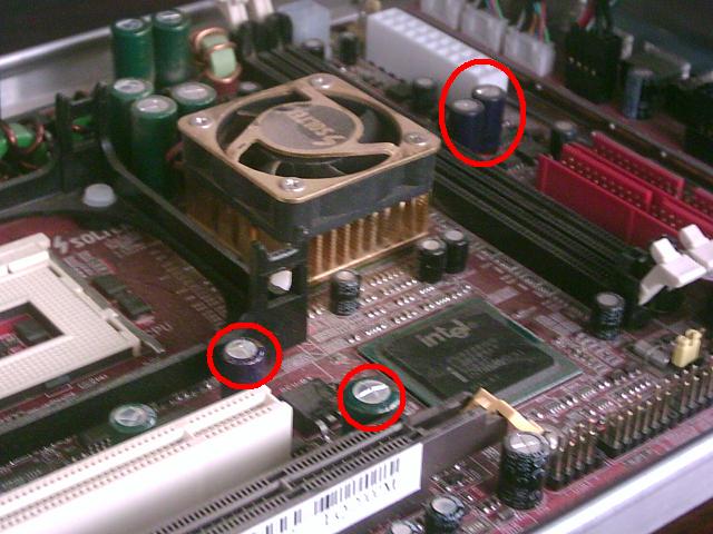

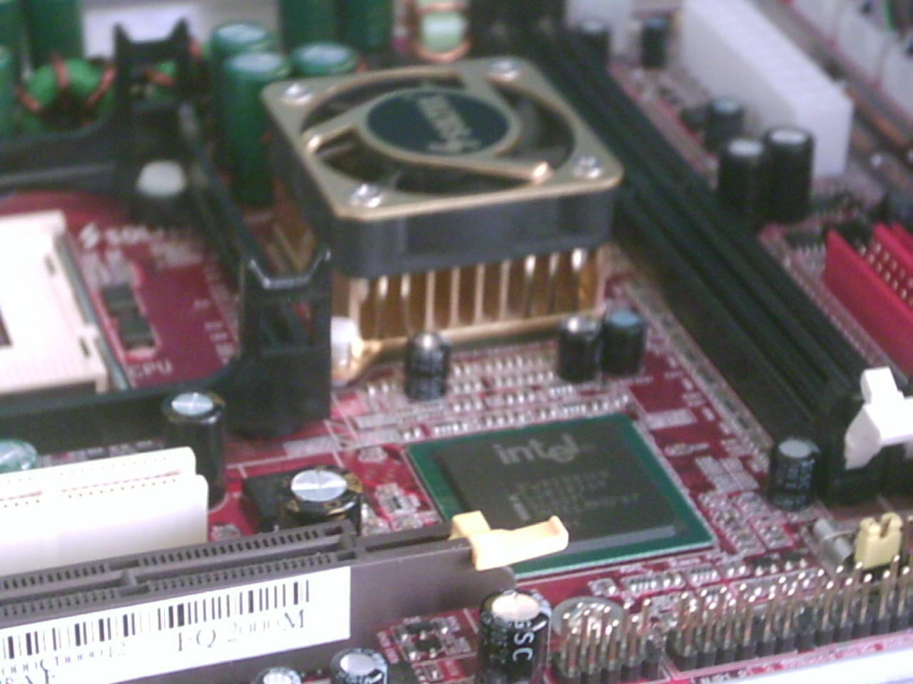

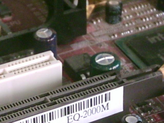

    I recently recieved a Soltek SL-B8A-F SFF motherboard to (partially) recap out of a Qbic EQ-2000M barebones PC, now you're thinking partially recapping a motherboard is kinda' bad or unusual practice eh? well not in this case, as the title of this post indicates Soltek almost got it right with this motherboard (and SFF PC in general).
    As you will be able to see (from the pic's below) this mini motherboard is almost entirely populated with Sanyo WG series capacitors, 11 x 6.3 3300uF & 1 x 6.3v 1000uF to be precise... somewhere during the construction process 3 x 6.3v 1000uF & 1 x 6.3v 1500uF GSC's were introduced (sadly to the detrement of this product)
    Replacement components? that's easy, I'll be using GC series SamXon 6.3v 1000/1500uF pieces, however I'll be flying a little blind on this job as I don't have a s478 processor to 'test' the motherboard before returning it
    FYI the PSU is an Enhance unit model designation ENP-2320 which is populated with Teapo & OST and thankfully no GSC!
