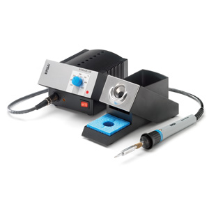

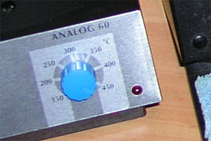

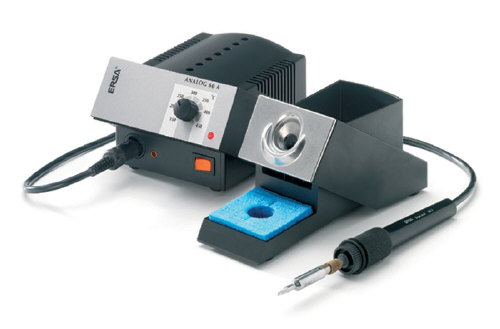

                                  Is this your Station Willa? if yes, how it goes with recapping? is that 60w enough to get the job done easily?
                                  I have this Station seen several times and it seems to be a good unit.
                                  • willawake
                                    Super Modulator
                                    • Nov 2003
                                    • 8457
                                    • Greece
                                    Re: NF7-S Rev. 2.0 Bad Capacitor (see pic)
                                    its fine for recapping but using the chisel tip included. not good at all with conical or other thin tip. i think ersa is making good products but the prices vary, some places sell them for very expensive (180 euro???)
                                    you might find it on sale somewhere like i did. maybe you can find digital 80 cheap now its obsolete?
                                    some versions come with basic tool iron, others come with ergo tool. mine came with ergo tool even though it had a picture of basic tool on the box
