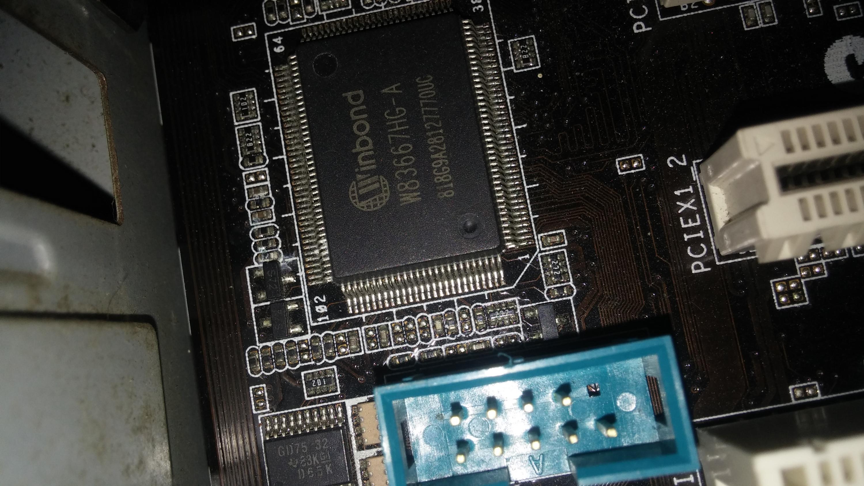

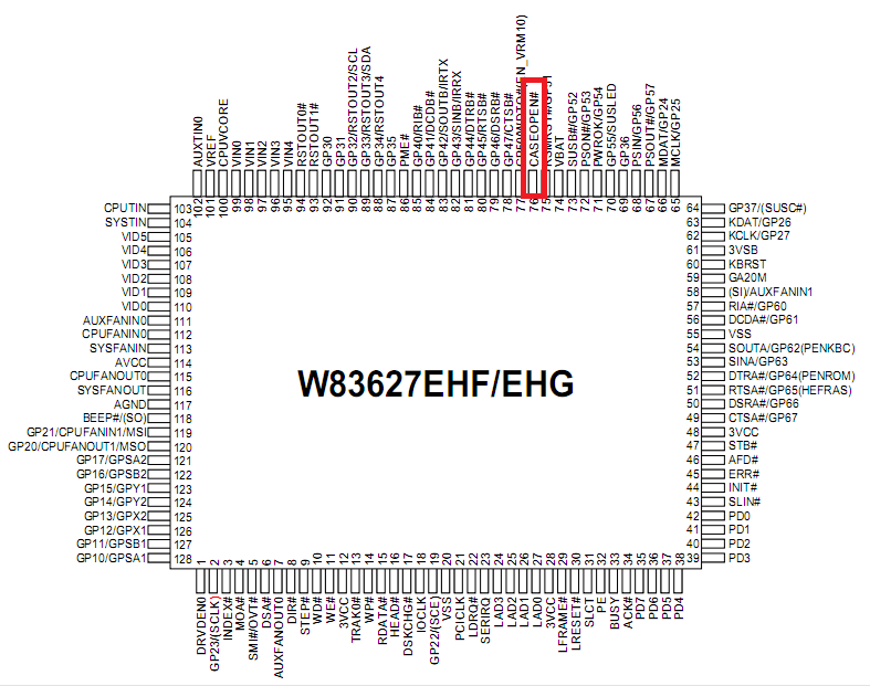

Now, as far as how to find that transistor... I haven't a clue! But probably some SOT-23 transistor either near LPC Super IO chip or perhaps even CPU socket itself.
