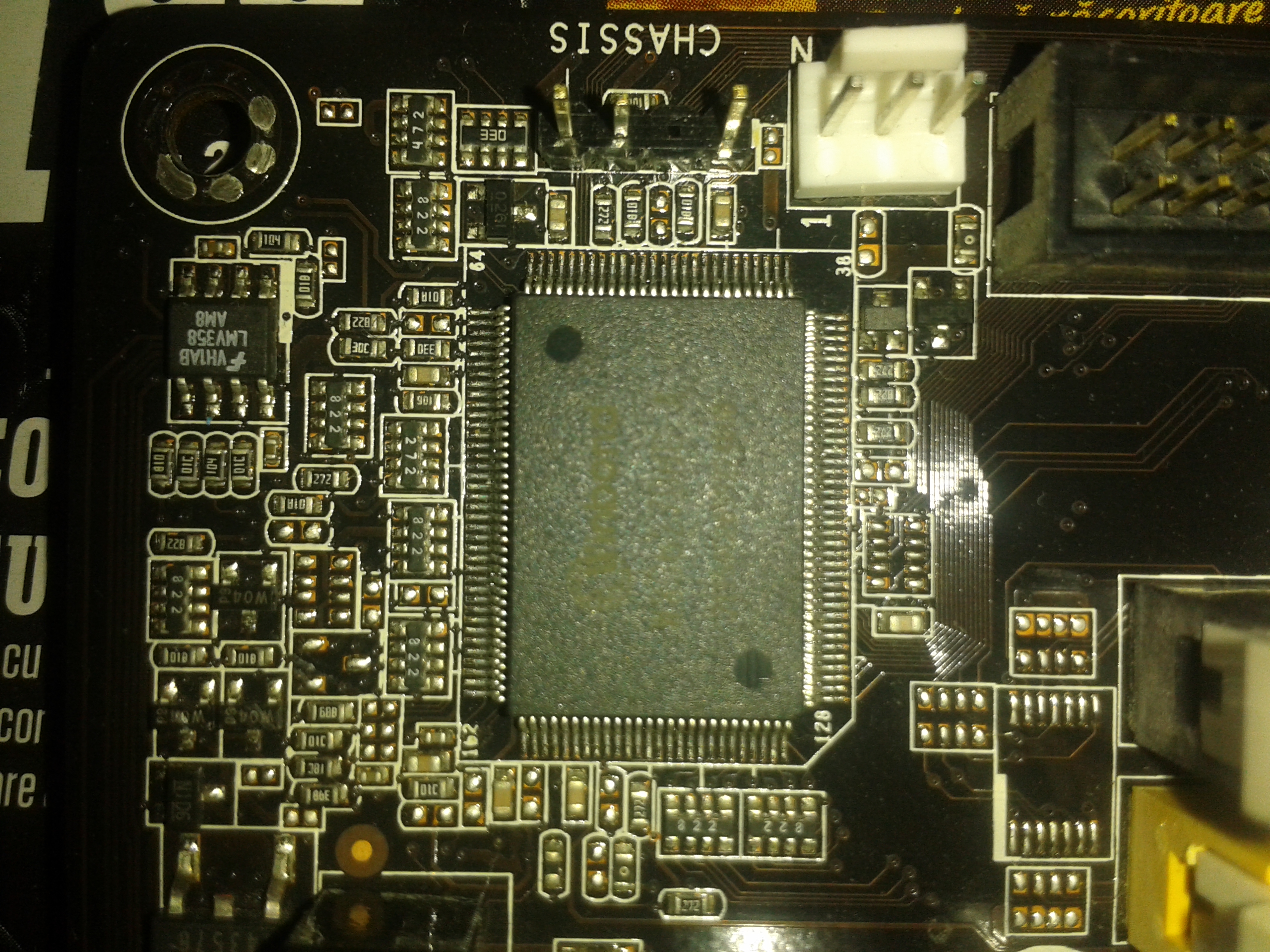

    https://www.dropbox.com/s/ibhv2svdt6...35.22.jpg?dl=0

      Re: [HOWTO] Fix/Repair "Chassis Intruded Fatal Error System Halted" on Asus P5QL
      Ok that's a good pic. With the board powered ON, measure voltage at the CHASSIS jumper. Find the pin that has somewhere between 1 volt and 3.3v. Could be anything in that range.
      Once you found it, turn all power OFF and unplug the power supply, and set your multimeter to beeper. One probe goes to that pin you found with the voltage on it, and with the other probe measure on the little 3-pin transistors around the Winbond chip. You should find one that beeps on the single pin at the top, which would be the collector or drain.
      Return with these results and i will try to help you further.

        #43
        Correction - the drains are going to be wired to the pins of the Winbond chip. You should check continuity from the chassis intrusion pin to the gate, which is the first pin on the left, on the side where there are two pins.

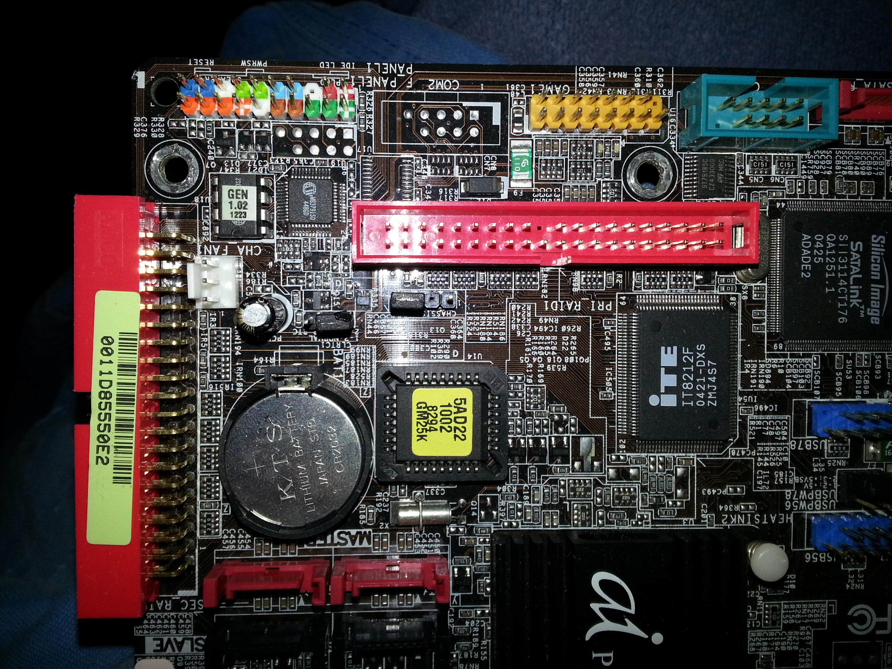

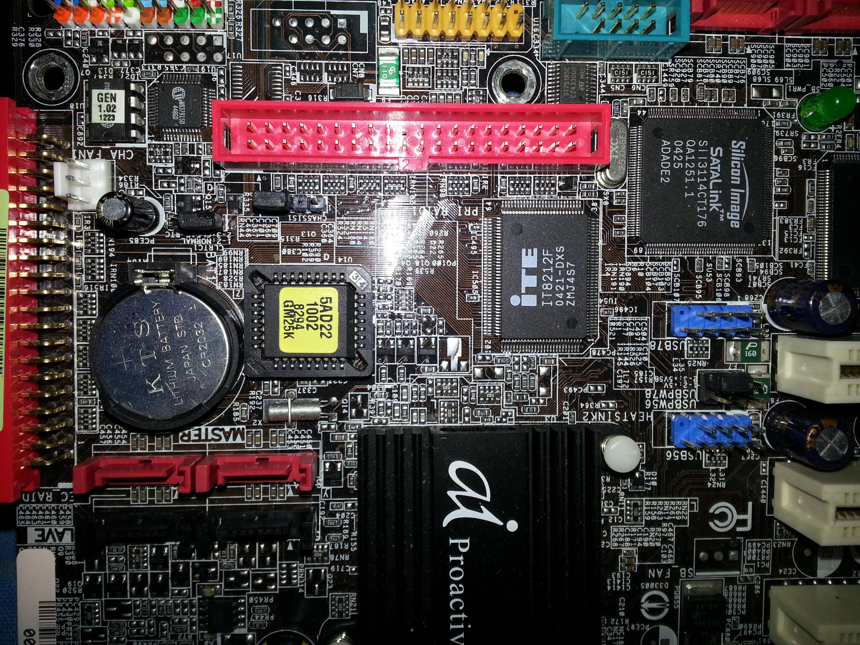

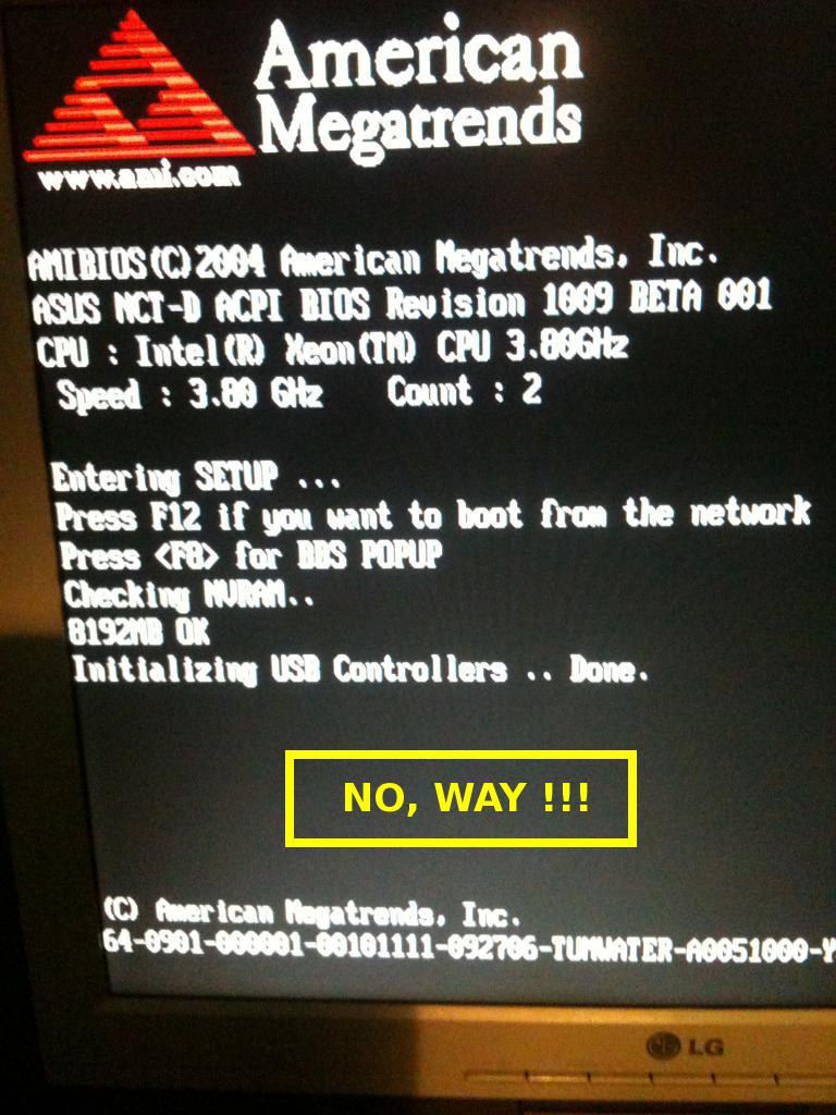

                #47
                Hi Th3_uN1Qu3 !
                Following your directions I was able to boot an Asus NCT-D motherboard, thank you.
                With power ON has been measured 0.7 voltage on pin 2 of chassis intrusion detection jumper, found the same voltage on the drain of one of the seven SOT-23 NPN transistors and the same on a pin of the VIA IO chip. After the complete removal of the transistor I've found zero voltage on the IO chip pin. After three days of intense benchmarking no problems still has been found !
                to Th3_uN1Qu3 !!!
                  #48
                  good job!

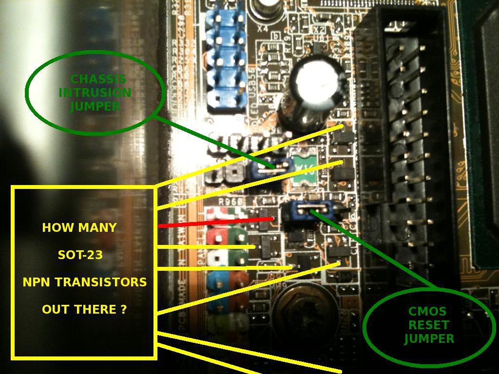

                                          Just finished fixing this one. Apparently, this is a common issue with all Asus P5 series boards. I first assumed it's a bad BIOS flash or corrupt CMOS settings, as it would go away once after resetting CMOS, but upon the next reboot it would be there again. Same if i changed any BIOS settings and saved them.
                                          I read that people have flashed BIOSes to no luck, and someone pointed towards a transistor on another (older) board, so i proceeded to look for a hardware issue. And i found it. See attachments for fix.
                                          Instructions:
                                          1. Follow directions in pictures
                                          2. Clear CMOS
                                          3. Power board up, redo all BIOS settings
                                          4. Be happy and have a cold one.
                                          This should apply to *all* boards that exhibit this behavior, obviously the parts may be in a different location. Follow these directions to find it if your board differs:
                                          1. Remove jumper cap from chassis intrusion connector (if you're reading this, you already found it's of no use anyway).
                                          2. With the board powered ON, measure with your voltmeter and find the pin of the chassis intrusion switch connector that has somewhere between 1.7v and 3.3v on it.
                                          3. Disconnect board from PSU.
                                          4. Use continuity tester function of your DMM and probe on the SOT23 transistors next to the super IO controller, you should find it beeps on one of them.
                                          5. Power the board back ON and find a 3.3v supply nearby
                                          6. Power board OFF, remove transistor, solder drain connection (it's gonna be the single pad, just like it looks in the picture) to 3.3v supply.
                                          The rest is the same as above.
                                          I'm also going to tell you what causes the issue to appear in the first place in a follow-up post.
