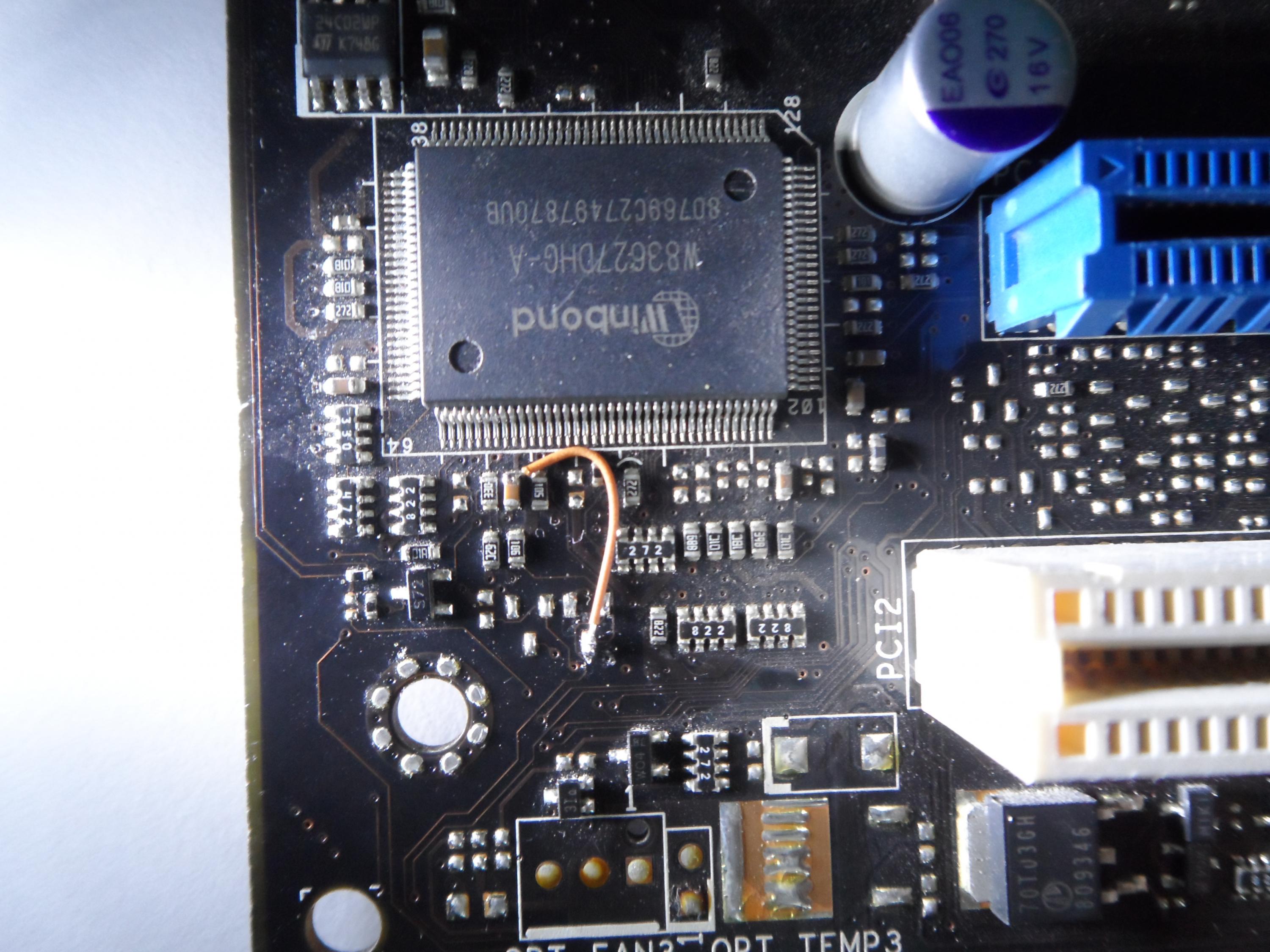

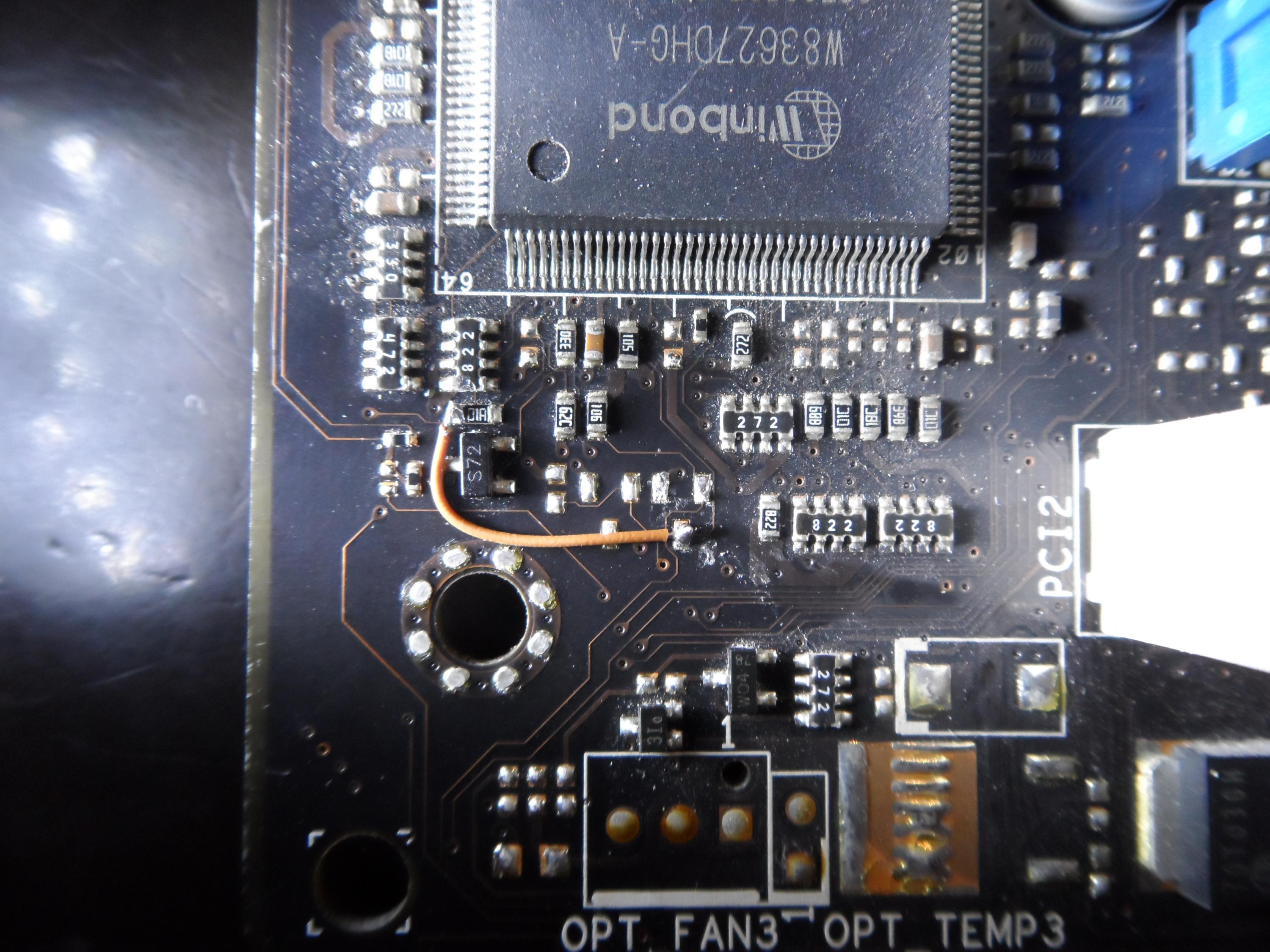

          Re: [HOWTO] Fix/Repair "Chassis Intruded Fatal Error System Halted" on Asus P5QL
          This helped me fix my Asus P5E deluxe. It also had the Chassis Intruded fatal error. Took me only a few seconds to find the right transistor, thanks to the directions.
          It's not perfect yet. Is it possible that my 3.3v point comes on too late? If I do a cold boot it gives me the error, but when I reset everything is fine.
          Anyway, I wanted to say thanks and give people looking for a solution for their P5E deluxe some directions. So I added a picture of the fix for the P5E deluxe. The transistor is located in the bottom left corner of the motherboard. Underneath the winbond chip.
            I see you pulled 3.3v from a resistor. Maybe that's part of some other circuit and it takes a little while to charge. Try finding a capacitor with 3.3v on it, that should charge up quickly (as it'll be directly across a 3.3v regulator) and it should work on a cold boot as well.
            The capacitors are the brown colored parts with no marking on them.
              Thanks, I'll find another spot and post the picture. If it goes into hibernation or sleep mode now, I can't get the computer to turn back on heheh
              Still, this is a lot better than Chassis Intruded: Fatal Error...
                I found a new spot, but it seems that I can't get my computer to wake up anymore if it goes to sleep, and also it doesn't want to turn off anymore. Could this have something to do with it? Should I just find an alternate point again?
                  Shouldn't happen. What happens when you try to turn the computer off? Do the fans remain spinning?
                  Try to clear CMOS again and also clean that area on the board well using isopropyl alcohol and a toothbrush.

                      #30
                      So, there we go... Thanks for the help Th3_uN1Qu3! Found a new 3.3v point, cleaned the board and reset the CMOS. Everything is working now.
                      In the attachment is my final solution for the Asus P5E Deluxe
