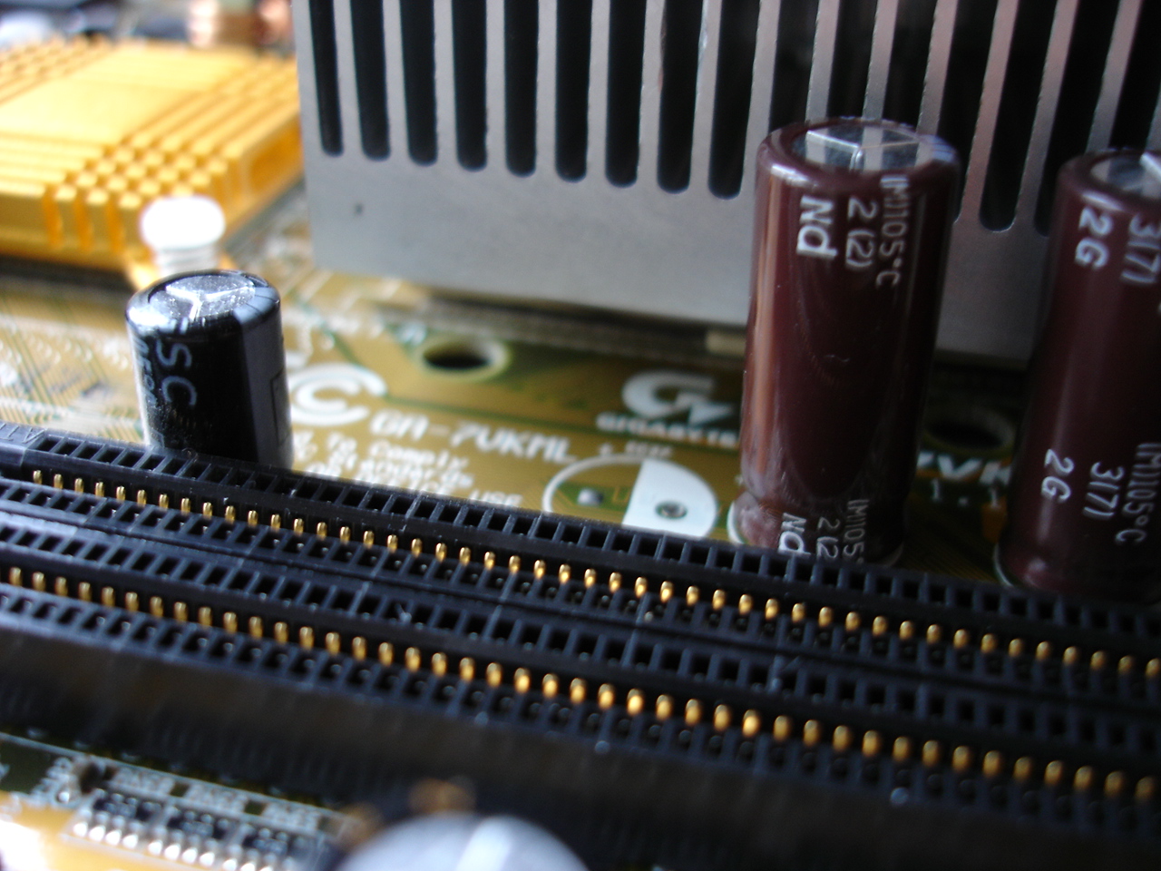

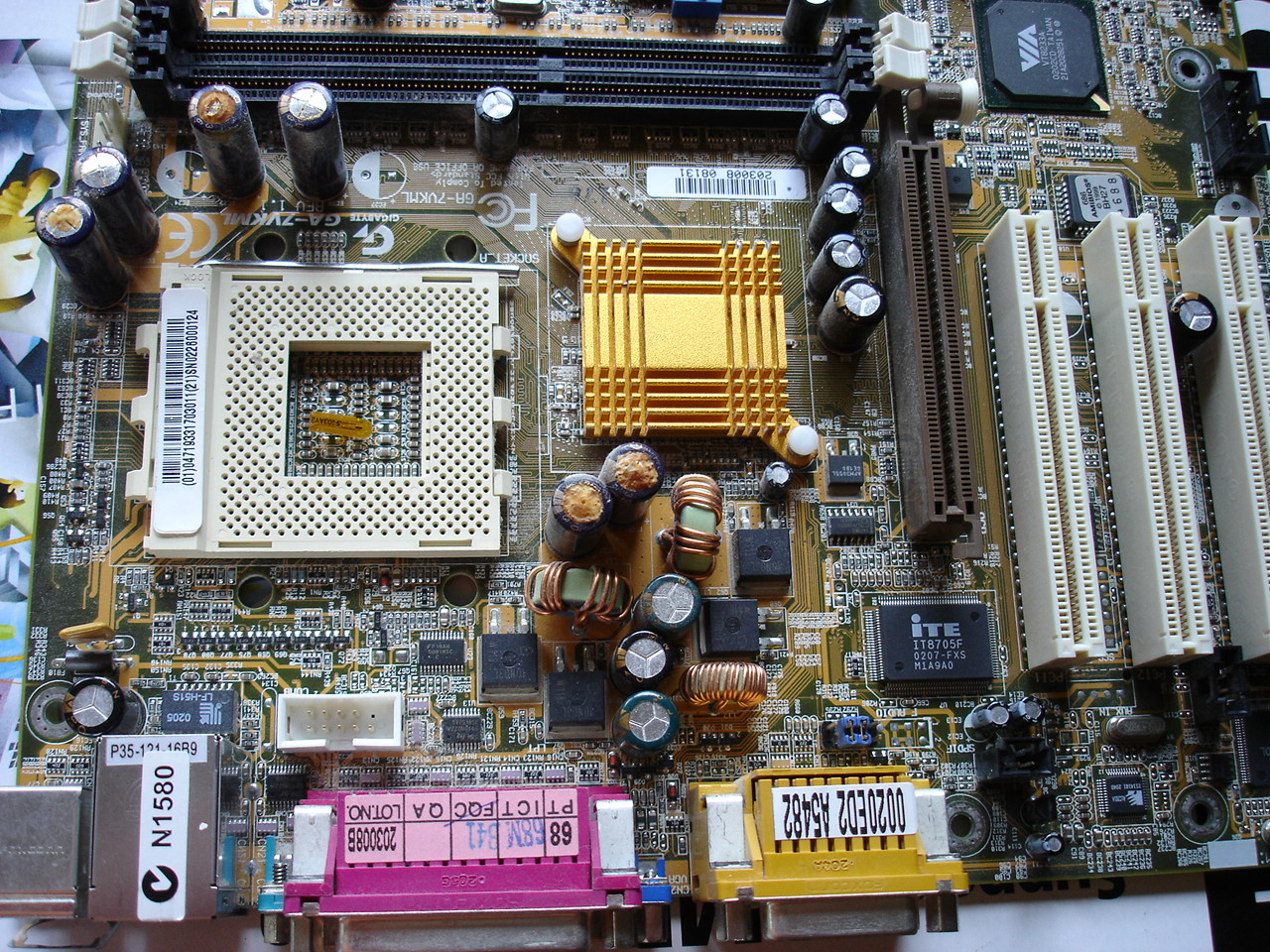

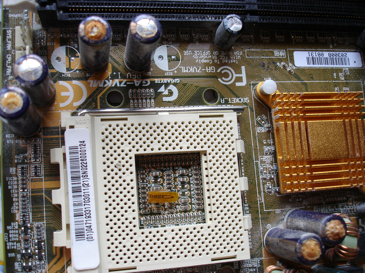

Surprisingly this GA-7VKML still worked with six GSC 3300uf capacitors in this condition, driving a Duron 1200
Gigabyte board works with GSC capacitors
Re: Gigabyte board works with GSC capacitors

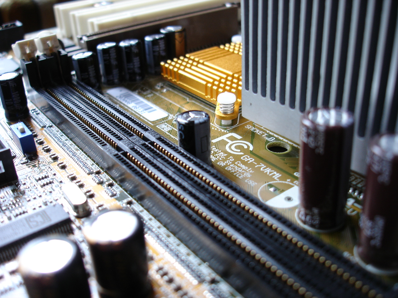

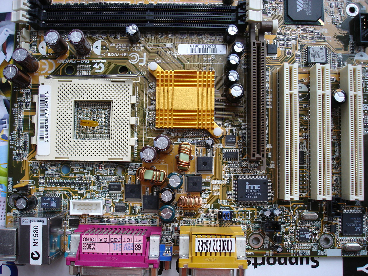

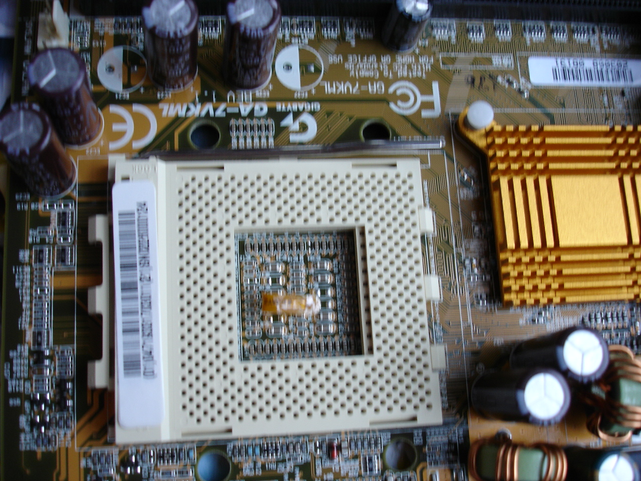

Hoping for longer life after replacing the GSC crapacitors with UCC KZG salvaged from a dead boardAttached Filesif you find these attachements useful please consider making a small donation to the site

nice you have missed some though. what is that one starting to bulge in the middle of the ram. i have seen some gigabyte looking like the first pic to fuck the ram also permanently eventually
well ok a memtest would be conclusive

More pics
I think it is deep vent stamping - no sign of bulgingAttached Filesif you find these attachements useful please consider making a small donation to the site

As I mentioned in an earlier 'bad caps irony' thread, caps don't have to be spilling their electrolyte out to have gone bad - they can fail silently and you would never know. On the other hand, you can have a whole load of caps fail inside a PC and it still remains stable - there was a PC at my workplace like that!Originally posted by pfrcomSurprisingly this GA-7VKML still worked with six GSC 3300uf capacitors in this condition, driving a Duron 1200
As a general rule though, when you find bad caps you should replace at least the bad ones as soon as possible. If the other ones are a known bad brand, it may be a good idea to replace those too to save you more work in the future.
I can't see any bulging or venting in the second set of pics, where you have replaced the bad caps. I have seen caps that look like they've caved in though, more often than not it's the result of a deep vent stamp (or physical impact, though that often causes similar symptoms to vented caps).You know there's something wrong when you open your PC and it has vented Rubycons...Comment
