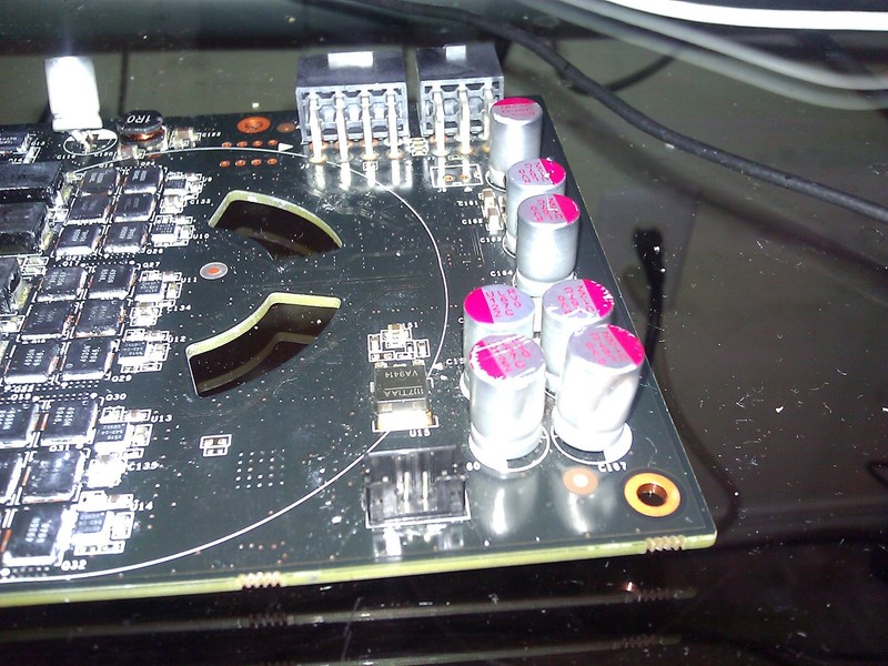

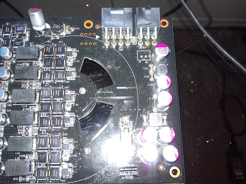

    I sold a graphics card with water block and the buyer returned it to me saying it was damaged in shipping. I packaged it extremely well and I can't understand how this happened.......:
    I am hoping to replace these dented ones and the pulled out one and have a working card.

    As for what caps to use, it looks like it has 270uF 16V polies on it. replace them all with these (http://www.digikey.com.au/product-de...018-ND/1136108) Nichicon LF series

      Thank c hegge, I will remember that with images. Thanks for the info, I will order those caps from Digikey!

          Are you sure that it is your card, does it have the same serial? Or did the buyer just take his broken card and return it to you? Something seems a little fishy, if you really had this packed properly.

            If that was packaged properly, there wouldn't be scratches on the capacitors, and no dents/pushed over caps too. I suspect foul play!

              Utter BS, dude. Don't refund this.
