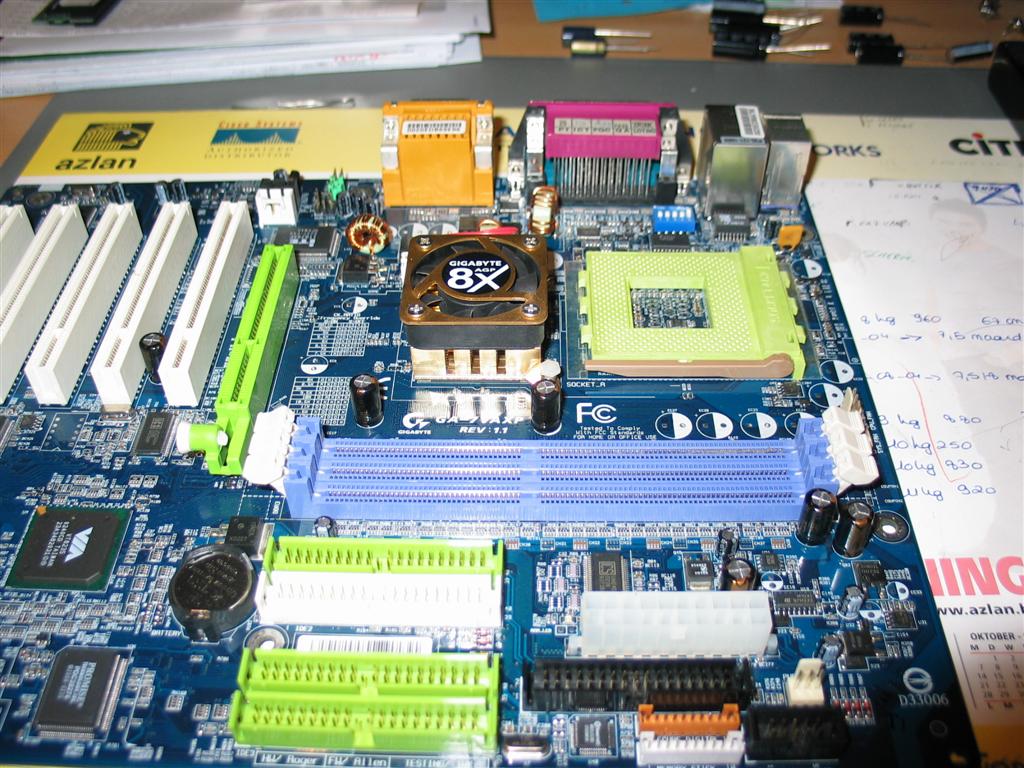

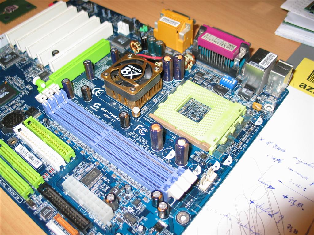

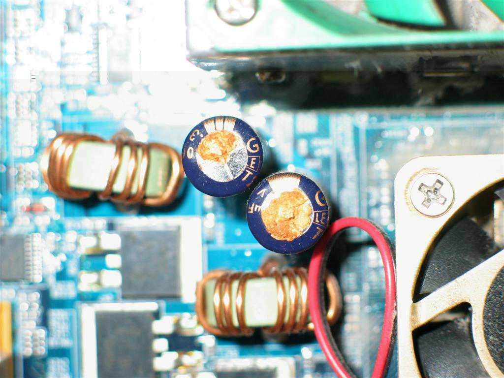

    I Have 2 of those boards failing on me the last 6 months (after 3 years of reliable service).
    Both have the same issue: the 4 GSC 3300uF caps are leaking from the top.
    I will recap this board but are looking for extra info:
    1. Do I only replace the faulty ones, or the lot of them (4 3300µf, dozen 1000µf (supacon), couple 1200 µf (Choto?), 3 1500µf (supacon).
    2. The board has room for 5 more capacitors in line with the 3300uF. Do I better install caps in these also. If so, what capacity?
    3. I seem only to get hold on panasonic FC type elco, which are 12.5 mm. The GSC are 10mm. Do I stick with 12.5 or go for the 2200uF 10mm?
    Thanks in advance

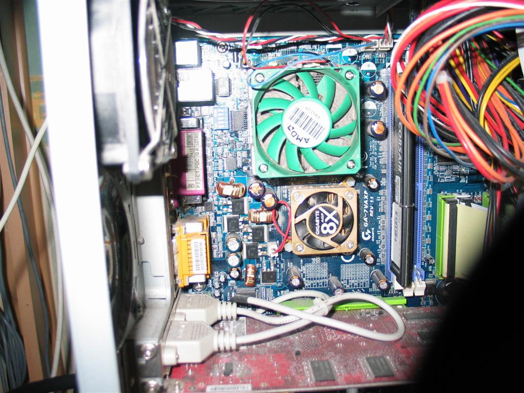

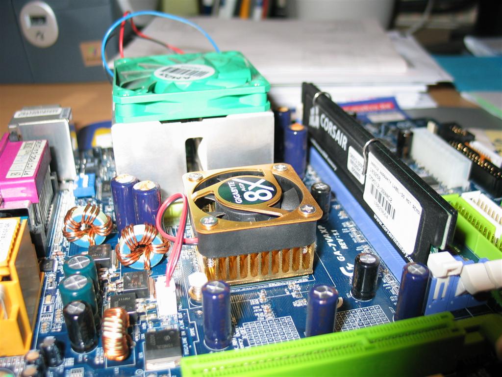

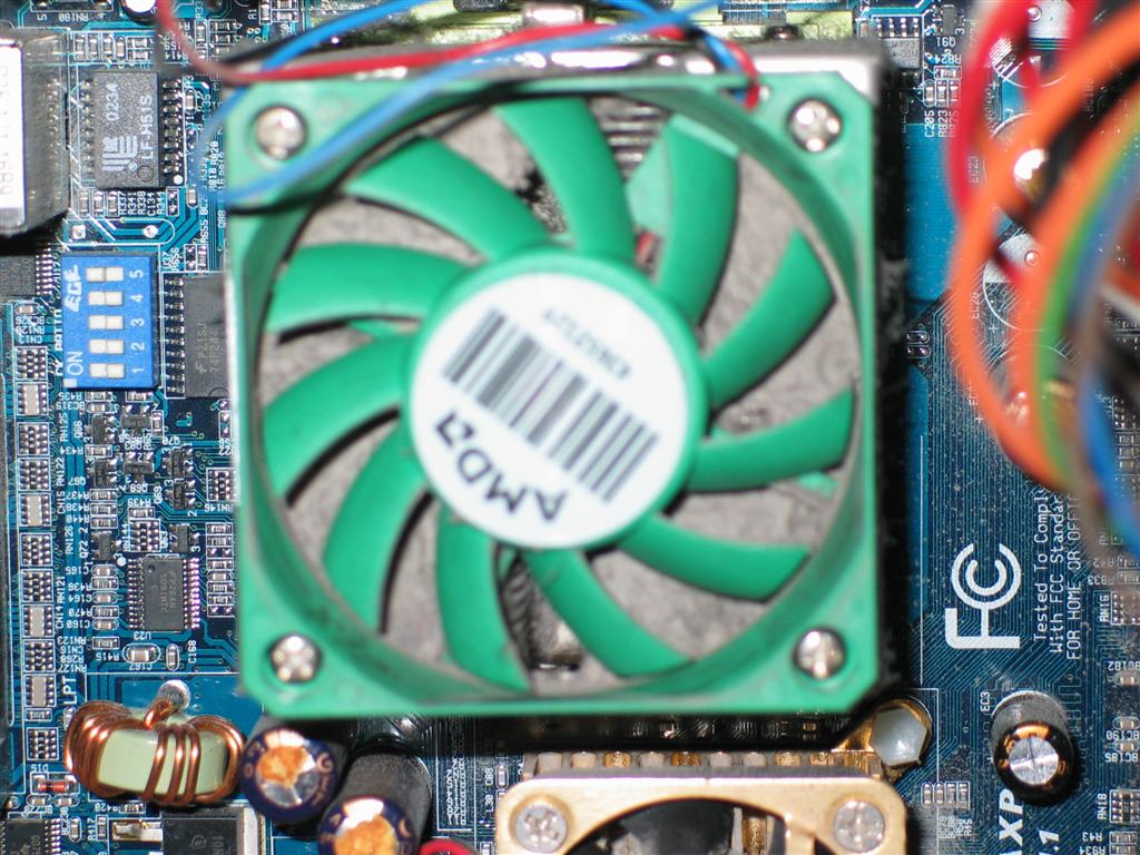

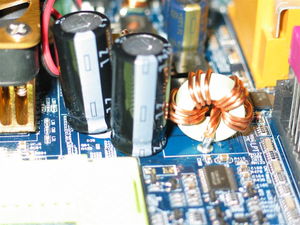

    Re: GA-7VAXP rev 1.1 - recap advise needed
    Here some pics, don't look at the cpu cooler....
      I dont know about adding additional caps, but trust me and replace all the capacitors at once. If you do not then you will be removing it from the case every 4 months replacing the next round.
      • Rainbow
        • Aug 2005
        • 1374
        Replace all the GSCs and Choyos, probably Supacons too. And clean that heatsink/fan.
        • davmax
          • Dec 2005
          • 899
          Re heatsink. Remove the CPU fan (four screws) and use a paint brush to remove fluff and dirt from fan and heatsink fins. The fluff often means the computer is near carpet, try and keep away from carpet. Ideally once you have loosened dirt on to the motherboard the dust needs to be blown off or vacuumed. Never leave the power lead connected to the power supply of the computer when working on it.
          If the caps are gone on the motherboard they may also be bad in the power supply. It will need a clean as well.

          • Rainbow
            • Aug 2005
            • 1374
            When a heatsink is really dirty, I wash it. Of course removing the fan before.

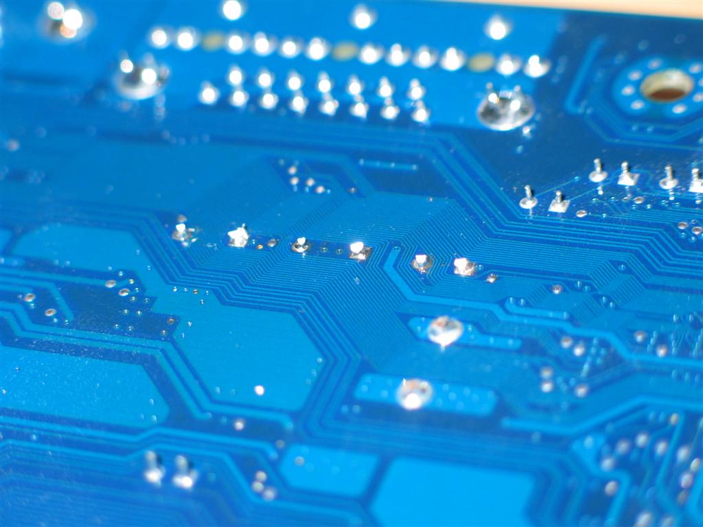

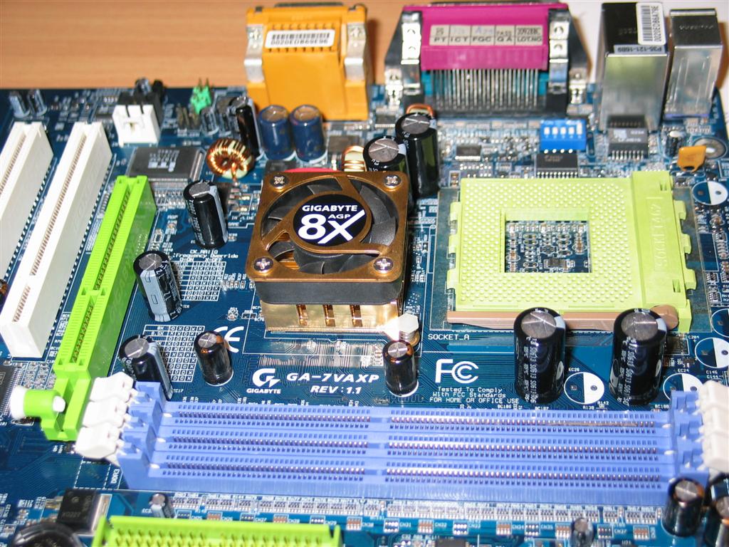

                      • jsteenbrugge
                        • Jul 2006
                        • 7

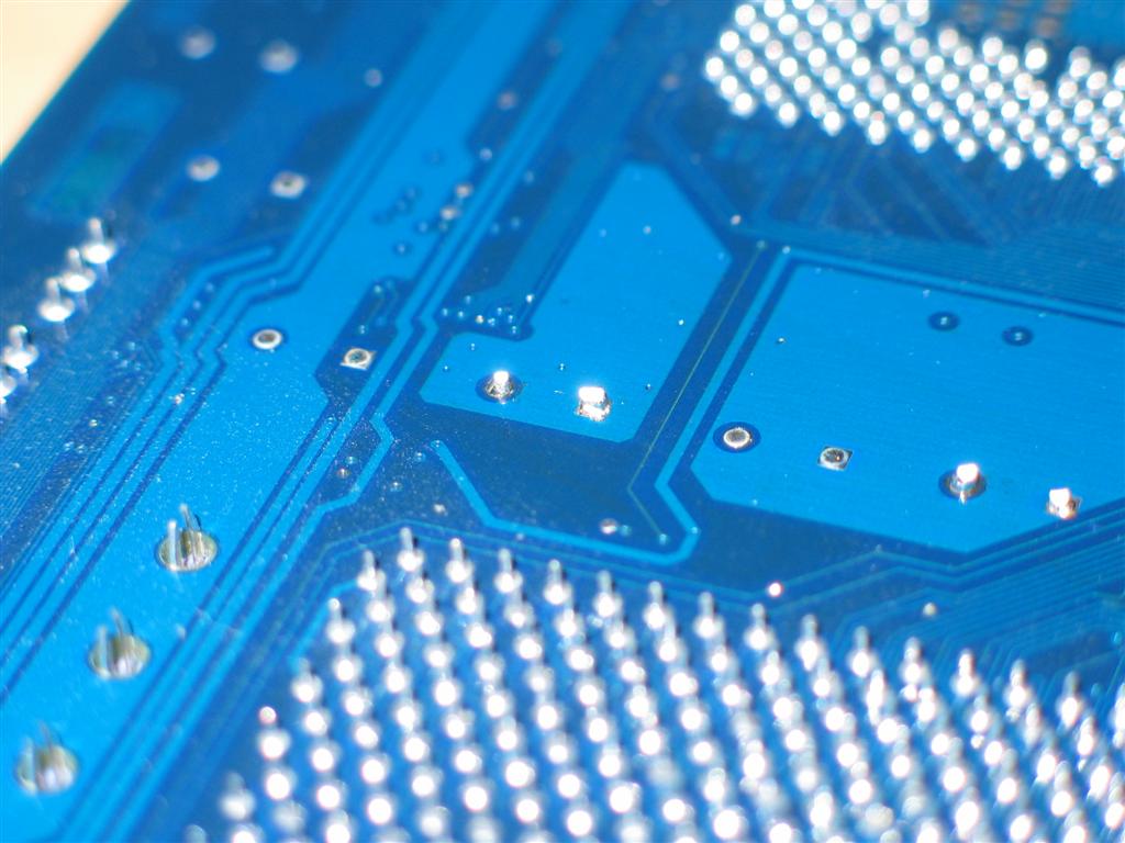

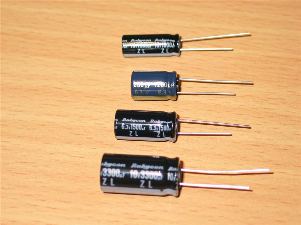

                        Got my capacitors today by ups:
                        - Rubycon 1000uF ZL
                        - Panasonic 1200 uF FC
                        - Rubycon 1500uF ZL
                        - Rubycon 3300uF ZL
                        Used my 40w Weller soldering Iron. In no time the caps were out.
                        I do not have andy kind of desoldering tool (except those mechanical pumps) so putting new caps in the board required some wiggeling.
                        System is running for an hour now (was 2 minutes in the past). Will test by running full virus scans and stuff like that.
                        Some pictures to see the result (it's my first mobo recap)
                        I had to bent one capicitor quite a bit to squeeze another one in between it and a coil, that was the difficult one.
                        Thanks for the replies
