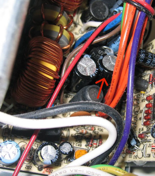

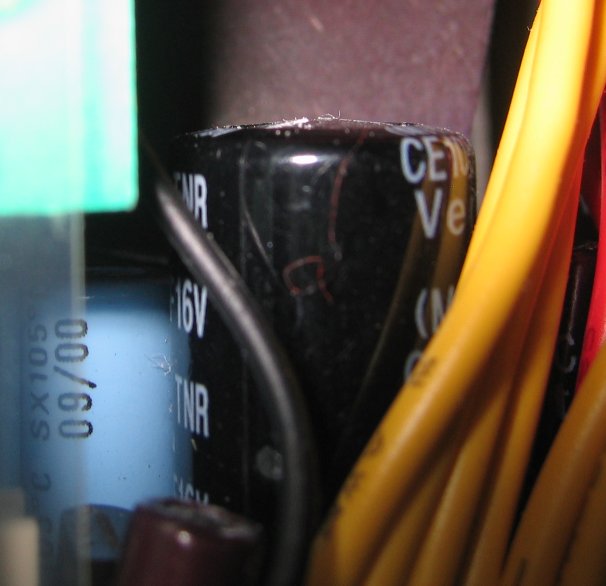

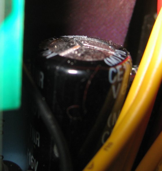

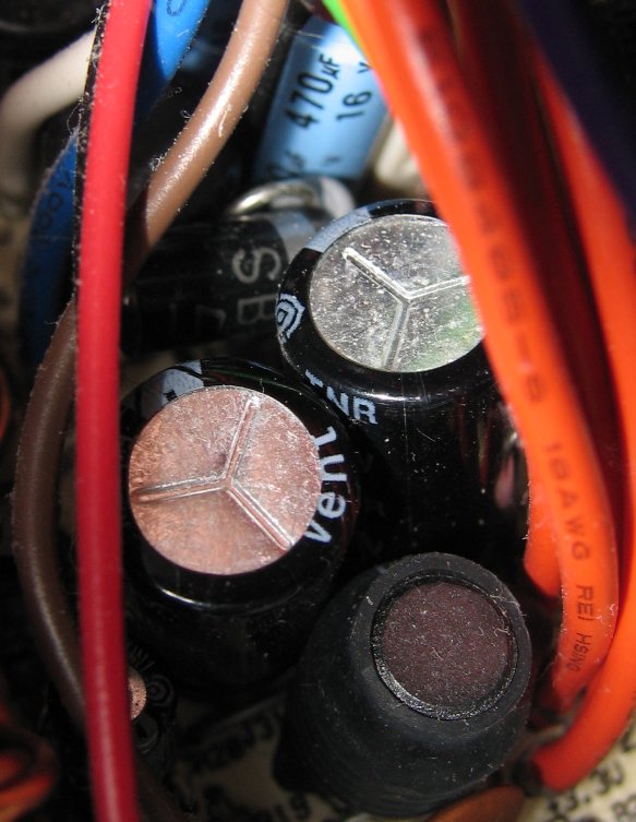

      Well, I looked inside the PSU and found a cap that appears to be bulging slightly, but not spilling any electrolyte (yet). It's nowhere near as bad as the work PC I posted pictures of earlier!
      Another cap in the PSU is pointing at a weird angle, but is not bulged. Perhaps it blew from the bottom? Both caps appear to be made by Fuhjyyu, a known bad make
      I also turned the PC on with the PSU all opened up (dangerous, yes, but fun ) and heard the 'hissing' sound again. However, it appeared to be coming from the transformer rather than the capacitors - I assume it's just the transformer windings vibrating.

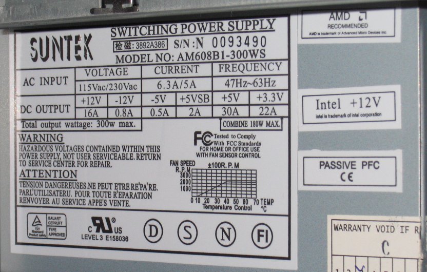

      The first two pictures show the bulged cap, from two different angles. The next two show the pointing-wrong-way cap, arrowed on the second pic. Finally I've also attached a picture of the PSU label, so you can see the specs.

        The first cap is definitely bad. The second may or may not be, but as you've stated, both are on the badcaps list. Why not take the opportunity to replace everything 470μF and up while you're at it? You can do it now, or wish you had later, when more of the Fuhjjyus give up the ghost. Caps for a power supply (doing everything {except the primary filter caps}, not just the majors) is only about $5 plus shipping.

          That "SUNTEK" power supply was made by ACHME CORP (done a search of the UL File number) and that company is in Taiwan. Either replace the power supply or recap it.
