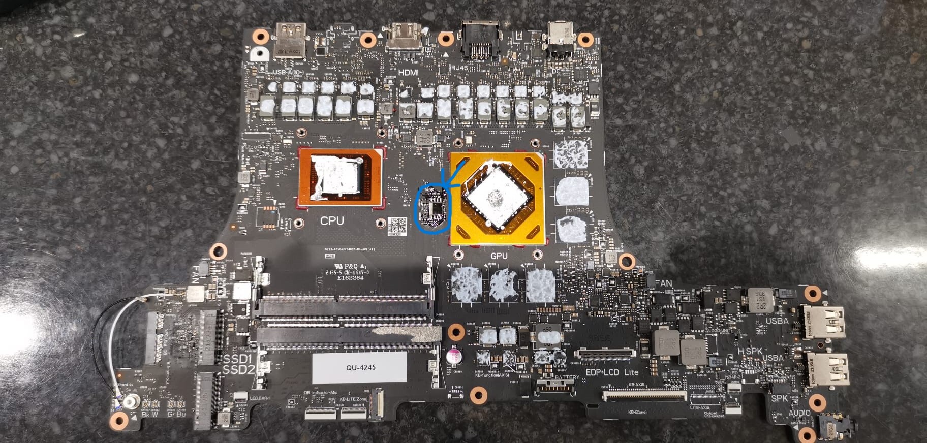

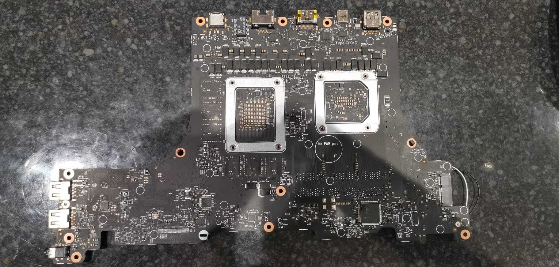

            The file that you uploaded it's not the main laptop BIOS, it's just the VBIOS for dedicated graphics card on your motherboard (RX 6800M).
            If you post high quality photos of your motherboard from both sides, then I'll try to help you locate the correct BIOS chip on this board.
              Regards
              Hi, thank you for your help. I've circled in blue the area where the chip I took off was... so makes sense it was a VBios chip... If you need to see better a specific area of the board, let me know and I'll upload close ups. I'm aware the quality of the pictures isn't great but that's the best I can do with the full board in view.

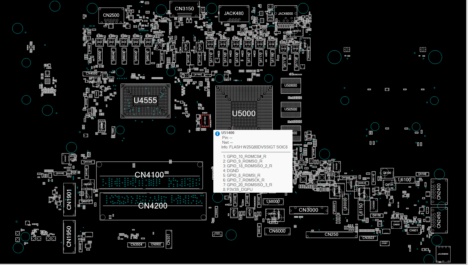

                this bios vga Click image for larger version

                  Any chance you could share your boardview file? That would help me locate the main bios chip. It would be even better if you also had the schematics...

                  Looks like BIOS chip is that one on picture below. Could you post markings of that chip?
                    This bios chip
