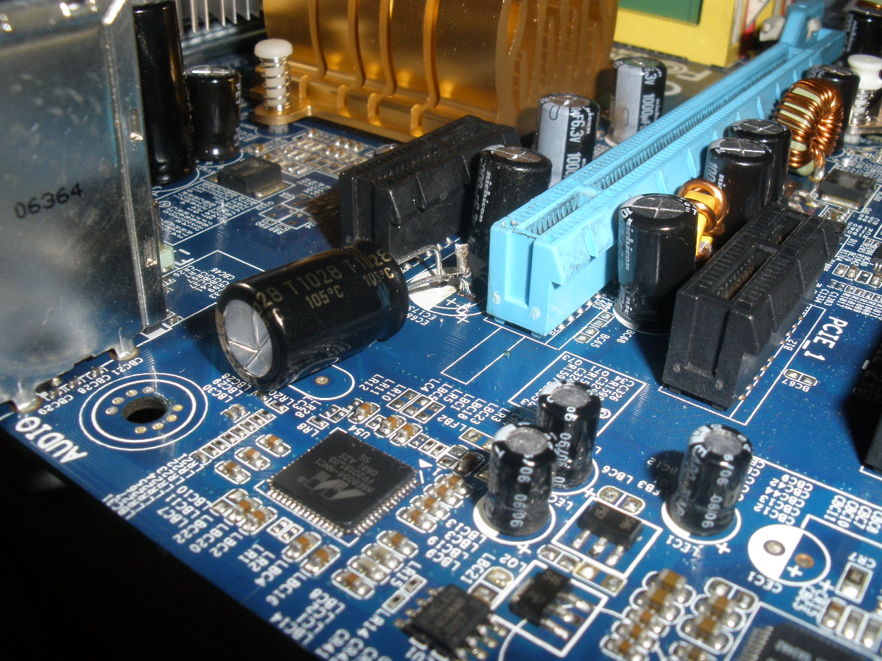

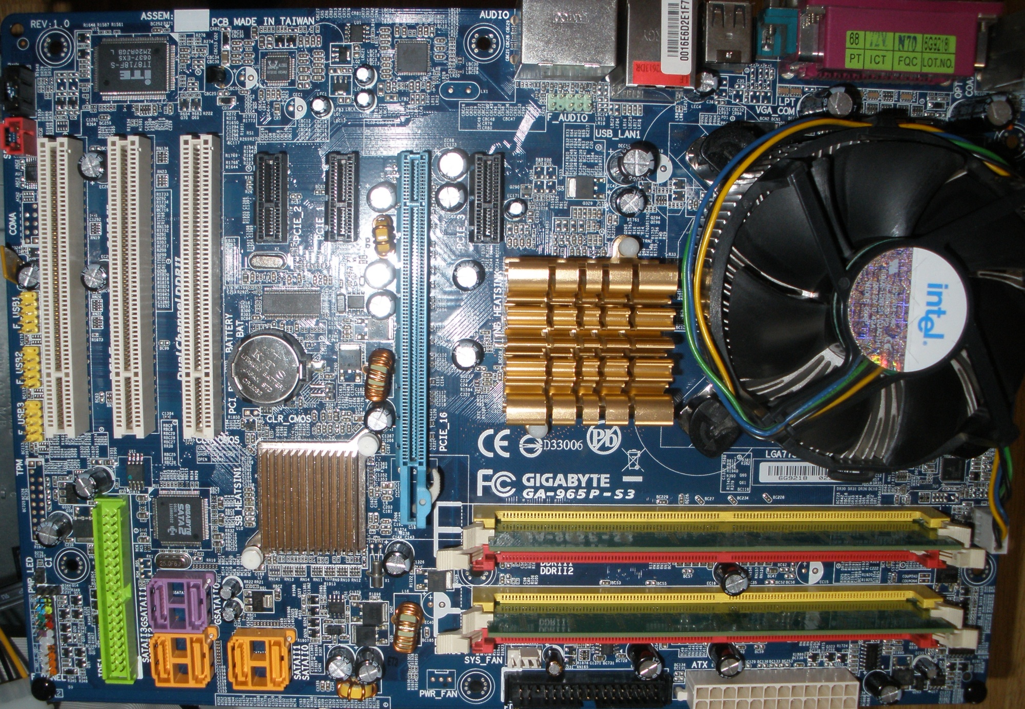

    For GA-965P-S3 REV1.0 (Doesn't apply to ga-965p-ds3 which has solid caps.)
    The mainboard had history of overheating, the video card is with passive cooling and SB got very hot, this could speeded up the failure.
    Firstly the Intel SATA ports failed first and the HDD controller reported intermittent errors in event viewer and PC sometimes locked. Temporary it could be fixed by plugging HDD into GSATA ports. But after couple months the PC didn't boot. Inspected the board visually and found two blown caps(didn't check the brand)
    Replaced the 2 blown caps(DEC11, DEC12) 6.3V 3300uF. After that PC could be booted but only after powering on/off 2 times everytime. Now again it doesn't boot. The symptoms: the CPU cooler works but no POST beeps - nothing. What else could be at cause?
    Other caps on board:
    16V/1500uF Rubycon (MBZ) 4x
    6.3V/1000uF Nichicon (HM(M)) 20x
    16V/470uF KZG 1x (gigabyte - why put different brand for 1 cap?)
    10V/100uF TEAPO (A3) 7x
    16V/100uF can't see ends with E...con (E67F) 1x

    Nichicon HM with 2001-2004 date codes are defective due to manufacturing goof.
    Nichicon Date Codes.. in H0322 .. the "03" = year 2003 [and the "22" = week 22.]
    - Need to replace all of them.
    Chemicon KZG are bad and often don't bloat.
    Evercon are bad but a small one like that is less likely to be the problem than HM or KZG.
    - Probably don't -need- to, but I'd replace it anyway.

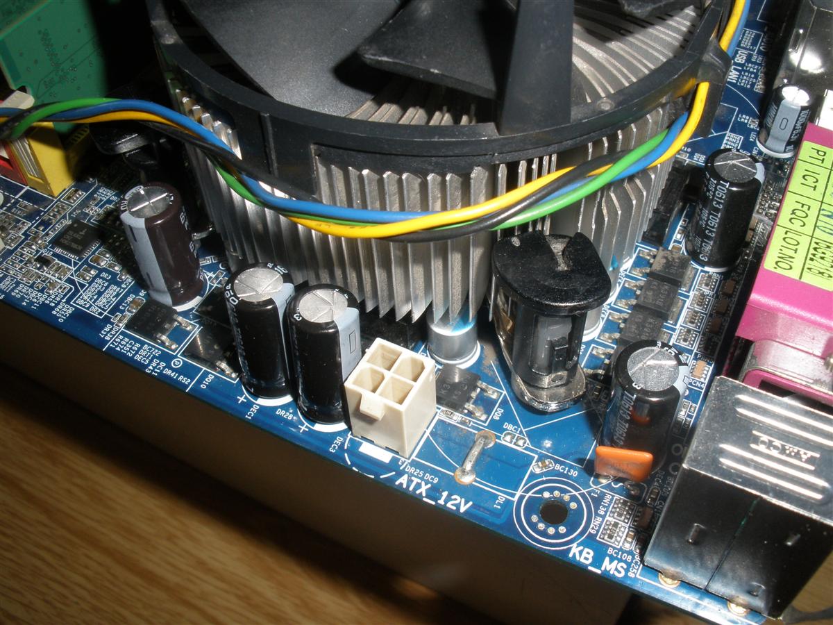

            its not the board that has a history of overheating, it's the processor. Pentium D is one of the most terribly overheating processors in the history of desktop processors. get a better heatsink on there, clean them up (heatsink bottom and cpu top), and put some artic silver on there (fine, thin layer, spread as thin as you can get it)
            were DEC11/12 near the CPU?.....the heatsink might not be transferring enough heat off it and the chip itself is overheating the board, and thus the caps (why those 2 probably originally bloated)
            go ahead and replace the KGZ's, thats your best bet, but I would also try an alternative CPU if you've got one, those D's draw some serious power and require some higher voltage, of a cap blew and was blown for a long period of time, it might have put too much current through the cpu vrm
            oh yeah replace the nichis too, I like Sanyo's, but Panasonics are just as good

              Yeah but North and South bridges were heating a lot too and the passive cooled VGA(one bad cap on it also) maked it even worse. I salvaged the broken PC at my workplace so nothing to lose. The bad caps was around CPU of course. Reapplied the thermal paste it was hardened like a brick, almost lifted the NB .

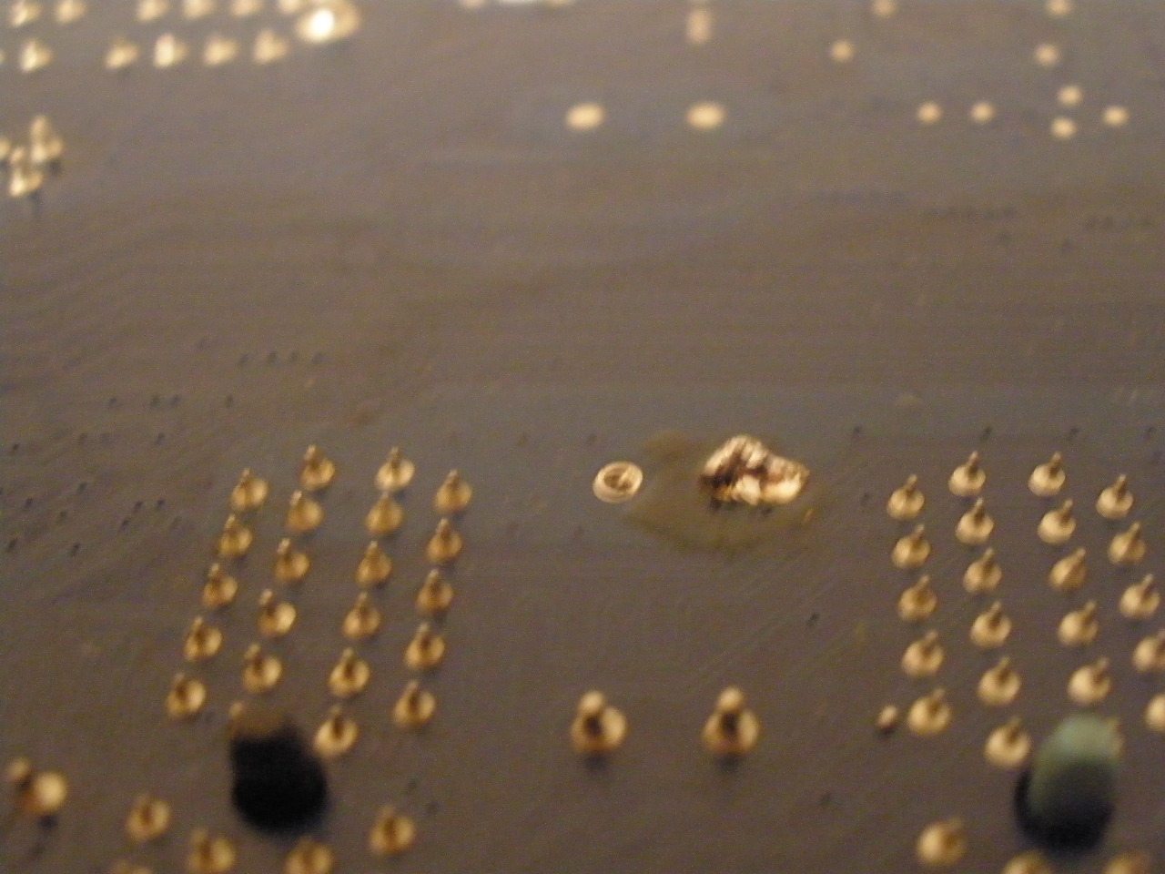

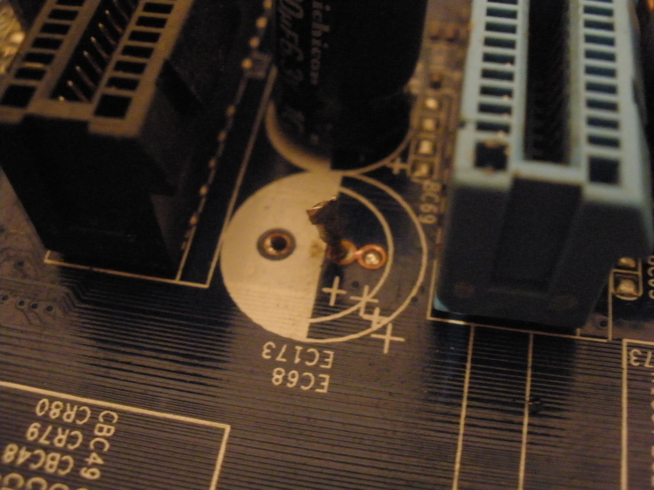

                      Resoldered all caps except Nichicons, there are too many of them and one naughty cap pissed me off. At first it didn't boot so I thought that I failed but after CMOS reset it was back to life. Now it works again .
                      There was one cap witch I couldn't unsolder correctly. It has two alternate mounting holes and it was impossible to extract it. Used 50W iron and 240°C temp is it not enought? Ended up with this.
