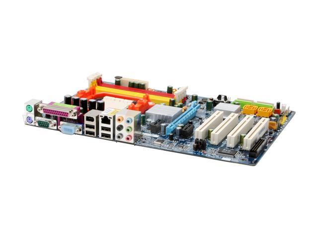

    My computer has failed for about a week now. I tried power supply replacement after finding that my computer would turn on then immediately off.
    After more troubleshooting and removing peripherals, I found that the computer would not stay on with the 12V ATX 4pin connected. My capacitors were bulging and they were shorted.
    I replaced (5) 3300uF capacitors 6.3V rating
    with
    (3) 1,000uF capacitors 10V rating
    (2) 1,000uF capacitors 16V rating
    While I know decreasing the capacitance is not recommended my computer has been stable for an hour. I plan on getting a new mobo, CPU barebones at the end of next month.
    Less capacitance means less time that the capacitor can hold the charge, these ones are meant to keep the power going to the CPU stable correct?
    I have a degree in electronics but it has been so long since I have had to use any of those skills.
    What exactly can using a lower capacitance rating do?
    Not be able to supply voltage for a certain duration when its needed?
    Discharges to fast?

    There is a large chance that they used so high capacitance values just to get the required ESR. Capacitor technology has progressed a lot in the past few years. If the board runs fine there's nothing to worry about.

      those 5 caps you mentioned seem to be on the CPU VRM output (the 5 black ones with the X vent above the CPU socket)

        Those are the five I had to replace. So they don't help control Vcore? edit: I think I figured it out, they smooth out the Vcore and they are in parallel

            I am concerned with that much difference
            you're replacing 16500uf with 5000. that bothers me. but if it works fine, it might continue to, for now

              Bulk capacitance is for smoothing transients but that is -NOT- why they used 3300uF caps there.
              They used those caps for low ESR and high Ripple ratings.
              It's doubtful 1000uF caps have low enough ESR to remove the ripple [means possible unstable system, reboots, BSOD, corrupted data, etc.] and also doubtful they have high enough of a ripple rating to not overheat. [means very short life for the caps.]

                Well it is just a quick fix. These caps came from a spare PC power supply I have so they should be good for ripple and heat.
                6 hours uptime now, with graphics intensive games occasionally. I am going to order the proper size.

                          I am not sure if these are 10mm tall or 25mm, the 3300uF Rubycon only come in 25mm tall.

                            A 3300uF cap must be tall, atleast 25mm if only 10mm thick
                            Just measure it but in the picture linked by Scenic they look to be 25mm tall to me.
                            I borrowed this pic from Newegg, seems that 25mm is correct.
                            Anything is ok so long as it clears the heatsink you use...
                            Btw, I'm surprised the thing works at all with the caps you put in, for sure it will not have a long life before it cooks those poor capacitors

                                Replaced the five short term fix capactors with.
                                Nichicon HZ 6.3v 3300uF 10X25mm - Ultra low ESR
                                Nichicon Part number: UHZ0J332MPM
                                Rated Voltage: 6.3v
                                Rated Capacitance: 3300uF
                                Capacitance Tolerance: 20%
                                Temperature Range: -25 to 105C
                                Rated Ripple Current: 4690
                                Diameter: 10mm
                                Height: 25mm
