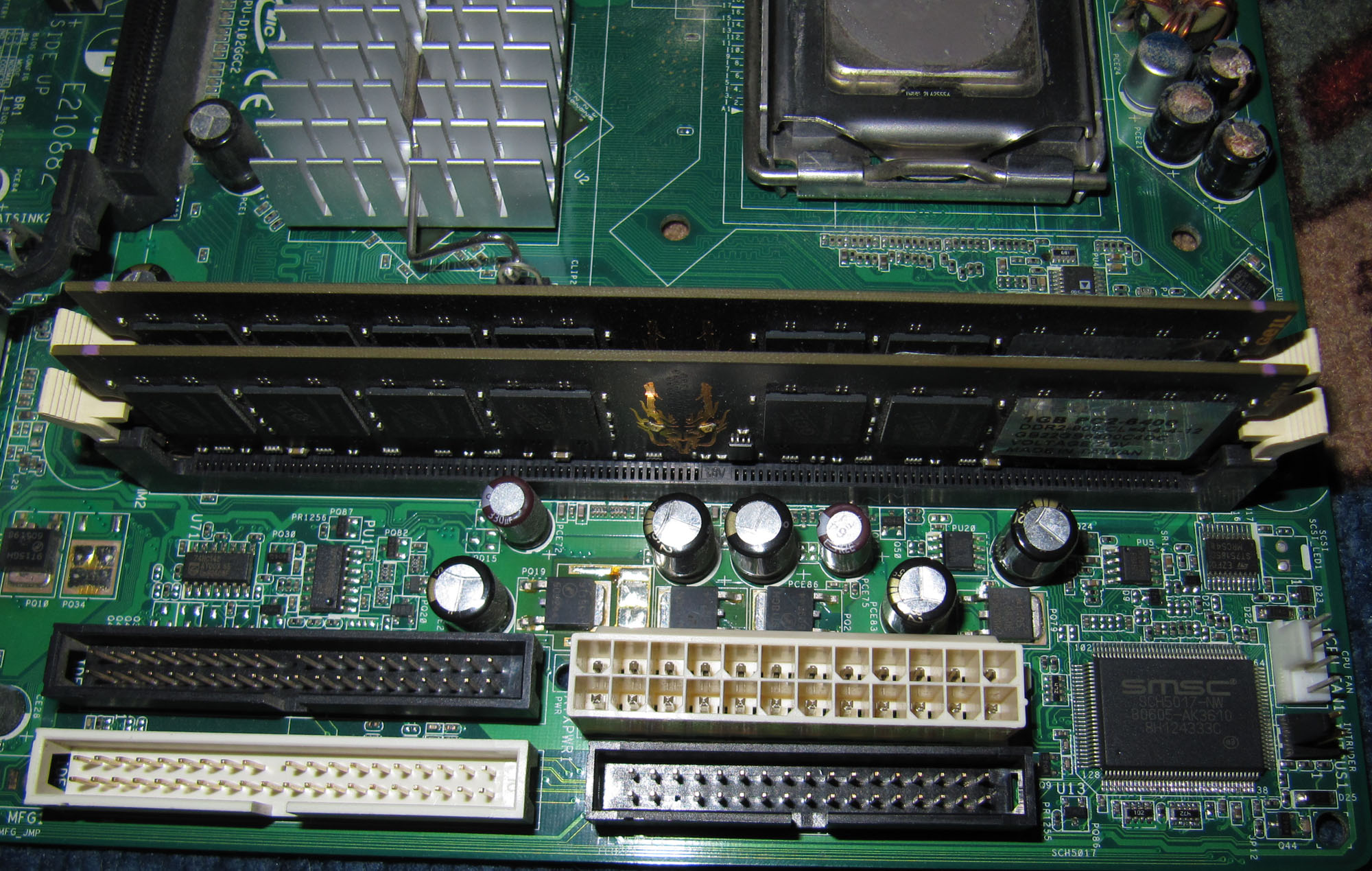

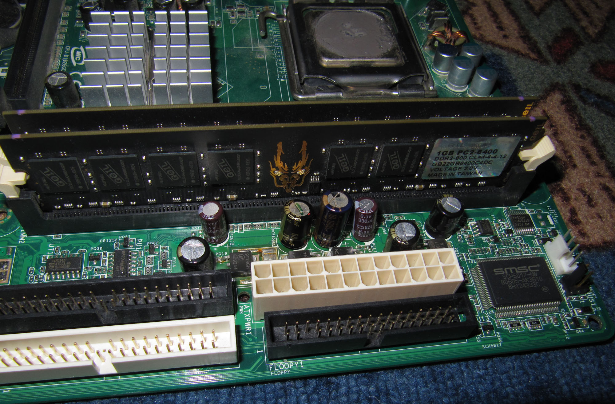

                          Hey, remember that board I recapped 5 years ago?
                          https://www.badcaps.net/forum/showpo...0&postcount=18
                          Well, this computer worked for years on a daily basis without a problem. I maxed the ram to 2GB (yes, this board cannot take 2GB DDR2 dimms..).
                          Several months ago I had some random BSOD, so I opened the case and found a bulging Rubycon MFZ. I can't blame the cap cause it was sitting under the LGA775 heatsink. I continued using compurer as a file server, then all the electrolytic capacitors on the CPU VRM out failed (3x Rubycon MFZ 680uF 4V 8mm). Computer kept working with some random BSOD, then it couldn't even boot Windows Xp
                          2 Panasonic FJS 820uF 6.3V 8mm capacitors bulged. I think those 2 caps are the VRM out capacitors for RAM.
                          I would like to find suitable replacement caps for MFZ. There is no datasheet available for them. Are they equivalent with MCZ? Another problem is that the replacement caps need to be no taller than the original or else they will touch the heatsink.
                          What a crappy design

                            Re: Emachines - Intel D102GGC2 board
                            I don’t know if it’s just the pictures, but the FETs (linear regulators, by the looks of it) by those Panasonic FJS look like they were running rather on the warm side. If a system of that age is worth it to you, I’d recommend polymodding both Panasonic FJS in that location and the 3 failed 680uF 4V Rubycon MFZs. As far as I know, Rubycon MFZ is supposed to be equal to Nichicon HZ.
                              Notice that the ram has 2 red leds right where the bulged caps are located. The airflow is blocked by the ram dimms and all this makes it a rather hot spot that cooked those FJs

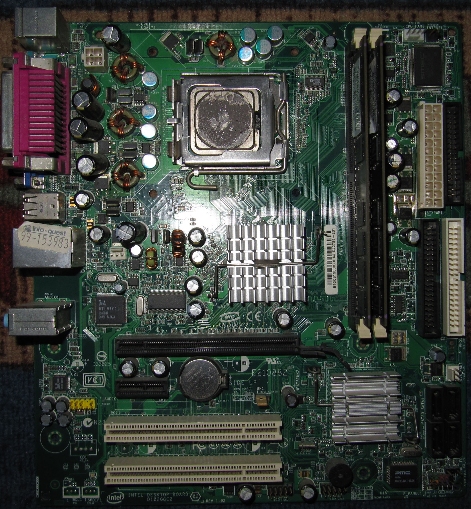

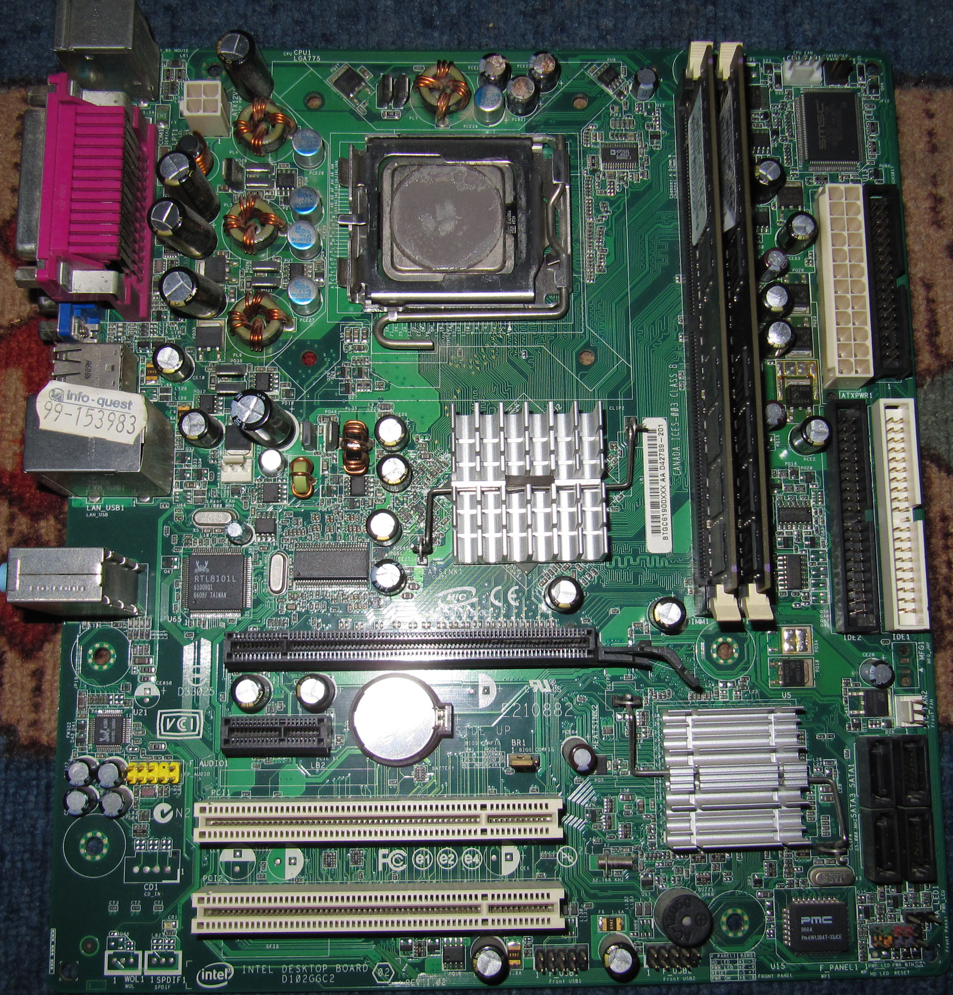

                                Recapped it and works like a charm!
                                Used 3x Nichicon NA 560uF 4V 8mm polymer capacitors pulled from a dead motherboard to replace 3x Rubycon MFZ 680uF 4V 8mm.
                                2x Panasonic FJ 820uF 6.3V 8mm were replaced by 1x Panasonic FJ 680uF 10V 8mm and 1x Rubycon MBZ 1000uF 10V 8mm.
                                  Nice, looks like the board has been really really toasty though!
                                  Also take a look at the VRM input caps (right by the parallel port).
                                  They look like they might be pushing their bungs out, as they are standing at odd angles...

                                    #37
                                    This was just me recapping that board years ago
                                    I tried to install the caps in a way that they don't get all the heat from the VRM mosfets and coils. Looks bad
