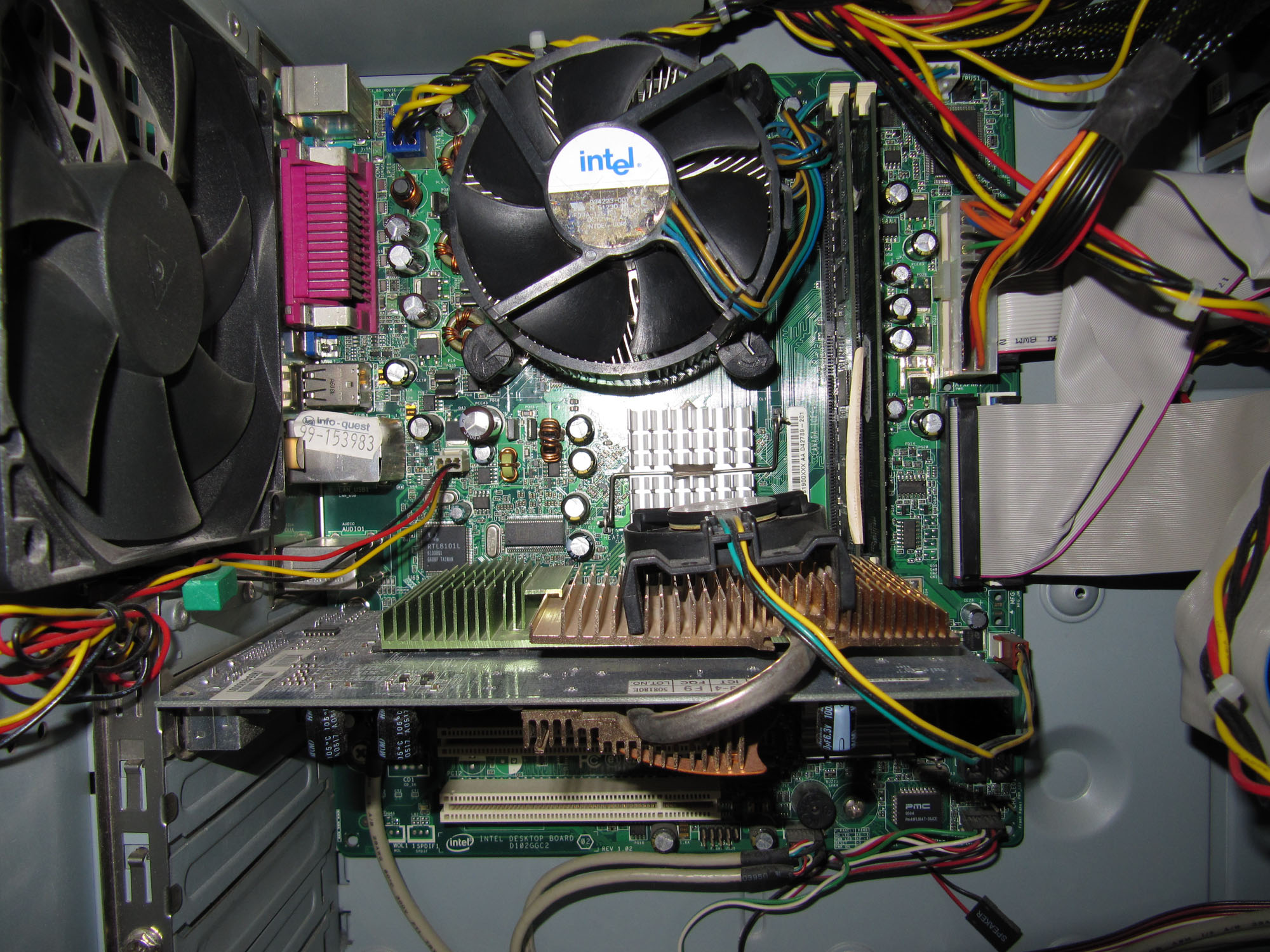

                I am posting from that board right now.

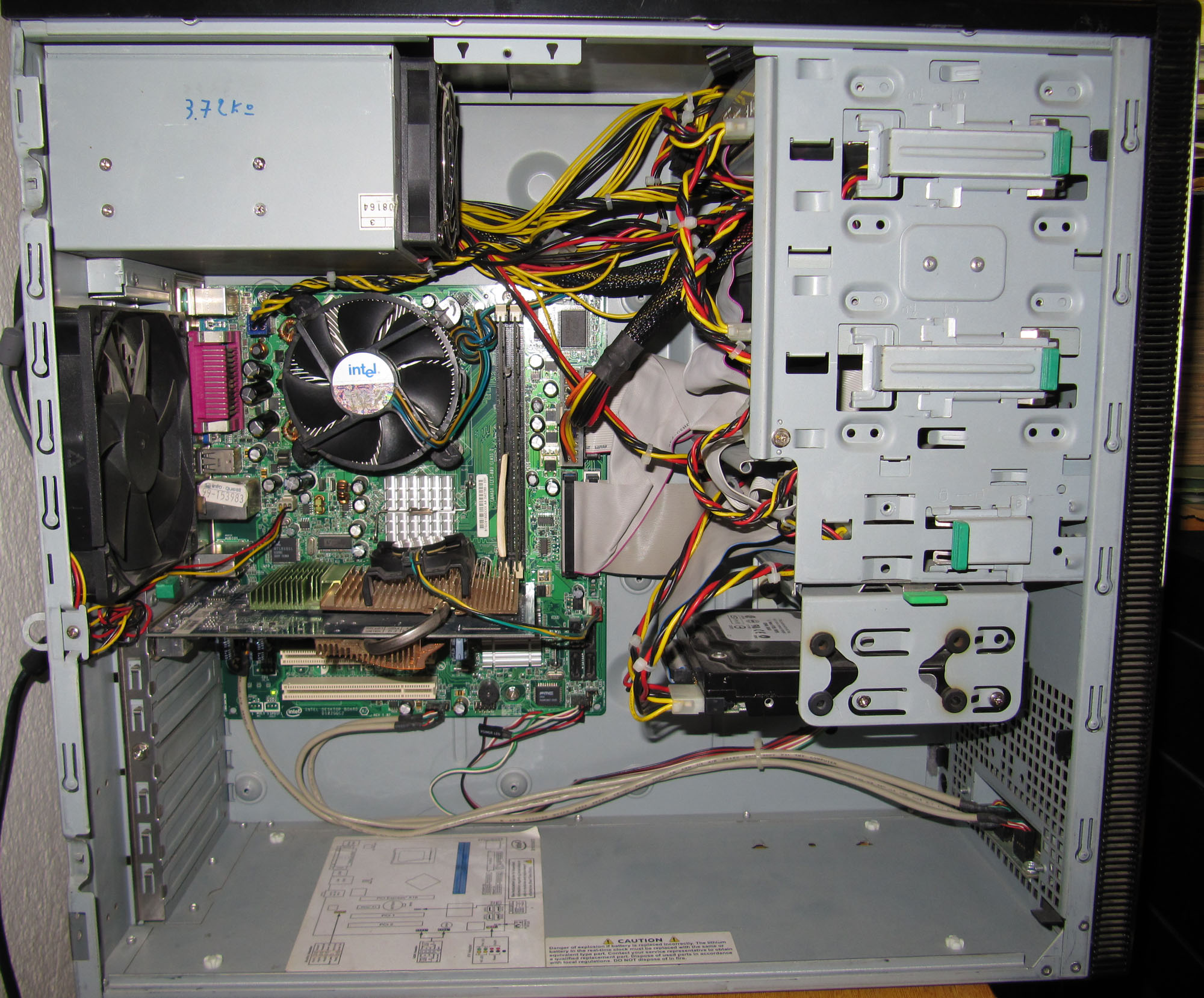

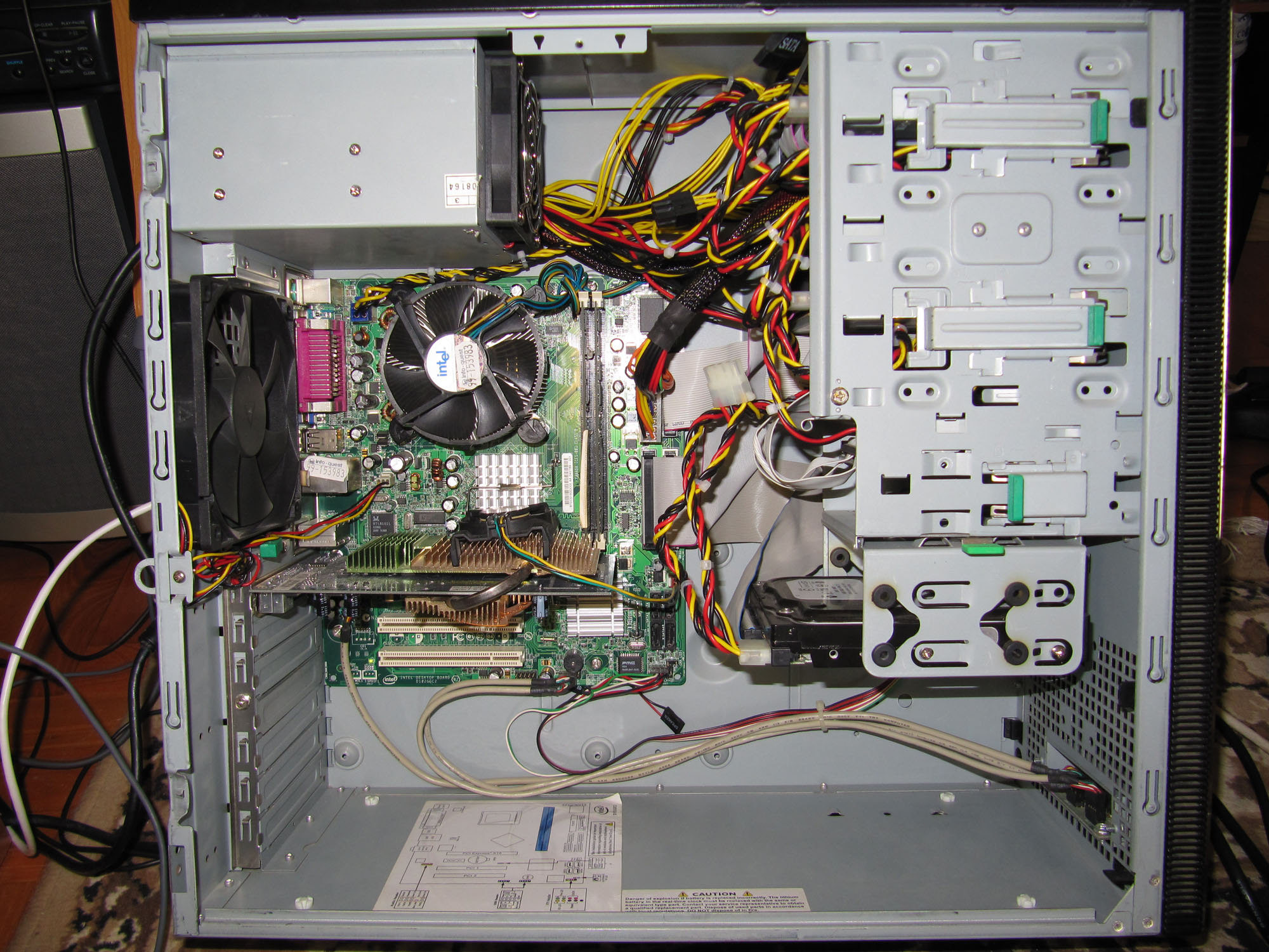

                It was a gift to me a year ago. It came with a nice black case, a P4 3.06GHZ HT, ATI X300 PCI-E, an LG DVD-RW and 512MB DDR2 ram.
                This is how it looks today. I added a Jou Jye 460Watt psu (recapped and modded), 80GB IDE WD 7200, 1GB DDR2 667MHZ, and changed the ATI X300 with a Gigabyte 6600 GTS.
                I am worried a bit about the KZGs but I am not comfortable with the idea of preventive recap on motherboards.

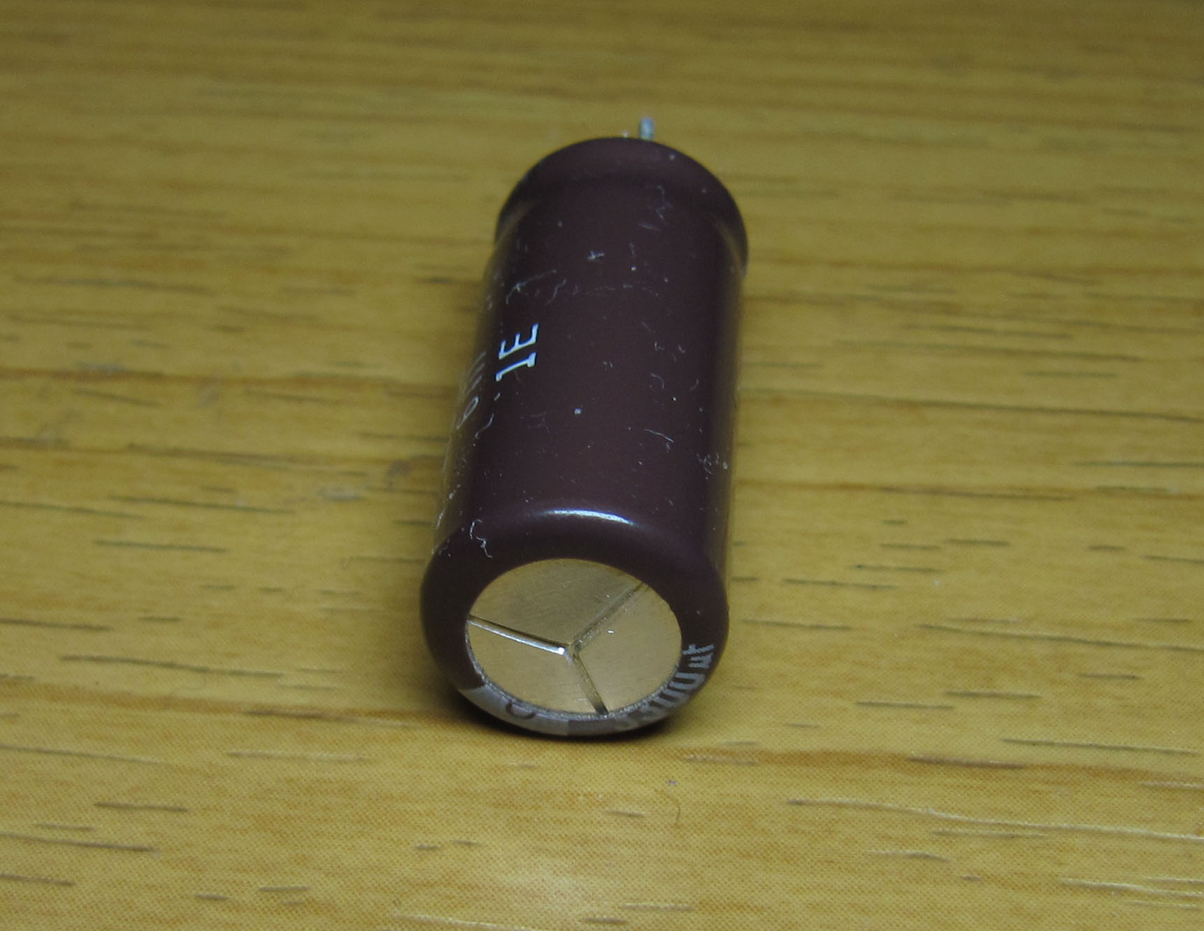

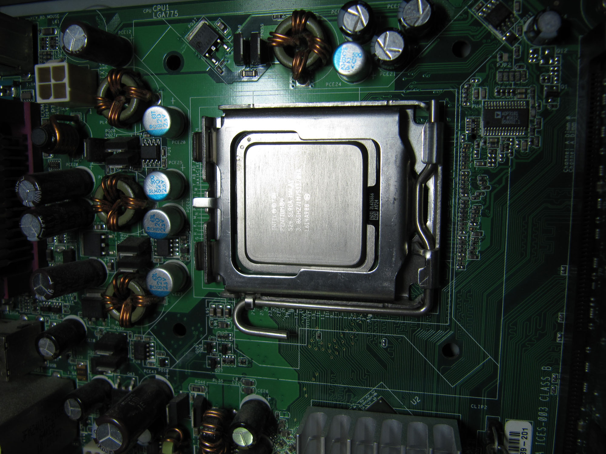

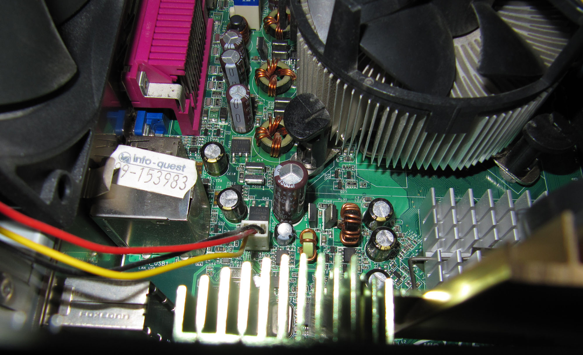

                    Well, the KZG caps stood up to their reputation... and failed!
                    Today I opened the case to take out a ddr2 dimm to test another motherboard and noticed a bulging 3300uF 6.3V 10mm KZG...
                    There are also 4x1000uF 16V 8mm KZG caps, not bulging.
                    I am thinking of recapping all of them.
                    The other caps are poly, Panasonic, Rubycon and Chemicon KZE.
                    The computer is working like nothing happened. In fact it is my main rig and I am posting from it right now.

                              I just noticed that this motherboard follows the Asus color code of the capacitors' polarity! The white marking is where the positive leg of the cap goes!
                              But it's an Intel! What does this mean????
                              Btw I took the bulging 3300uF 6.3V KZG cap out and tested it with my ESR Micro meter:
                              3390uF esr: 0.02

                                    I replaced all the KZG at this board.
                                    For 1x Chemicon KZG 3300uF 6.3V (bulging) I used 1x Nichicon HM 3300uF 6.3V
                                    For 4x Chemicon KZG 1000uF 16V 8mm esr 0.021 ripple 1,870 I used 4x Panasonic FM 1000uF 16V 10mm esr 0.019 ripple 2180.
                                    I also tested the 4 non bulging KZGs and the esr showed 0.01-0.02, so they hadn't failed yet.
