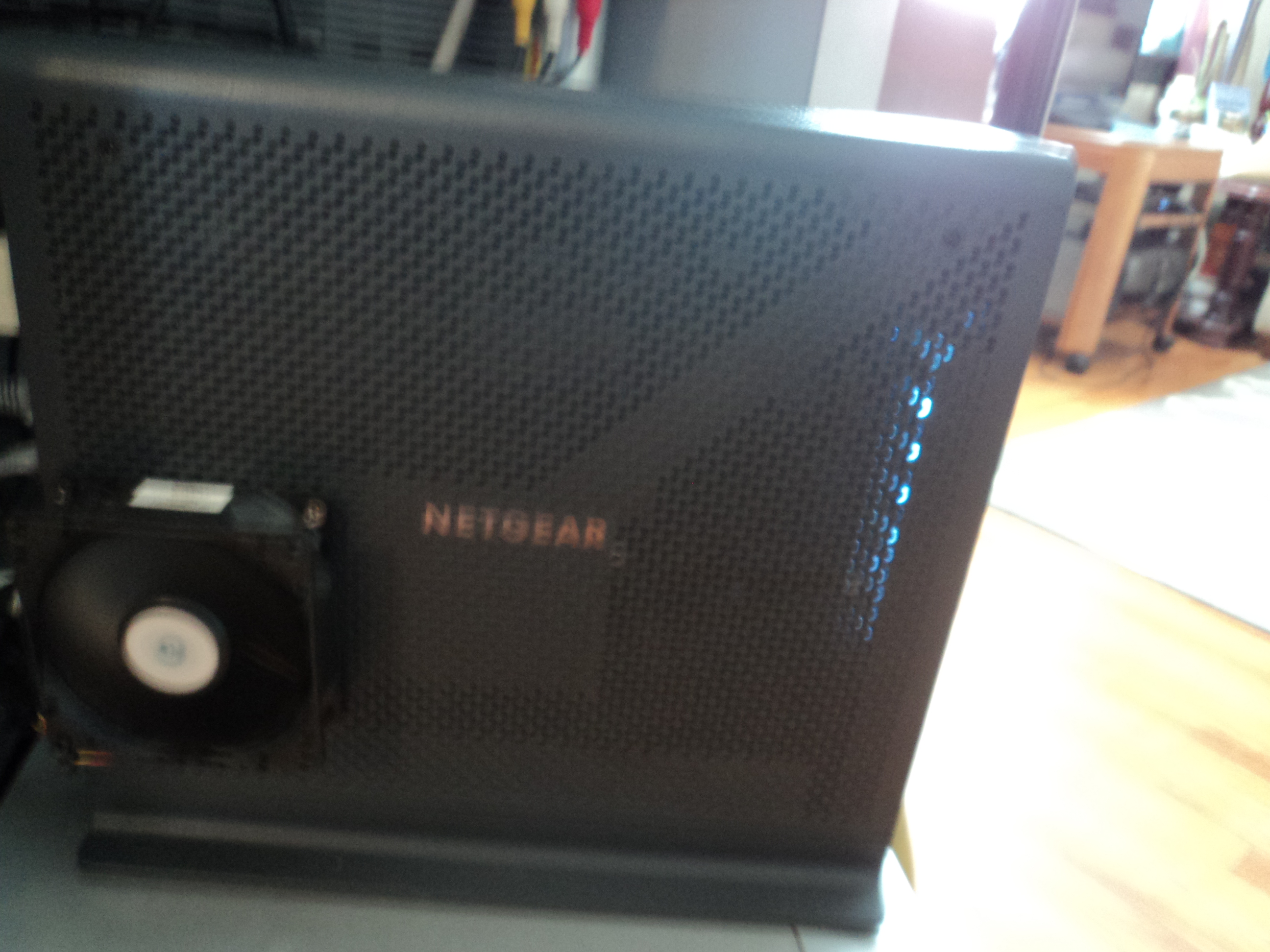

      For the Heating ,I have added a fan to my Netgear C7100v, as a measure of caution and love and it keeps it cool all the time,
        I like your idea and might be doing this myself on my new router as well but I going to wait 90 days before I do this modification just in case I have issues with this router while it under warranty
        But I going to do this with a temperature sensor/fan speed controller unit because I do not want the fan running at full speed for no reason I do not want to hear it running unless it has to
        Can I ask why you you did not put a filter fan guard on it ( if you are interested in getting one let me know what size the fan is and I will post a website link to where you can get some )
        By the way how are you powering this fan
              I use a 12v computer fan ,i connect it to the 5 v usb port on the router,it's very silent.
              My router is almost payed up,since i had to pay 10 bucks a month to Comcast ,and performance compared to Comcast router is abysmal for better,no comparison.

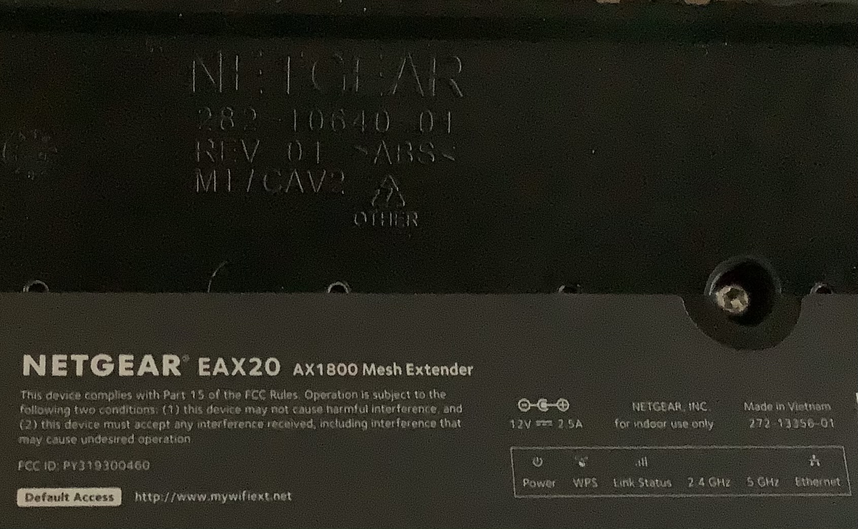

                      I did not show the hole data plate because of security concerns reasons just in case I find a solution to this setup issue and decide to use this new extender

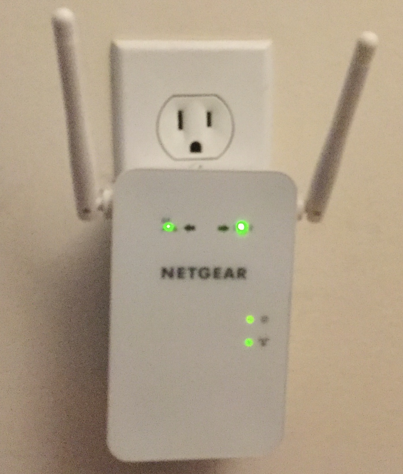

                            Ok here is an update
                            This all started because my wife has to work from home two to three times a week and she was having issues with printer access and the door bell camera not work correctly all the time and she works in the front of the house so she see the drive way and keep an eye on the dog as well and keep an eye on me as well also
                            I thought some of these issues were internet service connection issues with internet service provider and some of the issues were service issues but not all of them
                            I could not get either extender version to work correctly at all——>
                            I also could not get the printers to work correctly with new version of the extender either because if I could have done this I would have just use the extender because it has a better signal strength range than the router but this was also a no go as well so I am just striking out no matter what way I was trying to go
                            I called NETGEAR tech support and what I was told that I could not setup my internet connection the way I want to because it would not/could not work correctly with the setup I want to do because of interference from the modem to router and the extender
                            The extender is not setup to work the way you would expect it to work because my thought was you extend the range of the signal strength range to the hole house but this is not the case
                            So what I have had to do is relocate the router to front of the house and have the modem in the office in the back of the house which works ok but down load speed is half the speed being 100 feet from the modem
                            but I can use the printer with this setup correctly and seems to work ok so far but time will tell if I have issues with printer problems connecting correctly
                            ( the router signal strength range is decent for this router it just that the range is little bit shorter than what I expect from the router because the modem has as good as range as the new extender does which would have been wonderful if I could get everything to play correctly together )
                            When the modem and router are right next to each other ( with a very short cable connection) the down load speed is the same as the modem but I guess this is the price of having them that far apart
                            I can live with this trade off unless someone has a solution for this issue but at least I have my front door bell camera working correctly on the modem
                            This front door camera is the most pick-e device I have used in a very long time
                            For what ever reason it would not detect the router in the front of the house but would detect the modem
                            But the funny thing is when the modem and the router are next to each other it would not stay connected all the time and drop out for periods of time and it did not matter which device you used
                            So what I do when suffering the internet connection using the modem and when I need to print something from the printer I switch to the router and use the printer which is fine I can live with this setup as long as I can access internet and print what I need to print which is what I was after in the first place anyway
                            Here is why the door bell camera not work and I am in the back of the house I would have to go to the front door but having the door bell camera I can use my tablet and see the camera with it and decide if I need to answer the door or just pretend that I am not home
