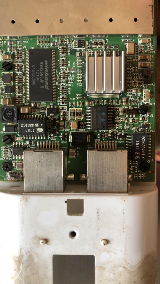

    Hello everyone. please someone can help me remove the username and password in a router ubiquiti nano station M5

      Yes thank you for your help. But I downloaded this on their site for flashed and it did not work. only it comes back with its old interface but I forgot the password

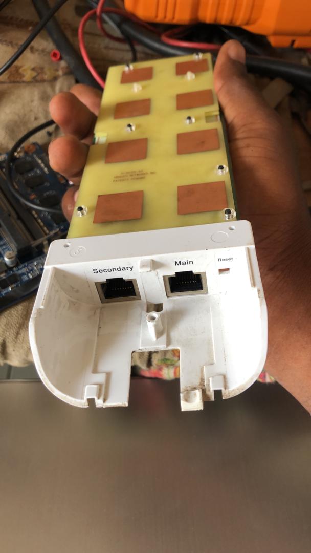

        u did not see that hole with mark "RESET" on it with switch in it???
        power up and hold switch for 20seconds. if still not reseted password than hold switch, add power and still hold switch for 20 seconds

          okay thank you very much my brother. it is done
