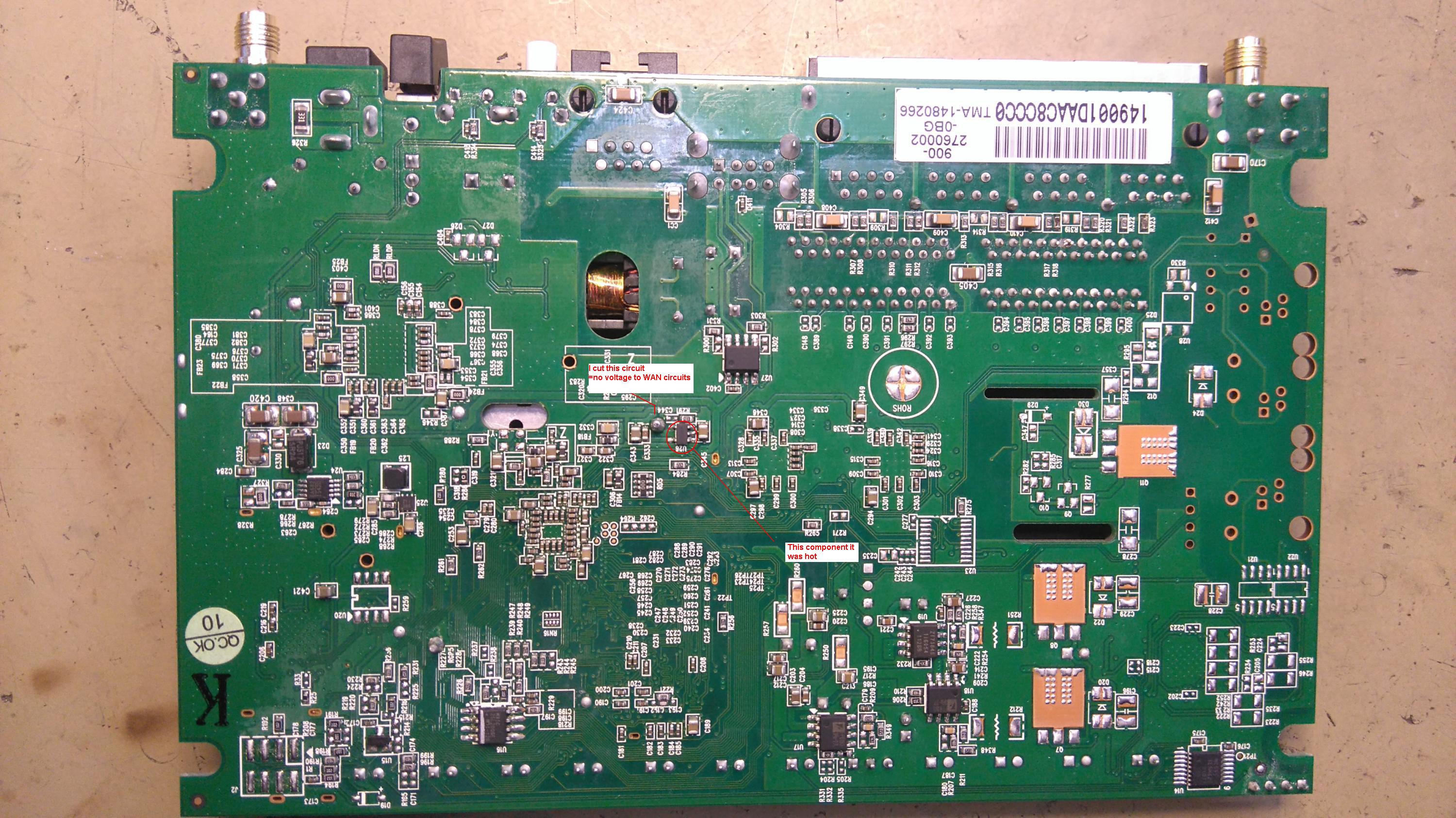

Draytek Vigor 2960n

    Re: Draytek Vigor 2960n
    You said it's a 2960, it's telling you it's booting 2760 firmware.... wrong firmware?
    • tehmatix
      • Nov 2012
      • 177
      Re: Draytek Vigor 2760n
      No, it is 2760n. I wrote wrong from beginning. My mistake.
      • kc8adu
        • Nov 2003
        • 8832
        • U.S.A!
        bad flash chip.
        its failing to boot because of it and going to recovery mode.
        • tehmatix
          • Nov 2012
          • 177
          Originally posted by kc8adu
          bad flash chip.
          I didn't upgrade its firmware. The router is behaving as I said, it reboots continuously. What would you suggest to solve this?
          Thank you
            Have you tried booting it via TFTP? You need to put it on a network with a TFTP server on 192.168.1.1, serving up the firmware.
              Originally posted by tehmatix
              I already check capacitors on the board. All components it seems to work normal , no overheating. Which tools I need to make firmware upgrade ?
              How did you check the capacitors on the board - what test equipment did you use? Did you test the capacitors out of circuit?
              Used to have a coupe of Draytek's - overheating? All mine seemed to be hot enough to broil a steak - I am almost suspicious that your Draytek is running cool! But of course it could be running cool because it wont complete booting so no CPU load to generate heat OR a component (capacitor?) has failed and stopped operation of a portion of the router - or the CPU is not supplying enough voltage so the under-volted router is running cool?
              How old is your router?
                Could be 4 or so years old. Drayteks have, for as long as I've seen them in the wild, suffered from power supply problems. If the power supply is suspect it could easily cause a corrupt firmware, but you should be able to recover it.
                  I solve this problem. The WAN IC is broken with shortcircuit over Vcc+.Now the router is working without WAN ports.Prehaps it was lighting over the ethernet cables. Thank you all for support and ideas.
