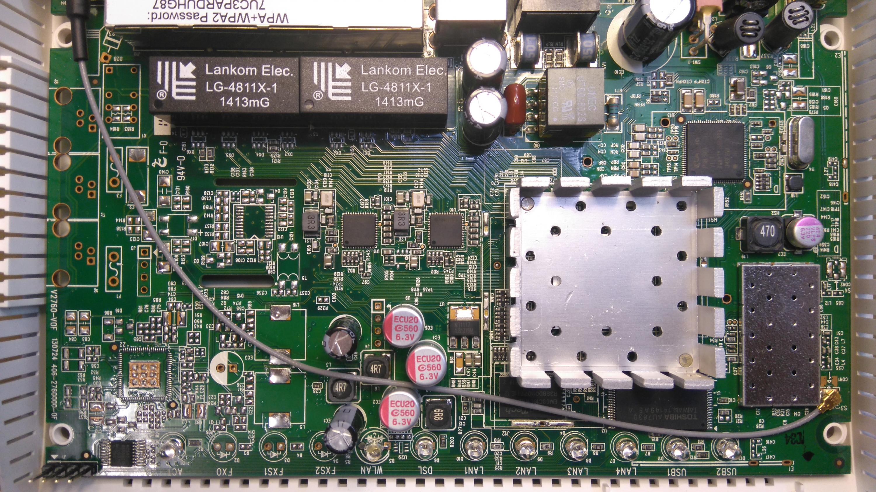

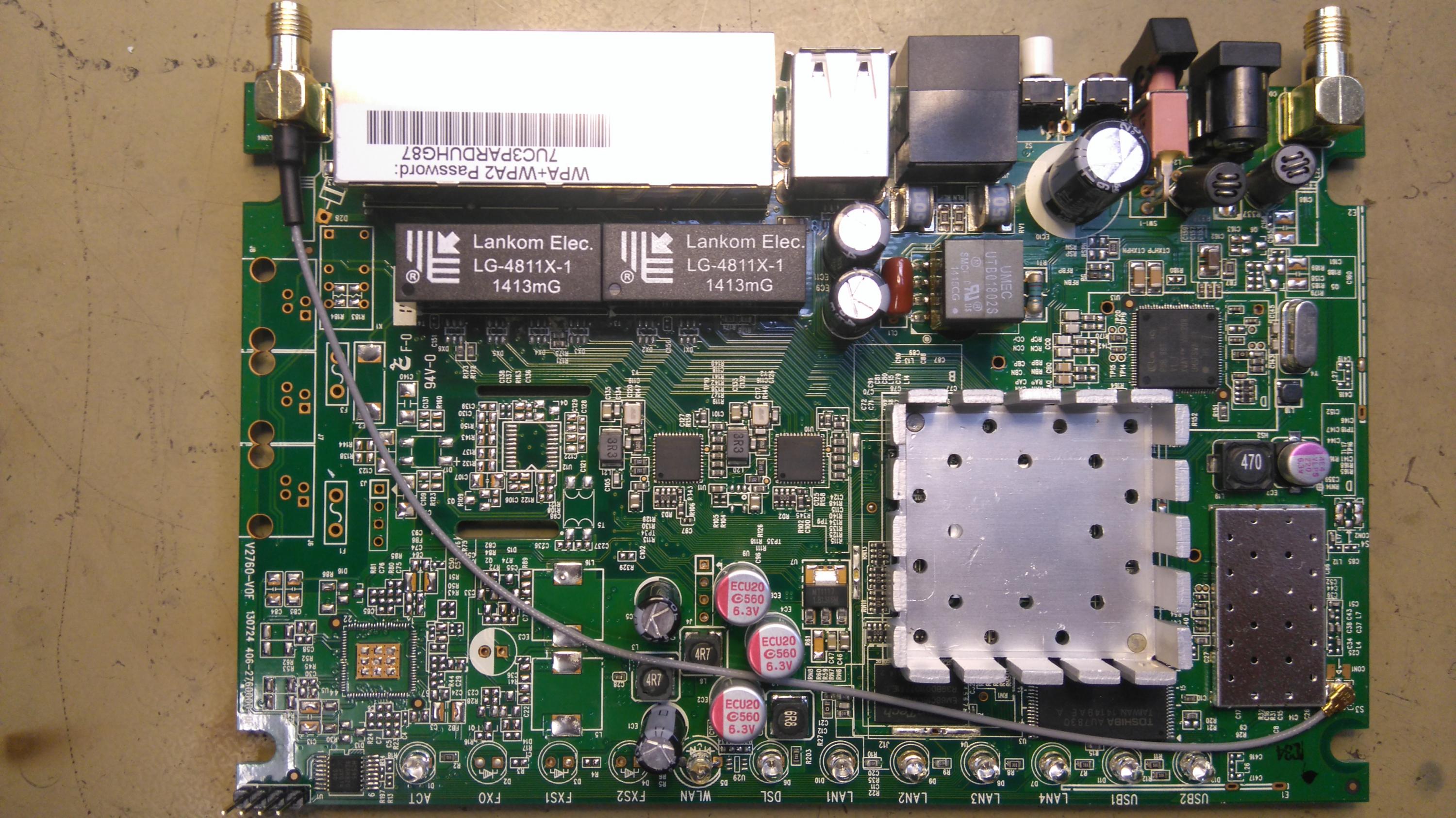

    Hi, I have this router with an issue: I can't connect with network cable or wireless, is permanent restarting, power led and USB2 led flashing. Any ideas
  • diif
    • Feb 2014
    • 6978
    • England
    Re: Draytek Vigor 2960n
    Yes. Take the top off and post photos of inside.
    • tehmatix
      • Nov 2012
      • 174

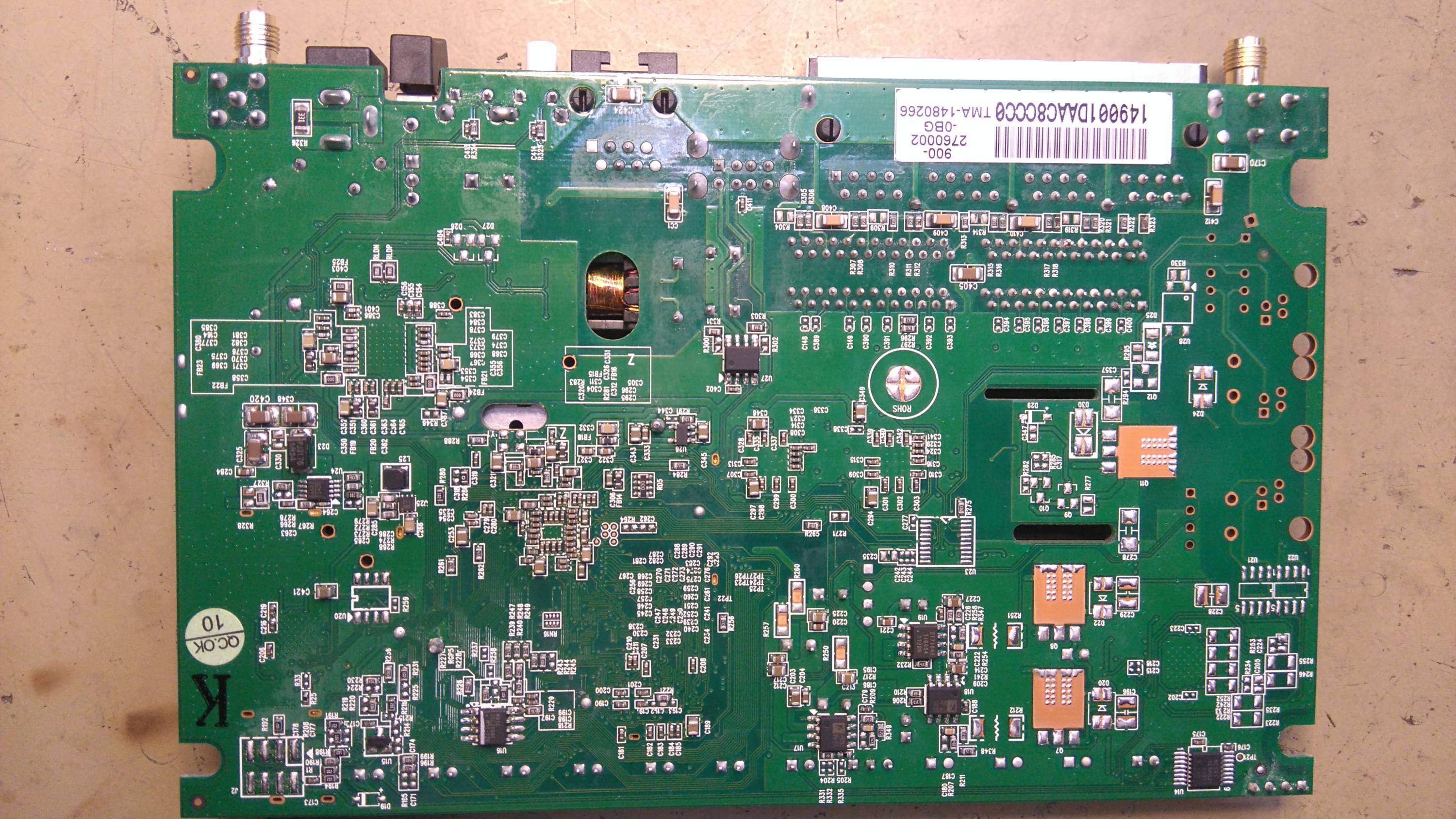

      Photos
          that's a nice build.

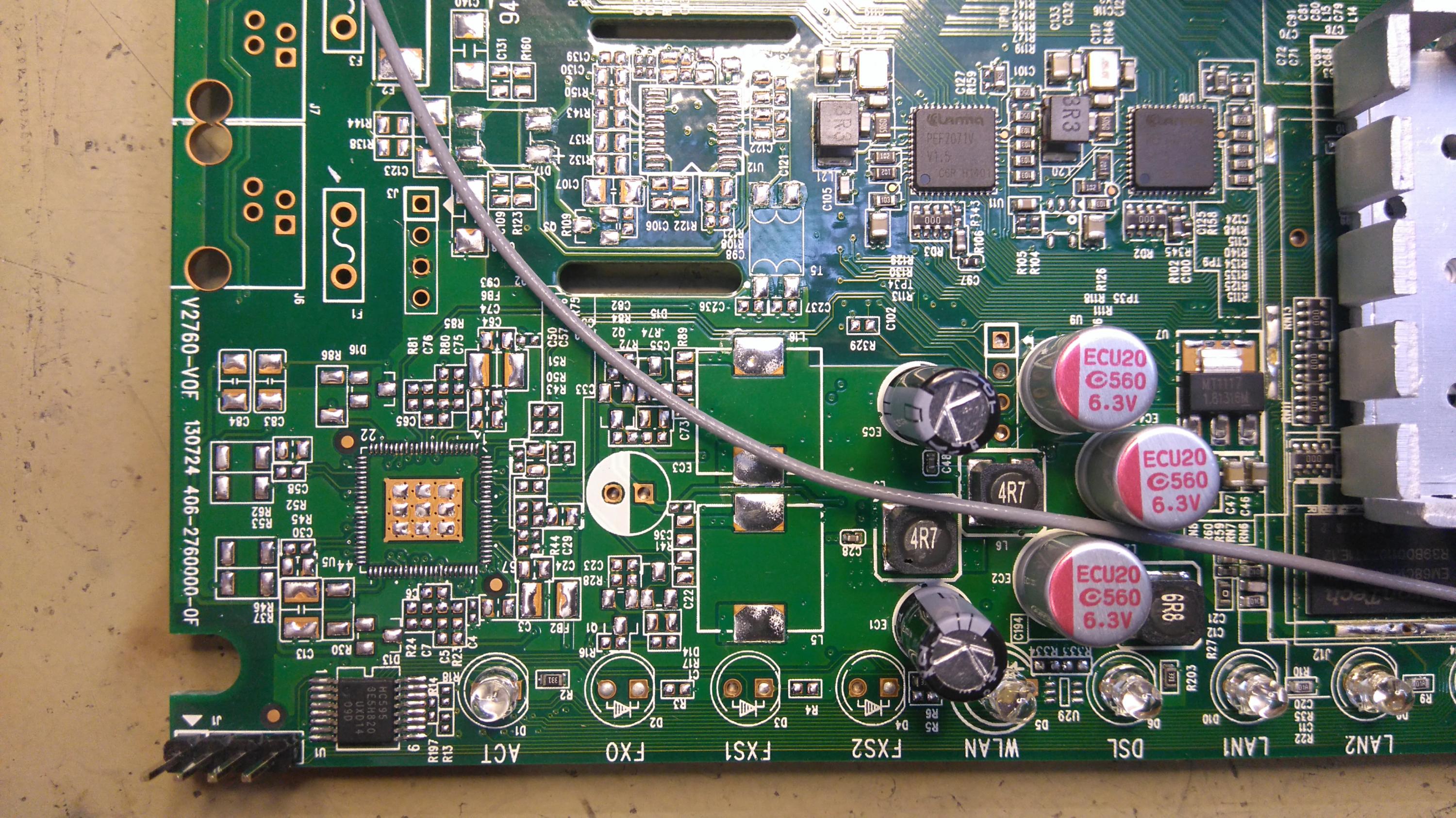

                      Any overheating component? if you have proper tools, try to reflash the firmware (using an external programmer)
                      • tehmatix
                        • Nov 2012
                        • 174
                        Re: Draytek Vigor 2760n
                        I already check capacitors on the board. All components it seems to work normal , no overheating. Which tools I need to make firmware upgrade ?

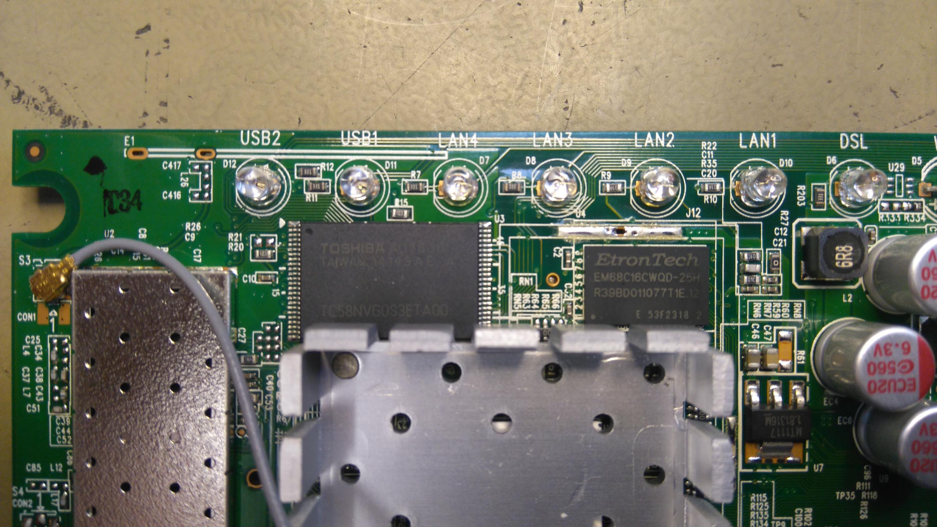

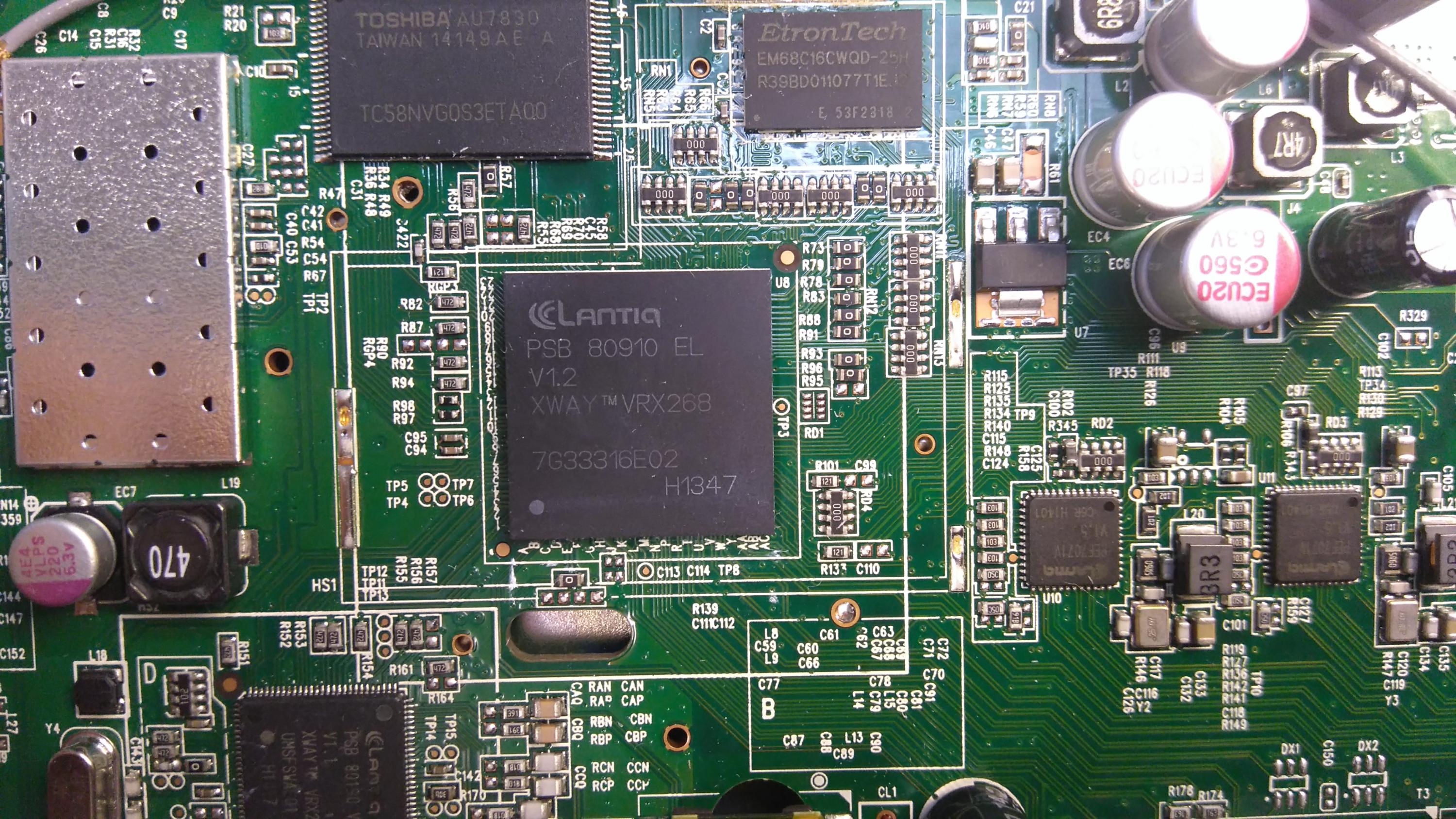

                          CPU Lantiq PSB80910 El V1.2. Is a small memory on bottom MX25L2006E. This device contains the firmware?

                            Most likely the firmware is stored at the toshia tsop chip TC58NVG0S3ETA00 (128Mb chip) and the MX25L2006E is used to keep some parameters like mac address, serial number..... unles you have acces to the tools i wouldn't bother.
                            Look like this device can be controlled with console commands, maybe you could connect via console and perform a firmware reset or maybe a remote firmware upgrade, check the manual.
