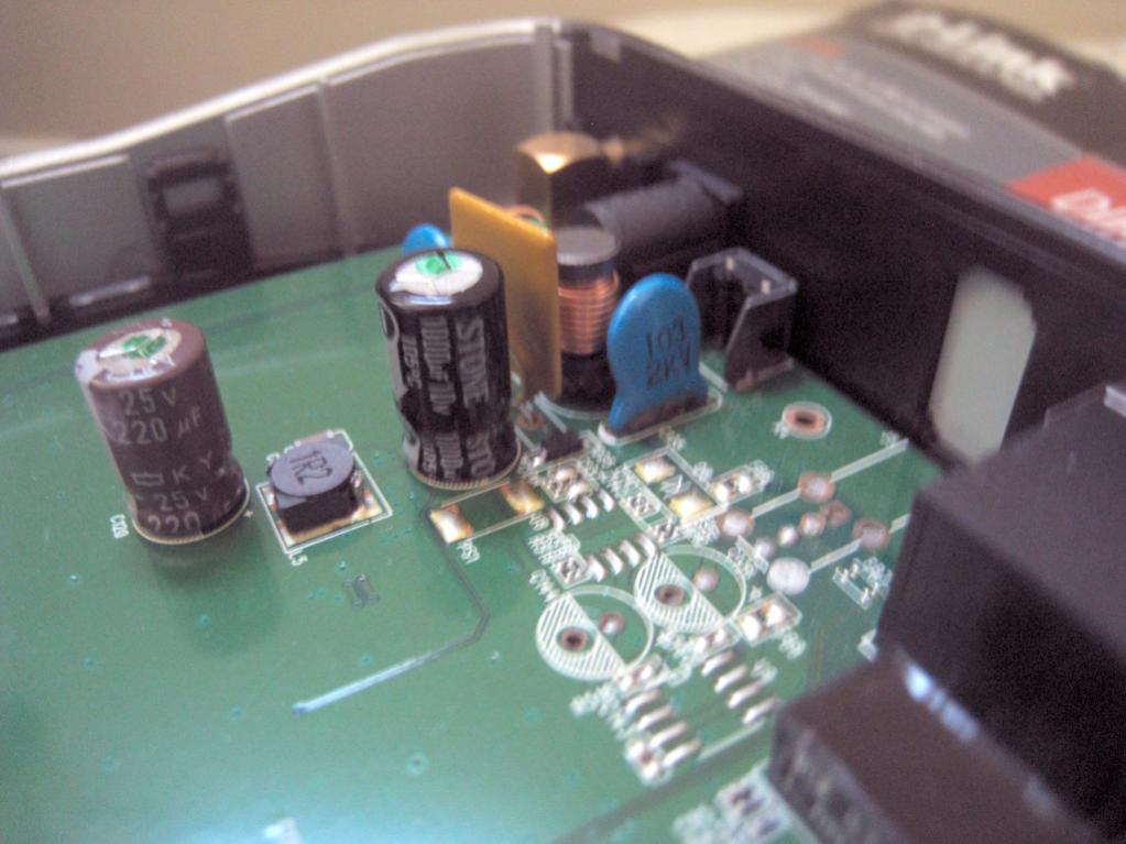

    DIR-615 HW Ver. B2 -FW 2.20 When Shipped
    1 X Stone 10V 1000uF
    3 X Nippon-Chemicon 25V 220uF KY Series
    marvell 99e6060-rcj1
    atheros ar5416-ac1a
    other chip covered by heatsink (aluminum/thermal pad)
    I quickly took a few pics.. Should the Stone come out? Higher voltage replacement? Router works fine just havent had it running in a few months..

    You don't need to increase the voltage, Stone are just really crappy caps and prone to failure. I'd replace it with a KY cap, is this on the PSU or the mainboard of the switch?
      Re: D-Link DIR-615 B2
      Yes, replace Stone on site... They are completely unreliable and last only a very short time...

        Wow.. Super fast responses .. Ok I will see about exact replacements.. I was just about to post about my xtreme gigabit DIR-655.. I don't know if I ended up hitting submit..

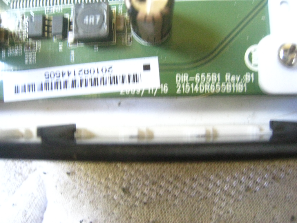

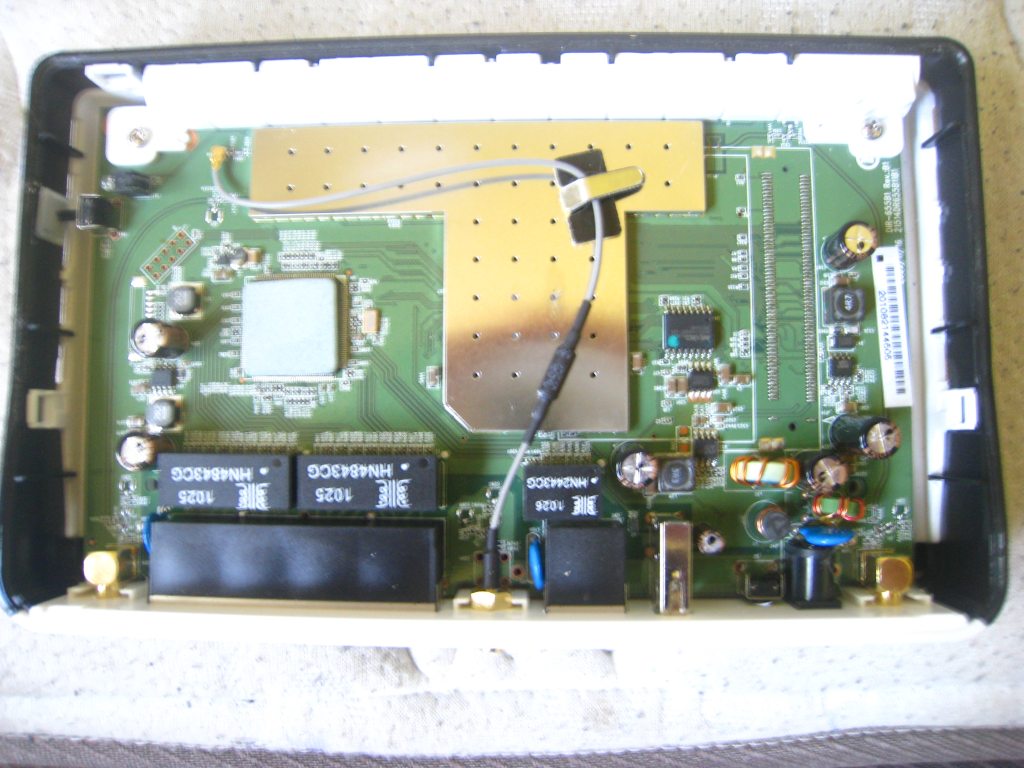

        DLINK DIR-655 Extreme Gigabit HW Ver. B1 FW2.00NA when shipped.. Working.. Main Router
        1 X 16V Lelon 1000uF
        5 X 6.3V Lelon 1000uF
        1 X 10V Lelon 100uF
        All Lelon Caps? See Pics.. Would you pull them all or?
        Is that a thermal pad on the main chip or a "pad" to hide the identity? Feels harder then a thermal pad..
        Thanks,
        EDIT: Could if I put in a 16V if thats all if have still 1000uF?

          Lelon, but which series? What are their dimensions (W x H)? No idea about the thermal pad.

            My mistake Lelon RXW Series -
            I'm just working on some pics quickly to put up..
              Yeah you could put in a 16V cap. Unfortunately, Lelon caps are also of low quality. They would technically work, but who knows for how long

                  Yeah preventative recapping is always good Can't see those pictures very well, do you think you could reupload them using the attach function in the "Go Advanced" window?
                    I just uploaded.. Sorry not best quality ... Just snapped them quickly.. I need to find my iron..
                    I only have 1 x 16V 1000uF KZG or some 1000uF 16v Sanyo WG if they will fit.. Might be 2 tight.. For the 615 which I will start with..
                      KZG are extremely problematic too, a dud series from a great brand, also avoid KZJ (Doesn't it suck how many low quality caps are out there?) I would use the Sanyo if you can get it in there, those are very high quality
                        Ok.. I will see about the WG.. They will just fit if so.. Does any1 know the max size a dlink dir-655 will take?
                        I just went through my pulled dead caps.. Had a few in a jar.. KZG 6.3v 820uF.. Should I just junk the 16v 1000uF one I have? It was bought new.. Hasn't been tested..
                        WG seems a tad 2 big in the 615.. I may just wait until another time..

                              Looking for recommendations on recap of the D-Link.. I have some Sanyo 16v 1000uf I believe but its 8 X 20 just a little 2 big I think for the D-Links.. I'm thinking 10x16 or so to be safe.. Recap all the 25V caps aswell?
