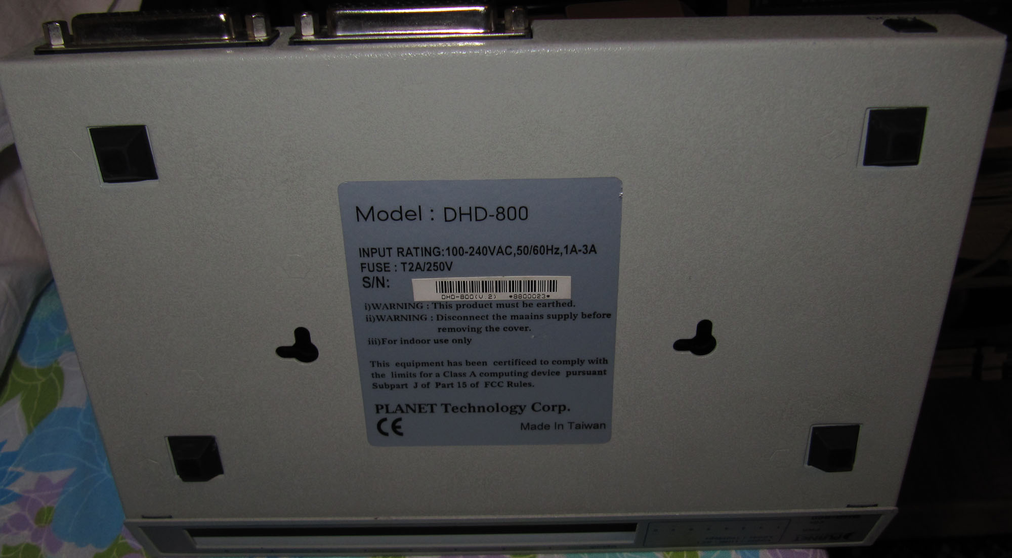

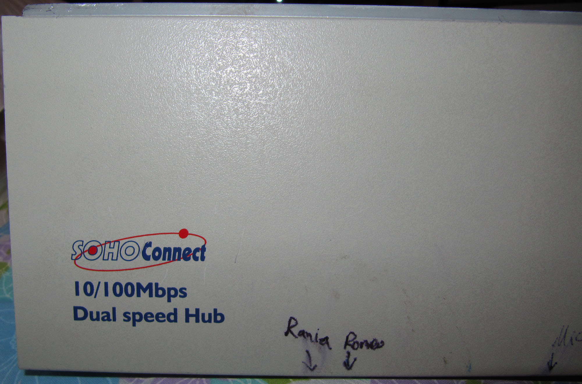

    What is this?
    I have to admit I know few about hub/router/lan/nas etc

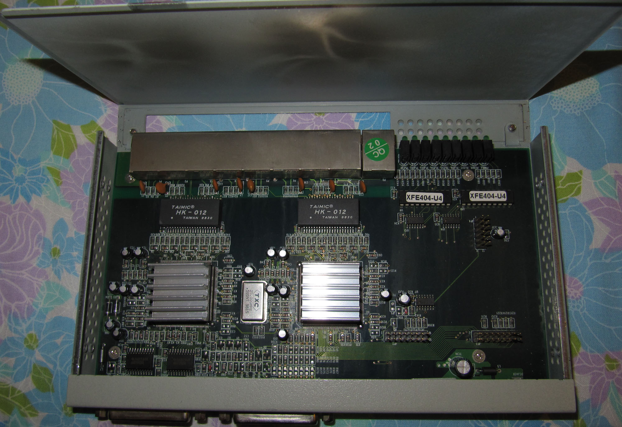

    I found it some days ago at the uni and I finally managed to open it.
    What's its use and what are the parallel ports for?

      planet is another taiwan brand that didnt make it into the very know international brands. had some of their nic cards like a decade or more ago and working ok.
      DB-25 connectors are so you can connect compatible similar units together and stack them.

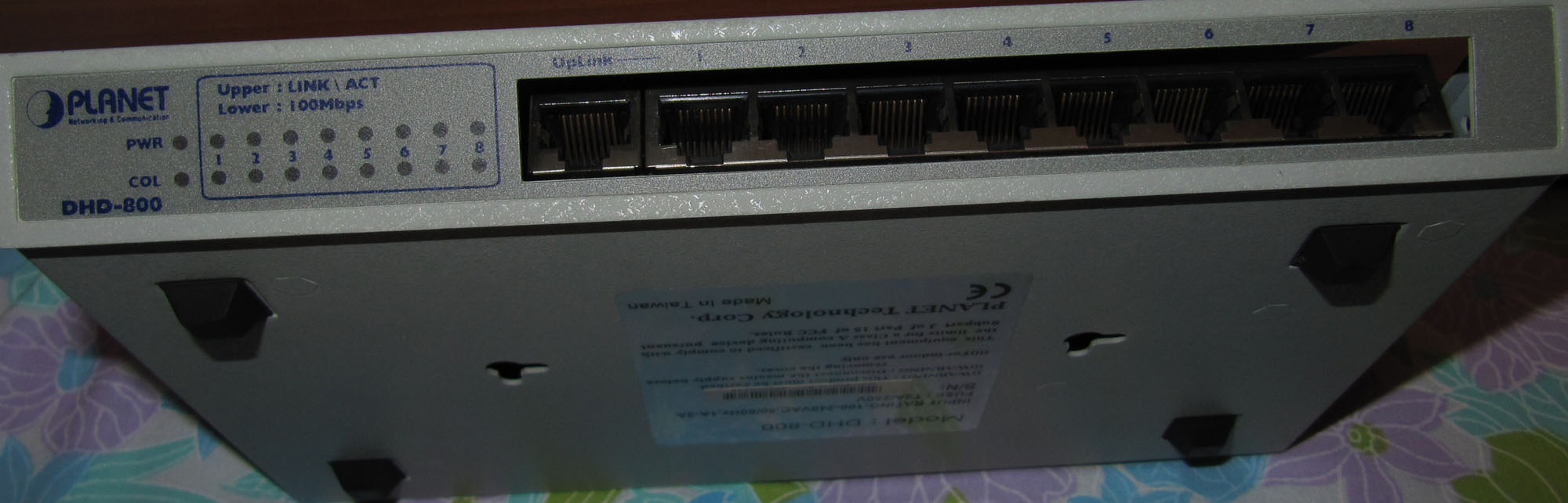

        Thank you for your answers.
        There are 8 Ethernet ports and one that is named "Uplink".
        What does this mean?

            In most network designs the 8 port hub that you have connects to a larger and faster ethernet device.
            Uplink is usually used to connected to a bigger switch "up the link".

                uplink- what that means is it you can connect it to another hub/switch. modern switches are auto uplink... but it used to be that one had to either use the uplink port or use a cross cable to connect hubs. i forgot which wires but two switch... so again, more old technology.

                      The uplink and port 1 are the same port with the pins re-arranged.
                      Allows use of either a cross-over or straight through cable to connect port-to-port with another hub/switch or a router.

                          Thanks for the replies! Yes, when I connected both the uplink and port 1 with Ethernet cables, they acted like shorted.

                            When I got that hub, it came to me without a power supply and I used a PC psu to test that it's working.
                            Today, I found a variable voltage power supply brick that matches the hub pin.
                            The lowest voltage it gives is 6V. The hub takes 5V. I have tested it and it worked. Volts were measured 5.88V. Can I use that psu with the hub or it is a bad idea?

                                It might be ok, but I am not sure about that unless you have some linear/switching converters on board.

                                  Its close enough. .88v over isn't going to do much.
