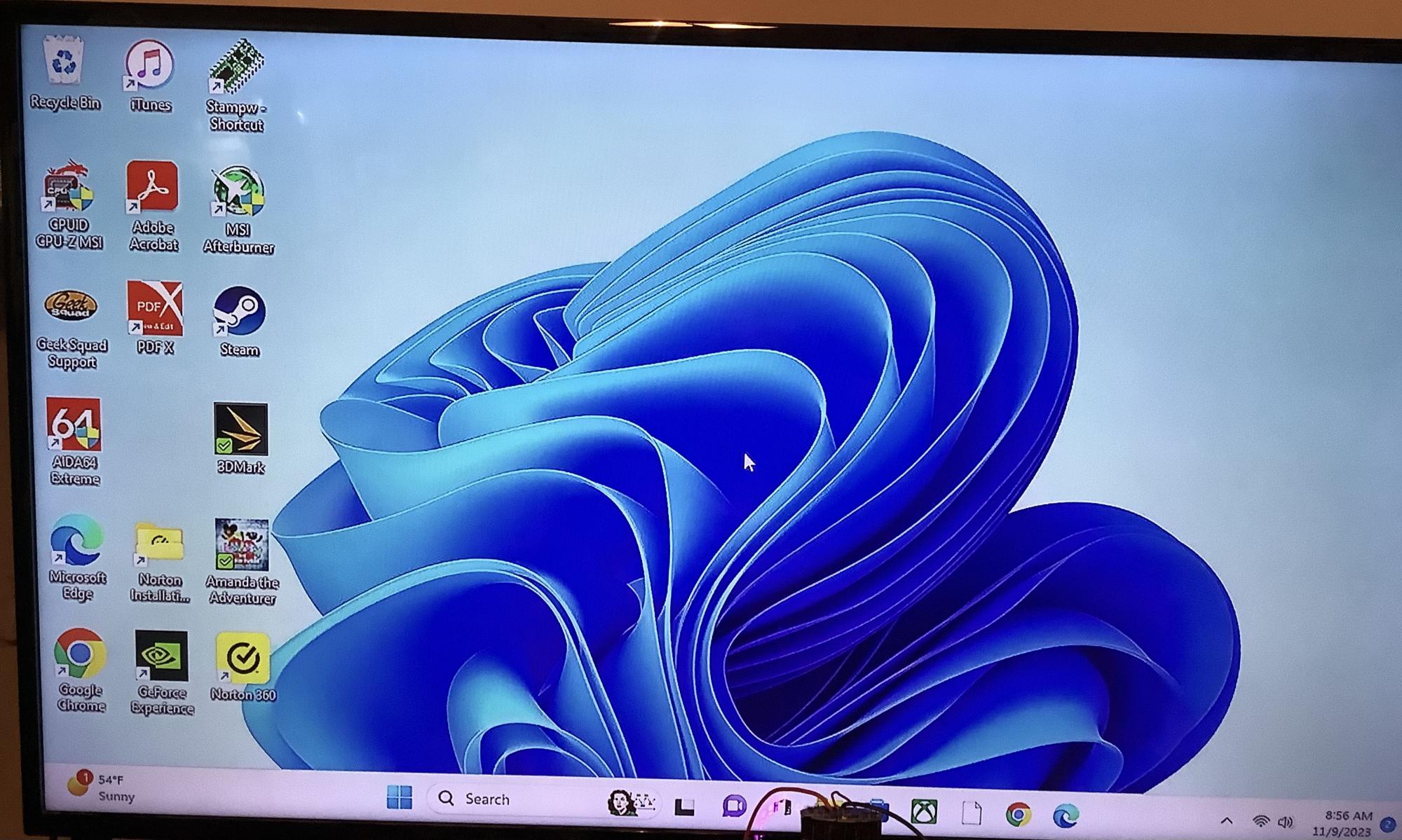

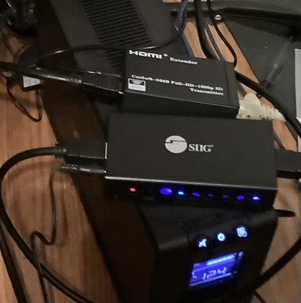

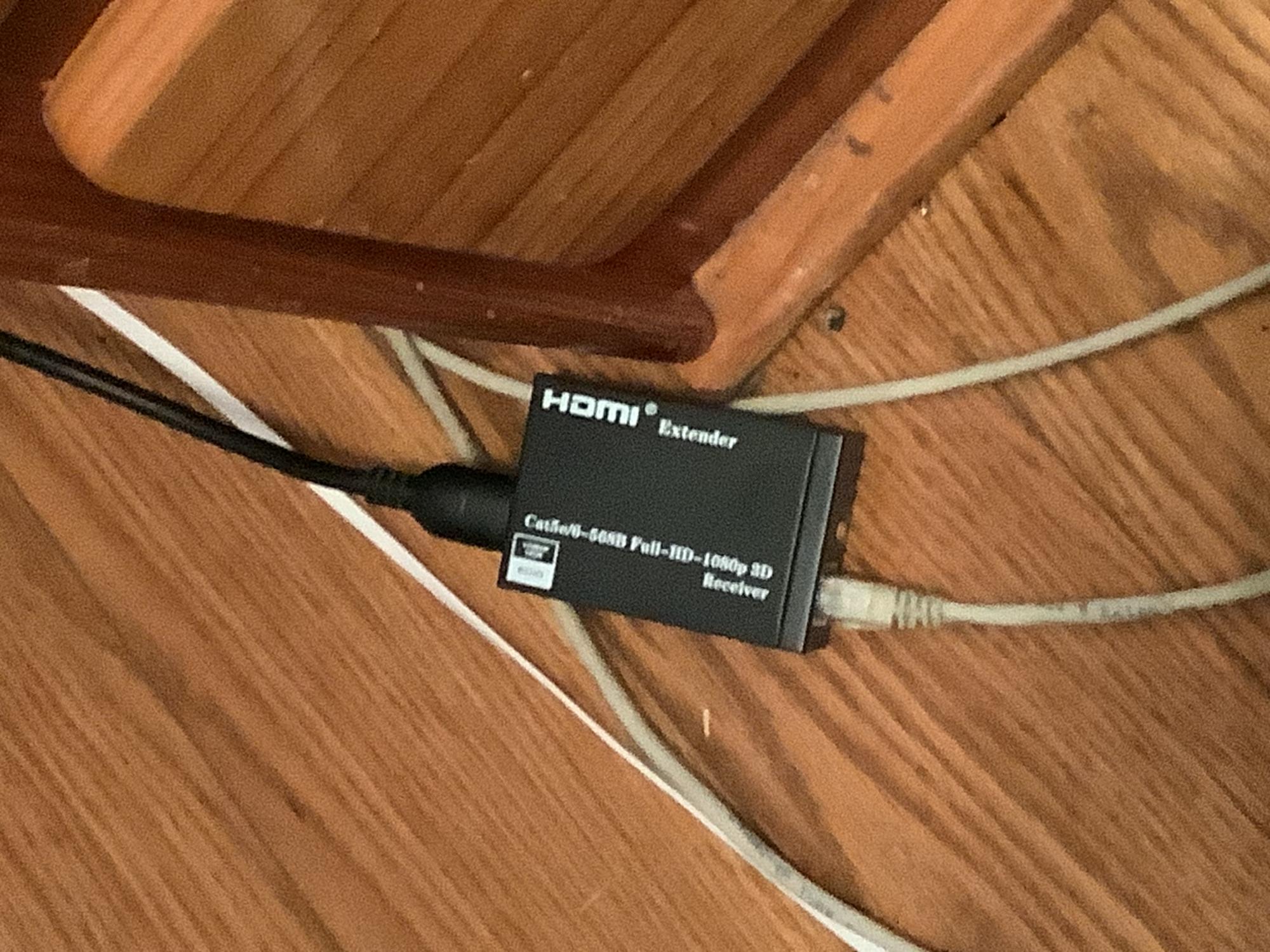

    I recently got a new shed that it my battery testing work bench beside this it also be electronic work bench as well and general work bench area as well
    I want to have a way to monitor more than one computer that is doing battery testing on the fly so I can switch between monitors and be able to see the results in real time
    I a chief engineer where I work gave me the information and idea to use a CAT5 repeater which would be the simplest way to do this
    They use a different method to transmit the data to tv monitors around the facility but that system requires some programming that apparently is somewhat difficult to setup
    I did some research and testing the system concept that I had in mind and the testing revealed that yes it is doable and the results are very good for what I am trying to do
    As you can see in the pictures below
    If I do not have this post in the right place please feel free to move it to the right place
    I have one question about putting 4 CAT5 cables in a out door conduit is there going to be any issues if I do this
