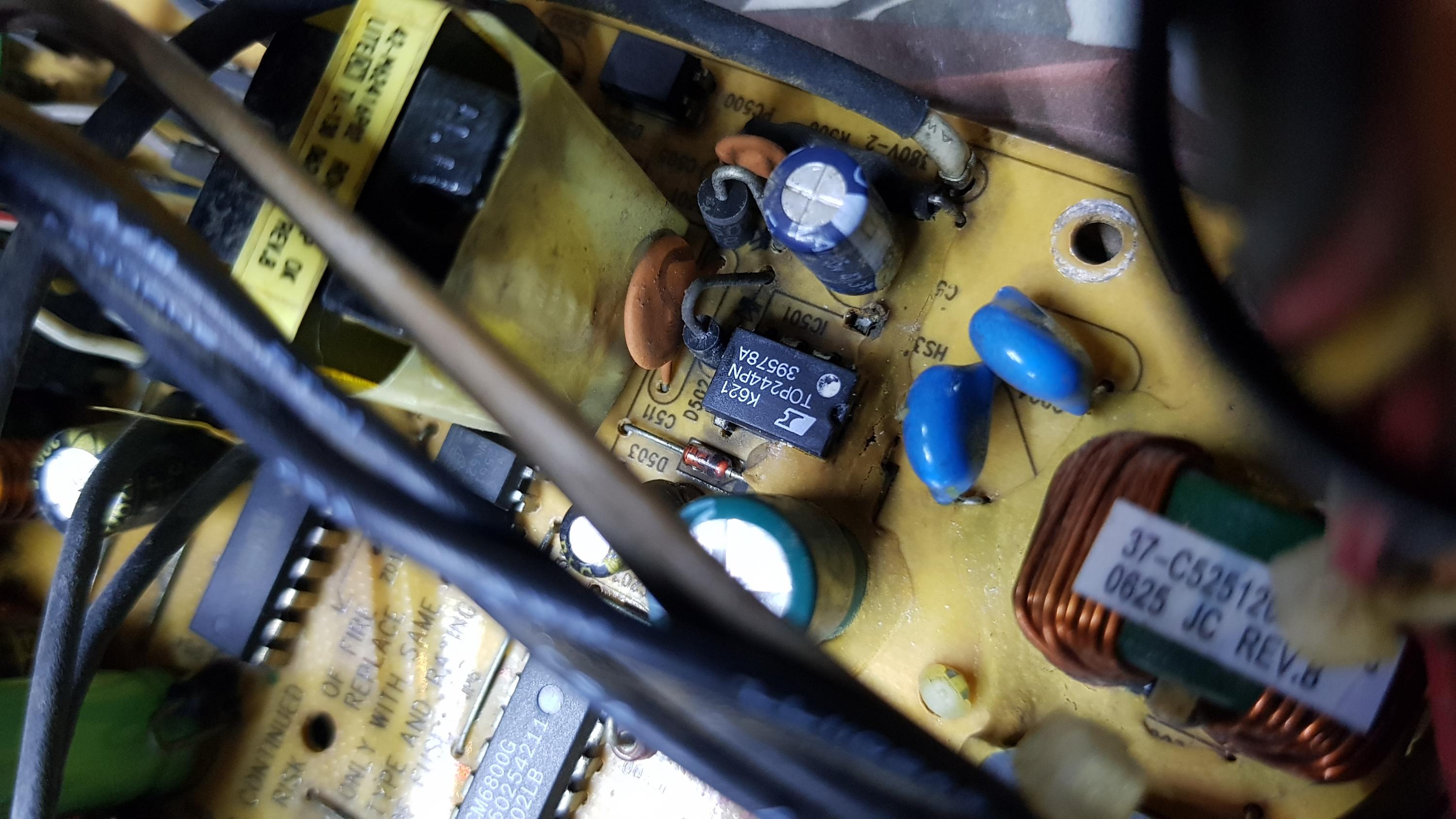

    I have an SMPS where the TOP244PN switching IC is used to power the standby section. I am not able to get this IC locally, is there any alternative in the TNY switcher series I can use in its place?

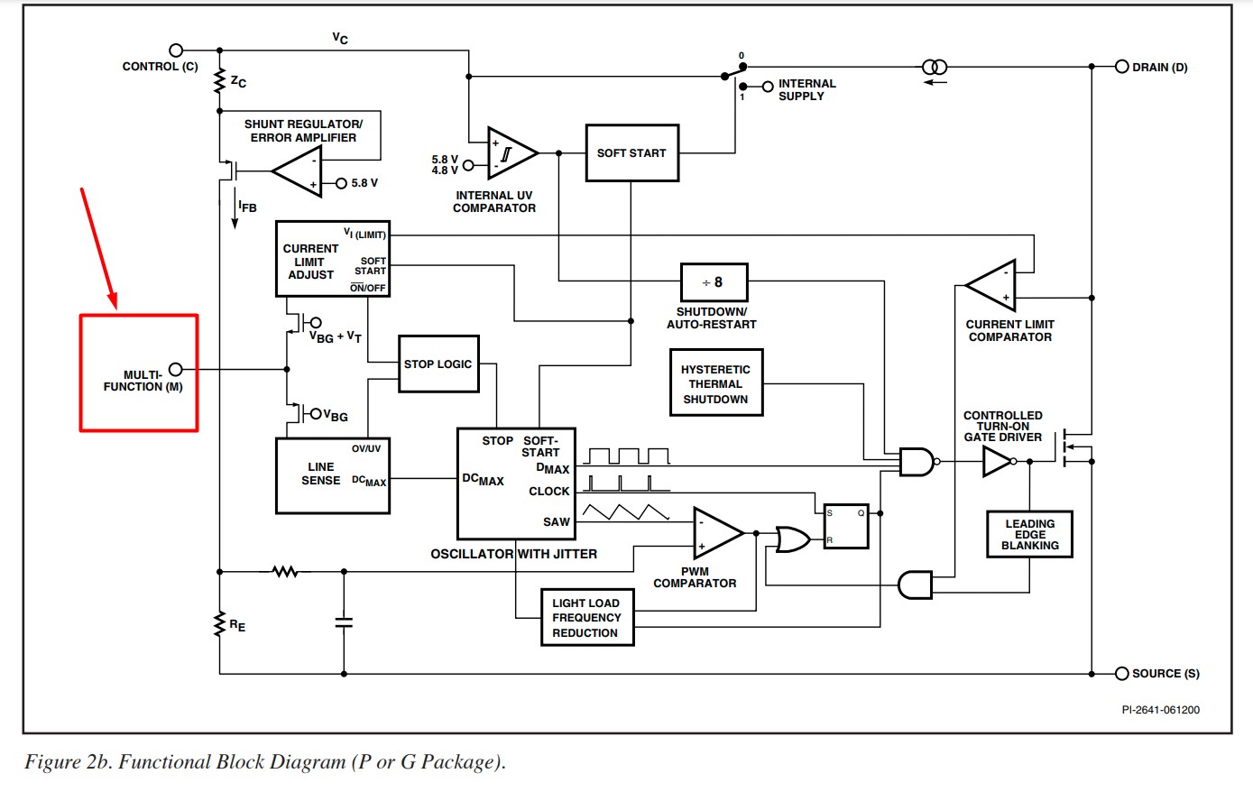

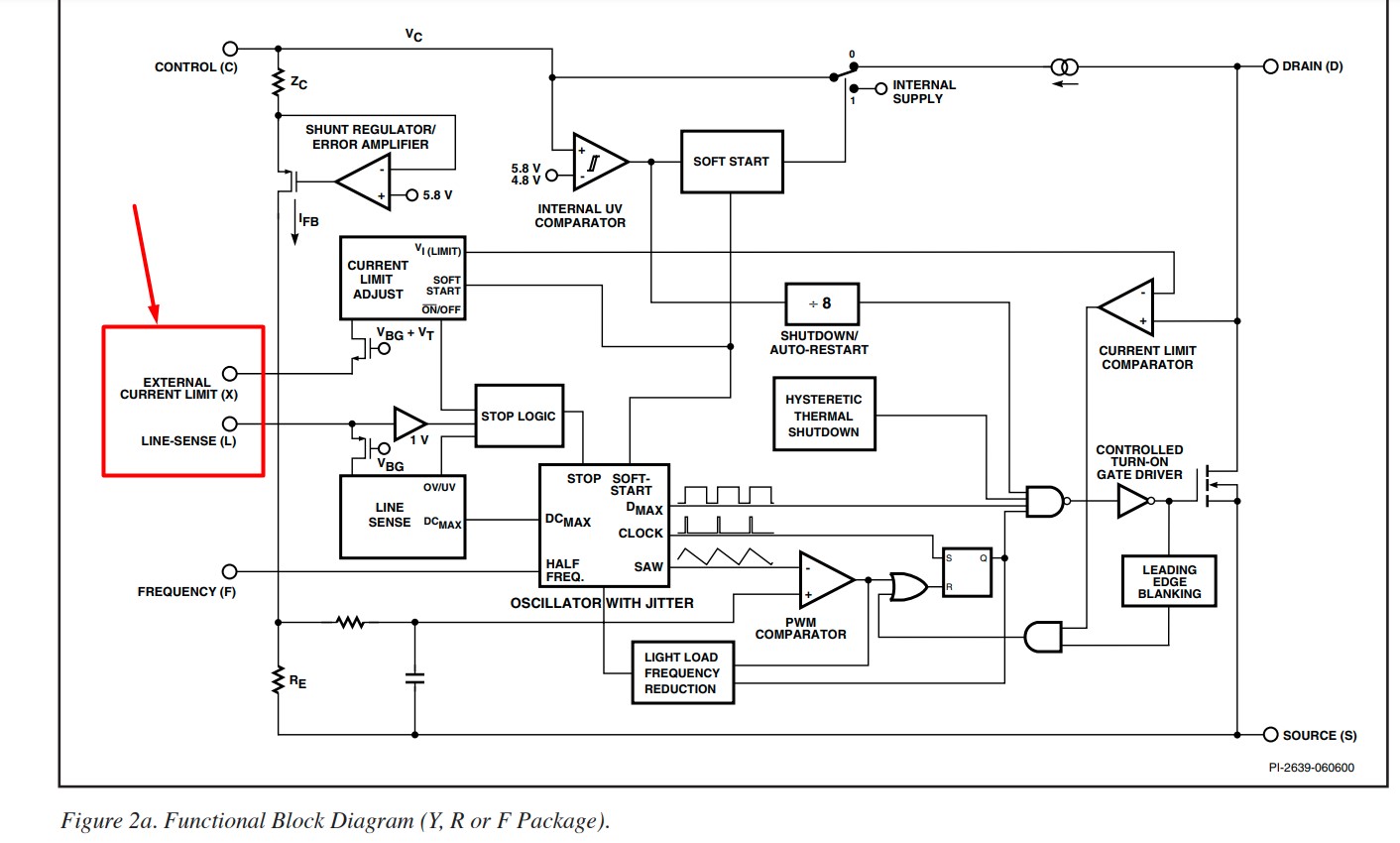

    Also, can I use the TOP244YN package in place of this TOP244PN package? It seems in the PN package they have combined the X and L pins of the YN package and made single M line.

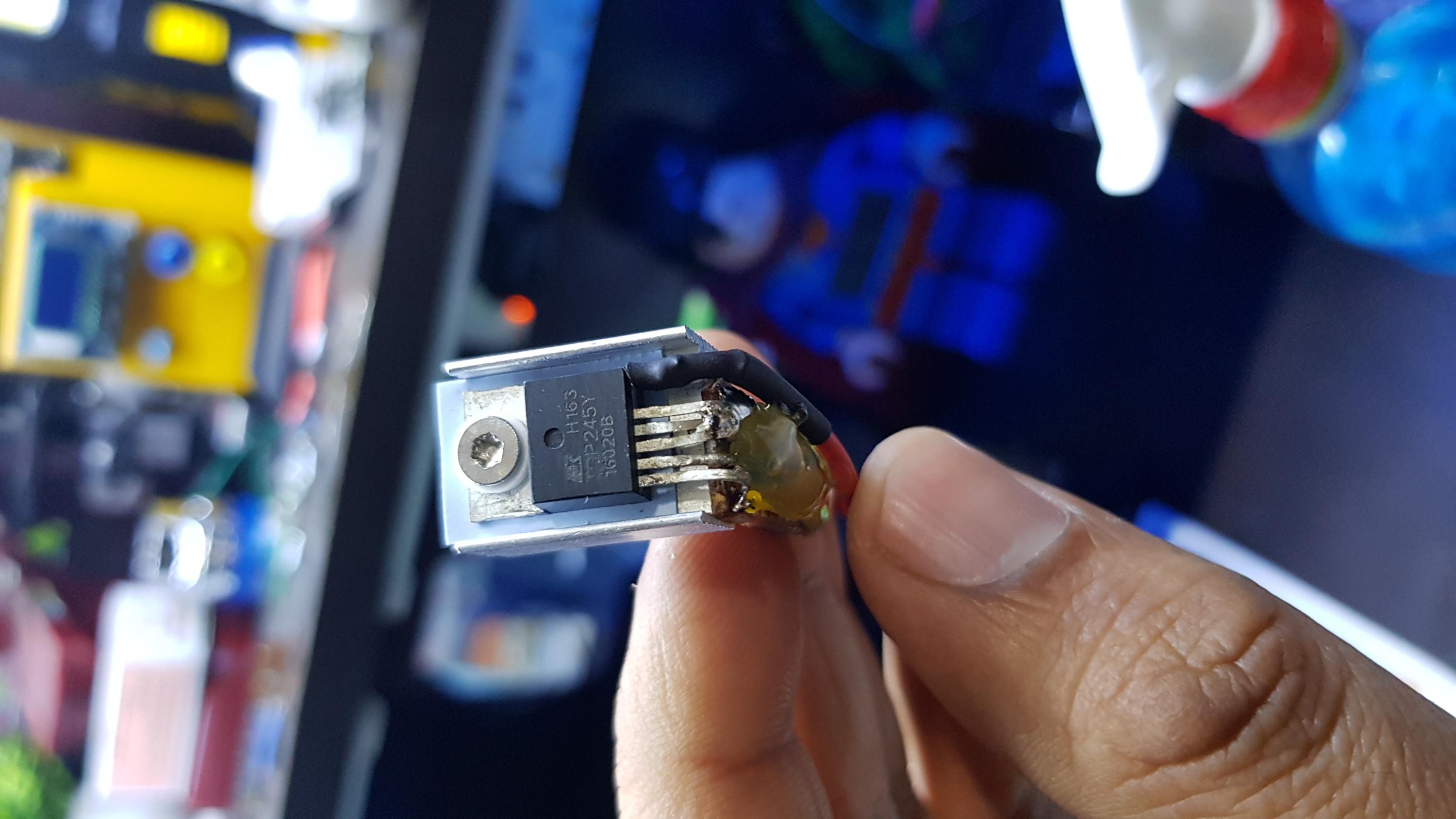

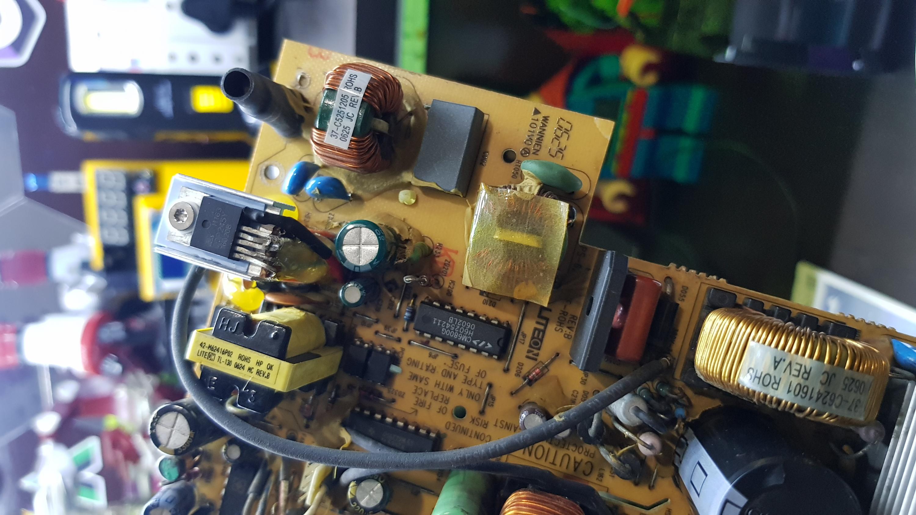

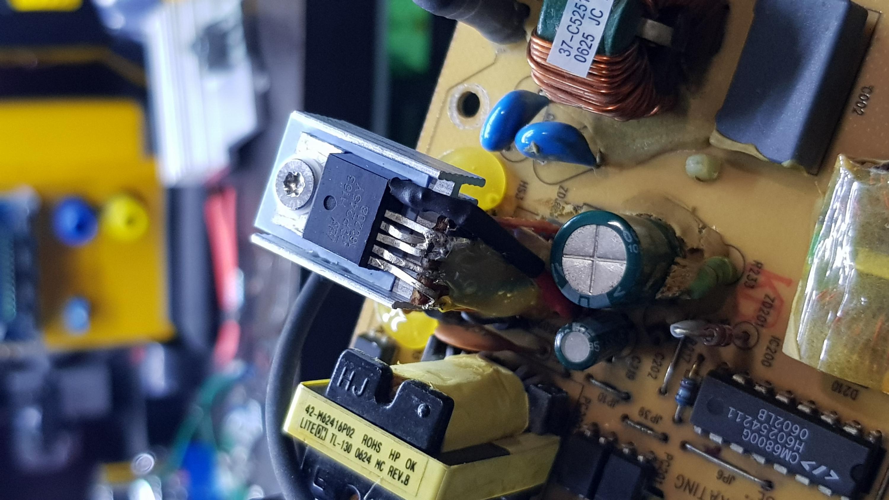

                    Actually I had some spare TOP245YN. I was able to use the TOP245YN package successfully in the SMPS after going through the datasheet, basically, they just had undervoltage protection enabled for the standby supply section. I did the mods and integrated this package in the SMPS, and got the supply successfully working back ☺
                      • Jul 2011
                      • 6040
                      Re: Alternative of TOP244PN switcher IC?
                      Good work getting it going again one more item that did not end up in the landfill
                      However I would mount the TOP245YN off to the side and make it a little bit safer that just me
