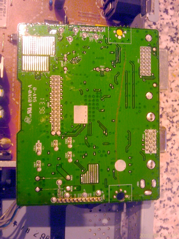

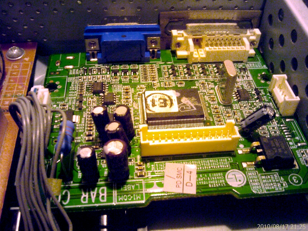

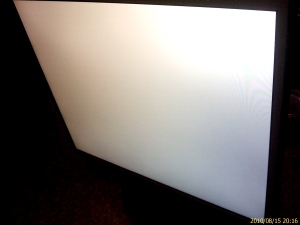

    Got this 19" monitor from a friend. The picture is missing while CCFL's are working as the light comes straight through. No build in menus or picture can be seen.
    Visual inspection revealed no heated spots, no bulging caps nor any other defective looking parts. All seems good, though caps are some "con" caps.
    I've checked both voltages on logic board are ok. (12.1 V and 5.0 V)
    I did read from another threads that this kind of problem may be caused by blown fuse on logic board or the panel board. I can't locate any fuses on either. Measured some lookalikes on panel board but they seemed to be resistors.
    Any ideas please.

    Re: LG L1952TQ: White screen, lights on but no image
    White screen is usually panel problem if the cable between the logic board & LCD is in securely (especially if you have not even touched it yet).
    There are fuses on the LCD board (integrated T-con so to speak). If the fuses on it are OK, then the panel is defective.
    What I do is then scrap the lights for testing other inverters. I also keep the whole assembly of P/S with Logic board to test other CCFLS (connect VGA & power) and you can turn on/off CCFLs at will. makes troubleshooting quicker as you have good lights & good inverter.

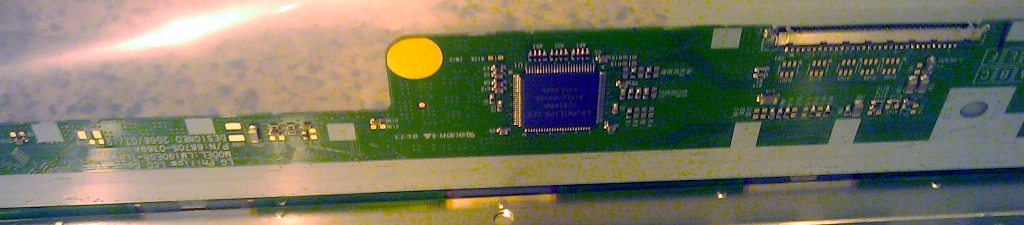

      Thanks. Located the 2A fuse on LCD panel board, it's blown. I better get some of those. Is there something typical defects to check for before replacing it with new one?
        Hello! Since there is a possible short somewhere in the panel and for testing purposes, consider temporarily soldering a glass type cartridge fuse holder across the pads of the old fuse (after of course, you've taken the old fuse out). You can use thin gauge wire from a old telephone or cat5 cable to connect the fuse holder to the circuit board. DO NOT bend the wires after soldering them to the circuit board, otherwise you'll lift the copper pad off the the board. Replacing glass type fuses will probably be much cheaper than replacing smd fuses. Once you figure out the problem, you can replace the above contraption with the proper smd fuse.
          What are these "AR13 and AR11" parts? Could they be 4 parallel resistors in one chip?
          MMC gives 100 ohms when measuring opposite sides. One chip has 2 of opposite sides shorted.
            Resistor arrays (also called resistor networks). They come in many different flavors, where they could be independent (straight through opposite sides) or tied together (have a common pin, sometimes marked with a dot).
              Thank you Wrog.
              I did some googling with array resistors and I guess that this is it 741X083 so I would have 2 of them to replace... but there is something like 0.3 mm to solder each pin in place. Looks pretty much impossible to me. Width of the array is only 1 mm.
