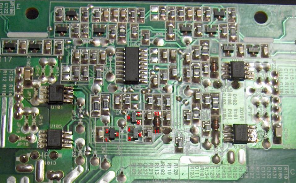

            Dear Plain Bill... your nightmare is almoast over, but only almoast
            I've just replaced bit3193, and there was still no voltage to vdd pin. I took 5V directly from conn1 to vdd pin and voila... monitor is working perfectly!
            So, obiously problem is somewhere three transistors that we mentioned earlier; by schematic Q101, Q102, Q103 or maybe zener 103 (i didn't measure voltage yet)
            New schematic of this board is here; thanks to Skhoda:
            https://www.badcaps.net/forum/attach...7&d=1283432613
            PS: to be honest, it's not problem to me not to have stby function so can i simply install switch at the bottom of monitor for turn on/off monitor?

              Hmm, I had asked you to measure those transistors back in post 36...
              SO: While taking 5V directly to the Vdd pin will work, you may want to go with a more elegant solution. With the schematic (Thanks, Skhoda) it's fairly easy to locate the faulty component.
              I've numbered the pins of the three transistors, and of the Zener diode. I will want you to make two sets of readings. The first will be with the jumper to Vdd removed, monitor plugged in, and power LED off. Measure the voltage from ground to each of the 11 points. Next, with the power LED on and active (blue or green, whichever this monitor uses) and a video signal being fed to the monitor, measure the same 11 points.
              Now for the fun parts. Those transistors have 'package codes' on the top. The one with terminals 4-5-6 seems to be 'PD' and two more letters at right angles. What are the codes on all three? For extra credit, which is Q101, Q102, Q103? Hints: Q101 has one pin tied directly to N/F. Q103 has one pin tied directly to U103, pin 10.
              PlainBill

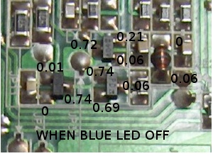

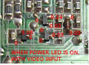

                Re: Xerox xa7-19i - ao4620 failed
                Oh gee, PlainBill can smile, it takes 50 posts for him to do it
                Ok now serious, here are the readings, and you also have the photos:
                Q102:
                PIN1: blue led off: 0V and when blue led is on: 3.08V
                PIN2: blue led off: 0.01V and when blue led is on: 0V
                PIN3: blue led off: 0.74V and when blue led is on: 0V
                Q101:
                PIN4: blue led off: 0.74V and when blue led is on: 0V
                PIN5: blue led off: 0.69V and when blue led is on: 0V
                PIN6: blue led off: 0.06V and when blue led is on: 0.03V
                Q103:
                PIN7: blue led off: 0.21V and when blue led is on: 0.24V
                PIN8: blue led off: 0.06V and when blue led is on: 0.03V
                PIN9: blue led off: 0.72V and when blue led is on: 0V
                ZD103:
                PIN10: blue led off: 0V and when blue led is on: 0V
                PIN11: blue led off: 0.06V and when blue led is on: 0.03V
                Codes of transistors are shown in pic.
                PS:
                from practical reasons, this is my "blue led off"
                this is my "blue led on"
                //serious off:
                Hmm, i did, and you said "The transistors (more likely dual diodes) you are getting so excited about are part of the voltage and current sense circuitry"

                  Wahoo!!! A smoking gun. According to the schematic, pin 5 should be at 14 volts - a direct connection. This could be due to a bad solder joint or a cracked land (trace).
