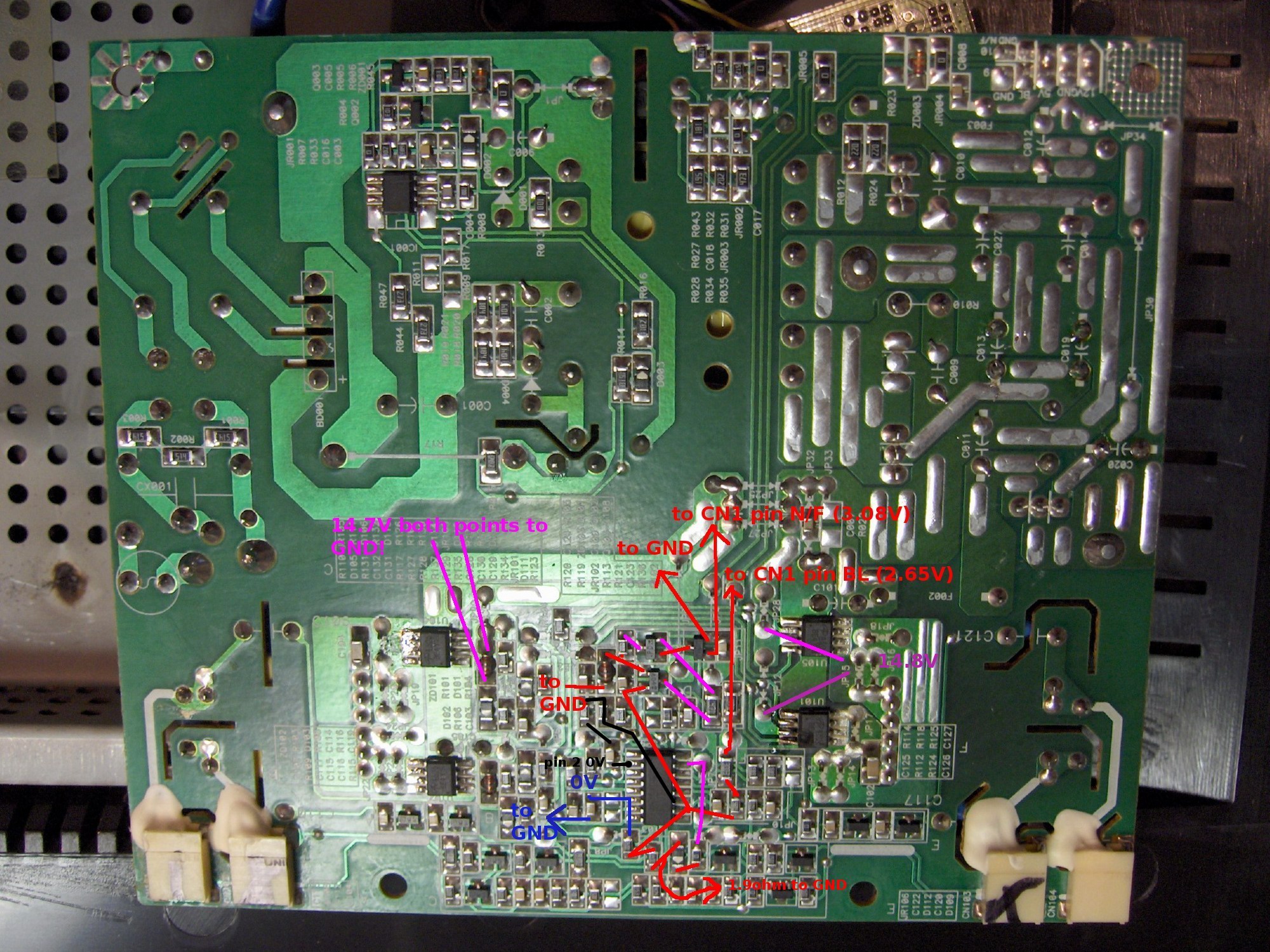

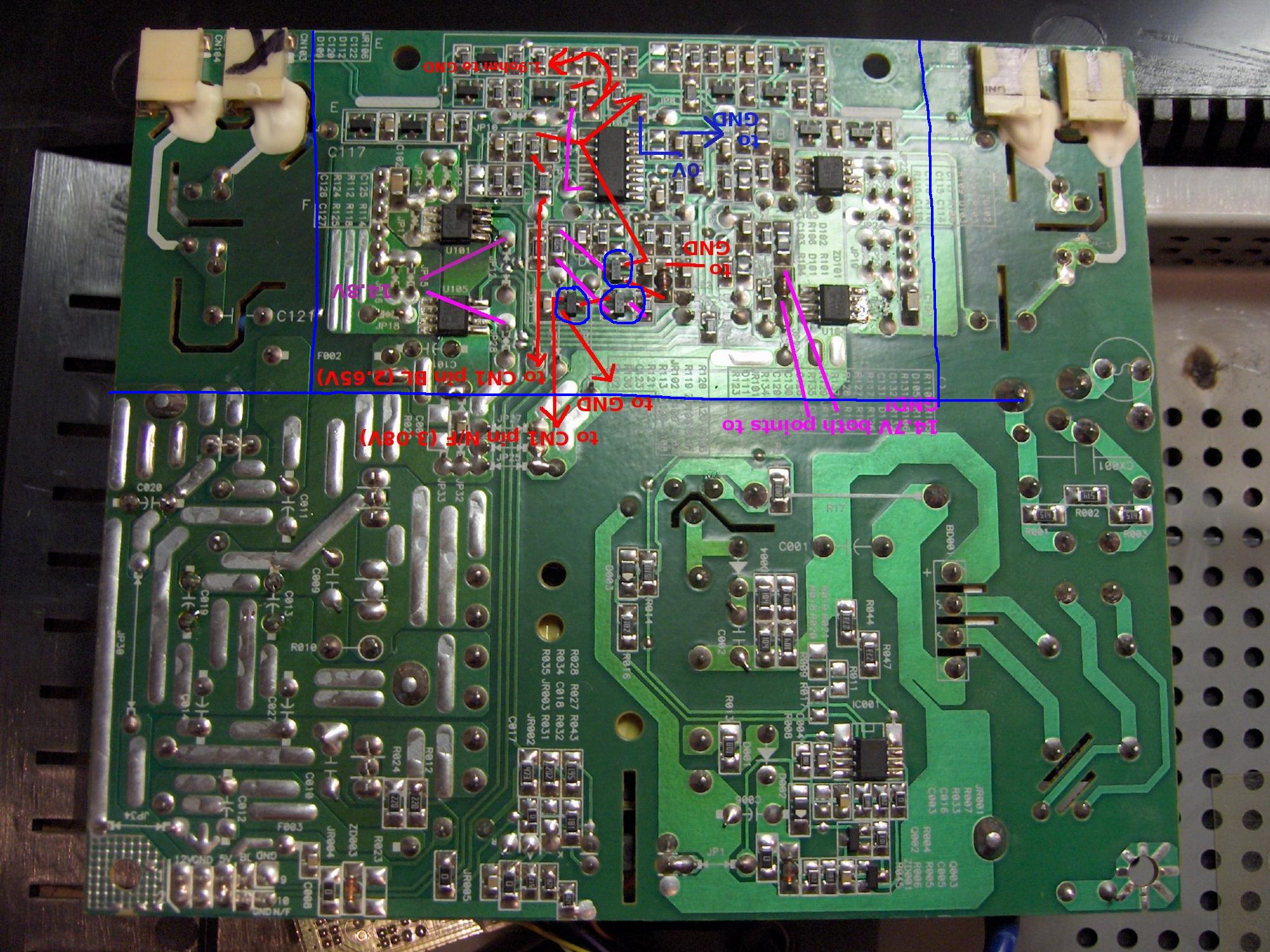

    Originally posted by emilije
    Don't know is this helpful to you, but i put my probes on almost every place near inverter controller. This is what i get, on most spots there is zero volts. From conn1 BL signal 2.65V is constant even monitor is in stdby (blue led blinks) N/F signal is 3.08V only when blue led is ON, otherwise iz zero volts.
    i took voltage measurement and with ohm meter to show you how the components are connected near bit3139 from pins ON/OFF (pin 6) and VDD pin (pin 10).
    That's a big help, but it does leave a few questions unanswered. Still, any progress is good.
    First of all, could you take ANOTHER picture, just covering the area within the blue box. Don't bother making any marks on it, I'll be supplying plenty.
    Next, I've circled three transistors in blue. Your picture is ALMOST good enough to read the numbers on them. What are the numbers?
    Third, Pin 2 of the controller IC is Vdd. Where does that connect (Gee, I guess I better let you mark that in.)

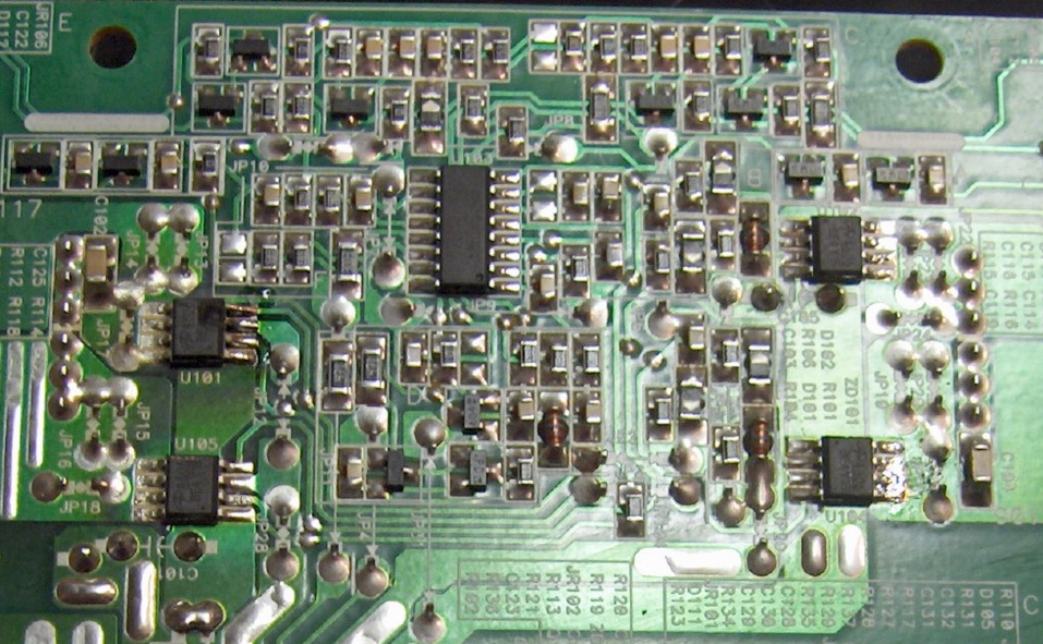

      Re: Xerox xa7-19i - ao4620 failed
      i don't have my camera anymore to post new pictures, so i have to handle with what i have i have crop and resize one of the good pics.
      I'm little bit confused, by datasheet of bit3193 pin 10 (red lines on my pic) is VDD, and pin 2 is error output? I added trace of pin 2, it goes to pin 11 - black lines on pic. Both pin 2 and 11 are zero volts.
      other pics are it attach. Those three trans you circled in blue are one that i was so excited yesterday
        Ahh, crud!!!!I was looking at the wrong datasheet. I guess that's what happens when I'm trying t figure out three different inverters. I saw the tracing you did from pin 10. That 1.9 ohms to ground is probably significant - it may indicate a shorted Zener diode.
        One possible reason for the unusual readings on those three transistors is at least one of them (PD) is a P-channel enhancement mode mosfet.

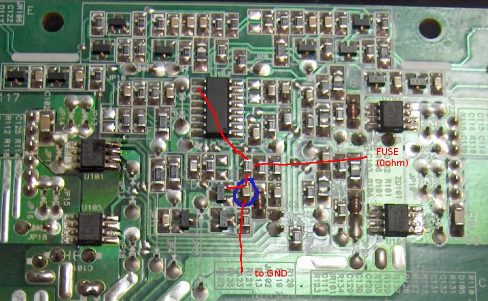

            think i got it... resistance from pin 10 to gnd is that famous 1.9ohm. When i gently desolder and lift pin 10, from pin 10 to gnd resistance is still 1.9 ohms. From pin 10 lines on PCB to gnd resistance is very high when pin 10 is desoldered and lifted away (140mega ohms). Is this sign that bit3193 is dead?
            PS: when pin 10 is desoldered, monitor won't power up (12V present, on 5V there is 1.88V, on backlight and brightness signals there is 1.3V)
            if u also think that bit3139 is dead, can u recommend some replacement? i can't buy it in local shops (still i can order it from ebay, but i will need to wait at least 10 days)
            • emilije
              • Aug 2010
              • 60
              oops, i forgot to mention. This cap (is it a cap?) in blue circle is 5-20-100ohms (oscilating) and little burned up.
              correction; without pin 10 and this cap monitor won't power up.
              final suggestions, what to use for replacements?
                If you are indeed reading 1.9 ohms, not 1.9K, yes it is.
                That makes absolutely no sense.
                The eBay deal strikes me as the best approach. But you can research if by Googling buy BIT3193
