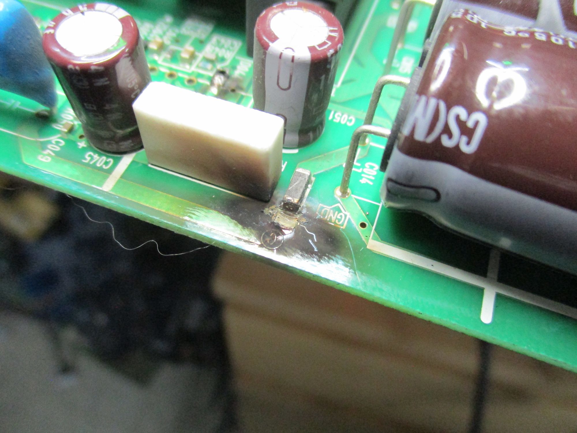

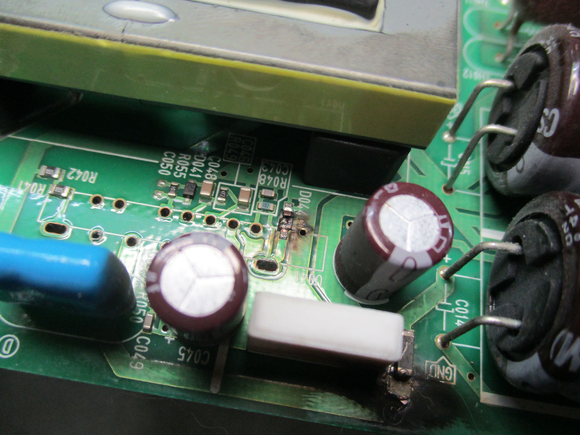

    Eizo ColorEdge CG277 power supply burned
    Got this monitor with a burned main track and diode, unable to identify. My feeling tells that this mysterious "MP2C5052" IC caused the damage, yet I'm unable to find any useful information about.
    The power supply model is "PCB-POWER 05A26240C1"
    Does anyone have either schematics or datasheet of this probably faulty IC?
    Thanks!

    Re: Eizo ColorEdge CG277 power supply burned
    This is a special part, I think your only hope is to buy one from the component distributors in China, or ask Eizo if they sell the board?
    The only data I was able to find is the attached document from the component manufacturer Fuji Electric.
              Hi!
              I'm currently trying to repair a CG277 with this exact same issue.
              Was in touch with a really great guy from Eizo (in Sweden), who informed me that:
              1. D044 and L041 are likely to be faulty. They are RB070M-30 and BLM41PG600SN1 respectively.
              2. Replacement power boards were surprisingly affordable through Eizo costumer support.
              • Bored repairs
                • Oct 2023
                I also have one of these.
                Thanks to Bubz I've found that D044 is short circuit.
                I also found that it is in just about the most awkward place on the board.
                I tried Eizo customer support (UK) but they absolutely refuse to sell a replacement board, they will however take it in for 'Inspection & repair' for £95 +VAT +parts!
                  Bored repairs: I paid about half that, for a brand new, revised version power board, including new cables (as the revised power board had different connectors).
                  I've since received it, swapped the board, and can report the screen as fully working again.
