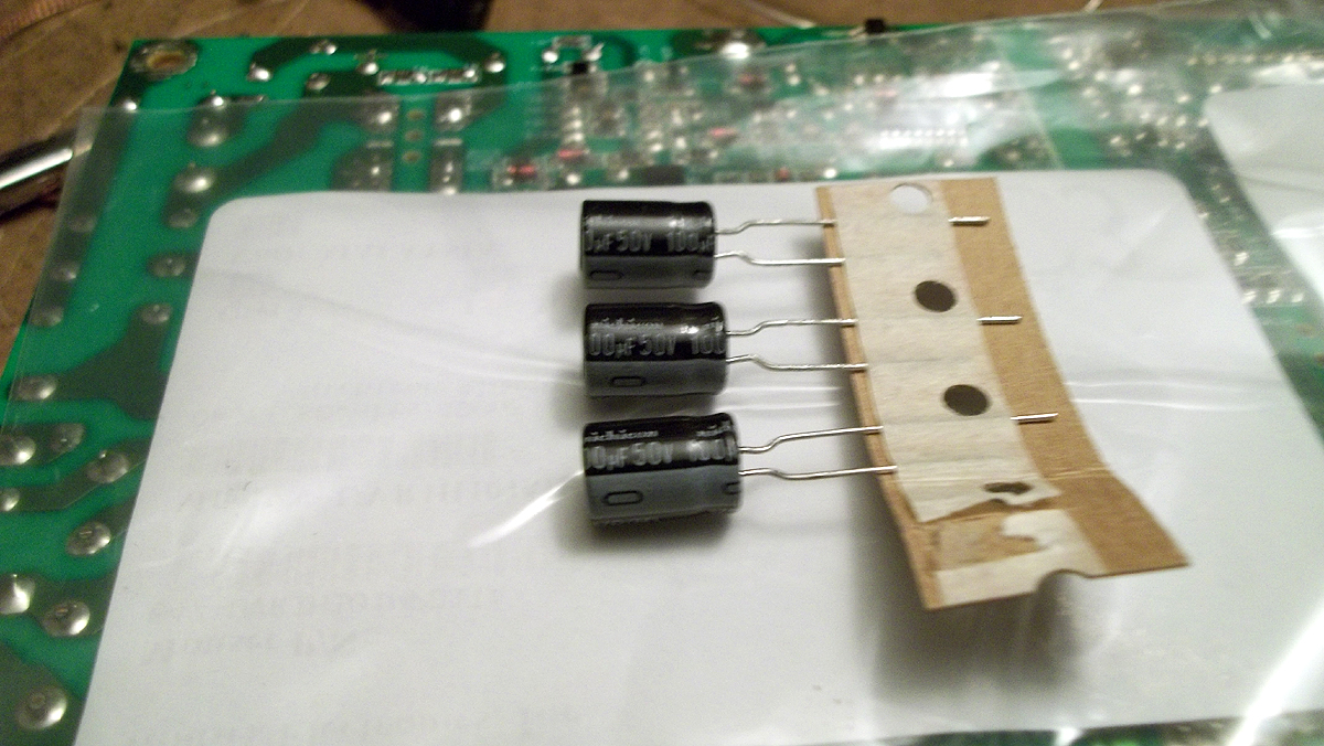

    Hi, this is my 1st post. I have a similar power problem with my HG281D. It would boot up normal and sometime it would go black. The on/off switch would be non responsive, I would have to click it 5-10 time to get the piture back for a few seconds. It would go out again, I repeat the above and it would stay on. If I let it in yellow stand-by it would come on OK for a few days, maybe a week until the problem startes again.
    After reading some of the post here I took it a part and noiticed bad solder connections on the smaller pCB, I guess this is a lodgic board? I ordered the kit for the PSB.

      Did you order the two caps (100uf 16vdc) by the voltage regulators on the main/logic board also?
      https://www.badcaps.net/forum/showth...427#post334427
      read post 427 and later.

                I believe the capacitor kit is for recapping the power supply board only, not including the caps for the main board.
                Did you try running the Video on PC at the lowest resolution to see if the screen will stay on yet?

                  Monitor is apart right now. I am doing both PCB's.

                    Are these the ones?
                      #50
                      Re: Hanns G HG281D 2 second black screen and parts help
                      R&R caps...I have 100Uf 50v for the Logic Board?
                      John.
                        #51
                        Yes, they should be low ESR type also. you can try regular one for now for testing.

                              UPDATE: All done and it works fine again, Thank you All for your Help!

                                    Sorry to resurrect a old thread, but I was having this issue too and replacing all 3 of 100uf 16v caps on the logic board fixed the issue for me. I salvaged some caps from an old usb2 pci card, so with a little extra work, it cost me $0.00. woot!

                                      I went off the list of parts from several different posts regarding this monitor and basically found I need to re-purchase about half of the capacitors. Obviously I would not blame anyone buy myself, but I have seen several mentions for a 1000 uF 25v capacitor when my board has a 680 uF 25v cap.
                                      I also purchased several others that are 120 uF replacing 100uF.
                                      I'm not worried about the above, but I've read higher voltage doesn't matter as much as the uF. Am I overreacting?
                                      In case anyone was interested, all the caps on the logic board are 25v and not 16v.
                                      I put it back together temporarily until new parts come, but now it displays a solid red color.
                                        #59
                                        Those two cap are for circuit with less than 5V, so 16V cap will be more than enough.
