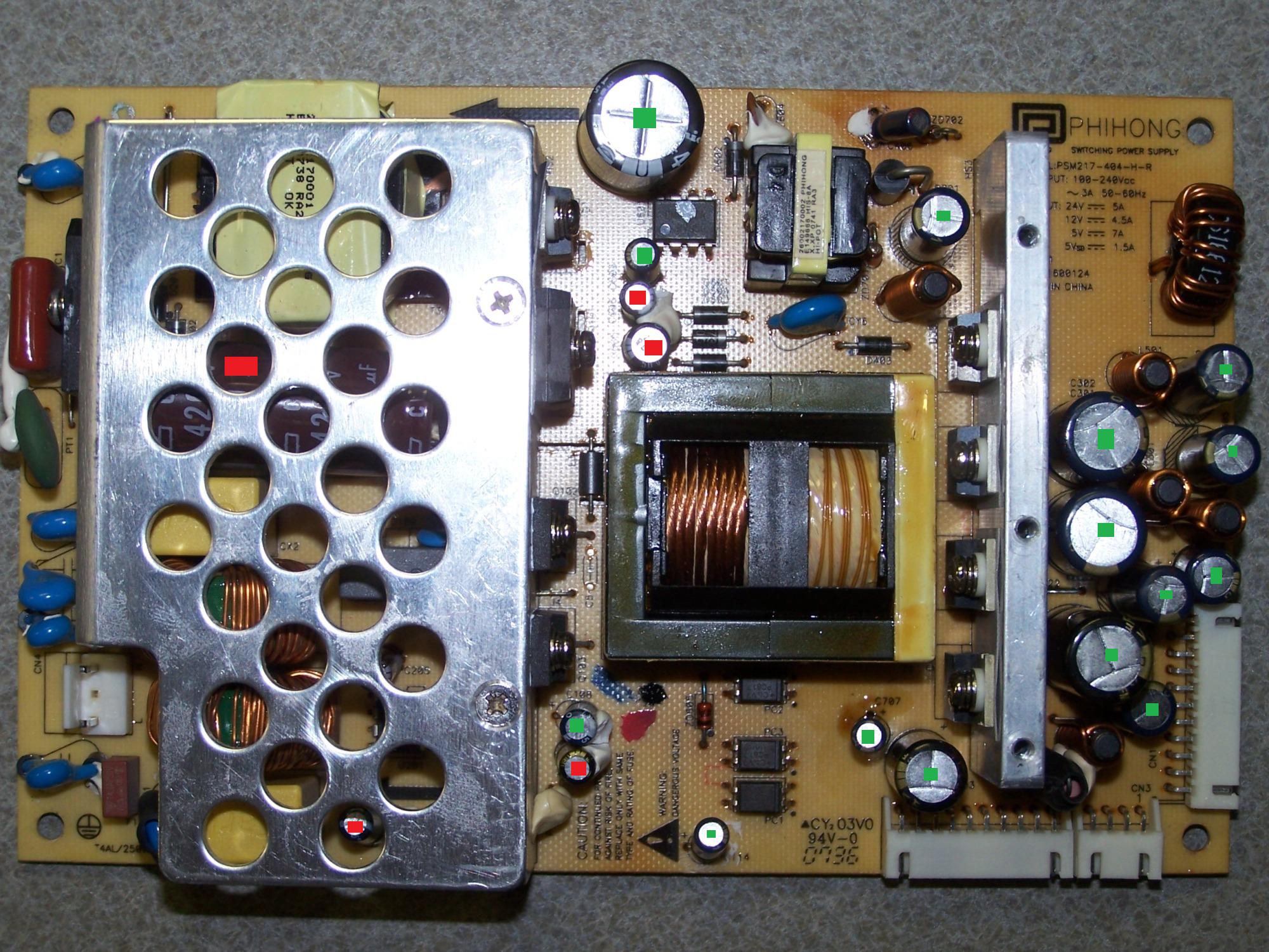

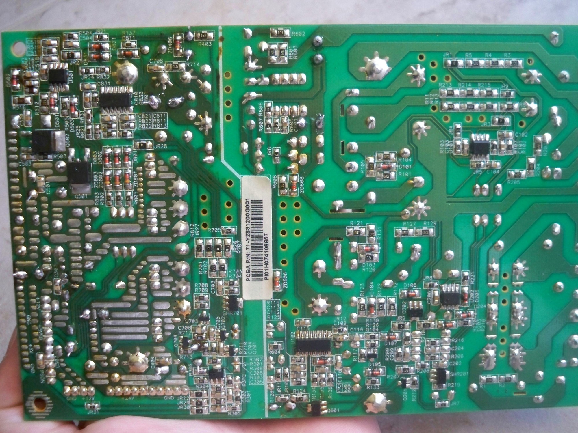

                    Re: Hanns G HG281D 2 second black screen and parts help
                    Here are some quality photos of the power supply board. I did find some cold solders that I will have to redo.
                    Can you guys spot anything unusual or give me a direction to check next.
                    The green boxes on the caps are the ones I've replaced and the red's are the ones I haven't (yet)
                    If you guys want more pictures let me know.
                      #30
