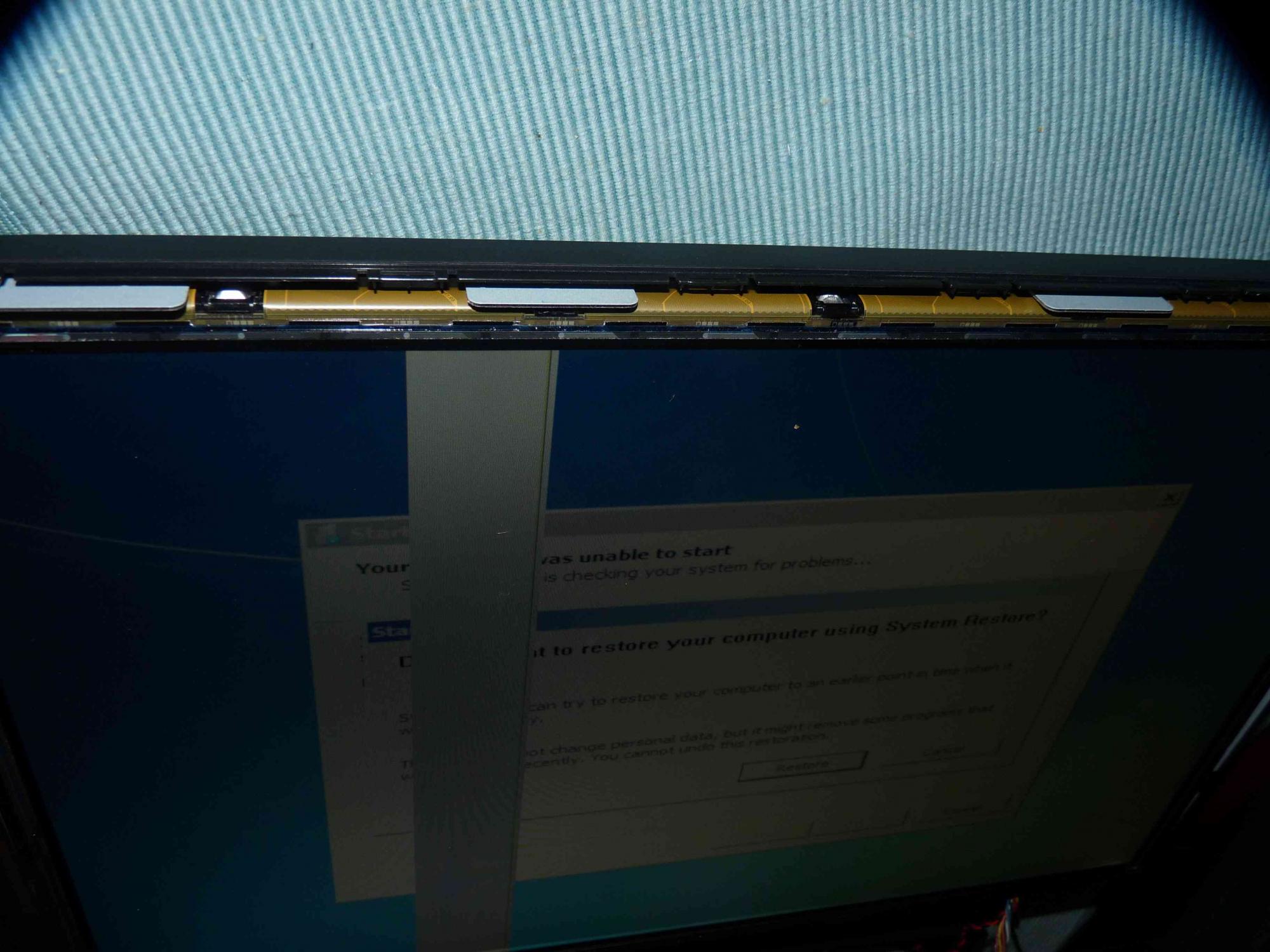

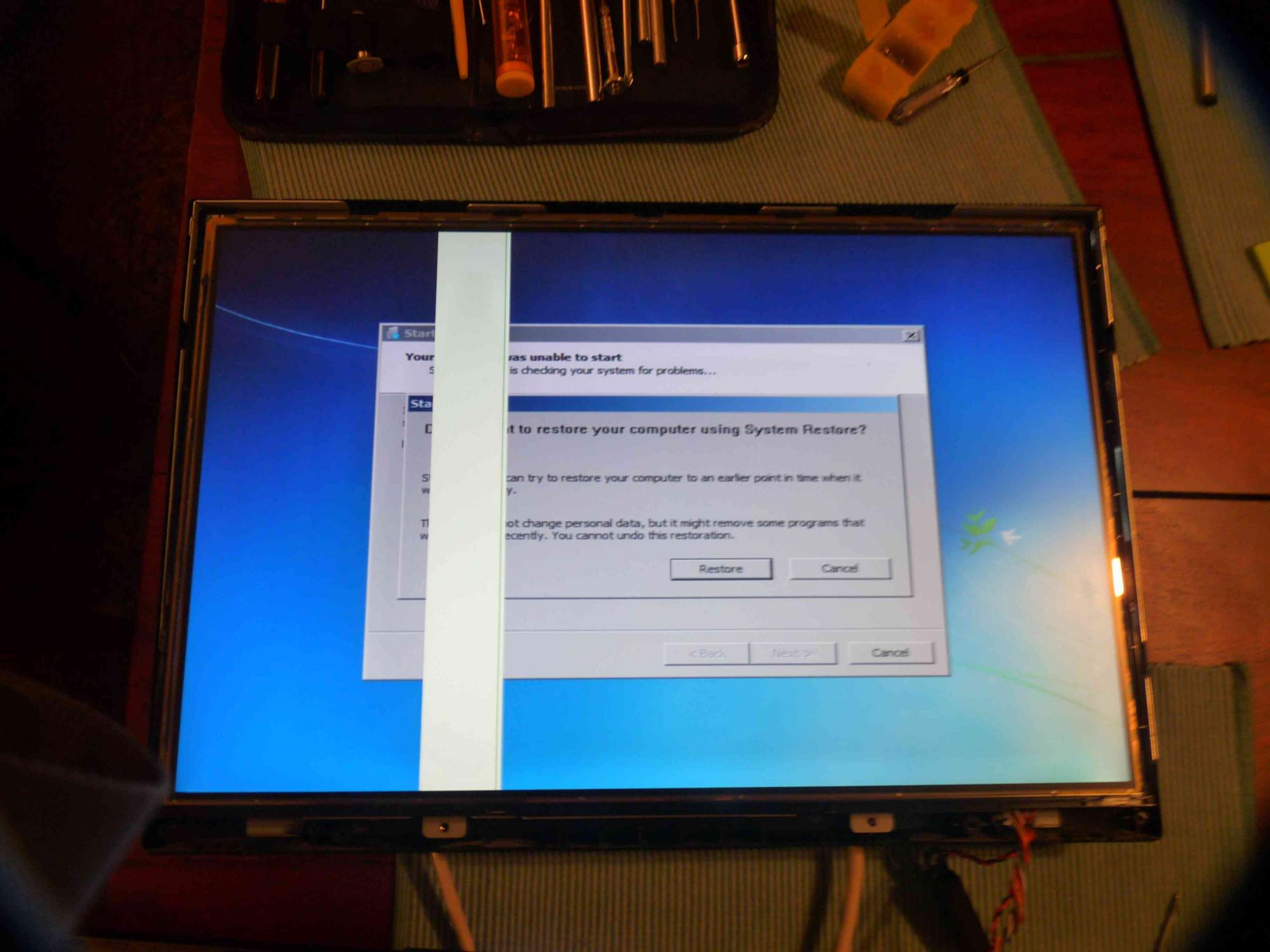

                        Replaced the CCFLs assemblies with new ones from CCFL warehouse. They fit and the backlights are working now!!!
                        Another problem has come up. There is now a approximately 1 inch wide light grey vertical bar running down the screen top to bottom half way to the right of center.
                        Checked connections, and wiggled wires with no change.
                        Am I sunk? Can anyone please provide any advise?

                          #32
                          Re: Scepter x20wg screen problems
                          Congrats!!
                          Pics? And which wires have you tried to wiggle?

                            • Jules3084
                              • Oct 2010
                              • 18
                              #34
                              The gray vertical barin the picture is the issue. It has appeared since replacing the CCFL
                              assemblies.
                              The ribbon cables along the top of the screen are the wires that when flexed would make other bars on the screen come and go, but this bar in the picture won't seem to go away.
                              • PlainBill
                                • Feb 2009
                                • 7034
                                #35
                                assemblies.
                                Bad news. One or more of the connections between the flex ribbon and the glass LCD panel is broken. "He's dead, Jim."
