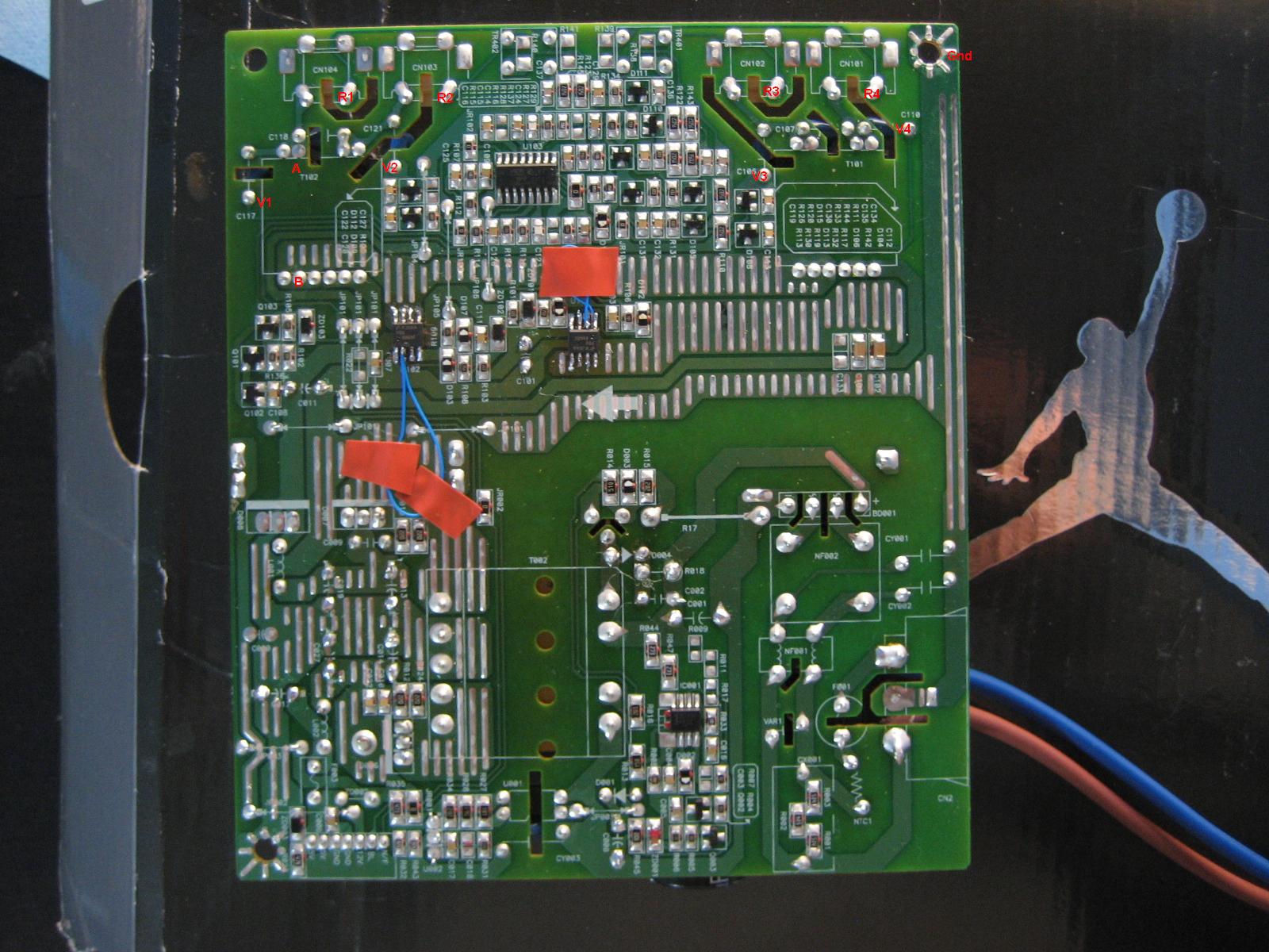

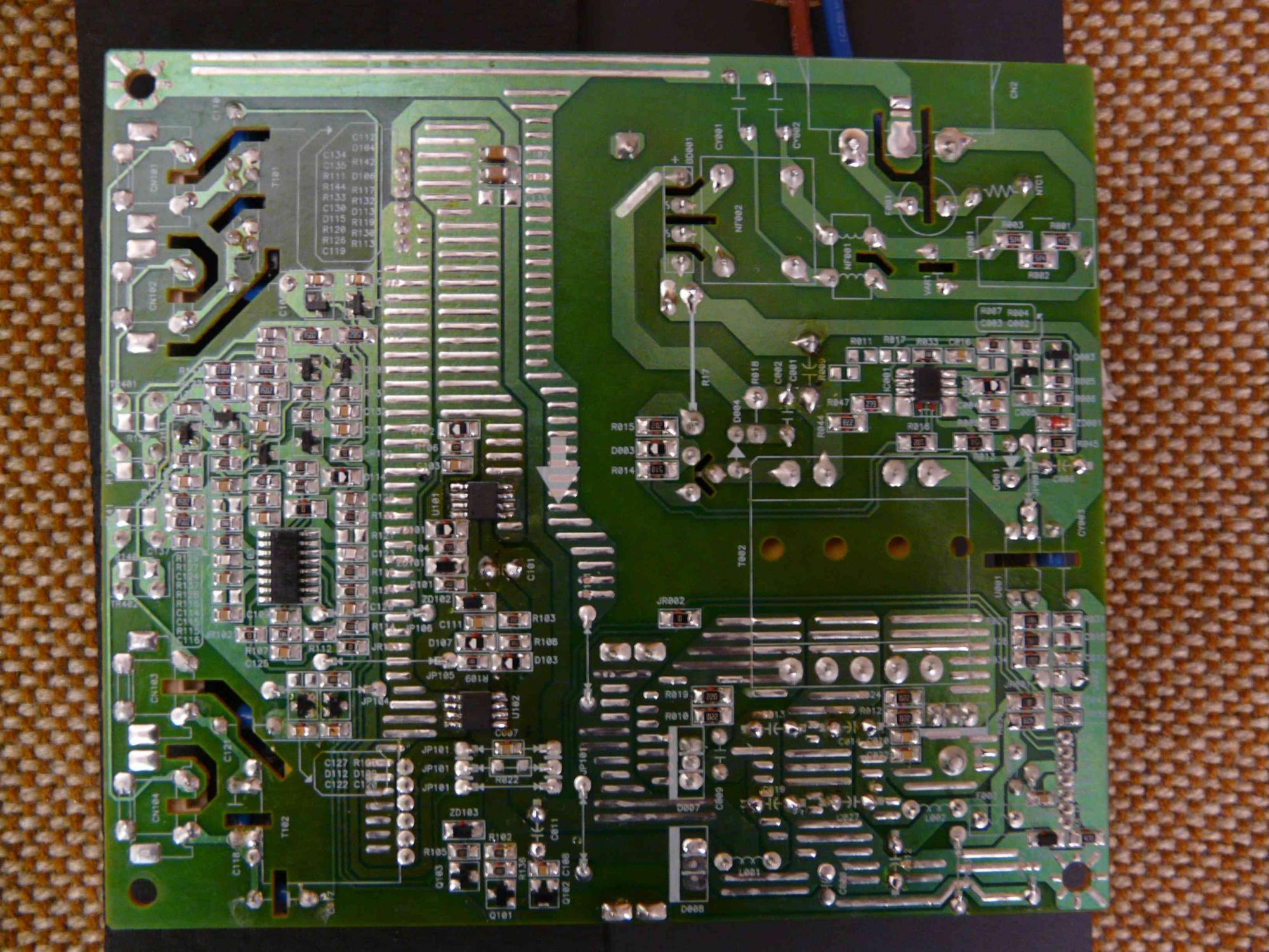

    I have a Scepter x20wg with problems of the screen going black, but then the front LEDs stay blue. So the LEDs are telling me that the x20 is still seeing an incoming signal from my PC. So after doing some research and looking around on the circuit board, I did discover some bad caps (which I replaced) I also noticed some board discolor around the 2 MOSFET ICs on the bottom of the board (so I just went ahead and replaced them too) But I'm still having the same problem, the screen only stays on for about 30s then goes black and the front LEDs are still blue.
    Any ideas?
    I'm going to just go ahead now and upload pics of the bottom and top of the circuit board, just because after reading through these forums that seems to be the first response back is asking for pics. (As you will notice from the pics on the bottom of the board the two jumper wires are there because I ruined the landing on one leg of the IC connections)

    The problem is referred to as the 'Two seconds to black' problem. One day Real Soon Now :roll: I'll write up a detailed explanation of how to troubleshoot it.
    Note the picture I defaced. The first step requires a DMM. Set it to the 2K ohm scale and with the power off to the monitor measure the resistance between A and A'. Then measure the resistance between B and B'. What are the readings (as accurately as possible)?

      After testing both spots (A to A') and (B to B') I got the exact same reading on both which was 623 ohms.
        Re: Scepter x20wg screen problems
        The good news is that it is not a transformer. The bad news is that we must try to identify the bad component. The good news is that the transformers can be difficult to locate. The bad news is that now we get into tests that involve high voltage and enough current to hurt you.
        FIRST, one more safe test. What is the resistance from A to B on the attached picture? (Measure with monitor unplugged).
        A little background. The inverter controller in this monitor first turns on all CCFLs at full brightness. After a fraction of a second it reduces the drive to normal levels and monitors the voltage across and current through each CCFL. If any of these are out of the proper range, the controller shuts down the inverter.
        The following tests will be done with the monitor operating. Both the AC supply (120 VAC in the US; 240 VAC in some countries) are enough to hurt you. The rectified line voltage (1.4 times as high as AC supply) will also give you quite a jolt. As long as you aren't doing something foolish such as working in a damp basement while sitting on a metal chair and holding onto a cold water pipe with one hand it's unlikely to be fatal. The inverter output also has enough voltage and current to hurt. So be careful. I recommend having an assistant who will press the power button on the monitor while you hold the probes
        There are eight readings to take. I've marked points V1 through V4 (the voltage sense lines) and R1 through R4 (the current sense lines). I have also identified a ground point.
        The process goes like this. Set the meter to the 20 VAC range. Black probe goes to Gnd, red to the point under test. The assistant pushes the power button, the CCFLs go on, you get the reading, the CCFLS go off, the assistant presses the power button again TWICE, the CCFLs come on again, you verify the reading and write them down. Repeat for the other 7 test points.
        The 4 Vx test points should read approximately the same, the 4 Rx should also read fairly close together.

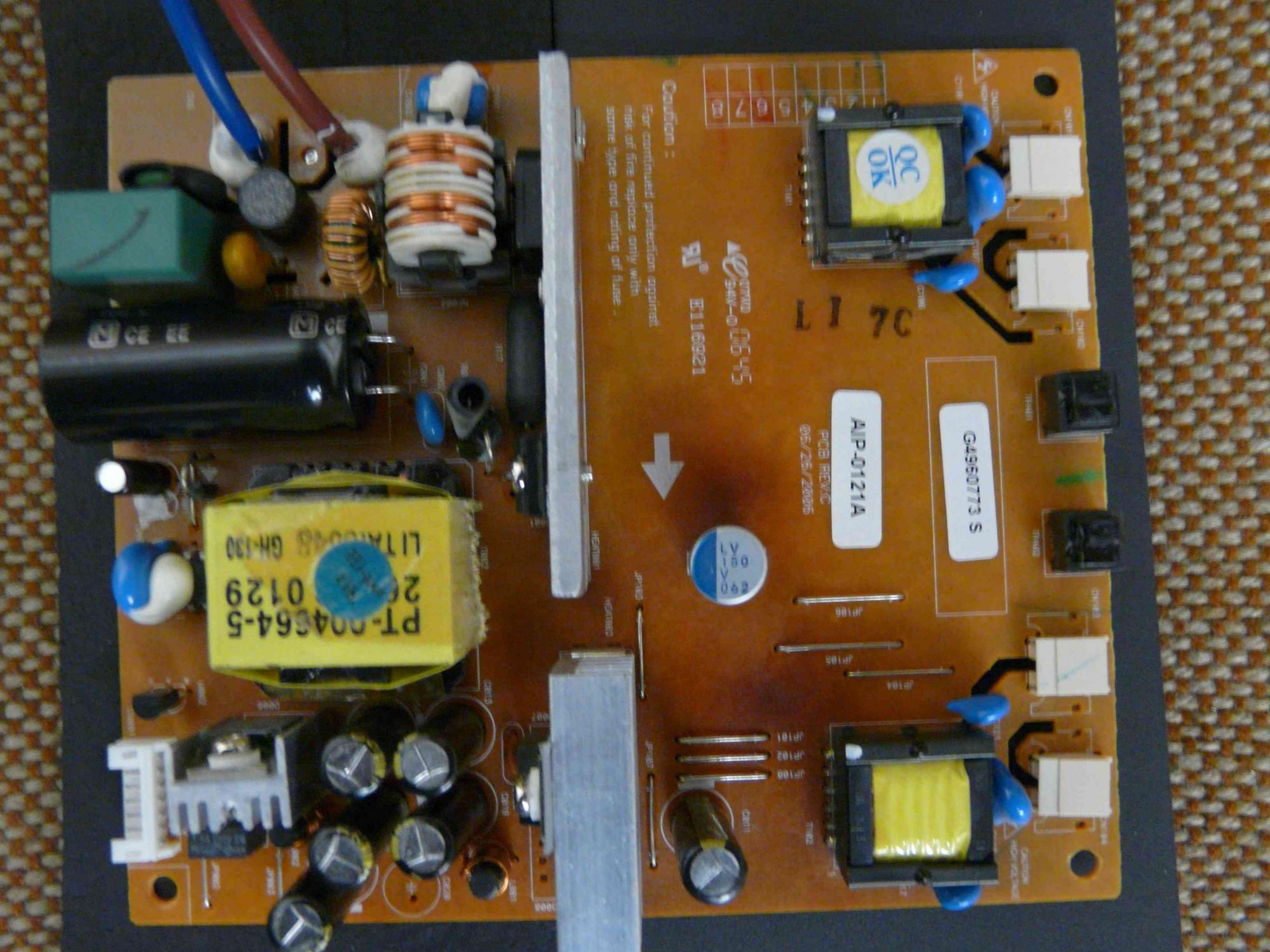

              Pictures of the Sceptre X20WG inverter board are attached.

                  Interesting... did you replace C101 (center topside, below and to the right of the big arrow) with a poly cap instead of an electrolytic?

                    Yes, the electrolytic C101 was replacxed with a poly cap. The one
                    that was in there had the top cap expanded. I thought it would be a better
                    cap since it has higher ripple current rating than a standard electrolytic.

                      For all the people reading this in the future, this is an excellent example why we request pictures of *your* particular board. Some people are lazy and say "it looks like the board in post xx", while in reality there are minor, but important changes.
                      So without a pic, Wrog would have never spotted that poly cap.
                      I'm not an expert in area, but I would suggest swapping that out back to an electrolytic.

                          The first time around, I had a standard electrolytic in the C101 position because it was obviously bad with the expanded top. It was replaced with the U101 and U102, the
                          4511GMs as stated in my earlier post. All the caps were then changed so in the future I wouldn't be dealing with old caps one at a time.
                          All along the symptoms have been the same.
                          I'm going to guess that a bad ccfl is shutting down the inverter.
