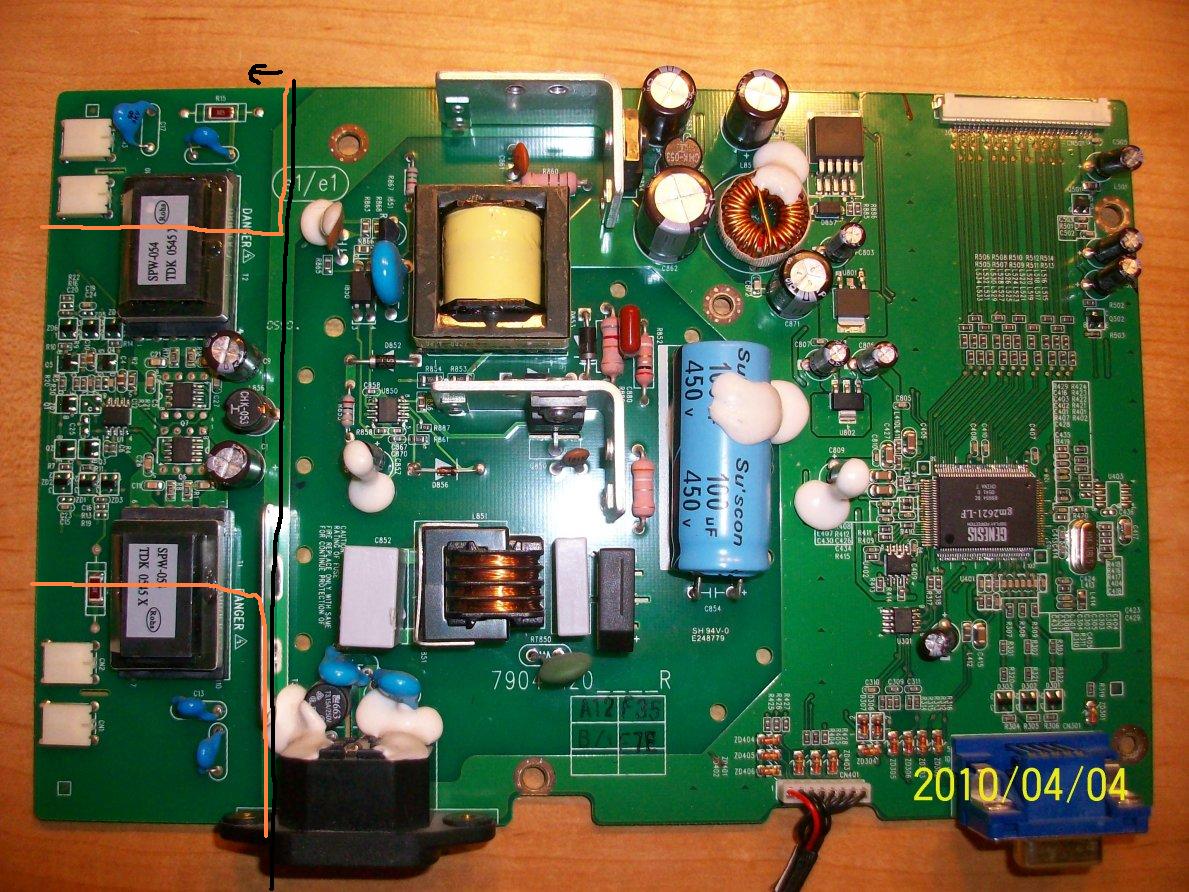

    Hello, I have been given this Dell E176FPf 17" lcd
    It has the classic backlight switches off after a couple of seconds problem.
    I have done a visual inspection of the components to the best of my (very limited) ability, and it seemingly looks OK
    Where do I start diagnosing this?
    I dont have a strong electronics background, but would love to fix this monitor!
    Many thanks

    Su'scon are known crap caps. i'd replace them all (except the 100uF 450V primary filter cap as those rarely fail)
    according to this thread (*click*) the caps are most likely gone high-ESR without showing signs of failure, and a resoldering of the board (especially the transformers) could help.

          Profile updated to include my locale
          01 Su'Scon 220uf 25V SG 105ºC 0538(V)
          02 Su'Scon 220uf 25V SG 105ºC 0540(V)
          03 Su'Scon 10uf 50V SG 105ºC 0538(V)
          04 Su'Scon 470uf 25V SG 105ºC 0540(V)
          05 Su'Scon 470uf 25V SG 105ºC 0540(V)
          06 Su'Scon 1000uf 25V SG 105ºC 0544(V)
          07 Su'Scon 47uf 16V SG 105ºC 0540(V)
          08 Su'Scon 680uf 16V SG 105ºC 0539(V)
          09 Su'Scon 47uf 16V SG 105ºC 0540(V)
          10 Su'Scon 47uf 16V SG 105ºC 0540(V)
          11 Su'Scon 47uf 16V SG 105ºC 0541(V)
          12 Su'Scon 47uf 16V SG 105ºC 0540(V)
          13 Su'Scon 4.7uf 16V SG 105ºC 0540(V) (might 4.7uf be a printing error?)
          14 Su'Scon 47uf 16V SG 105ºC 0541(V)
          15 Su'Scon 47uf 16V SG 105ºC 0540(V)
          Close up of Cap #13

                        OK I have replaced all caps on the board, took my time and did a good job, everything is exactly like it was before - no change at all.
                        What should I be looking at next?

                          Check T1 and T2 underside for dry/cold solder joints. If this is a Benq board OEM for Dell, many have suggested this could be an issue.

                            I removed all the older solder from the underside of T1 and T2, resoldered - same again.

                              If it isn't obvious, this is a classic example of the 'Two Seconds to Black' problem. Now we have to figure out why the inverter controller is shutting things down.
                              I have marked up one of the pictures; I would like several more to make the circuitry easier to view.
                              1. A picture that includes all the area to the left of the black line in the attached picture. Rotate the board so the picture will be in landscape orientation
                              2. A picture covering the same area, but of the back of the board.
                              3. If you can do it, pictures of the back side of the board showing only the area around each transformer - the area outlined in orange.
                              Also, there is probably a 16 pin IC on the back of the board in the inverter area. What is the part number?

                                  Took me awhile but I googled those TDK parts.. those are special transformers for the lamps.. looking at your photo each pair of lamp wires is attached to each one, so those may be at fault.
                                  Usually you'll see a pair of 2SC707 ( or similar) transistors in line with the lamps, but not on this monitor.
                                  http://pdf1.alldatasheet.com/datashe...CTSPW-054.html
                                  Hope this helps!
