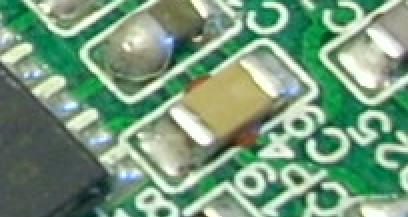

                      Another observation, could this be a bad capacitor? There seems to be something red on sides of it.
                        #31
                        Re: HP w20 LCD Display Inverter, running out of options.
                        Glue, probably.
