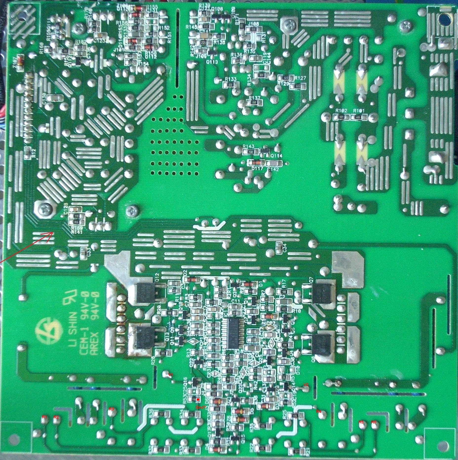

    Here are the voltages (pin):
    start time
    4.83 (2)
    1.21 (5)
    3.02 (7)
    4.78 (10)
    10 minutes
    4.85 (2)
    1.22 (5)
    3.04 (7)
    4.81 (10)
    35 minutes
    4.87 (2)
    1.23 (5)
    3.04 (7)
    4.82 (10)
    45 minutes
    4.87 (2)
    1.23 (5)
    3.05 (7)
    4.82 (10)
    1h 4 minutes, just after lights went off
    4.96 V (2)
    0.00 V (5)
    3.11 V (7)
    4.91 V (10) (Lights are off but there is still almost 5 volts here)
    restarting (off/on)
    4.87 V (2)
    1.22 V (5)
    3.03 V (7)
    4.80 V (10)
    Voltages for 10 & 7 when switched off
    0.12 V (10)
    0.19 V (7)
    Looks good to me. What should I do next? All I can see is that ISEN and VSEN drop to 0 when lights go off.

      Again, good work. The reading at pin 10 proves the inverter is shutting off due to a fault condition, not a command from the logic card. There is no point in monitoring pin 5, we know that won't cause the controller to shut down. Either the voltage on pin 6 is triggering it, or the controller itself is bad.
      Try this. Place a pair of switching diodes (1N4148 or equivalent) in series from pin 6 (anode) to pin 14 (cathode). This will clamp the voltage at pin 6 to no more than 1.7 volts. If the inverter still shuts down, the controller is bad. If it doesn't shut down, we will have to troubleshoot the individual inputs (Oh, joy!!).

        Thank you PlainBill. I finally managed to get two 1N4148's today and soldered them to IC as you suggested.
        I'm not sure should I say Oh joy . I've been burning it now for 4 hours and it does not shut down anymore. So the controller is good? How can I troubleshoot inputs?

          #64
          Re: HP w20 LCD Display Inverter, running out of options.
          With great difficulty. There is a LOT of circuitry involved and I've never figured out how this particular design works. Let's give it the old college try.
          Early in this thread you indicated the brightness would increase, followed by shutdown. Is the brightness still increasing with the diode blocking the shutdown?
          I've marked up the picture of the bottom of the board. First of all, I've dotted one end of R53. Is that point connected to ground (pin 14 or 16 of IC1)?
          What are the numbers on R53?
          I've marked 6 points R1 - R6. These are the six return lines from the CCFLs. Measure the voltage on them first at turn-on, then after the brightness (would have) increased.
          I have also marked two points V1 and V2. These are the voltage sense lines from the inverter outputs. Again, measure the voltage at turn-on and after the brightness (would have) increased.
            No, backlights don't shutdown now with diodes is place and brightness seems to stay normal. Brightness increase used to happen just split second before shutdown.
            Yes, it's grounded with pins 14 and 16. It's marked as "91R0". Multimeter says it's 91.5 ohms. R52 on "mirror" side is alike and also grounded.
            PlainBill
            Should I remove diodes and use monitor untill backlights go off. Then I might get some readings by turning it on and off like when measuring IC. I need to get measure points out of the monitor again. Just to be on safe side, are we talking about huge voltages on points R1-R6? My multimeters max is 600V and these spots are so connected to CCFL's...

              First, I must be honest. I don't full understand what was causing the failure. The inverter is designed to produce a constant current through the CCFLs. One possibility was one of the transformers on the return lines was intermittent. When it failed to sense the current from one or more CCFLS the controller would increase the output, thus tripping the over voltage protect. You have indicated the brightness no longer increases, which shoots down that theory. The other possibility is that there is a problem with the OVP circuitry.
              Points R1-R6 are the return lines, and should have voltages of less than 2 volts; well within the range of your meter. Likewise, V1 and V2 are after a voltage divider capacitor. The voltages at those point should also be quite low.
              However, I have had several meters die an untimely death because of inadvertent application of high voltage and would prefer not to be responsible for it happening to others. I've marked up the areas to avoid.

                Thanks again PlainBill I really appreciate your advices. I don't understand this neither. I did factory reset for this monitor when I started with it and I keep wondering why on earth I've spent 120 hours and 113 backlight hours with it already. I must be insane. Luckily enough others are involved too so I'm not the only crazy one here.
                I've been using this diode "hack" of yours and monitor stays on forever (allready 6 hours now) without any problems. I may not have knowledge or experience required to make any good guesses but I'm starting to believe that there is indeed a problem in OVP circuitry as you mentioned. (shame on me, I have no idea where it it or how it works).
                - Monitor stays on with perfect picture and stable brightness god nows how long when diodes are in place.
                - There is nothing wrong in CCFL's as another board works fine with them.
                - There is no overheating problem. REV 3 monitors temperature is 51.1 centigrades and my failing REV 2 monitor is only 47.1 centigrades measured at exactly same spot above circuitry with same 50% brightness.
                I will measure R1-R6 and V1 - V2 next but I suspect that OVP circuitry is bad and does something it should not do...

                  That is very likely.
                  I've attached a schematic of a typical inverter, which will give you an idea of what we are dealing with. C8 and C13 they form a voltage divider. The significant point is that the voltage at the junction is a very small fraction of the output voltage of the transformer. Something like 22/33022 to be exact. CR2 shunts the negative spikes to ground while passing the positive spikes to C16 and R14. C14 charges to the peak value (less 0.7 volts) of the positive spikes.
                  Yours has some differences. The first is that on yours C13 has been replaced with a resistor. The second is there are two such networks.
                  Back to the schematic, CR1, R16 and R15 for a network to feed a voltage representing the current through the CCFLs back to the inverter. Yours is much more complicated. I don't really understand how yours works, hopefully I will find a schematic of a similar inverter.
                  Clearly, yours has an intermittent problem. The diodes I had you add should not stop the intermittent, they only prevent it causing a shut down. I am hoping that by measuring the return currents and the output voltages when the monitor is first turned on, and again after it would normally fail we will be able to identify a particular path that causes the problem.

                              #74
                              Maybe this explains voltage differences?
                              R1 1.22 M ohms to GND
                              R2 92.2 ohms
                              R3 92.2 ohms
                              V1 92.2 ohms
                              V2 92.2 ohms
                              R4 92.2 ohms
                              R5 1.12 M ohms
                              R6 92.2 ohms
                              That would do it. Now why the different resistors?
                              PlainBill

                                #75
                                The fog has just lifted from my brain. We don't have to know HOW those transformers work, they probably aren't in the fault detection circuit anyway. We just have to figure out where the voltage spike is coming from.
                                To that end, here are a couple of things to try. I've circled the low voltage end of the two high voltage caps used in the sense circuitry. As a first step, I suggest grounding both those points. The easiest way might be to solder a short piece of wire across the locations for C19 and C25 (verify those actually short it to ground). Then test the monitor for a minimum of several hours - longer is better. If it doesn't shut down, we can be sure the problem is coming from one of those two points.
                                If it does shut down, we know something else is feeding in a fault signal.
                                PlainBill

                                  #76
                                  Thanks PlainBill. Before I try that shorting to ground, what do you think about these disconnected spots?
                                  I really can't figure out why they would build circuitry with several resistors and capacitors not connected from another side. Could this be on purpose or might it be a manufacturing defect?
                                  At least R45 might be involved with current sense feedback (PIN 5 in IC) if CP1 would be connected. And on the other side PIN 13 (timing capasitor) might be missing two caps because CP7 and CP8 are not connected.
                                  I did not notice these before I had this better image and started measuring different points here.

                                    #77
                                    This is quite common. In many cases one board will be designed for several different applications, and depending on the needs only certain parts will be loaded.
                                    At one point in my checkered career my employer used the same board for about 20 different products. Depending on the configuration the board could be fully loaded, or each input channel could feature a single jumper from input connector to the multiplexer, with 75% of the board unused.
                                    PlainBill

                                      #78
                                      Seems to me that CP7 would connect C36 parallel with C12 and CP8 would add a cap C35 parallel with C10 adding some capacitance.

                                        #79
                                        PlainBill
                                        Thanks PlainBill.
                                        Points are now grounded. I had it on 3,5 hours without any problems, finally I set brightness to 0 and back to 95 several times. No problems whatsoever. I had to quit testing for a while, but I'm running it again now to make sure.
                                        What if it does not shut down? Should I remove one wire at a time to see which side is failing?
                                        P.S. I got brief access to that REV 3 monitor again. Measured about half resistances for R1 & R5 compared to this REV 2 board.
                                        R1 0.68 M ohms to GND
                                        R2 98 ohms
                                        R3 98 ohms
                                        V1 98 ohms
                                        V2 98 ohms
                                        R4 98 ohms
                                        R5 0.68 M ohms
                                        R6 98 ohms

                                          #80
                                          Thanks PlainBill.
                                          R2 98 ohms
                                          R3 98 ohms
                                          V1 98 ohms
                                          V2 98 ohms
                                          R4 98 ohms
                                          R5 0.68 M ohms
                                          R6 98 ohms
                                          Exactly, remove one jumper at a time. Then we start identifying what is causing the failure.
                                          PlainBill
