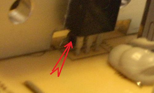

      I'll try to figure out how to arrange voltage change measurement on inventer. I have only a simple multimeter, limited tools and no schematics whatsoever so I need to find out safe measurement points. I've no idea on where brightness control voltage can be measured.
      Hot capasitors are Rubycon, they are between 2 heat sinks (Attached image), and I don't think heat sinks make them hot.
        I resoldered lots of connections earlier today and put the monitor back together. Now it took about 50 minutes before backlights turned off so something is maybe better now as it used to serve only 15 minutes.
        Something else I noticed, high frequency twirling sound comes out just before backlights turn off.
        P.S I've fixed only some motherboards with blown caps and DC stuff mostly so I may be out of my league with this TFT and AC powers in it. I rather wear rubber boots and keep my other hand on pocket when touching active device .. or measure stuff when they're off board... ;-)
        Hot Dawg!!! An audible clue. A high tech piece of equipment such as a 'Sonic Sniffer' might help locate the source of the 'high frequency twirling sound'. If you don't happen to have one in your shop, perhaps you can find a substitute in another room of your home. A cardboard tube, such as teh core from a roll of paper towels or toilet paper will do the trick. Hold one end to your ear and aim the other end at possible candidates for the source of the noise. (The most likely suspects would be the inverter transformers and the main smps transformer.)

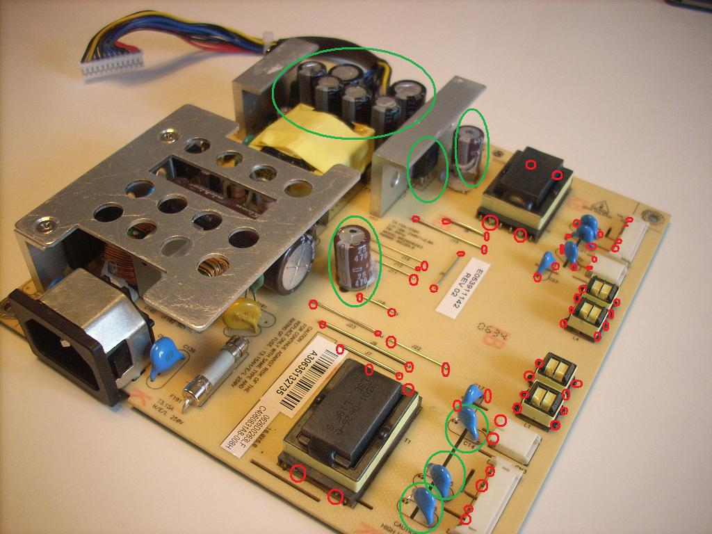

                                It seems I still need some expert help with this one.
                                1) In the beginning monitor stayed on for 15 minutes, then backlights went off.
                                2) After resoldering and applying freezer to components I thought that I finally located possible problem to HV caps on bottom side inverter. Cooling them got me extra time so I ordered new HV caps and replaced them but not too much improvement was gained so I thought that there must be cold joints nearby and resoldered all I could.
                                3) As 1000uF and 1500uF caps were really hot after 10 minutes and schottky was making noises, I changed 1000uF, 1500 uF and 470 uF caps to LOW ESR versions and replaced B20100G schottky with new one.
                                4) Now I have 1,5 hours of operating time with perfect image even when backpanel is attached... and then again backlights are turned off. It's better now than the original 15 minutes... but I still don't know the problem. No audible clues anymore.
                                5) Letting the monitor cool down for about 15-20 minutes I get another 1 to 1,5 hours of operating time, no problems whatsoever and then again 2 secs to black.
                                6) When I try to restart the monitor when it has failed the 2 seconds to black problem occures until 15 to 20 minutes have passed, then it starts and stays on again for 1,5 hours.
                                I'm going to mental asylum with this one. Help please... Should I start inspecting CCFL's? Is it safe to measure voltages there with normal multimeter?
                                P.S. In attached image red ones resoldered, green ones replaced.

                                  3) Is there a cap underneath that heat shield? Just right of the big cap on its side. If yes, did you replace that one?
                                  4) Just curious if what settings you have for contrast and brightness. Is it at "torch" mode where brightness is 90+? If yes, try 35 for brightness and 35 for contrast to see if you get longer running time?
                                    Thanks retiredcaps, there is indeed something underneath it but I did not know what it was. There is no any markings on it. I remember I measured it earlier today thinking by the looks of it that it must be a diode but it eventually acted like a capasitor. I did not pay too much attention to it. Do you have any idea what capacitance it should have? I have no schematics.
                                    Yes, I tried a torch mode and I tried to reduce brightness to 20. There was no noticeable difference in operating time. I will try this again now as I've changed lots of parts since I tested this.

                                      What does the circuit board say? If it starts with a C it is a capacitor. Something like C204.
                                      --- begin sig file ---
                                      --- end sig file ---
                                      • CapBlown
                                        • May 2010
                                        • 93
                                        Re: HP w20 LCD Display Inverter, running out of options.
                                        It's L106. Some sort of choke perhaps?
