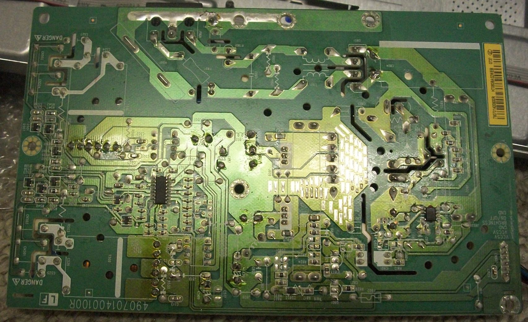

                I found one of these monitors in the recycle box plugged it in and nothing. No LED or picture. I opened it up and found two bulged caps. Replaced all caps & put the boards back on the display and hooked up both power and VGA.
                Gateway splash screen shows up followed by a bar with red green and blue sections. Then the monitor goes blank. The blue LED lights up and stays solid until the screen blanks at which time the LED turns orange. The on/off button will turn the monitor off and on and I get a repeat of the description above.
                Before putting the power board back together with the video board and screen I checked the two fuses which were good and the voltage on the large cap (173v) and the bridge rectifier also (173vac) I tried checking voltage at the connector between the PB and Video board. I could not get a reading on the two 5v pin or on/off pin or the other pin (brightness) (6 total) last one is ground all read in the mv range and those readings were bouncing around.
                Any ideas on what I should look for next?

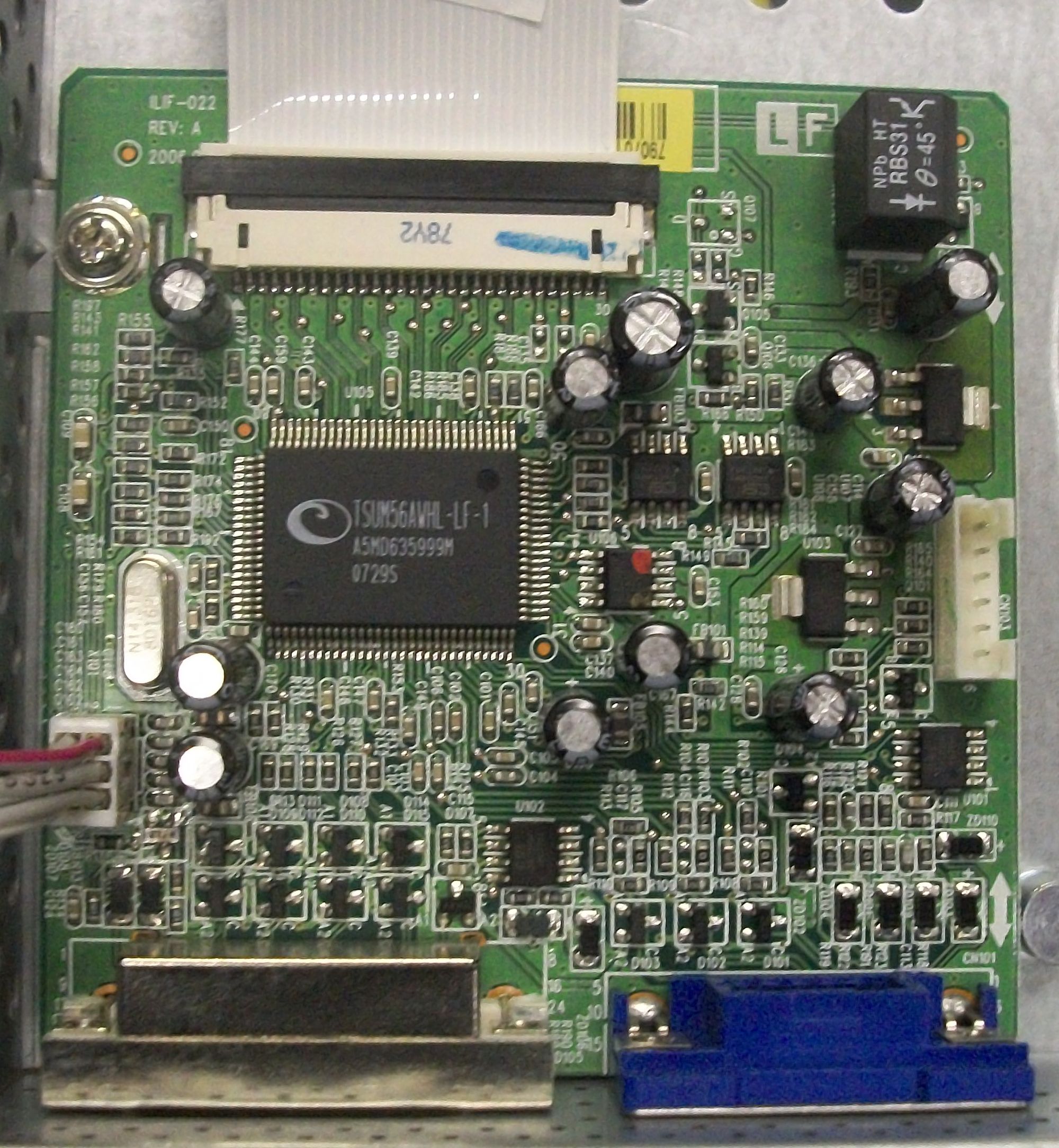

                  I took the LCD screen off and plugged in the power board and video board to AC. The connector between the two boards now reads:
                  VCC5v = 5.13v
                  VCC5v = 5.13v
                  Grnd
                  Brightness = 3.29v
                  On/Off = 3.23v when on
                  Grnd.
                  On video board Voltage Regulators
                  U103
                  AS1117L-33
                  Leg 1 = 0.0v
                  Leg 2 = 3.3v
                  Leg 3 = 5.13v
                  U104
                  AS1117L-18
                  Leg 1 = 0.0v
                  Leg 2 = 1.80v
                  Leg 3 = 5.13v
                  U103/104 appear to be ok, is that right?
                  Any ideas as to what to look for next?

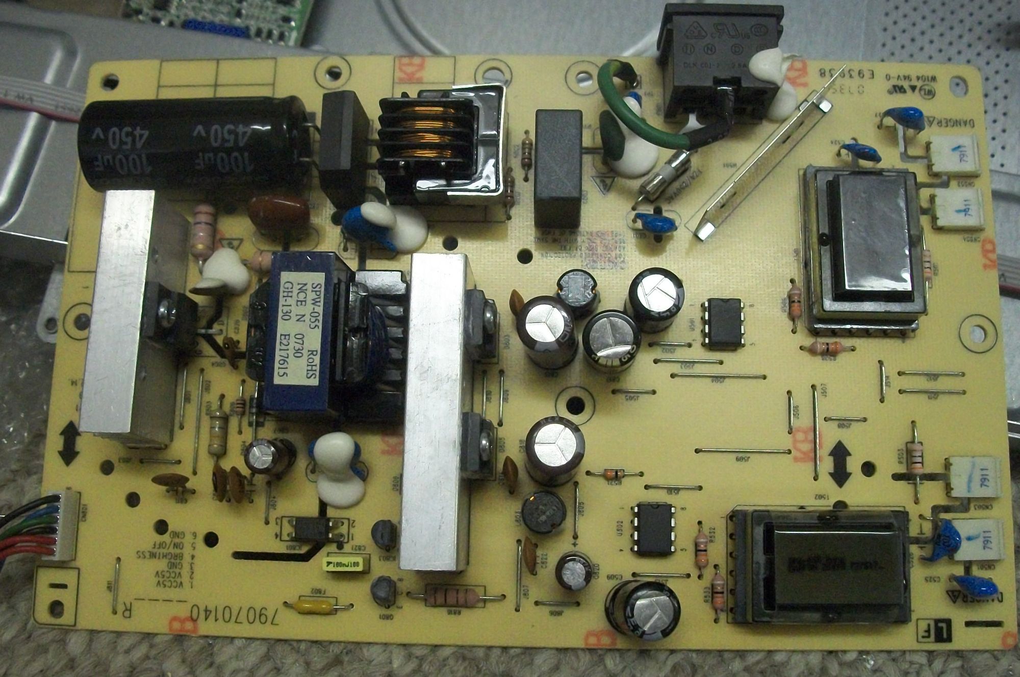

                    OK, the inverter backlights circuit since it is getting the correct voltages for BL_ON and the Dimming from the logic board so the backlights should stay on.
                    The inverter transformer has 2 pins on the output side, what resistance do get at those 2 pins (use 2K Ohm scale)?

                        OK, they are fine, so need to look at the drive circuits next.
                        What DC voltage do you have at the two legs of C817?

                            OK, you are getting B+ to the inverter section, next we need to look further in the inverter section, I will need to trace out the connections on the bottom side of the board.
                            BTW, can you read the P/N on those two 8-PIN MOSFET's, we will need to check the Source and Drain resistance.

                                      I took a resistance reading On U501 S1-D1 = 1.80 Kohms
                                      On U502 same pins = 7.95 Kohms
                                      Do want any other pins checked?

                                        The MOSFET's readings, since they are dual MOSFET's what are the readings of S2-D2?

                                          U501 Pin S2 - D2 = 7.92 Kohms
                                          U502 Pin S2 - D2 = 7.89 Kohms
