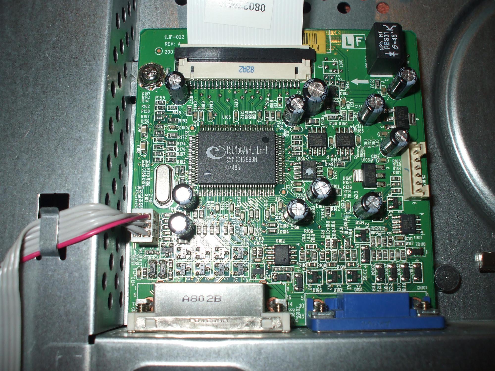

      2 x Acer KA240H + 1 Vewsonic VP2130 21 (a cap replacement job )
    • chrisborre
      • Mar 2010
      • 11

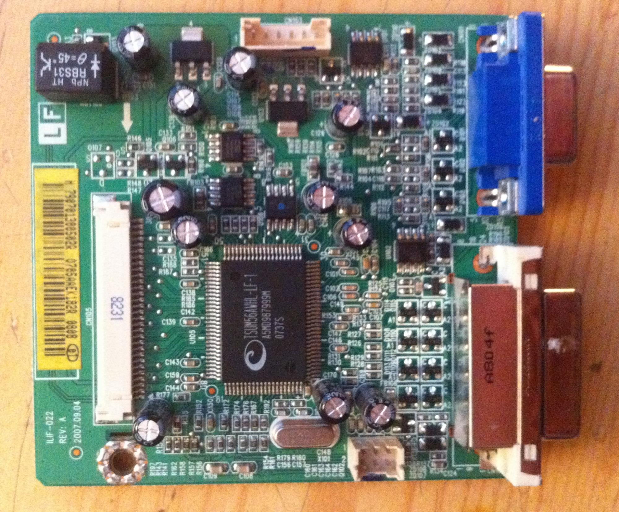

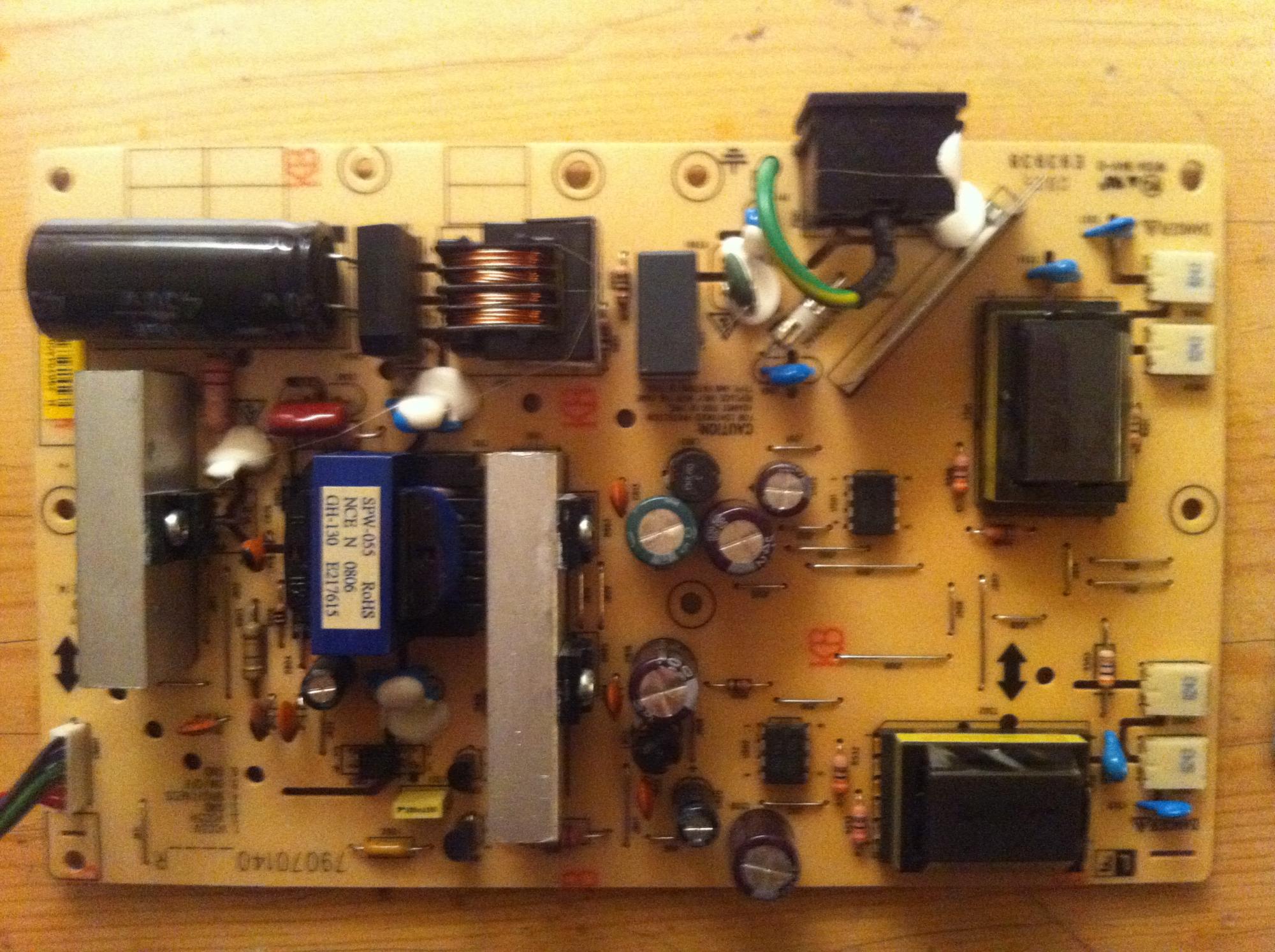

      Re: Gateway FPD1976w / LE1936 Problem
      Here are the pics.
      • EGuevarae
        • Nov 2008
        • 1336
        Originally posted by chrisborre
        Here are the pics.
        1st pic. Samxon & su'scon : post the specs because as a first step you'll have to change those. Also, post readings of the psu's outputs.

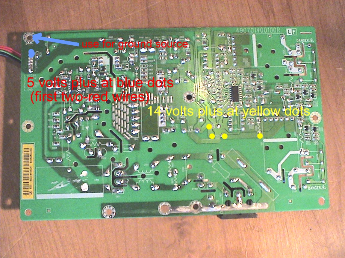

        • chrisborre
          • Mar 2010
          • 11
          I got the voltages as stated in the pics.

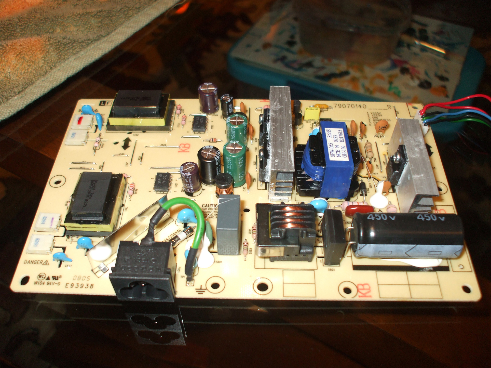

            Hey, I had this same problem with a gateway monitor but i have not found a fix yet. I posted this problem here:
            Post # 19
            https://www.badcaps.net/forum/showthread.php?t=6940
            with no input signal - cycles through 3 screens of different brightness then one screen of test pattern and then goes back out with power button LED change from green to amber, as usual.
            with input signal - Monitor simply cycles through 3 screens then test pattern then keeps cycling.
            Other sites that I have seen in researching this problem talk about possible firmware issues with this monitor. If this is the case, then theres nothing we can do about this. I hope I'm wrong in this case.

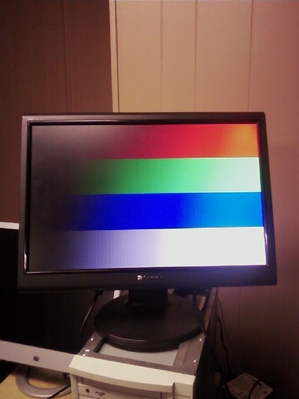

                          • Dgtech
                            E. Technician
                            • Apr 2009
                            • 1462
                            • Steeler

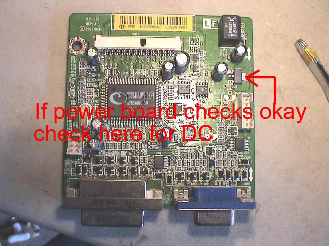

                            OK, finally getting back to this monitor. This time I posted one of the screens that pop up. Again, this monitor simply loops through 3 screens of different brightness and then splashes this test screen. I have no idea of how to get this out of this endless loop. It's a pain to take this thing apart but I already have changed the capacitors with known good ones. I have read similar posts about other monitor types having a reset sequence but could not locate a procedure for this one. Need help. ( Gateway FPD1976w / LE1936 )

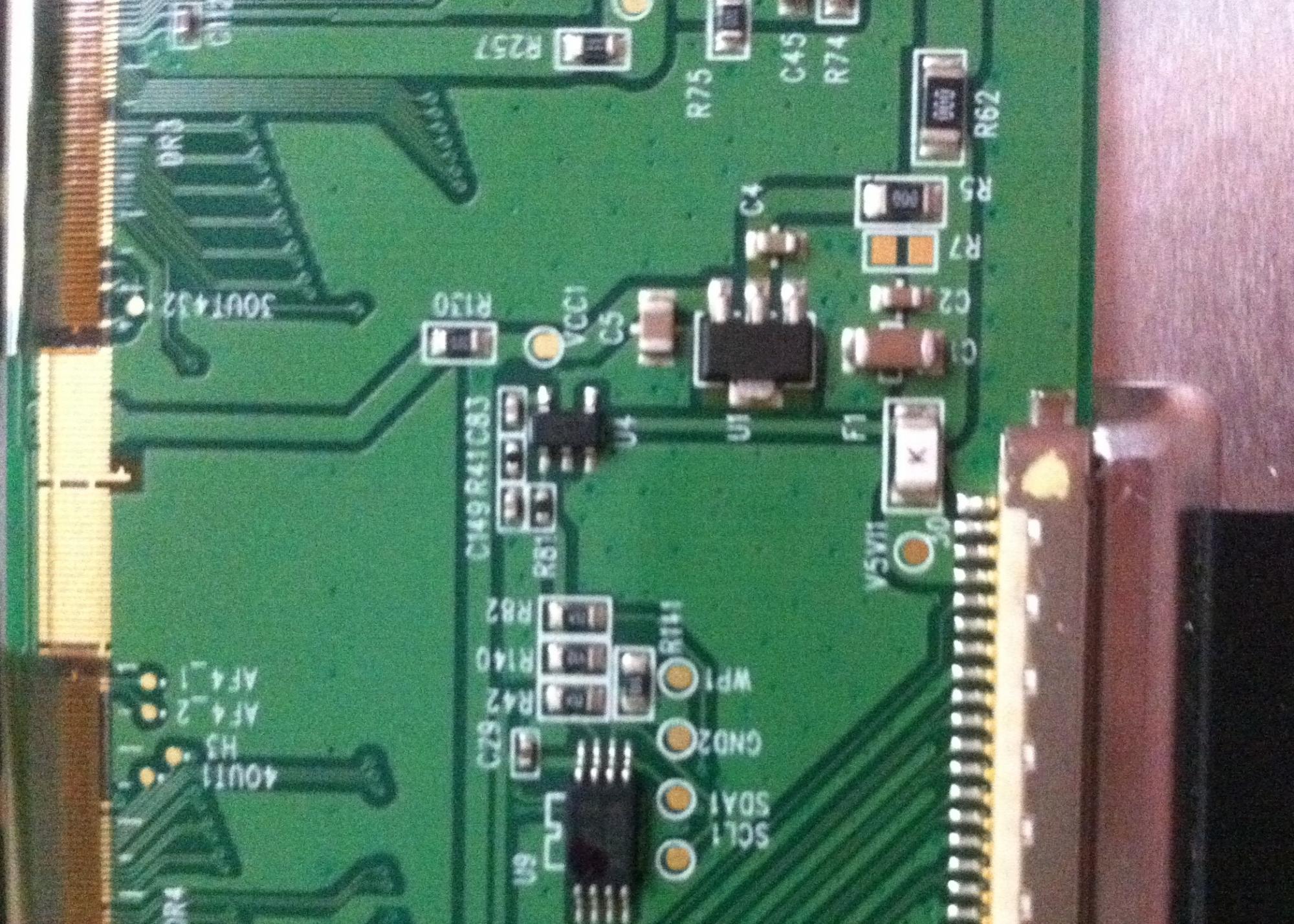

                            • bigtex2712
                              • Dec 2010
                              • 15

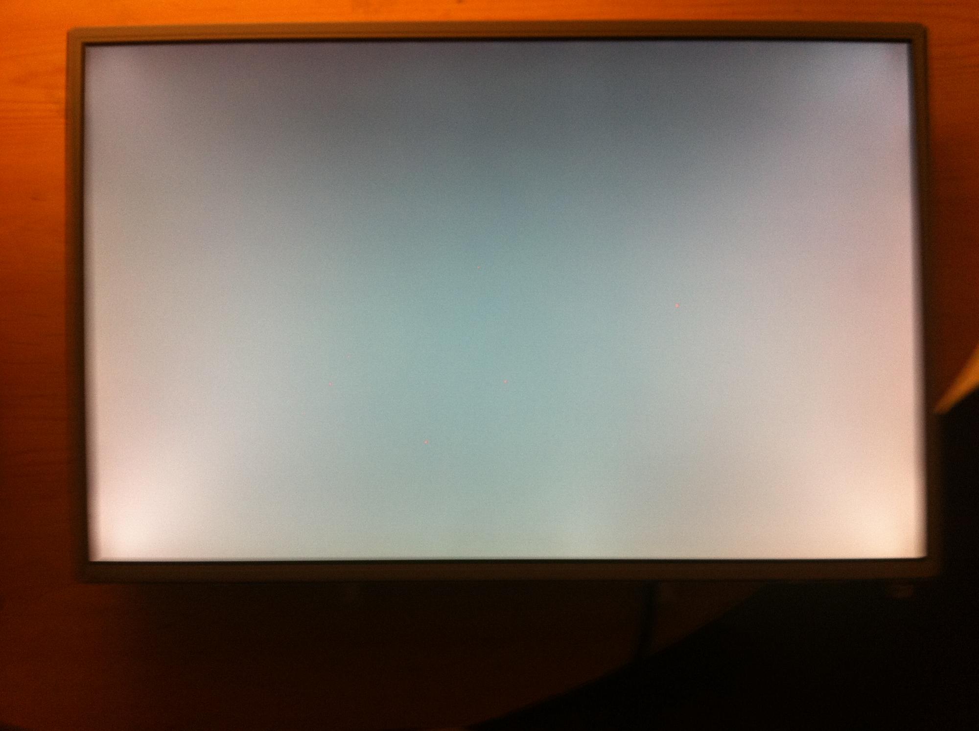

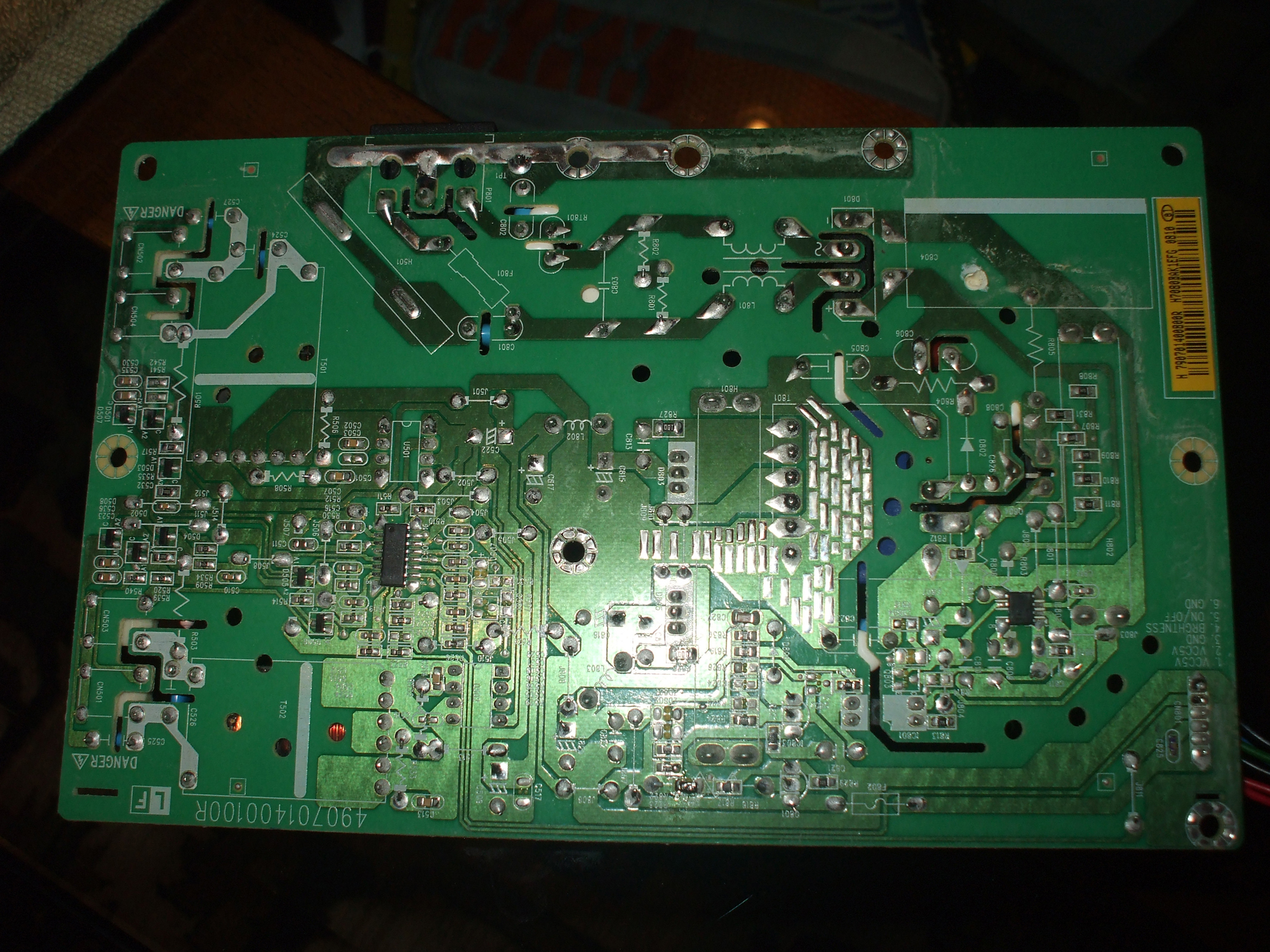

                              I am having the issue that whenever I turn on my monitor it is just blankly white and proceeds to go into standby. However I do know why it is doing this. I have stripped the monitor down and have posted the images of the screen plus the insides. Any help would be appreciated. Thanks.
                              • retiredcaps
                                • Apr 2010
                                • 9271
                                We need a clear focused picture of your logic board. Since you are getting a blank white screen, your logic board could be bad (maybe bad caps, open fuse, bad voltage regulator) or the cables to/from the panel need to be reseated?

                                • bigtex2712
                                  • Dec 2010
                                  • 15
                                  I assume what I uploaded was the power board. Here is the logic board.
                                  • jetadm123
                                    • 2169
                                    A white screen can be caused by a failure on the LCD control board. This is the board at the top that spans the width of the LCD panel. It's at the other end of the ribbon cable that connects to your logic board. It could be under a metal plate or covered with a sheet of clear plastic. Try looking for a fuse marked Fxx (where xx is a number). It should be in the area of the ribbon cable. Check to see if the fuse is blown.
                                    • bigtex2712
                                      • Dec 2010
                                      • 15
                                      I think I found it, would it happen to be the white component with the "k" on it? There is a "F1" above it.
                                      • jetadm123
                                        • 2169
                                        Yes, that's the fuse. With power off and monitor unplugged, set your meter to resistance and measure the resistance across the the fuse. It should read 0.5ohms or less.
