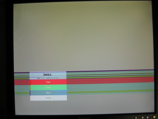

    Dell E178fp intercepted on the way to e-waste, manufactured in 2007.
    Initially at power on the DELL warm up screen would appear dimly for a second or two and then it would blank. At best, other times it would just start black. Disassembled and found the power supply and video board shown front and back in the attachments. The PS board had 4 Capxon electrolytic capacitors of which the biggest two (c203 and c204 on the right side) were domed and one of the smaller ones (c16, near F151 at the left) had blown its plug. Replaced them with Panasonics. Reassembled, and it powered up and lit.

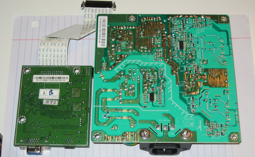

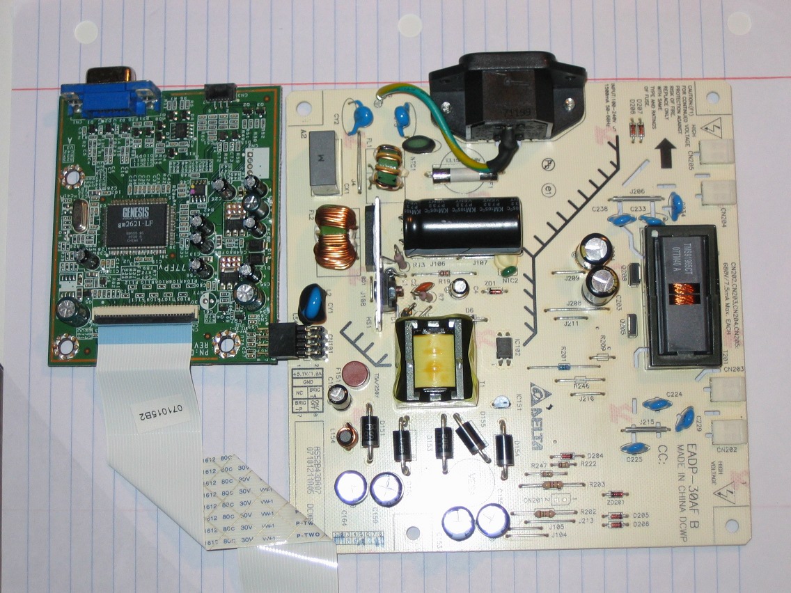

    However, the image has problems (see the attachment). The video board has 2 X Teapo 330uF 16V, 8 X G-Luxon 22uF 25V and 1 X Teapo 100uF 25V. Is the image defect shown consistent with some or all of these being bad? They all look ok, but as I understand it, none of these are very good capacitors. Measured the voltage at pin 1 on the power supply and it was 5.1, which is the value stamped on the motherboard. So I think the PS board is OK now and this problem is either in the video board, or I suppose it could be in the panel itself. The horizontal lines follow the color rectangle around the screen and appear in all positions. The Moire pattern is from the camera image, it isn't visible by eye.

    Re: Dell E178fp repair
    You're not done and what kind of panasonic capacitors was used? FC, etc?
    Need to replace the rest of capacitors ( group of violet caps) and check the rest on the mainboard.

        The way it looked shows me there is noise that is not cleaned up or poor voltage.
        This is ideal to go all the way to recap the power supply if don't have ESR meter, just swap out these four on that power supply.

            Replaced all the caps on the video board. Reassembled, powered on, nothing. Inspected and noticed the connector between the PS and video board was off one row (that is, 4 on one side were hanging out into the air, and the other 4 were plugged into the holes where the first ones were supposed to be. My bad, hopefully that didn't blow anything up permanently. Reassembled correctly this time. Power on (with no video input). Nothing, not even a back light. After a while though the Dell warm up screen came up for a while. It was still a little noisy, but just a bit on the left edge of the box that wanders around the screen this time, not lines all the way across like before. However it didn't stay on, but turned off after a while. Maybe that's normal - I've never had this monitor in working condition.
            I could easily have damaged the video board replacing those caps as it was very, very hard to get the solder out of the through holes once the caps were out. Couldn't do it with a solder sucker, a Radio Shack desoldering iron, or solder wick. Eventually resorted to heating up a resistor lead, pushing it through the hole, wiping the solder off the far side with the iron, and repeat until the hole cleared. TEDIOUS. Overheating of nearby components is a distinct possibility. As are solder bridges, although I didn't see any. (My eyesight is crappy these days though, and the video card is pretty densely packed, so the odds of me seeing a small solder bridge are not great.)
            Guess I'll try plugging in a video source that's umm, expendable, just in case it handles real video input OK (I really don't care if the warm up screen looks right if the normal display correct.) Also replacing the last few caps on the PS.
