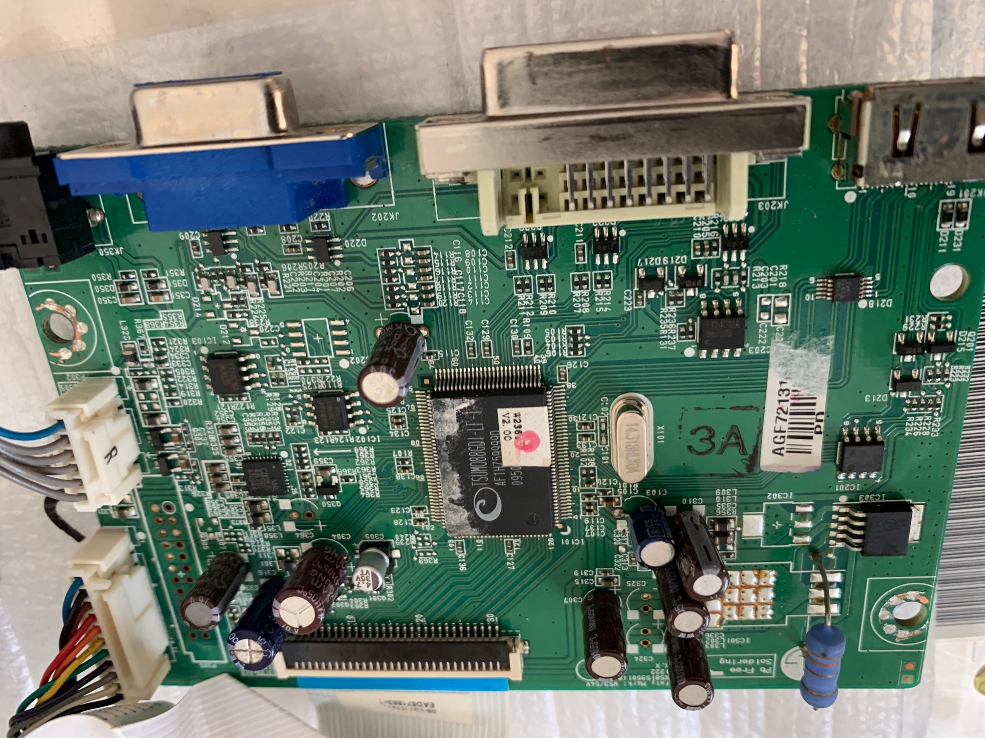

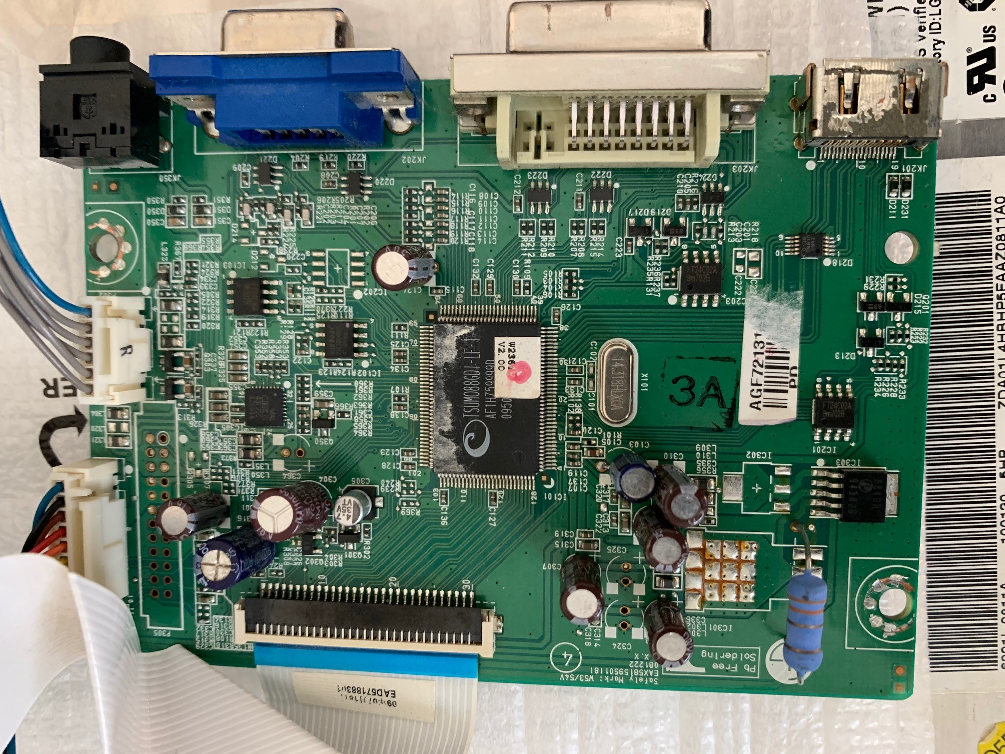

                    I changed all the caps on the mainboard but the monitor still does the same thing and the HDMI still doesn’t work
                    • R_J
                      • Jun 2012
                      • 9535
                      Re: OSD pops up, LG Flatron W2361v
                      What is the white stuff on ic101? it almost looks like the residue from water. I would try cleaning the ic and pins with ipa and see if that fixes the problem. Whatever it is it could be slightly conductive causing the switch input pins to false trigger.
                      • Sraros
                        • Jan 2017
                        • 223
                        • Greece
                        It’s the residue of a sticker. I removed it to see the chip’s part number
