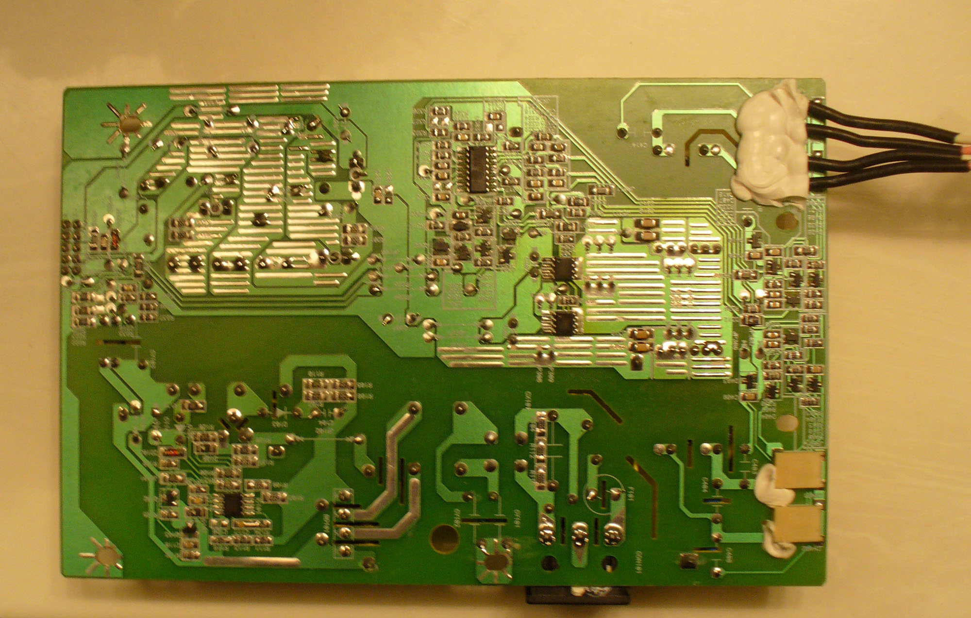

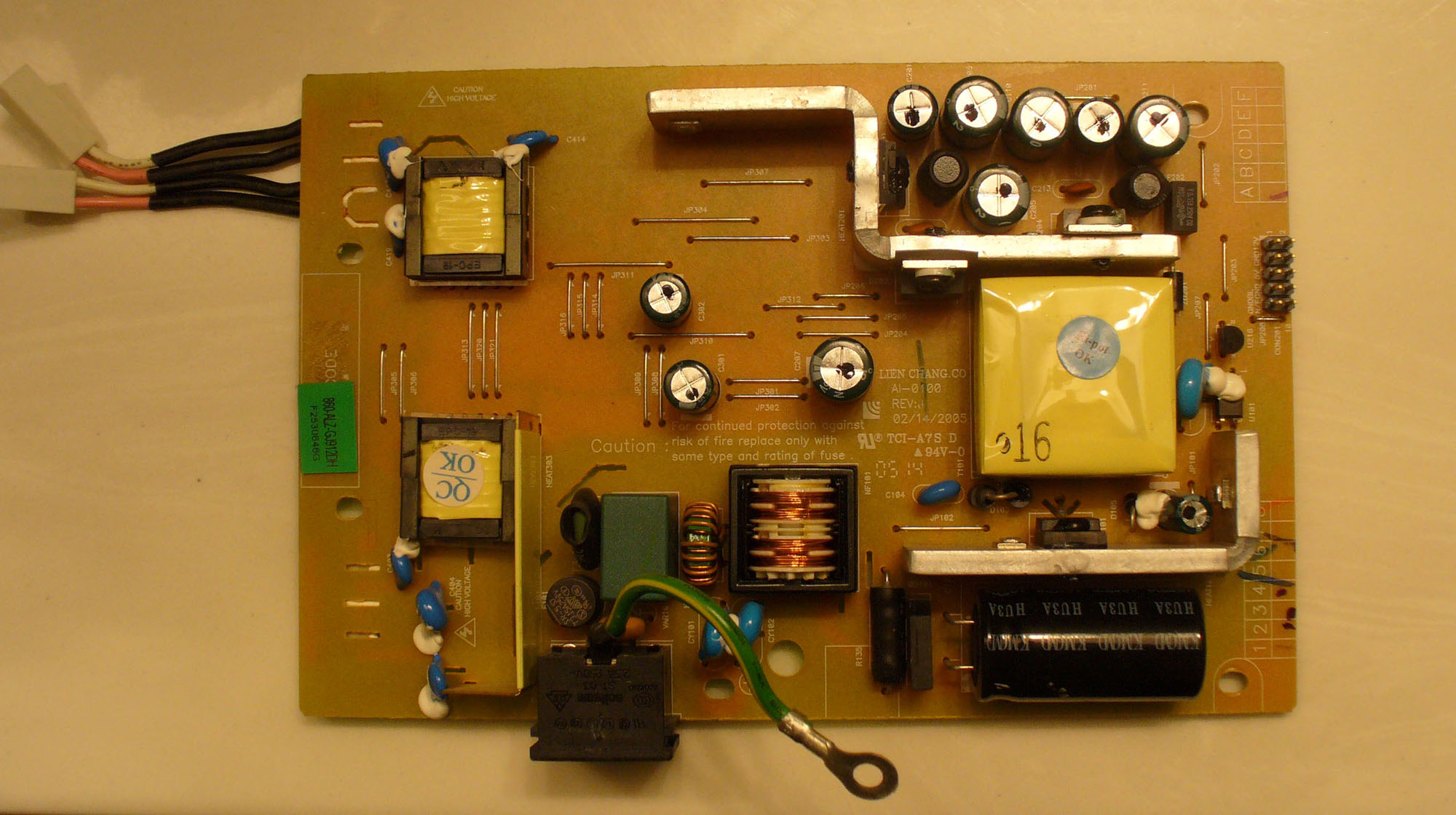

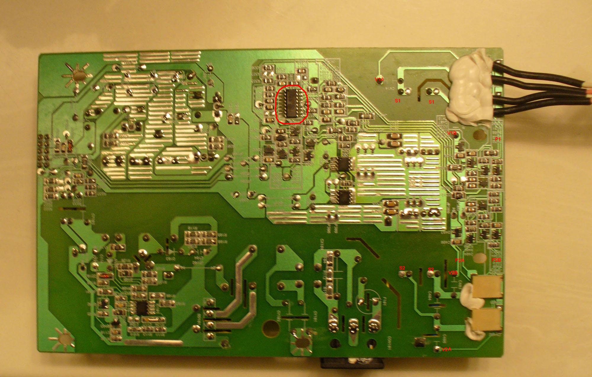

    Aquired a Gateway 900G monitor from a friend. Instead of recycling it, I'd like to try my hand at fixing it.
    Symtoms: The monitor is hooked to a working computer and plugged in. The power button is pressed and for a second or two the desktop is displayed. The screen goes black, but the power led stays on. I hit the power button again and both the screen and power led go black (off). I press the power button again and the desktop is displayed for a second or two then goes black.
    I quickly disasembled it and took some photos but need some help figuring out where to start. I read and re-read this thread https://www.badcaps.net/forum/showth...7&page=1&pp=20 and am still a little confused.
    Yes, I am a completely inexperienced in these types of repair, but I have lots of free time these days, lots of patience, and am decent at soldering. The terminology is where I lag behind a bit.
    My understanding is the attached pictures of the front & back side are what is referred to as the power supply/inverter, correct? The lcd half picture is to help me find where I would be able to gain access to the cold cathodes. They are in that half of the monitor right? And the part I didn't photo that contains the VGA & DVI hookups is called the logic board?
    So, am I on the right track so far? I reckon it's going to take me a while to get this done, but what should I start testing? Is a case modding cold cathode kit worth picking up? How do I avoid zapping myself while trying to fix this?
    Sorry to ask so many 'rookie' questions, but that's what I am.
    Many thanks in advance,

    This may take a while to bring you up to speed, but lets slog ahead. First of all, your nomenclature is correct. Also, you provided nice pictures, for which I am grateful.
    A case mod kit would help, but it is of limited help. One problem is they aren't as sensitive to faulty parts as the 'real' inverters. In general, this problem can have several causes, including a bad CCFL, a transformer with a shorted winding or an open winding, a problem with the wiring to a CCFL, or a problem in the protection circuitry.
    Let's start with the transformers. I've marked up the picture of the back of the power supply / inverter. The first step is to measure the resistance between the two points labeled S1 and also between the two points labeled S2.
    The second step is to identify the IC circled in red. What is the part number?
    The best way to avoid zapping yourself is to allow at least 10 minutes for the capacitors to discharge after unplugging power. And when working with power plugged in, always keep one hand in your pocket.

      Thanks for the guidance PlainBill.
      S1 resistance - I cannot get a reading. Multimeter reads 0 on all settings.
      S2 resistance - multimeter on '2000' setting yields a reading of 712
      IC part number - not sure what is the part number but line 1 reads BIT3193G, line 2 reads FMF05 G0511
      As you can probably tell, I'm not that familiar with a multimeter. I am guessing that the '2000' setting I used to measure S2 means I can measure up to 2000 ohms?
      I measured S1 and S2 with the power being unplugged for 12 hours or so. I tried measuring the flat solder blob as well as the 'nub' next to it.
      Have I overlooked anything? Where to next?
      Pants

        Well, this appears to be a short lesson. The next step is to use a soldering iron to melt the solder around the 'nubs'. Add a tiny bit of solder while you are at it. This will make sure you have a fresh surface. In the absence of a soldering iron, scrape the surface of the solder lightly with a knife blade so you have a bright surface.
        Your test indicated one of two things are occurring: Either you have a hard, insulating deposit on the transformer leads, or the transformer has an open secondary. If it is the second, you will have to replace it.

          Rather than heat up the soldering iron (have to dig it out) can I get a reliable reading from flipping the inverter over and measuring the exposed part of the transformer's leads before they go through the PCB?
          I have done this already and I still get no reading from S1. For the record, S2 still measures 712 this way.
          If I cannot get a reliable reading this way please let me know and I'll dig out the soldering iron and fire it up
            Re: Gateway 900G monitor not working.....shocking I know
            Assuming this transformer has failed, how do I go about finding the appropriate part to replace it with? On the top 'EPC-19' is visable. On the side, '0.0335P' and 'D07GP' are visable. I live in Canada and have checked the Badcaps FAQ for possible suppliers in Canada and then have checked Digikey and Newark in One's websites. However, it's like searching for a needle in a haystack. Any advice for identifying the correct replacement part?

              Your idea of flipping it over was right on. I'd definitely say the transformer is bad.
              There are a few things to try. Google is your friend. Possible search items are each set of numbers found on the transformer, 900G transformer, or variations of that. Also, try them on eBay.
              Also, take a look at this post and subsequent posts in the same thread.

                    Well, with the help of PlainBill and mr circuit I managed to fix this monitor. With mr circuit's advice, I found a source for used transformers on EBay named bammbamm. He sold me 2 for $20 and I replaced the failed one today and re-assembled the monitor and it fired right up.
                    Thank you one and all for your assistance. I truly appreciate it.
                    Looking back, I know in the grand scheme of things this little repair job was pretty easy, but I still fell pretty good about myself. I fixed something that was otherwise destined for the landfill.

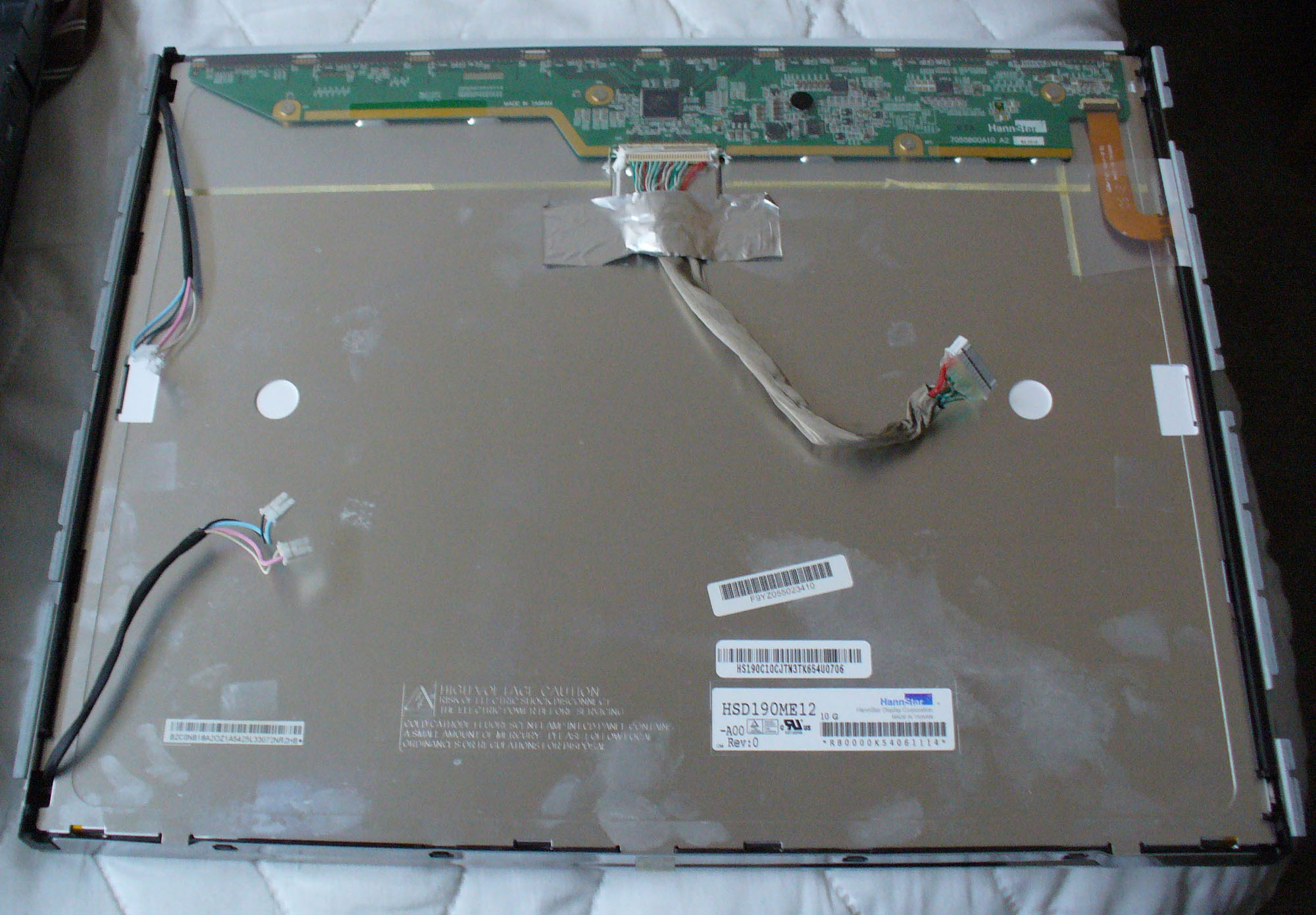

                        Ran out of ideas: replaced 10 capacitors, re-soldered "suspicious" connections, checked all 4 bulbs for firing, both of my transformers show around 0.75K on secondary, but it still performs 2 second of work and than off. Rather it got shorter now, closer to 1 sec work...
                        PS I've measured Transformers more accurately, they are within 3%: 0.710 and 0.709 KOm

                          Transformers look good. At this point i'd say bad CCFLs or bad CCFL wiring. You said you checked all 4 bulbs, how did you check them? Have you tested them on another inverter?

                            I tested bulbs connecting them one by one to the same output plug and turning the monitor on -- each time there was a start message a bit dim, lasting for a sec or so. Isn't that enough? Don't have a spare device unfortunately for testing.

                              What you are looking for are
                              http://s807.photobucket.com/albums/y...klight%20lamp/
                              The inverter controller controls the ccfls in an "all or nothing" scenario. Either all the ccfls work properly or none at all (shutdown after 1 to 2 seconds).

                                  No. If your bulbs or wiring look anything like the above, it will light up briefly before the pwm shuts down all the ccfls.
                                  The only way I know how to test the ccfls properly is to use a known good one.
