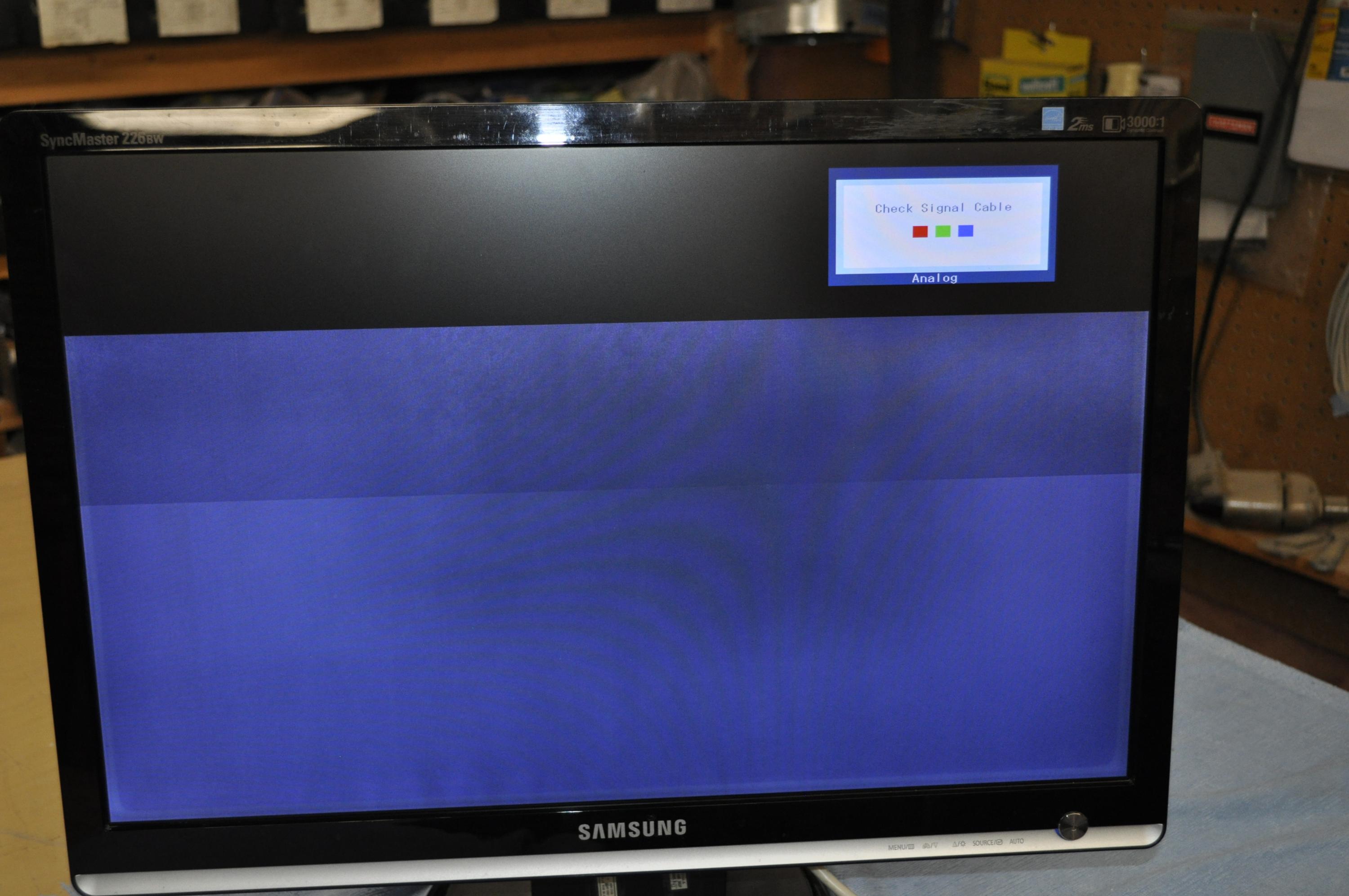

            Hi, my Samsung 226BW recently acquired the "2 seconds to black screen" syndrome and after exhaustive analysis, I concluded that one of the four CCFL lamps was drawing too little current to satisfy the detection circuit (SEM2005 chip)
            Once I realized that pin 3 of this chip was upset because the input voltage there was at 1.18 volts instead of the minimum of 1.3 volts, all I had to do was determine which of the 4 cathodes belonging to the 2 diode pairs D201 and D202 was the origin of the problem.
            It turned out that D201 had good inputs to it (1.85 volts), but one or both of the inputs to D202 was bad (0.72 volts). Since there were 4 mostly awkward combinations in which the 4 CCFL cable plugs could be connected to the 4 sockets, I tried all the combinations and when lamp number 4 was attached to socket number 4, D202 went low, and when lamp number 4 was attached to socket number 1, D201 went low. No other of the 3 lamps was responsible for pulling any diode to low. Conclusion, lamp number 4 is either drawing no current or too little to satisfy the SEM2005 chip, so the chip shuts everything down after 2 seconds.
            I should note that to do this testing, I needed to keep the inverter running by overriding the protection circuit. With the scaler board disconnected from the inverter board, I soldered the + lead from a 3 volt DC battery pack to pin 9 of CN02 (9 line cable connector on inverter board), and soldered the - lead of the same battery pack to pin 4 of the same connector. That fooled the SEM2005 chip into believing that the missing scaler board was requesting the backlight to come on. Then I soldered a wire from pin 1 of the SEM2005 chip to ground via an 82K resistor. That disabled the protection circuit and the backlight remained on indefinitely, allowing me ample time to do my measurements.
            I could not find any videos on the internet showing someone removing a CCFL from this or a similar Samsung monitor, and I had read horror stories about problems arising during disassembly and reassembly of the backlight panel, so I decided that I would prefer to simply run the monitor with 3 working CCFLs.
            I could have kept running the monitor with the protection circuit disabled, but I would prefer to have the benefit of the features of the SEM2005 in case there would be a catastrophic failure of the lamps in the future, with a risk of overheating or worse.
            So I measured the peak power being drawn by the monitor at the 120 VAC input to be 3 watts idling and 21 watts with the 3 good lamps and 1 sick lamp running.
            So any substitute resistor would have to accept 6 watts of heat (21 overall watts - 3 idle watts divided by 3 good lamps).
            To estimate the lamp current I noted that a good lamp will cause the cathode of D201 to be at 1.85 volts DC in my case. This half-wave DC voltage is developed across C214 and is due to high frequency current flowing through the CCFL and into series resistor R221 (910 ohms). To generate 1.85 peak volts across a 910 ohm resistor, the peak current must be about 2 ma. The rms current would be about 1.5 ma.
            So if my substitute resistor is to heat up to 6 watts due to 1.5 ma. of current, it has to have a value of 2.7 meg ohms.

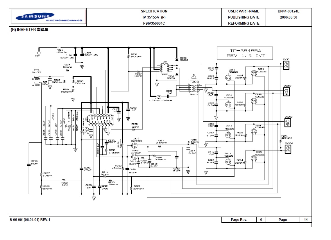

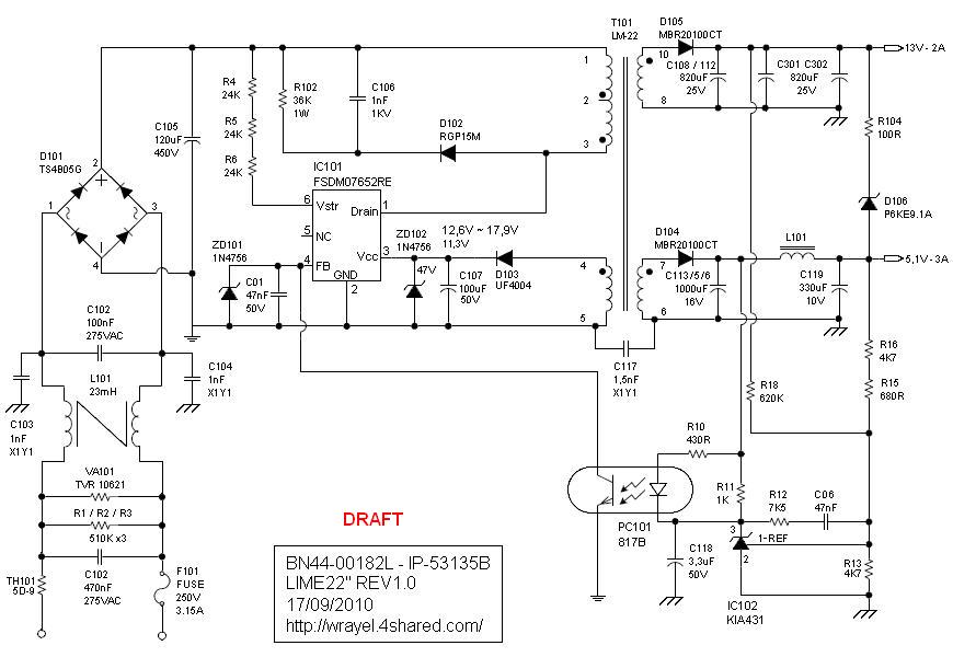

            The attached circuit is for a different but similar Samsung monitor with 4 lamps. I could not find the diagram for the 226BW monitor.

              Re: Using a resistor to fake a Inverter into thinking a CCFL is good
              6W at 1.5mA, that means the E = 4000V which could not be.
              The firing Voltage of the lamps is around 1200~1500V and the running Voltage is about 700~1000V.
              Looking at you board, you see the Voltage chart shows lamps running Voltage of 650V AC 1.5mA for each connector CN301~304.
              What is the model number of the LCD panel? You can find the spec sheet for the panel to verify if it matches the board spec or not.

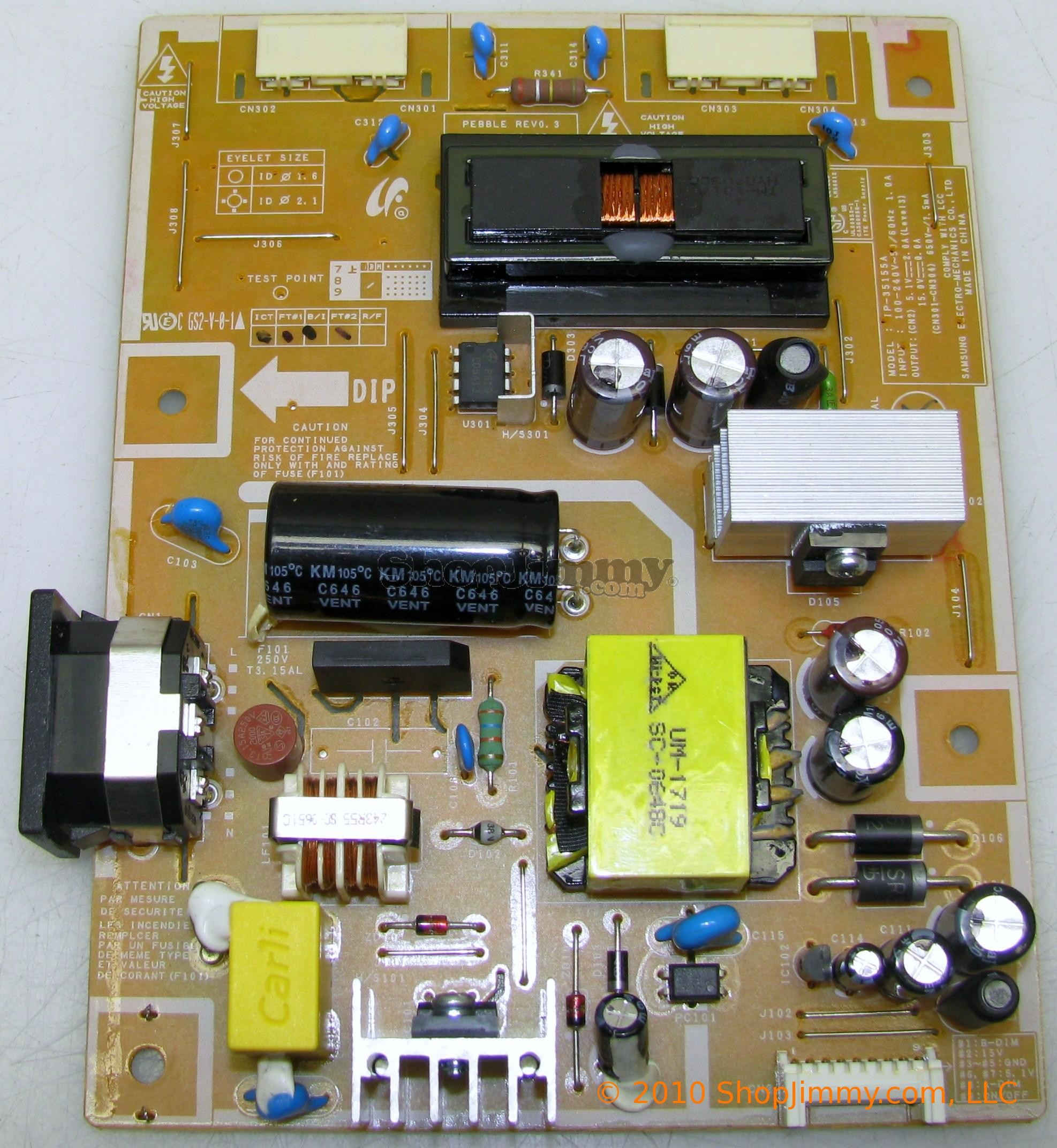

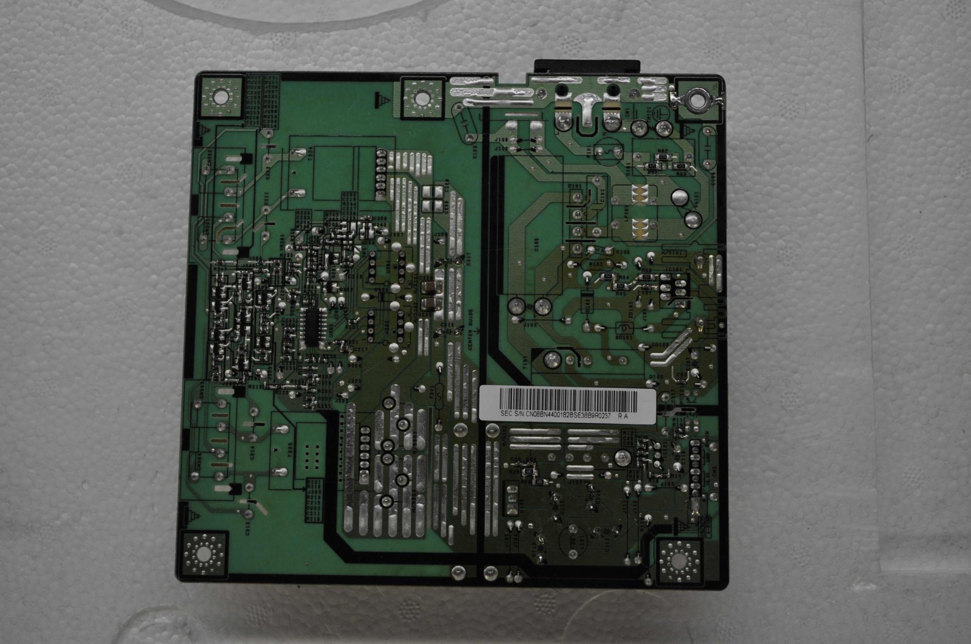

              Pictures provided by shojimmy. BN44-00124E as shown in the schematic is your board, right?
              http://www.shopjimmy.com/samsung-bn4...t-inverter.htm

                The average current through R221 is probably much less than 1.5 ma. and likewise the average voltage across the CCFL, however to get the 1.85 volts DC held across C214 which I was reading today, the peak current through R221 had to have been 2 ma, meaning 1.5 ma rms, and a peak lamp voltage of 4000 volts.
                Once D201 is reversed biased off, the voltage across C214 doesn't really have a resistive path to ground, so the capacitor will maintain the highest voltage it receives, even if that peak lasts for microseconds. I believe that peak lamp voltage had to have been 4000 VAC and I'm guessing that the peak was repeated hundreds of times a second in sync with the PWM frequency of the inverter operating with a duty cycle close to, but never 100%.
                Even though the inverter frequency is 50 khz, I am measuring a DC voltage across C214 because D201 gets rid of the AC, and my digital multimeter can give me an accurate measurement.
                However we need to lower the dummy power resistance to a point where the average current through it, whatever that might be, heats the resistor by 6 watts, so that the normal draw of the missing CCFL is simulated.
                The schematic shown in my previous post does not match exactly my board. My board is BN44-00182B.

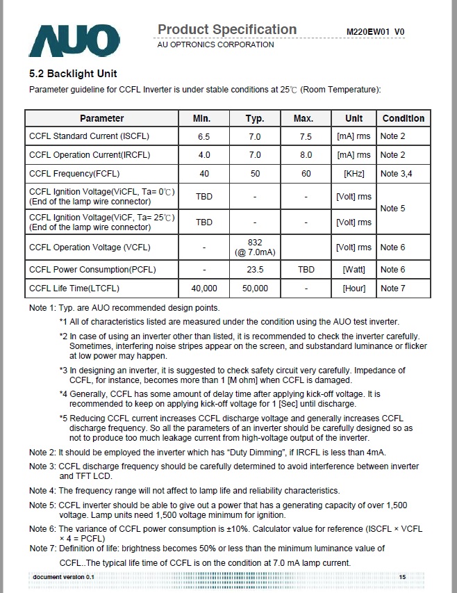

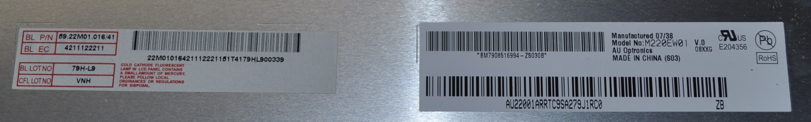

                  Here is a photo of the back of my panel.
                  Attached is the spec for my M220EW01 panel.
                  I appreciate better what you were saying about the dynamic resistance of the CCFL.
                  For the SEM2005 chip to believe that a healthy CCFL is in place when in fact there is a substitute fixed resistor, then the resistor will have to mimic the characteristics of the CCFL if detection circuit is to function properly and the transformer is to see the same load as a real CCFL.
                  According to the spec (Note 6), the panel wattage is 23.5 watts, or 5.875 watts per bulb. The standard current ISCFL is 7 ma., so the VCFL is 839 volts. The average resistance must be 120000 oms, which is 20 times lower than the resistance I originally proposed.
                  Using this resistor, the voltage across C214 should be about 9 volts, which will shutdown diode D201 and allow pin 3 of chip SEM2005 to drain to ground via R213 only, and not drain to ground via R216 and R221.
                  Therefore the voltage at pin 3 (likely about 1.85 volts) will convince the chip that there is no open lamp situation and the panel should operate.
                  Thanks for your help.

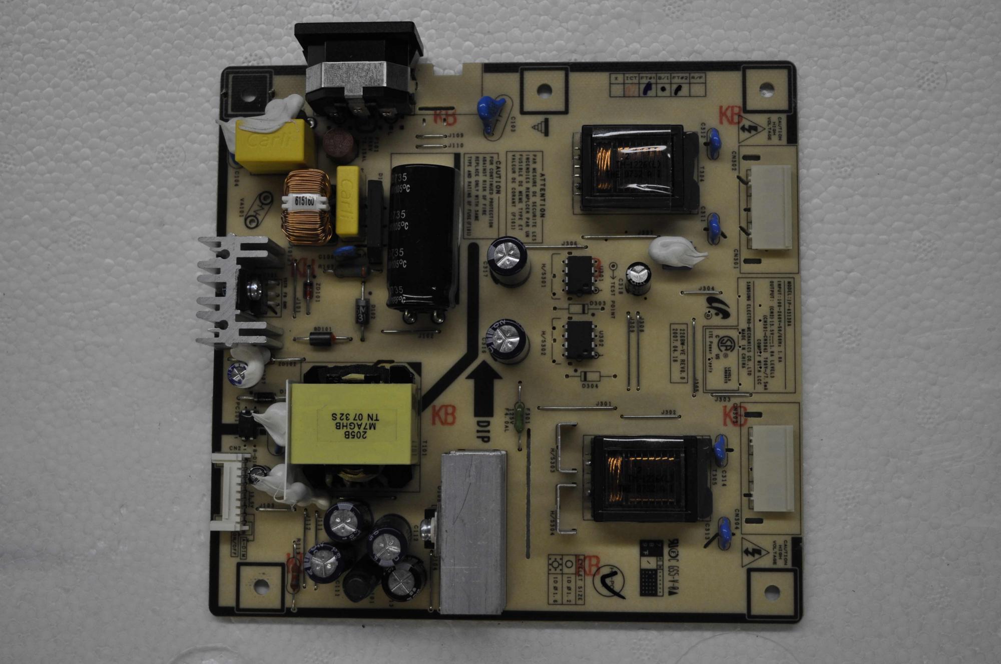

                    Your schematic of BN44-00124E does not match your board, you board has two inverter transformerS, the schematic has one inverter transformer and it matches the pictures of the board I posted so the part designators in the SCH do not match your board BN44-00182B.
                    Another thing about using the resistor is that the break down Voltage of the resistor has to be higher than the applied Voltage.

                      Since each transformer of your board drives two lamp, then you may be able to join the two lamp circuit detection together to fool the circuit in thinking it has to lamps connected.

                        Your schematic of BN44-00124E does not match your board, your board has two inverter transformers, the schematic has one inverter transformer and it matches the pictures of the board I posted so the part designators in the SCH do not match your board BN44-00182B.
                        You are correct about my board not being identical to your board, but they have so much in common and there are no schematics for mine anywhere on the web, except for a page which covers the 120vac entry circuit, a photo of which I show below. The BN number in the diagram is the same as the BN number on the bottom of my board, but the IP number on the top of my board is not the same as the IP number in the photo.

                          I already have that diagram, you board is revision B, that one page diagram is for revision L SMPS section.
                          Most Samsung power supply board has BN44-XXXXXx.

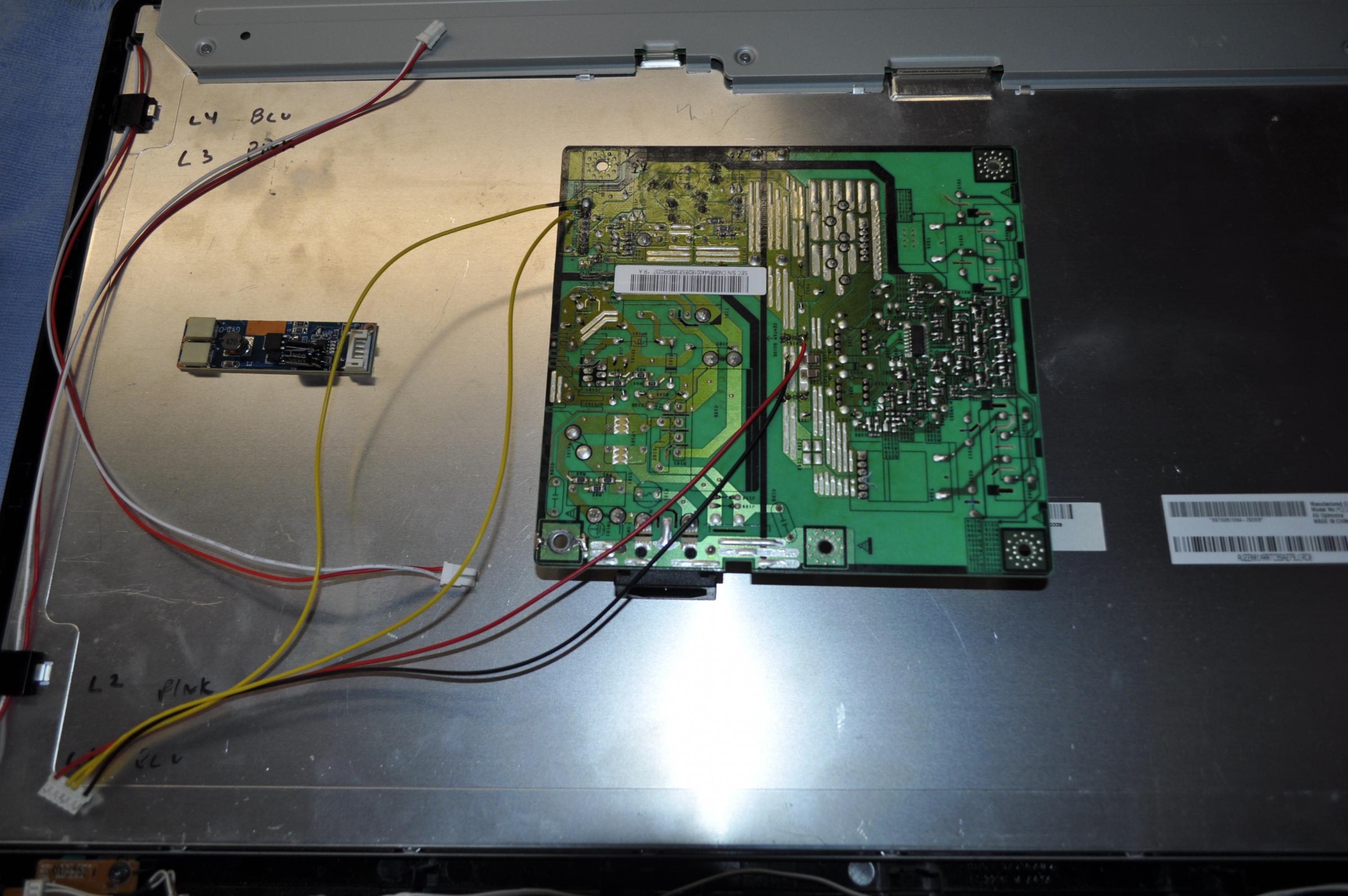

                            First the good news: After looking at a few Youtube videos showing how panels identical or similar to mine are disassembled, I partially disassembled mine. After I turned off all the background noise in my workshop, I could hear some arcing noise when the CCFLs fired up. As I had removed my grounding resistor to pin 1, the protection circuit shutdown the lamps after 2 seconds. I decided to completely disassemble the whole panel which exposed the top and bottom lamp assemblies. Each assembly contained two lamps. I then plugged both assemblies directly into the inverter board along with the pushbutton harness. Then I turned on the inverter and I could see that 3 of 4 lamps were lighting up and for the forth lamp, (number 4), there was a black carbon coating on the glass next to the rubber boot.
                            Now the bad news: taking a q-tip soaked in alcohol, I tried to rub off the carbon and the glass cracked. Additional, lamp number 3 would come on temporarily, but I no longer had light coming from the full length of the lamp, only the first half. So I really have 2 and a half lamps working, and that is not enough.
                            What I need is a new 19" long assembly of a pair of lamps. I'm hoping to find a second hand assembly from a scraped monitor, as the cost of ordering on-line a new pair of assemblies exceeds what second-hand monitors are selling for locally.
                            This has been a tremendous learning experience, I only regret that I won't be building a bypass resistor to fool the chip into believing that the bad lamp is good.
                            Thanks for your encouragement.

                              Well, as cheaper alternatives, you could completely try to disable one half of the inverter and run the monitor only on 2 lamps. I've done that to a Dell 19" here and it works fine. Though I will admit the contrast at the bottom of the monitor (where the two disabled lamps are) does look pretty bad. Of course, to avoid that, you could just get rid of the non-working and half-working lamps, then take one of the good lamps from the other assembly and have it in place of those two bad lamps. That should give you one working lamp on the top and one on the bottom, so the contrast should be equally good/bad throughout the monitor.
                              A different alternative is one of those LED kits on eBay and elsewhere online. I've never tried them, but I've been curious to do that. Member stj here has used them and says they work well.

                                I found that my lamps are very thin, as two are crammed into 6 millimeters of width within the metal "U" shaped reflector. The bulbs are very difficult to separate from the metal case without cutting the low voltage wires. They feel as fragile as a thick piece of spaghetti.
                                I called a few stores which specialize in recycled computers and none keep broken panels around for spare parts.
                                Today I ordered a LED conversion kit from China via Ebay for under $12 US with free shipping (4-5 week delivery). I've looked at some of the videos and this looks very doable. I know that my Samsung 226WB has an output signal for analog dimming which I believe is the only kind of control that the LED driver will accept. I may have to use some fixed resistors to set the analog voltage level that gives me the best brightness. The less brightness I ask for, the less the chances of shortening the lifespan of the LEDs which probably won't like being confined to a narrow channel.
                                http://www.ebay.ca/itm/272479776238
                                https://www.youtube.com/watch?v=7w805Rw9Mpk
                                Do a Google search for the PDF corresponding to chip "LED backlight driver" DF6113.

                                      After 20 days, the LED kit arrived from China.
                                      Initially I hooked up the LED driver board (GYD-9E with its DF6113 chip) to a 10 volt battery and applied 3 volts DC to the enable wire. The LED turned on but the current drawn from the battery was only 25 ma. I added another 5 volts DC in series with the 10 volt battery to give me 15 volts and the LEDs went brighter and the current draw was now up at 0.4 amps, so the lights were now drawing 6 watts.
                                      There was no sticky tape on the back of the LED strips, so I used some 2 sided carpet tape to hold the strips in place within the metal U shaped reflectors.
                                      On my Samsung monitor inverter board I found a source of 16 volts DC (officially it is supposed to be 13.5 volts) which I connected to the LED driver wiring harness. The enable wire for the driver board I connected to pin 1 of the ribbon cable that runs between the Samsung scaler board and the inverter board.
                                      Reassembling the panel went more easily than I had expected. Any specs of dust on the diffuser sheet I wiped off with a special cloth.
                                      Unfortunately, there is now a new problem with the LCD top sheet (see photo).
                                      The LCD top sheet has many flexible film ribbon connectors all across the top of the panel for horizontal addressing and four flexible film ribbons down the panel's side for vertical addressing. Each of the four ribbons on the side corresponds to one quarter of the height of the screen.
                                      All the ribbons at the top connect electrically to the circuit board at the top, however the four ribbons along the side are just squeezed under the outer metal frame.
                                      While there is no hard electrical connection between the four side ribbons and the chassis ground, I assume that there is a capacitive connection that operates due to the high switching frequency of the panel.
                                      As you can see from my photo, only the top quarter zone is working.
                                      I partially disassembled the panel and played with the four side ribbons one at a time and I could see that I was triggering different quarter zones to go on and off, so I conclude that my problem has something to due with the way these side ribbons are physically positioned during panel assembly.
                                      So while my experiment of converting from CCFL to LED was a success for under $15, the failure of my reassembled LCD panel to work properly brings me back to square one.
                                      I recommend this upgrade kit for monitors which allow the old CCFL tube assembles to be pulled out of their cavity without having to pull apart the different layers of the panel sandwich.
                                      When a person has to take apart the panel sandwich, one exposes to problems of dust and damage to the flexible ribbon cables, as was my case.
