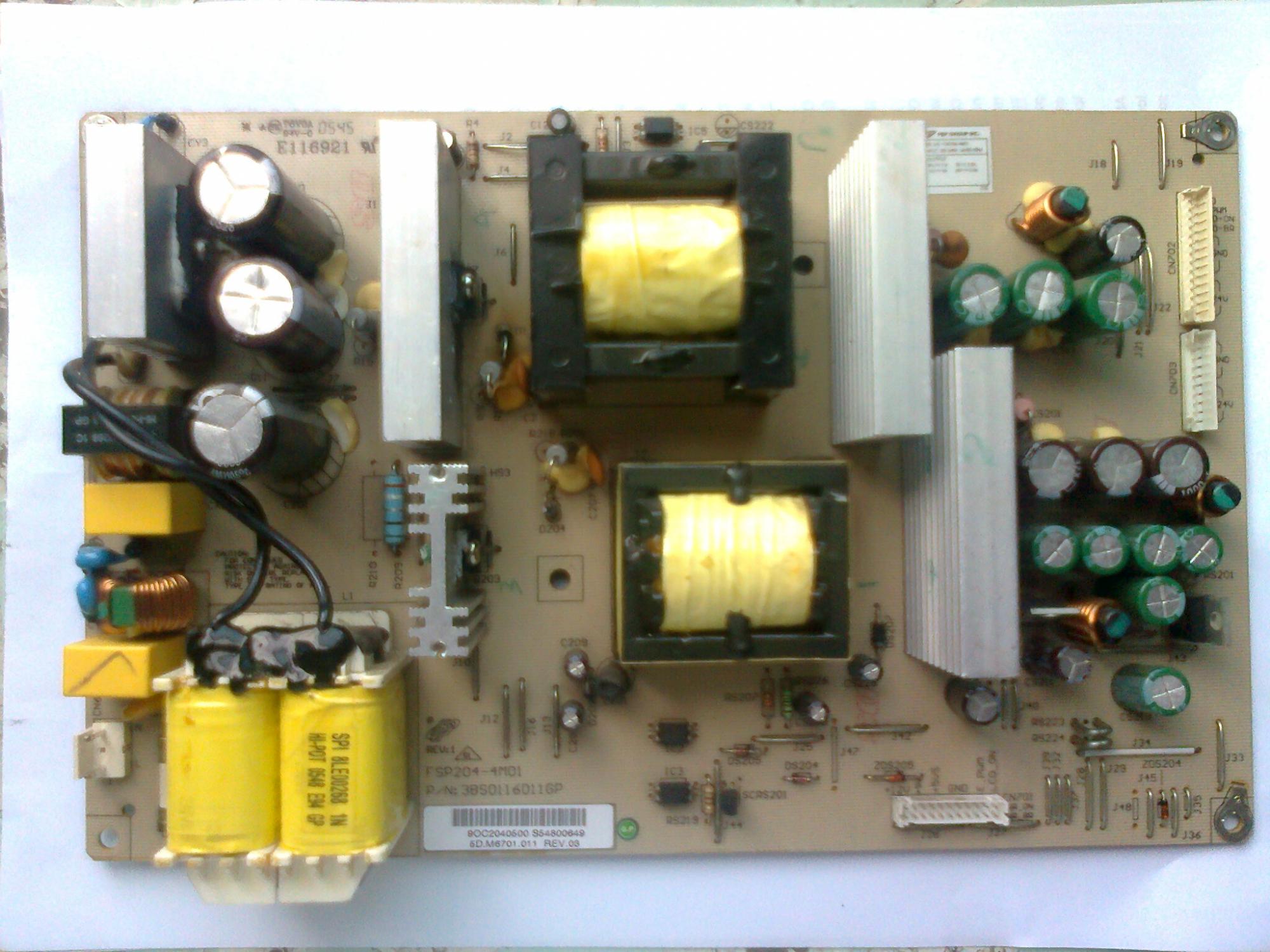

              Dear sir,
              Very interesting with your method to light up the backlight, I'm very new
              to repair LCD, would you kindly show me which resistor in my BenQ DV3250
              to replace? Image is attached.
              • retiredcaps
                • Apr 2010
                • 9271
                Re: Using a resistor to fake a Inverter into thinking a CCFL is good
                Originally posted by Bill Lee
                'm very new
                to replace?
                I suggest start a NEW thread and telling us what exactly is wrong with this monitor (is the power LED on, can you see the display flash, can you see it with a flashlight shined on it). We will also need a clear focused picture of both sides of the board.
