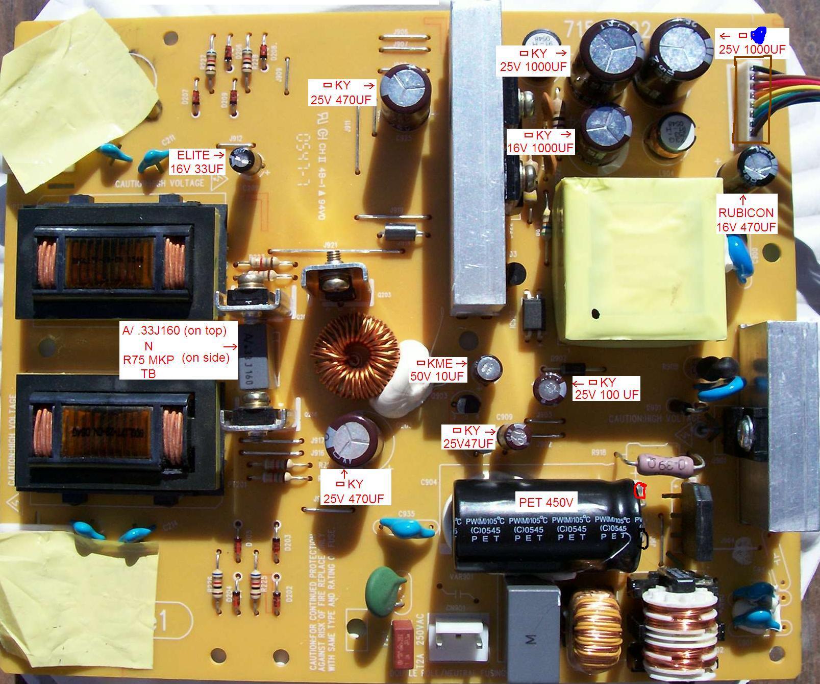

      I'm wondering what to test next. After following all the instructions listed here I have come to the conclusion that I should just try replacing all caps and see if that works. The problem is that none of the caps look bad except for the slightest budge on C0612 (1000 uF @ 25V) and C0604 (1000 uF @ 16V) shown below.
      5V supply
      1000 uF @ 16V C924
      470 uF @ 16V C926
      12V supply
      1000 uF @ 25V C923, C931 (yes, two of them)
      470 uF @ 25V C925
      SMPS supply
      100 uF @ 25V C906
      47 uF @ 25V C909
      Inverter
      470 uF @ 25V C203

        There are two possible approaches to this. One is to replace all the caps on the power supply board. Remember, bulging / no bulging is not a definitive sign of the quality of a cap. Any cap that is bulging is bad. One that is not bulging may or may not be bad.
        As I recall, this logic card has multiple processors. I suggest checking the voltages on all the voltage regulators on the logic card. Attach a picture if you want me to point them out.
        PlainBill

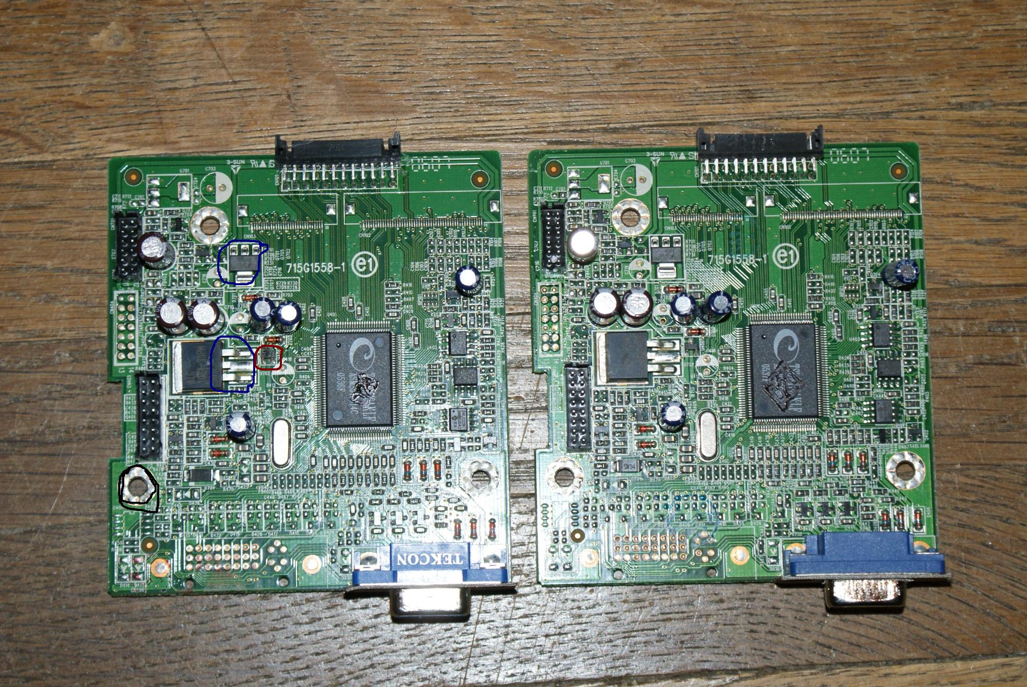

          #44
          Re: No power on a Acer AL1916
          A photo of the logic board is in my last post. I tried to take another picture but my camera is out of batteries so I'm charging it now. Let me know and I'll take a photo if needed.
            #45
            You are right, my mistake. On the picture on the left, two voltage regulators are circled in blue. What are the voltages on each pin of them, use the mounting pad circled in black as the ground point.
            PlainBill

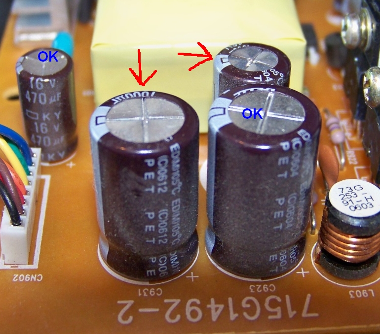

                #47
                I happened to be next to radio shack so I stopped in and I replaced the 1000uF 25V and 1000uF 16V both with 1000uF 35V caps from XICON. However, other than a tiny clicking sound when the power is on (something might be shorting) the problem is the same.
                Pushing the power button the power LED turns on green (and stays green) and the screen backlight turns on. However, there is no image, logo, menu, etc.
                It would still be nice if I could save this LCD.

                    #49
                    You need low-esr caps. The gp (gwneral purpose) caps that radio shack has are useless to you

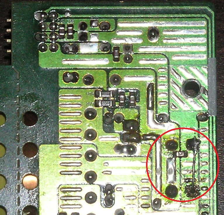

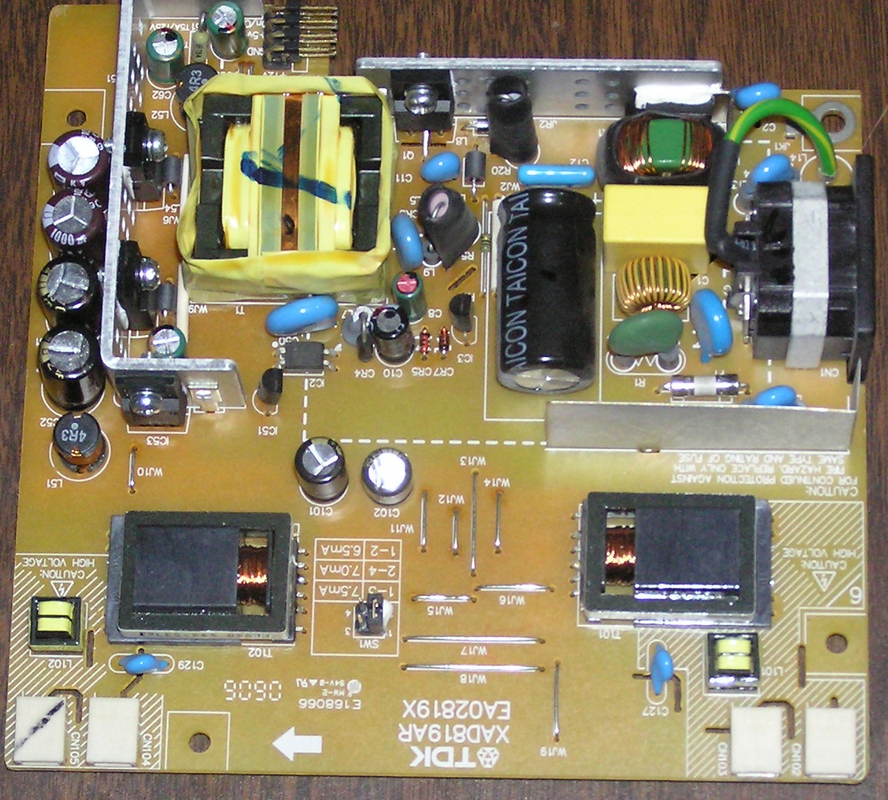

                            Hi Everyone,
                            I have a few questions/problems regarding repairing the power board of my AL 1916 ASD Monitor.
                            While trying to replace the capacitors on the board i managed to destroy one of the contacts on the board.
                            It is has been quite a while since i played with electronics and hence managed to destroy the contact using my soldering iron.
                            Based on the boards contacts it seemed like a few of the capacitors were in parallel, so i decided to connect one of the capacitor leads to the other capacitor's lead to make a good connection.
                            Please see picture.
                            Now the problem is that it did not fix the problem completely.
                            The monitor turns on, but i am barely able to see a shadow on the monitor when i press the menu button and when i connect it to my computer, (so it is defiantly getting some input from computer).
                            Could someone help me further to diagnose and fix the problem.
                            Thank you
                              Originally posted by borgdrone View Post
                              Hi Everyone,
                              Please see picture.
                              Thank you
                              borg drone
                              While the repair is not done professionally, it appears to be good enough. Did you check for the proper output voltages? How about an open fuse in the inverter area? Did you plug in the CCFLs?
                              Above all, good pictures of the top and bottom of the board will help us help you.
                              PlainBill

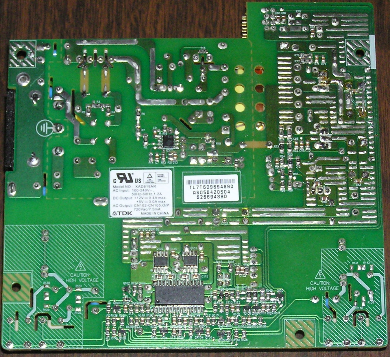

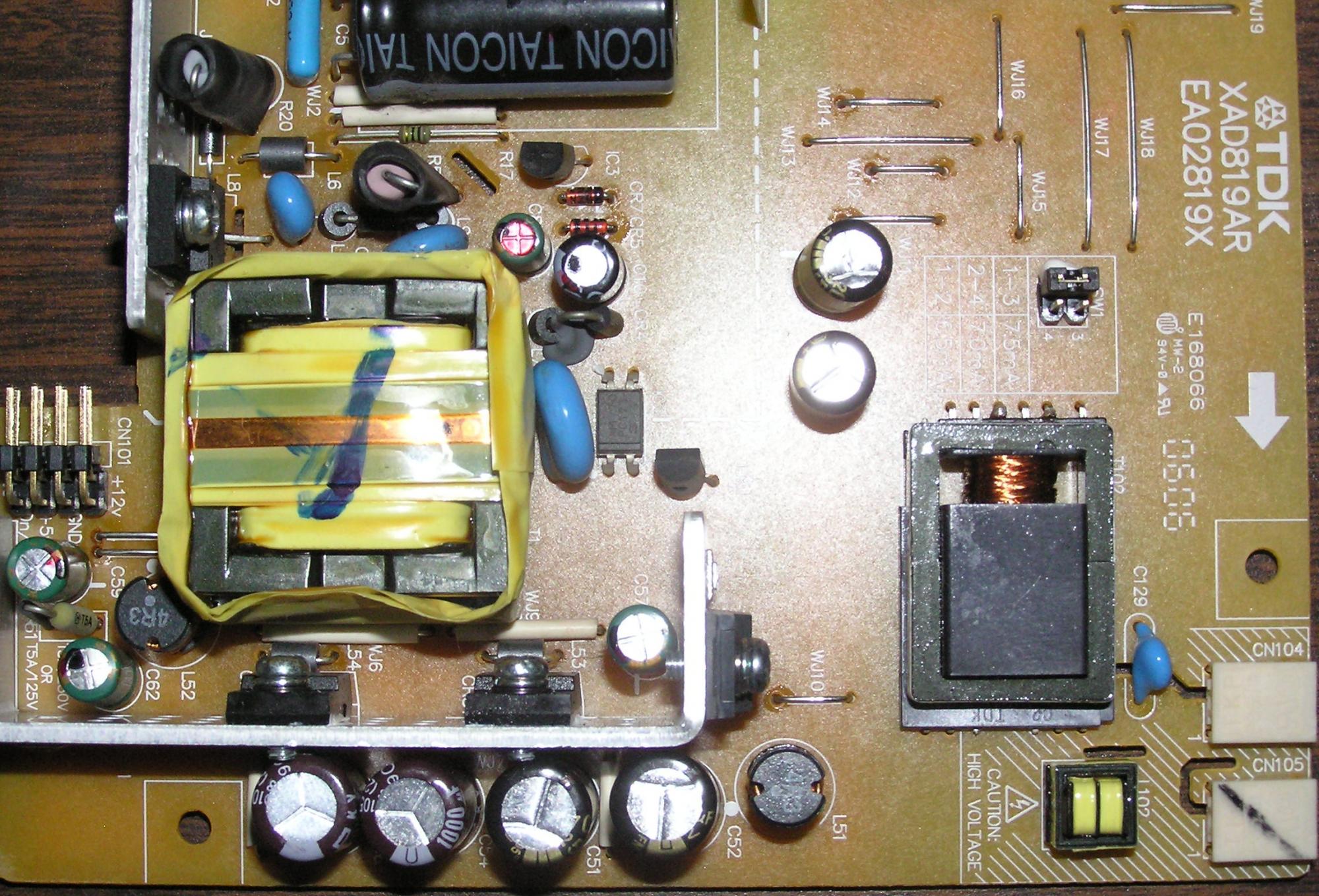

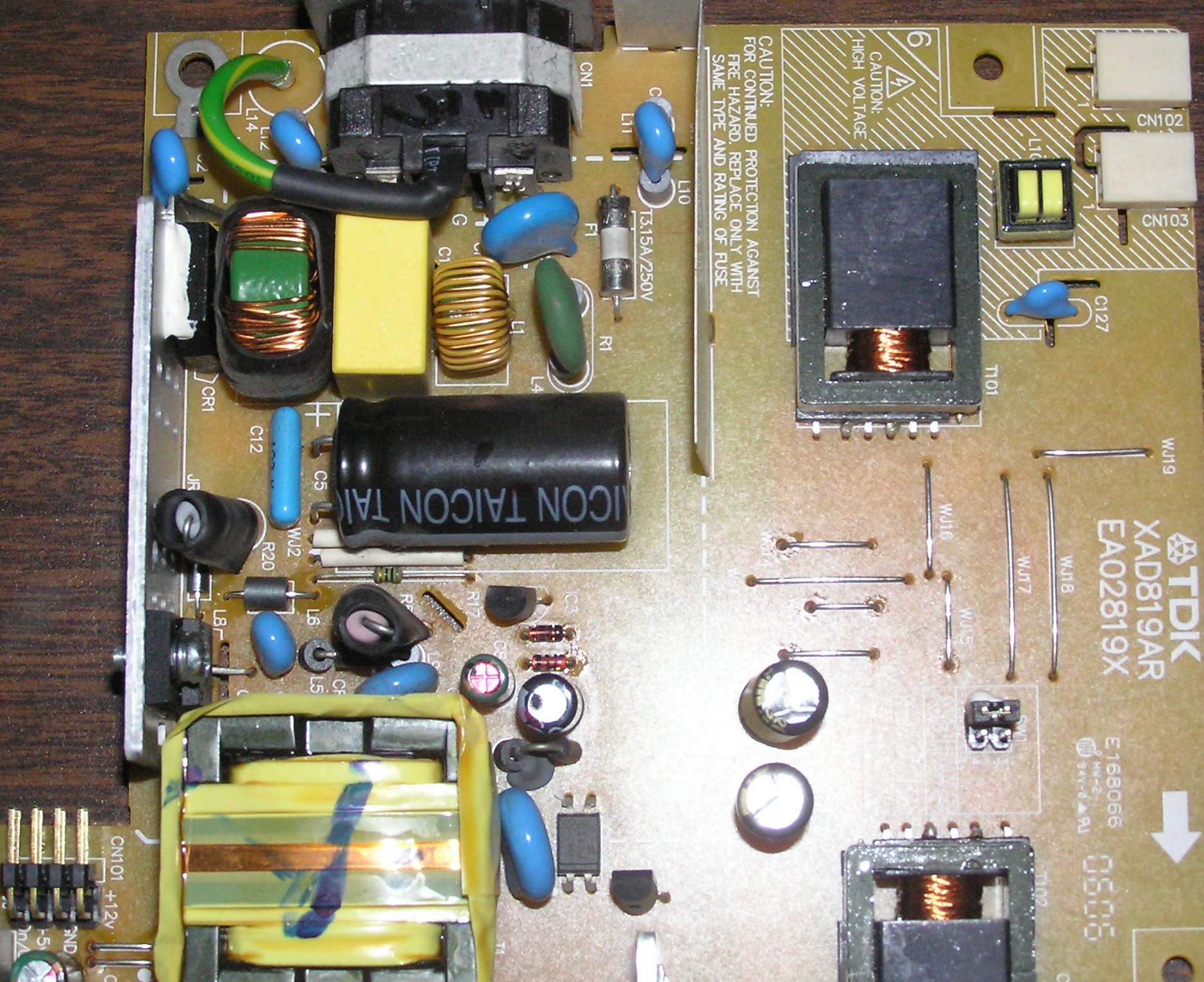

                                #55
                                Thank you for you response PlainBill.
                                I havent actually checked anything other then replace bulging capacitors. Could you please give me a little more directon on how to check for the output voltages.
                                Here are a few more pictures.
                                Thank you
                                Borg drone
                                  #56
                                  C62 looks swollen or bloated in the photos.
                                  CN101 is the connector to the logic card and clearly marked with voltages.
                                  Put your multimeter on 20V DC. Choose a ground screw near CN101. Put your black probe on the ground screw. Put your red probe on all the connectors on CN101 (one at a time) and record all the voltages and report them.
                                  --- begin sig file ---
                                  --- end sig file ---
