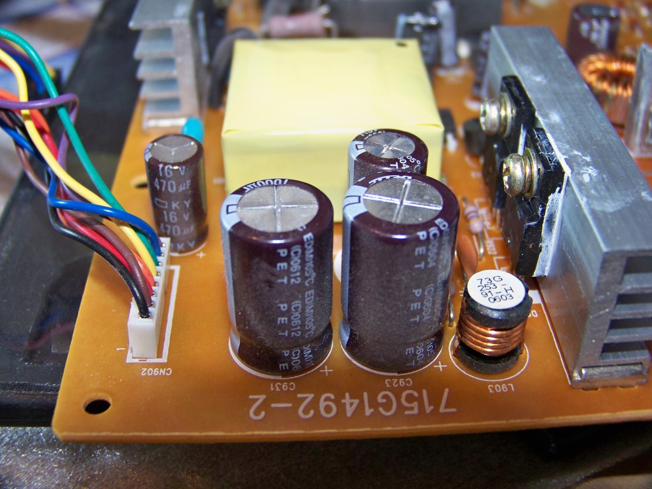

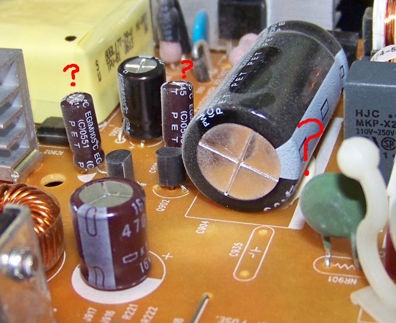

          Wow!! I never noticed that before. Look at the picture of the caps. It looks like those two may be bulging at the top.
          I'm not good at recognizing cap brands unless I read the label. And these are positioned so the brand's not readable. What brand are they? If they are on the 'crap brand' list they should be replaced.
          Anyway, here is a list of the caps by location.
          5V supply
          1000 uF @ 16V C924
          470 uF @ 16V C926
          12V supply
          1000 uF @ 25V C923, C931 (yes, two of them)
          470 uF @ 25V C925
          SMPS supply
          100 uF @ 25V C906
          47 uF @ 25V C909
          Inverter
          470 uF @ 25V C203
          PlainBill

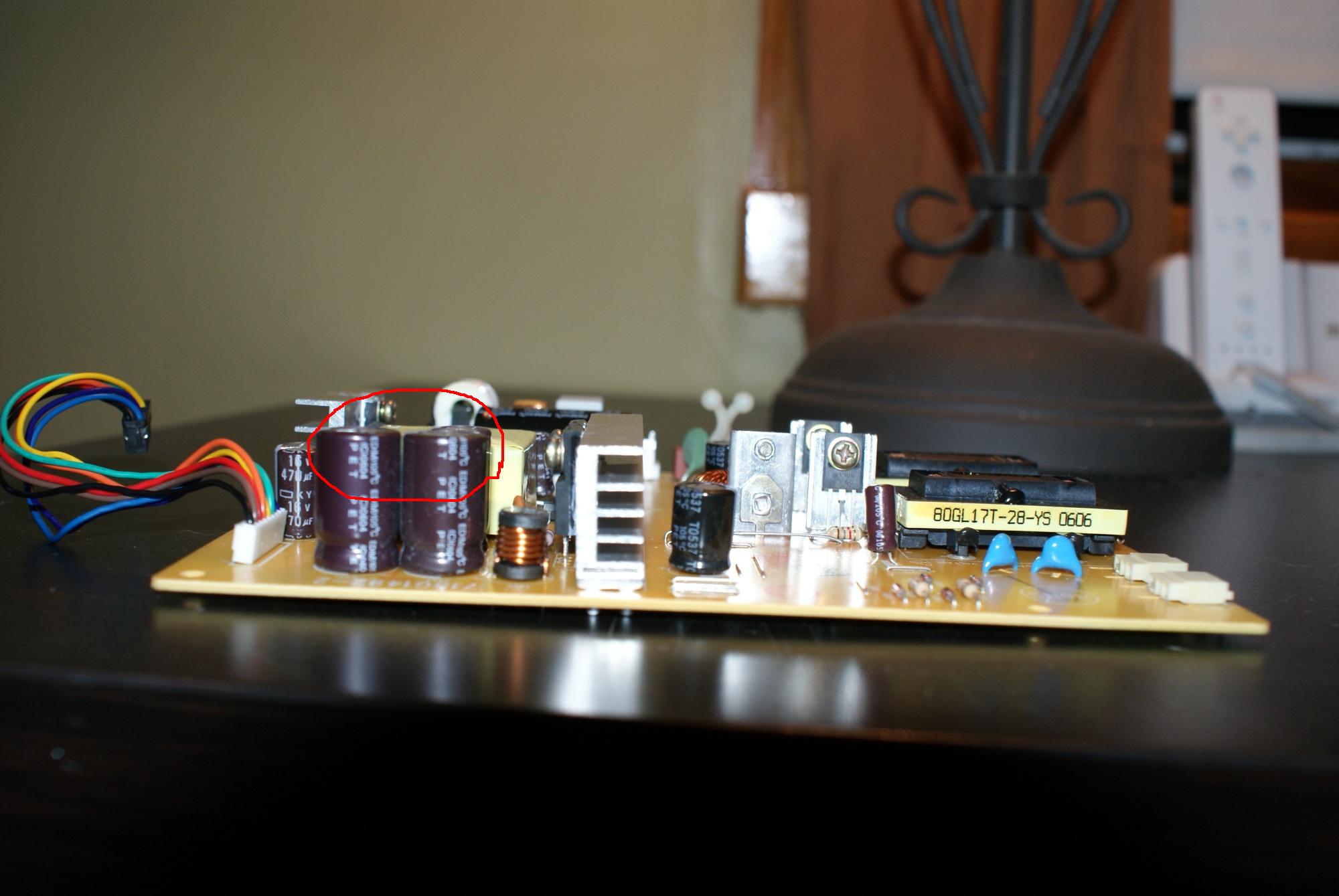

                    Just disassembled my "Acer AL1916A B" like above and I belive that I have the same problem with the power supply board. I'm a real DIY guy when it comes to PC's so I'm interested in following the advice here and replacing the caps.
                    The only problem is that I have never soldered anything.
                    Anyway, the only caps that seem to be bulging are the C0612 (1000 uF @ 25V) and the C0604 (1000 uF @ 16V) as shown below. The video board looks good. I'm hoping that I can just remove them an then solder replacement caps into their place. The depth of my knowledge is http://www.youtube.com/watch?v=on_2CP52cW4 so let me know if I'm about to shoot myself in the foot and need to go learn more first.

                              Ok, I want to replace the C0612 (1000 uF @ 25V) and the C0604 (1000 uF @ 16V).
                              After reading all the forum FAQ's and tutorials I'm still having trouble figuring out what types of caps I need. Maybe someone can let me know if this is right.
                              http://search.digikey.com/scripts/Dk...&name=P5544-ND
                              http://search.digikey.com/scripts/Dk...&name=P5533-ND
                              Again, here is a shot of them. (Front left and back right)

                                No.
                                Read the FAQ on 'Which caps should I use?'.
                                Read the FAQ on inserting pictures.
                                Read the thread I linked to on selecting caps.
                                As a minor point, I don't see signs of bulging, but you ARE closer to the caps than I am.
