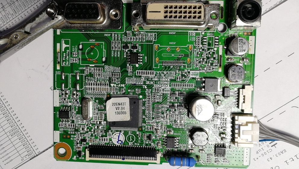

    This monitor had problems turning on from time to time. Pressing on-off button made power led to blink with no picture.
    After some tries ,once it started, there was no problem. Working perfectly.
    Now, there is no way to turn it on after several tries.

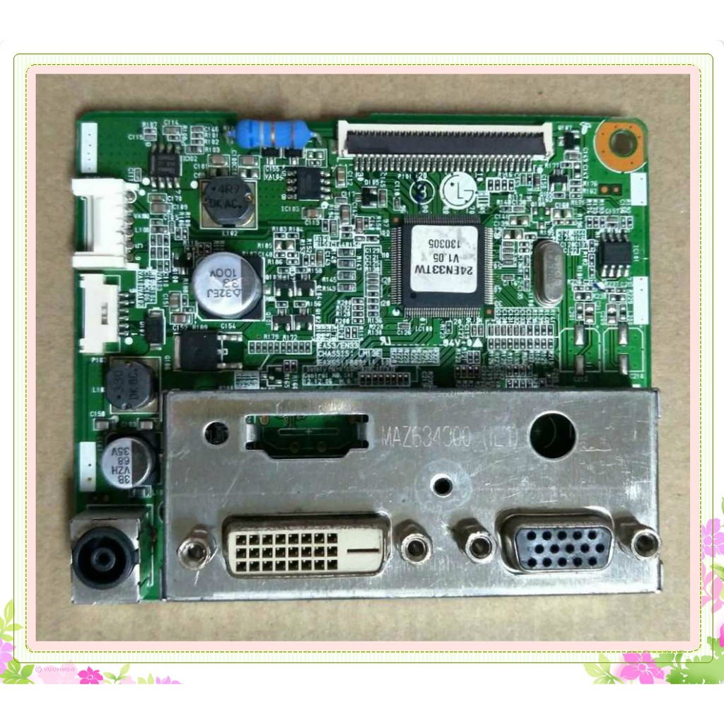

    The whole board is an eax65118801. I attach the schematic.
    All voltages are fine , 5VS from IC102 and both 3.3VS and 1.2VS from IC103 are OK.
    There is no voltage drop except from 0.5V on R100 when on-off button is pressed.
    I checked 2 big SMD electrolytic caps, and some other ceramic.
    Why not starting?? Do you think is a firmware issue?
  • R_J
    • Jun 2012
    • 9594
    Re: LG 22EN43T not start
    I see this is NOT the picture of YOUR BOARD (C154 does'nt look good, it seems slightly bulged).
    Post pictures of YOUR board.
    If this cap on your board is bad the backlight will not come on all the time.
    Have you checked the screen with an external light (flashlight) to see if there is an image on the screen? It could be the monitor is working and just the backlight is not working.
      I upload a picture of my board.
      C154 was checked, both capacitance and ESR are good.
      This in not a backlight issue. There is no picture at all.
      Monitor's power led is blinking. When was working the led was light steady.
      Seems that the monitor "is not starting".

          • R_J
            • Jun 2012
            • 9594
            At this point I would try a different power adaptor, It could be that the adaptor has an issue IE bad output cap. and the voltage to the monitor drops for a second causing the monitor not to come on. After a few tries the power supplies output cap is charged enough to keep the monitor on.
            You could try adding a 1000µf 25v capacitor across the 19v dc input and see if this makes a difference.
              Good suggestion, but no result.
              I add a capacitor and makes no difference...
              • R_J
                • Jun 2012
                • 9594
                Check the voltage on P102, pins 1,2,5 & 6. Monitor pin1 when you turn on the monitor, then try again with pin2 and so on. It could be that there is a faulty led causing the problem.
