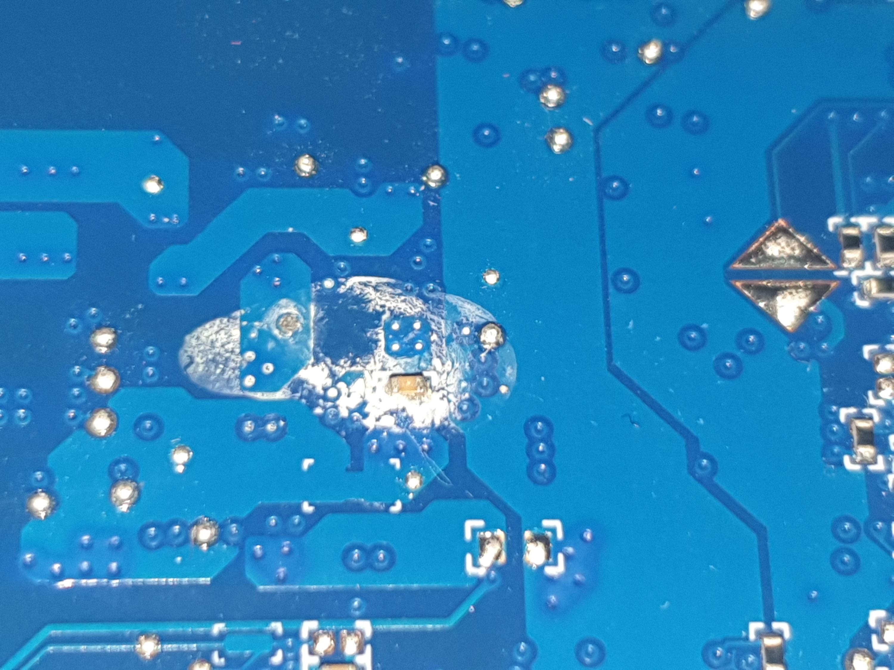

    I'm stuck with a hp zbook : the charge port flashes white/orange 8 times and than a white light
    it has 3.3 and 5v and 19v main power
    got 3.3 on onoff switch that gets pulled down by onoff switch but no reaction
    Got 1.6v on the middle pin of the power jack.
    Using a 150w original hp adapter.
    It has suffered minor some water damage
    Board DA0XW1MBAI0 REV:1
    Any suggestion or hint?
    Thanks!!

      Area's affected by water. One shorted capacitor has been removed.
      I don't see any activity on the coils which I checked with an oscilloscope except the 3.3v and 5v power supplies. It looks like that the power on sequence is not initiated when powering on.

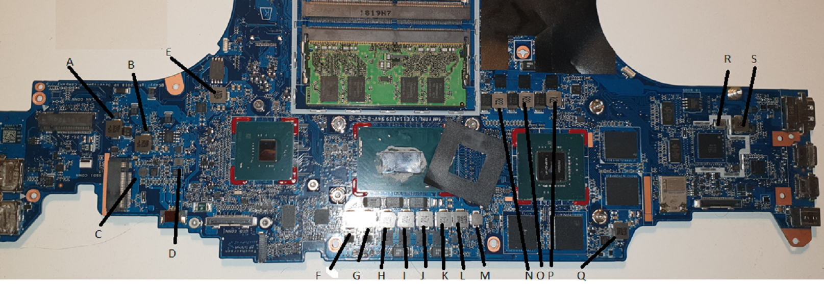

                            Best would be to share a pic of the board, with voltages and resistances written near the coils. Then we can decide where to start.

                              A 450k 5.26v
                              b 30k 3.38v
                              c 500k 5.26v
                              d 128k 5.26v
                              e 52 1.052v
                              f 7.5
                              g 7.5
                              h 3.6
                              i 3.6
                              j 3.6
                              k 3.6
                              l 18.5
                              m 46
                              n 1.5
                              o 1.5
                              p 1.5
                              q 112
                              r 256
                              s 800k 5.094v

                                Okay, this all looks good so far. Sequence is stuck at 1.05V for PCH but no obvious shorts at the power rails visible. But I have two questions:
                                - I wasn't able to identify the controller for the main memory (RAM) so far. Are there any hidden coils underneath the black tape or similar?

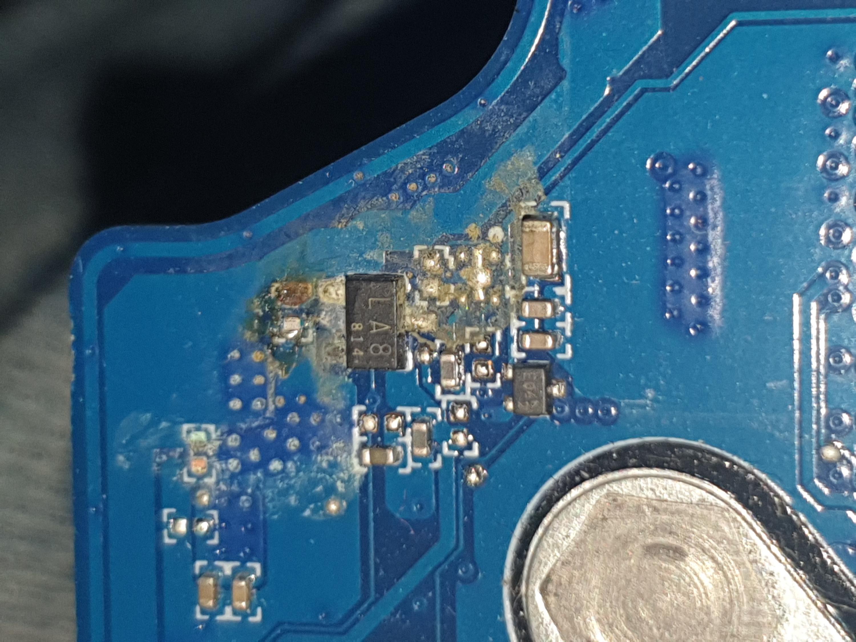

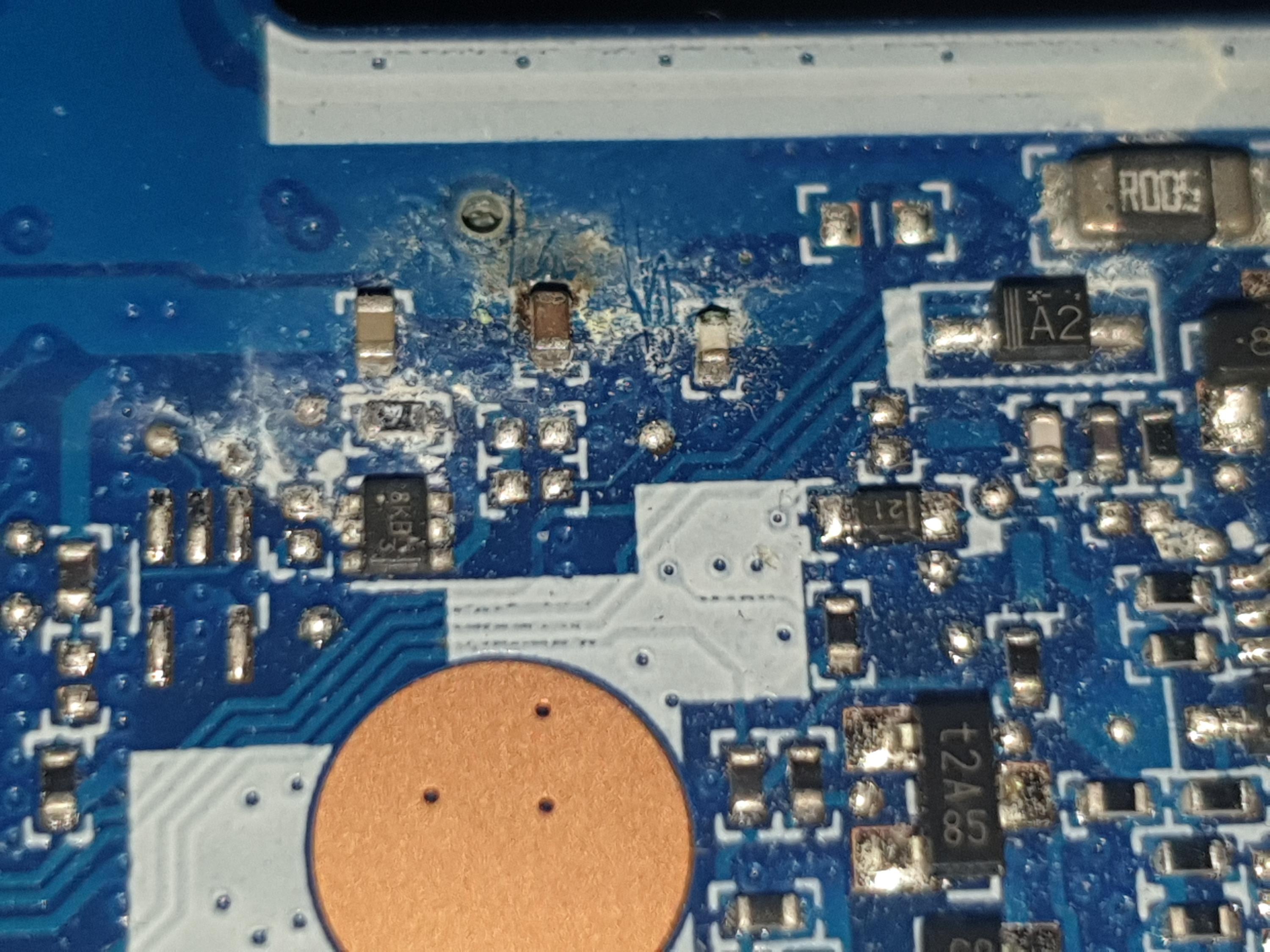

                                - and back to the liquid damage. Want to know how it looks like now. Hopefully not like in the initial post.
                                Since the issue probably isn't at the power rails we have likely unfortunately a logic issue instead, so my guess right now. If the RAM controller got found and measured fine, we have to dig more deeper to what the liquid damaged areas connects and to find out whether EC and PCH are indeed still healthy and hopefully we have just a failed transistor or similar semiconductor instead.
                                Exposed areas seems to be at least related to battery charging (pic 3) and to VMEM for the GPU (pic 1 & 4). Not sure what is affected when looking to picture 2, but damage doesn't looks so serious comparing the other pics.

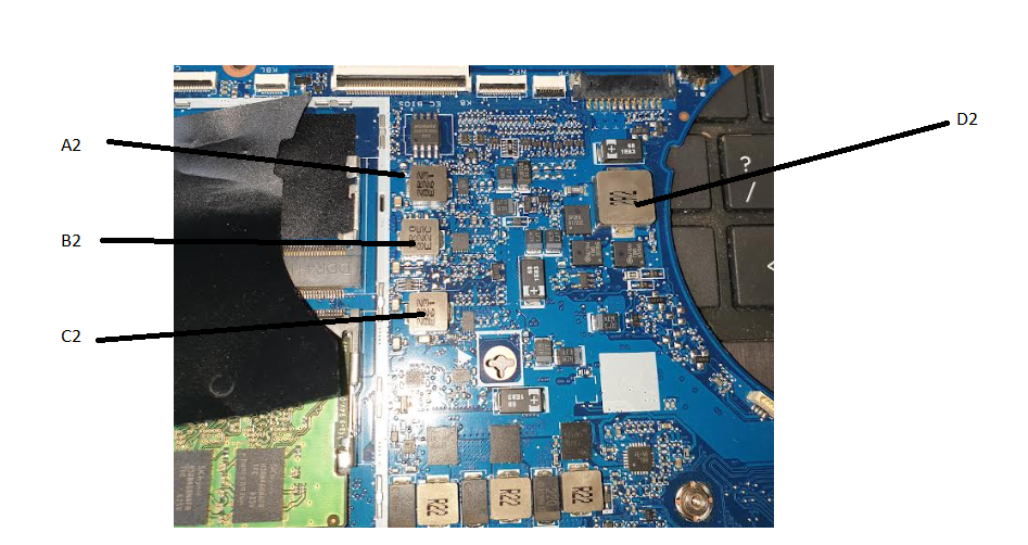

                                  you are right that I missed 4 coild underneath that black plastic:
                                  A2 88K 2.500V
                                  B2 600 1.20V
                                  C2 5.6K 1.8V
                                  D2 4.5K 12V (battery driver)
                                  measured with no ddr memory
                                  I agree that this could be a problem with on of the opamps that determines of all the voltages are there to instruct/signal the processor.
                                  I have taken pictures of all the arease that are affected by the water but I will double check them

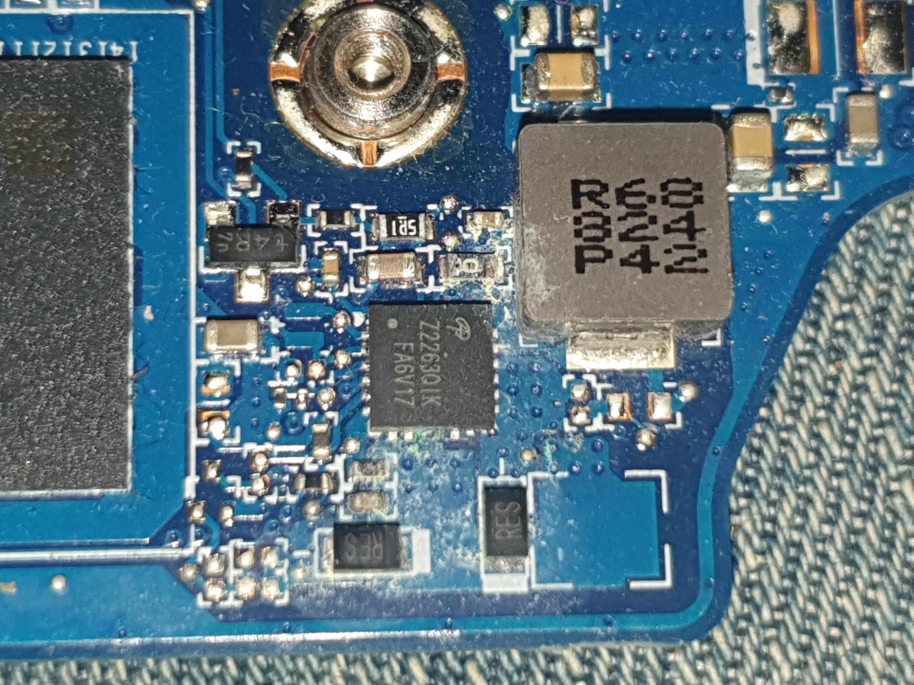

                                    Re: HP zbook pwr Jack flashes 8x orange 150w adapter
                                    I have found the problem: there was just a little bit of solder around a tiny capacitor that caught my eye: removed it and it starts up.
                                    Thank you very much for your help and encouragement to not give up. I learned a very valueable lessons on voltage injections: the assumption that a cpu or gpu takes 700mA at 500mV doesn't mean that it is toasted: is would if it measures say less than 1 ohm? I searched on voltage injection here on badcaps and found some very good information but not this specific situation.
